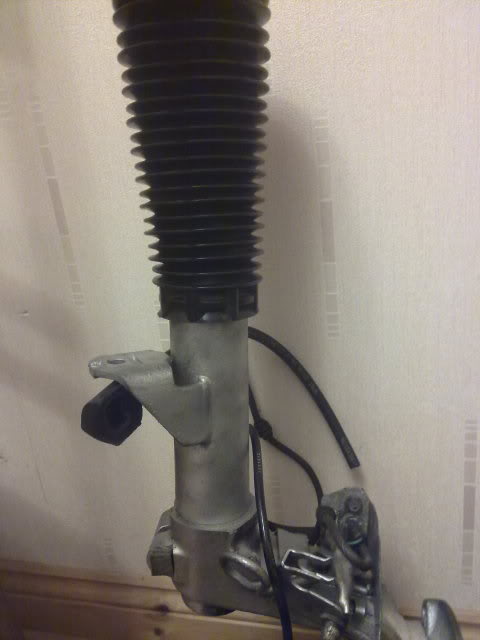

More progress on the xm today, or rather progress on bits of it indoors...
Heres the strut assembly before cleaning
Heres some of the cleaning happening, I really need a work shop, chloe is not terribly impressed with this happening in the dinning room... :?
Heres the arm having been cleaned and sprayed.
And the hub/strut assembly having been disassembled, cleaned and put back together.
Now to find the time to fit it bck to the car and do the same on the other side!

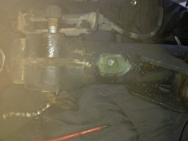

Been doing a bit more work today,
I managed to get the steering ram off after alot of fighting.
I found that the on one part the bush practically fell out as the rubber had disintergrated!
After persuasion with a socket i got the outer metal bit out

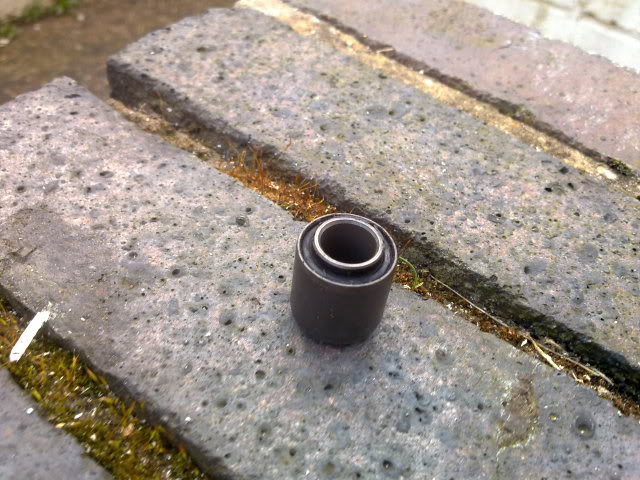

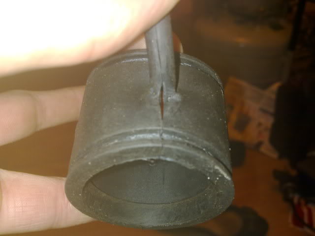

And heres the new one waiting to go in...
And guess what... its too small.
Apparently this bush is used on alot of cars, including the mk1 xm, yet on the mk2 to they incresed the bush size, and the later size is not available.

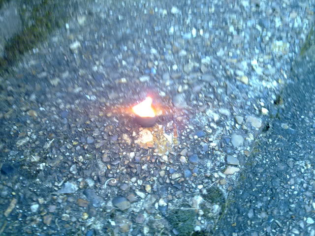

However the earlier size bush will fit inside the outer shell of the old one perfectly!
So i needed to get rid of the remnants of the rubber from the old one
Excellent, bush done, now to fit new gaitor on the end and seal the ram then job done....
Ahh, the brand new one is pre split for me :( Thats a trip to duff morgan to see if they will replace it!

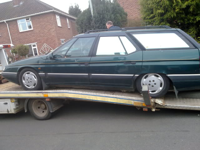

Got a bit of a dilema now....
This is it...
Its a 2.1td xm estate, I got it to break, but now as chloé feared I am dithering about destroying it!
The problem is that the head gasket is in technical terms, buggered.
Although it still starts and drives fine (though the auto box oil would need an urgent change.)
Also stuff like bald tyres and needs a new ignition barrel.
What to do? :?

KP
Posts: 3980
Joined: 10 Jul 2006, 12:11
x 27
Unread post by KP »
You know your aching to take another project on instead of taking the profit route on it :-)

Deanxm
Posts: 3327
Joined: 18 Dec 2008, 17:57
x 87
Unread post by Deanxm »
Then break it, i dont want to be the nasty one but you cant save them all and the body doesnt look like the best, there seems to be a few dents here and there.....
I had the same thing with my Estate, deciding if i should repair it or not but in the end it made sense to break it and im glad i did.
Im sure you have more worthwhile projects to be putting your time and money into, like your current XM or fleet of CX's 8-)

robert_e_smart
Posts: 1031
Joined: 23 Oct 2009, 10:51
x 14
Unread post by robert_e_smart »
Hi Dave,
I would judge the condition of the body and the autobox first. If the car has a good shell and isn't rotten, and the auto box is good, pending the condition of other bits it could be a good fixer upper.
Then again, breaking a car for parts also has its advantages. It depends on the space you have, but you could defer making a decision, unless you need to rob bits off it for the other XM.
