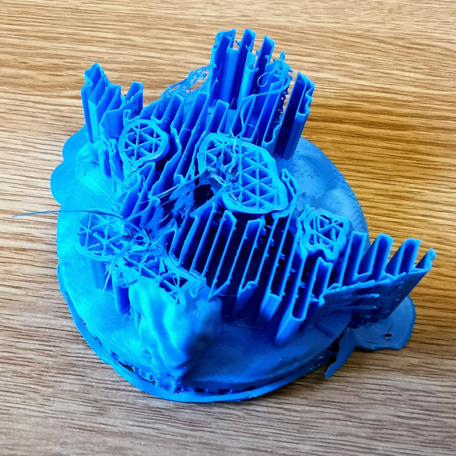

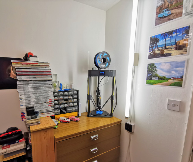

We had the first actual not immediately explainable 3D print failure today. This was going fine, right up to point where the printer decided that it would be a wonderful idea to jump to Z=0 - which would be fine if there wasn't about 40% of a model in the way.
No idea why that happened. Guessing there was something awry in the G-code, so I went back to the model and rebuild it, tweaking a couple of settings I'd forgotten to save the previous time.
Moved the printer across to the other side of the room too. Firstly so it's not in the way of the paper tray on the normal printer, but secondly to keep it clear of the window. Having a draught over it sounds like a recipe for warping that does.
It's off on attempt 3 of this model now. The first failure was due to a failure of build plate adhesion, which was brought to my attention when I heard a clonk, followed immediately by the half finished model rolling across my desk after it was punted out of the printer by the extruder.
If we get through the next hour without it going haywire again we might be in business this time.

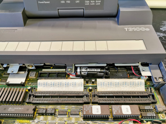

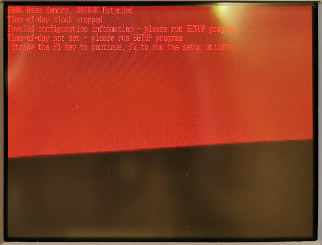

Main job for this afternoon was a quick one but something that's been on the to do list since 2005. Well, kinda. Sorting out the very, very dead NVRAM batteries in my old Toshiba laptops.

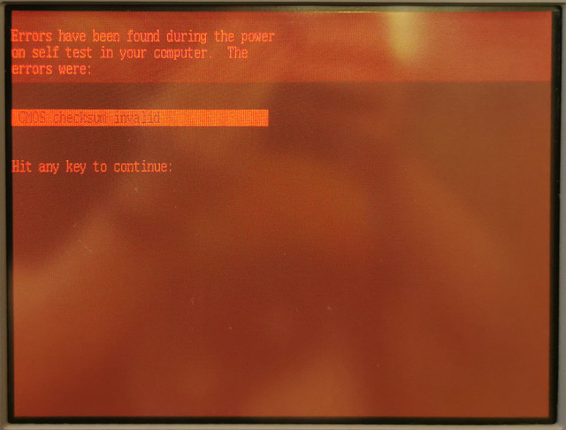

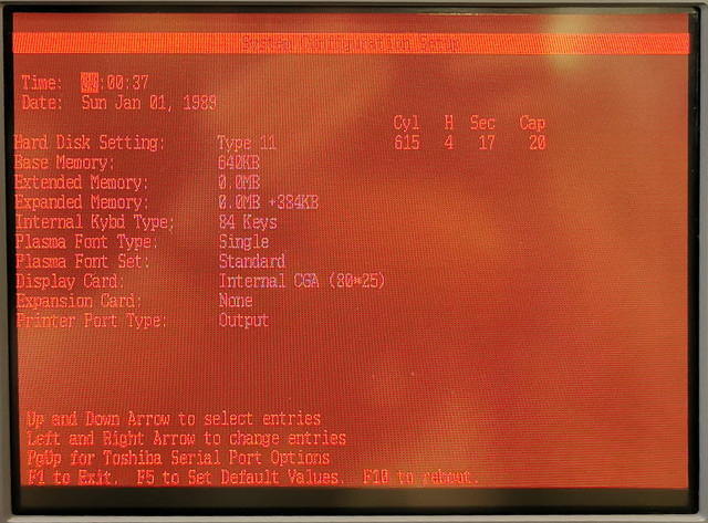

They use lithium thionyl chloride batteries for the NVRAM backup so they very, very rarely cause issues with leakage. However after 20+ years they're generally utterly dead. The T5200 has had this issue since 2005 meaning I need to reset the clock every time I start it up. However it's been the T3100e I've been using a bit more lately as it's more portable. So it's the one I'm sorting first.
This is the error I get every time it's powered up. Sorry for the image quality, plasma screens and digital cameras are not good bedfellows.
Followed by:

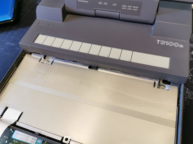

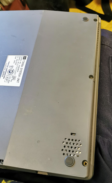

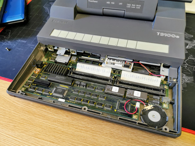

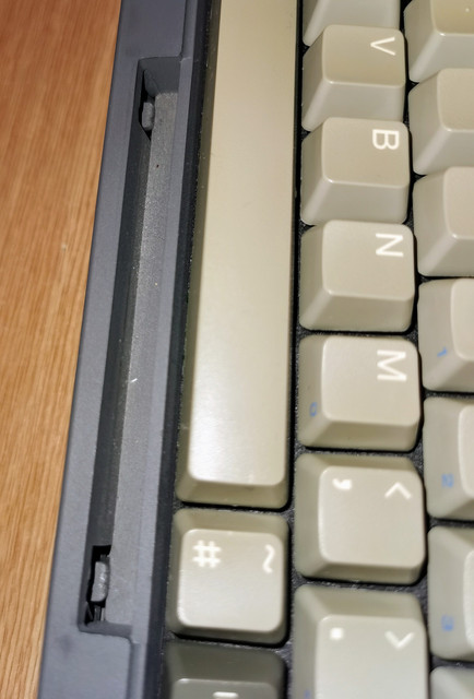

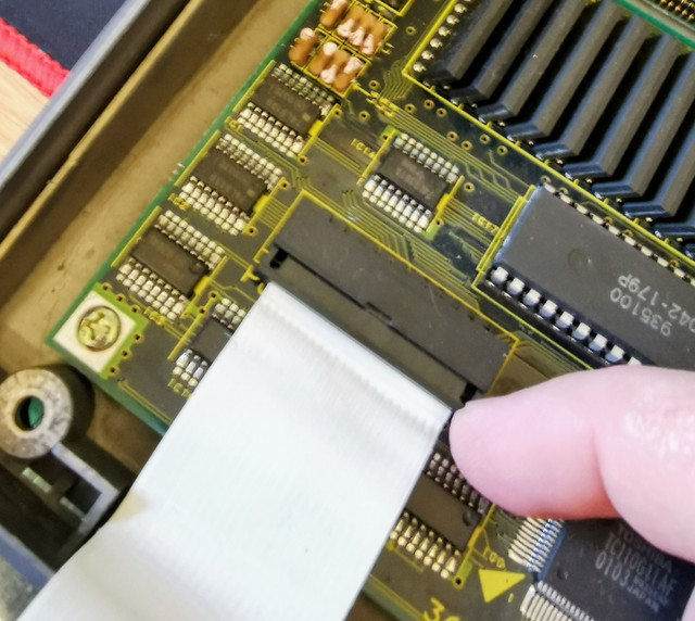

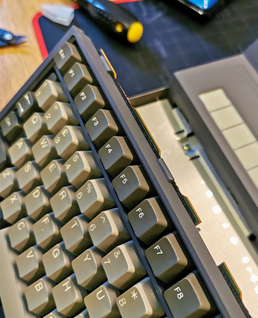

Step 1 is to flip the machine over and remove the three screws under the keyboard front edge.
You can then release the two little clips that are hidden in the screen catch recess.

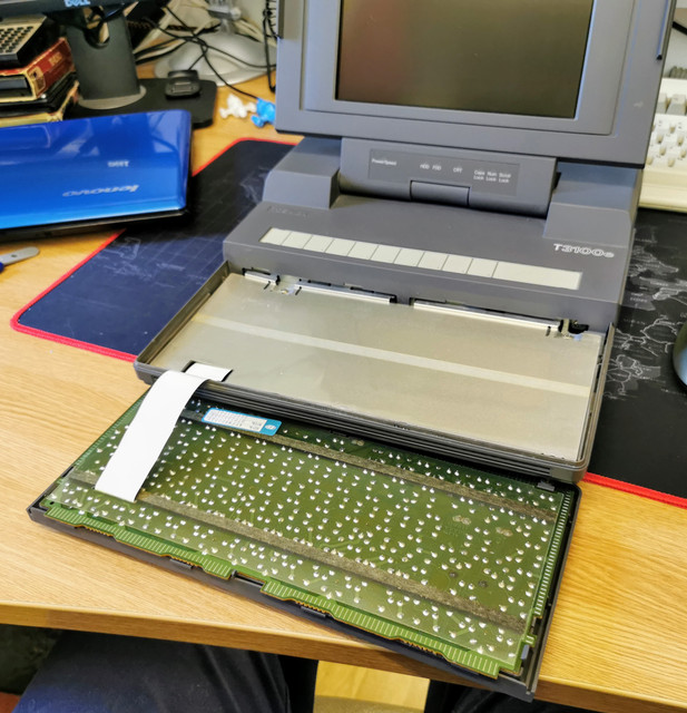

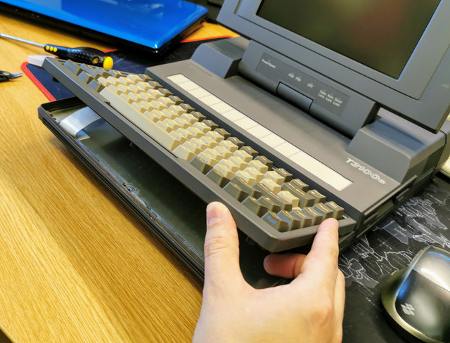

This allows the keyboard to be lifted up and laid down in front of the computer. The ribbon cable is exactly the right length for this.
Two further screws need to come out at the rear of the keyboard recess then the RF shield can be withdrawn.
You can then get to the keyboard connector. You don't *need* to remove the keyboard, it just makes things easier though as it gets in the way otherwise. This has one of those connectors with a raised collar you have to pull out before you can remove the ribbon cable.

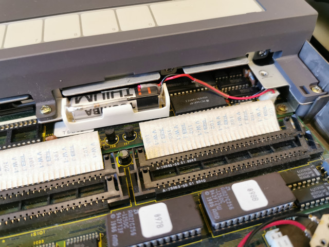

There we go, access to the area we need. If I had a memory upgrade to go in this is where it would be done. Sadly the T3100e uses proprietary memory so I can't just stick any old 36 pin memory in. If I had an 80287 math co-processor it would be fitted to the empty socket roughly central towards the rear.

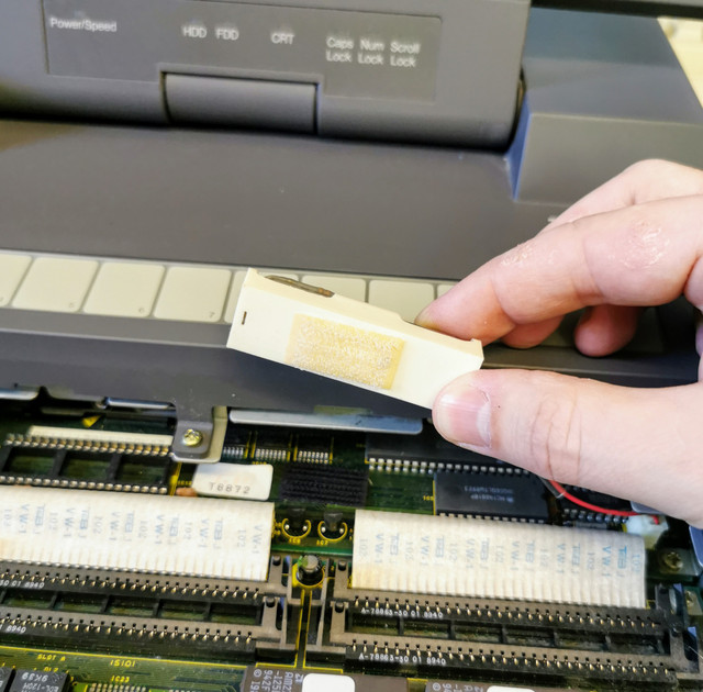

Here's our target.

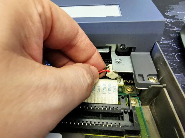

The trickiest bit of this process to be honest is getting the power connector off the motherboard as there's very little clearance beneath one of the case retaining lugs.
Still only about a 2/10 though, just a bit fiddly.

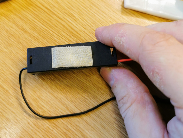

The battery holder itself is held in place by a bit of velcro.

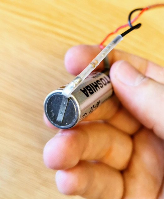

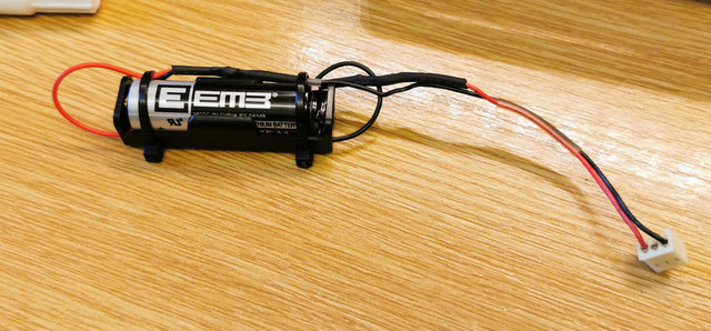

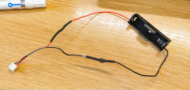

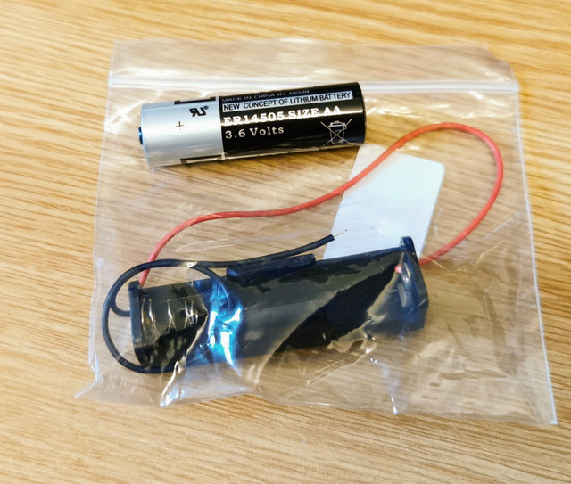

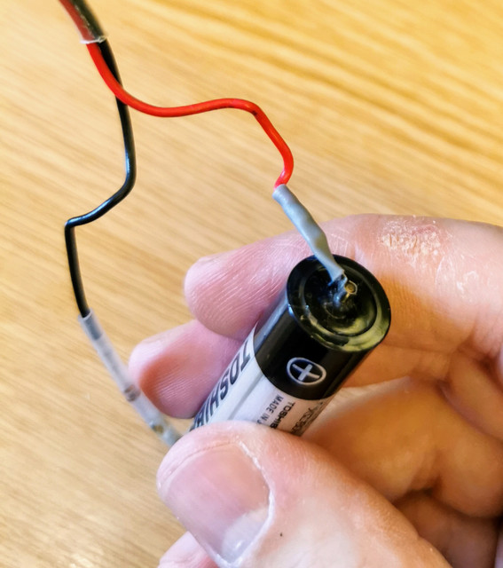

While the battery is a standard AA in terms of form factor a bit more work is needed than dropping a new one in, as the connections to the original are spot welded on.
The eagle eyed among you might have spotted there's a tiny little diode in there too. I think that's a holdover from an earlier design which used a NiCd battery and had charging hardware on board. Because of the spot welded connections there are no actual terminals in the battery holder.

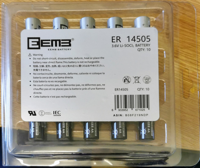

I figured rather than messing around trying to solder to lithium batteries, for the sake of £0.75 apiece I'd just get a new battery holder with standard connectors in.
I remember when I first got the T5200 that these batteries were really hard to find...however now you can just get a pack of 10 from Amazon or eBay for less than £20.
The T5200, T3200SXC and T1200 will want this job doing as well, hence the larger pack I picked up.
I just snipped the leads off the old battery so I could reuse the connector etc. For a change I did remember to put the heatshrink in place before soldering the wires together!
I bundled up the extra length of cable with a couple of small cable ties. Not pretty but it'll do the job.
Luckily for me the glue on the old velcro rectangle was still sticky so I was able to peel it off and put it on the new battery holder.
Convenient as that's not something I had in stock.
From this point on reassembly is the reverse of disassembly.
New battery holder etc shown in place before putting the covers back on.
Note when the keyboard goes back in that there's a lip at the back so it has to go in at the rear edge first.

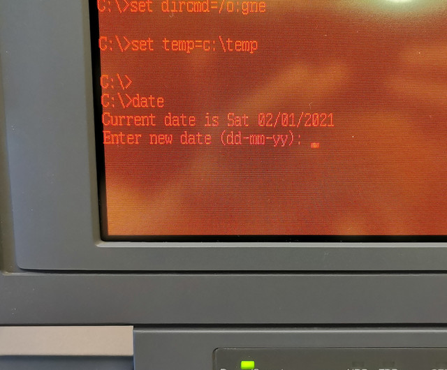

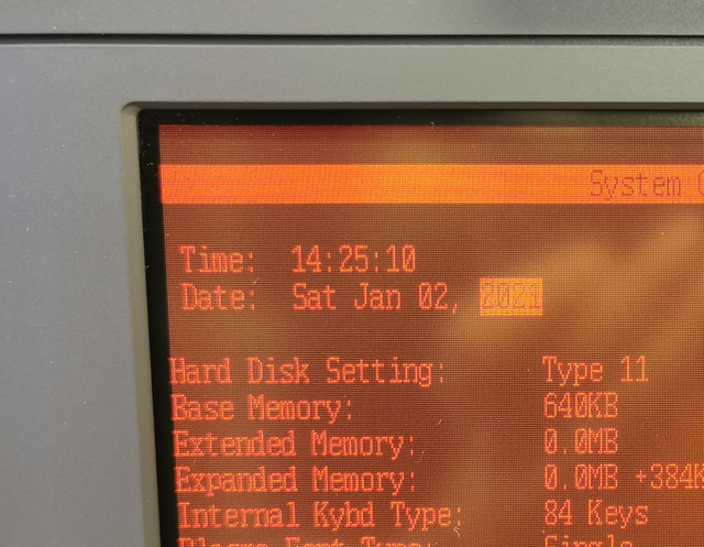

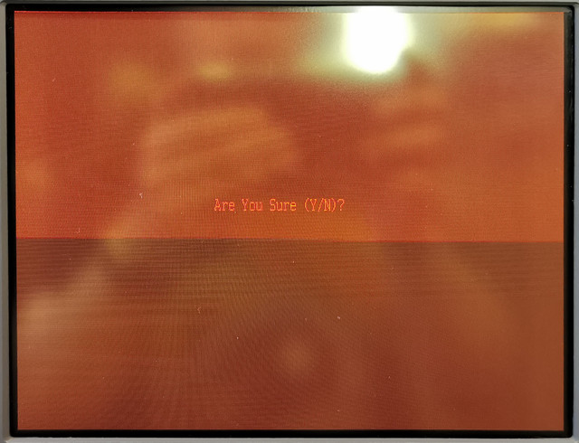

On the first startup it will of course still be complaining so you'll need to set the date and time one last time in the BIOS setup screen.
Date correctly set...no Y2K issues here on a machine from 1988!
I do enjoy the ARE YOU REALLY SURE YOU WANT TO DO THAT?!? nature of the confirmation screen it gives you before saving the settings.
Rebooting a few minutes later gave no error messages, and checking the date once we'd booted into DOS...
Yep...it's saved the date settings and the clock seems to be running properly.
Very simple job really but nice to have something that was quite annoying ticked off after several years.

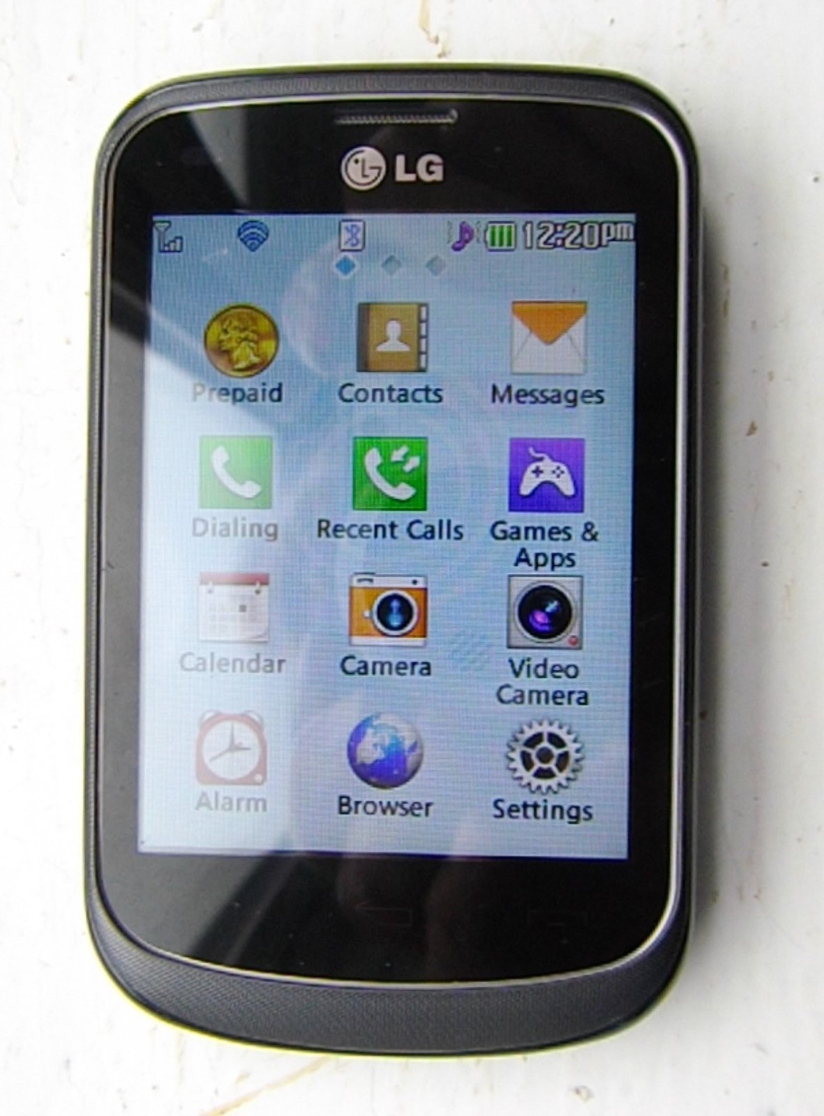

Here's one for you electronics boys.
I bought this LG 'feature phone in the States last time I was there, it's locked to Tracfone a US provider and they won't give an unlock code because it hasn't been used on their system for long enough.
I doubt I'll be going there again so unless I can unlock it it's a paperweight.
The regular unlock guys are unable to do it, seems the Tracfone stuff is built into it by LG.
Any suggestions?

Clueless :(
I have my son's discarded Samsung Somethingorother and can't do a damned thing with it, he can't remember the PIN which is needed to do a factory reset before it can be unlocked.

If he hasn't set a pin maybe it's still 1234 or 0000. :-D

Tried all the usual ones. He did set one but no recall of what it may have been. Tried his bank pins, not them either.

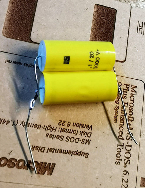

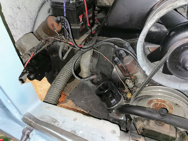

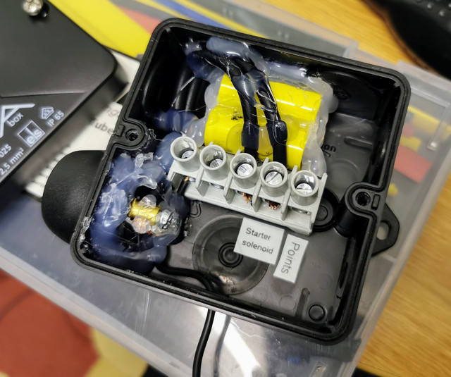

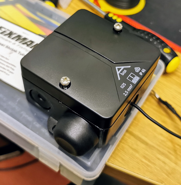

Finally got around to building up the enclosure for the distributor condenser for TPA today.
The 0.22uF caps still haven't arrived, so I've just made up a dual 0.1uF cap. As it will be living in a large enough enclosure there's really no issue with this.
Given the application vibration was something I was wanting to put a stop to, so the innards of the box have been well and truly secured in place with plenty of hot glue. The capacitors are actually a nice snug fit between the outer of the case and the posts that the terminal strip sits on anyway, so it's just belt and braces really. Under no circumstances should the capacitor leads have any load placed on them. I've also tried to ensure that anywhere that the wiring in the box is touching anything that it's held in place so we can't have any issues with things rubbing through over time.
It looks messy, but that's kind of the curse of hot glue.
The lead that you can already see connected is the ground connection, which is just going to a ring terminal which will be secured under one of the mounting bolts.
You can also see that there's more than just the condenser in here - that's because I'm also using the enclosure as a convenient location to fit a remote engine start button for use when I'm doing testing in the engine bay.
If I find I have issues with the plastic enclosure cracking I'll replace it with a metal one. It just seemed like plastic was less likely to dissolve the first time it got wet.
Drilled and tapped a couple of holes for it to attach to in the engine bay (okay...Three holes because I totally fouled up the location of the first one and the enclosure would have had to be halfway into the space occupied by the voltage regulator) and hooked it up.
Still need to install the wiring for the starter button but the distributor side is all hooked up now. I had planned to get the starter hooked up as well but by this point I'd completely lost all feeling in my fingers so retreated back inside!
It's a small detail but it's really nice to have got something on the car side of things ticked off again as it's been a while. Plus this gets rid of my cable-tied bodge from a few weeks ago and is far tidier. It looks a bit new and shiny in the engine bay at the moment but once it's got a bit of road dust on it it'll blend in just fine. Plus I'm more interested in long term reliability and things which make it easier to live with than absolute originality.

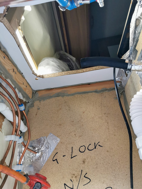

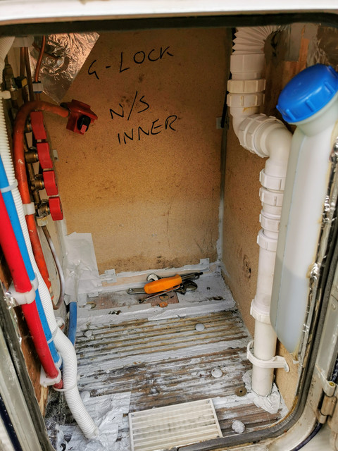

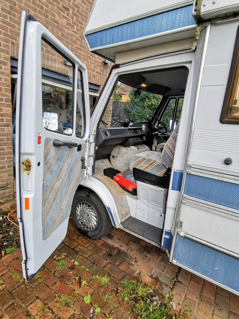

Despite successfully finishing wiring up the condenser enclosure and getting the remote start button working the day ended rather depressingly when I managed to lock the keys in the van. I also discovered that the battery charger I thought I had repaired following it going bang quite spectacularly a couple of weeks ago is still broken...and was actually sucking juice out of the battery rather than charging it. I know there are three conventional chargers in this house, but could I find one? Not a chance!

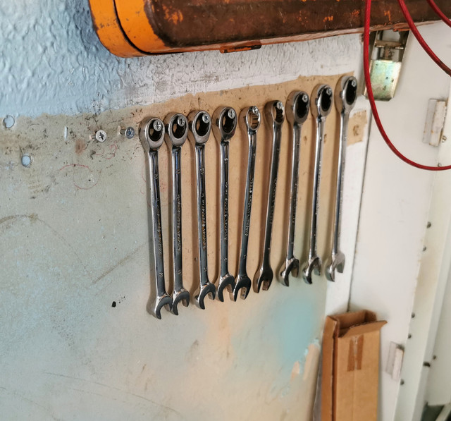

I don't have a full set of spare keys for the van. I've been meaning to remedy this for a while but it's never made it to the front of the to do list. Biggest stumbling block was that Timpson's (etc) couldn't apparently source a blank for the key for the actual van bit. Apparently you'd need to get it direct from Mercedes for stupid money. As other jobs took precedence I never really chased that up.
With the keys I did have, the only useful thing I could get into was the gas locker.

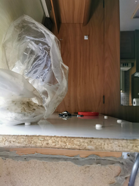

My plan was to unbolt the draining board which sits above the locker, climb into it, then reach up through there to get hold of the keys - assuming they were sitting next to the sink where I thought I'd left them. Of course just to add to the fun, all the blinds were closed so I couldn't see!
This plan then encountered another frustration when I went to pick up the 8mm spanner.
It should be on the hook nearest the camera. Last time I used it was when I was rebuilding the Jag's wiper motor...in the van. Ah.
After far too long wrestling with an adjustable spanner that was far too big for the job at hand I had the draining board out - at which point the 8mm spanner I'd mentioned earlier bounced off my forehead and everything I'd left stacked on the draining board cascaded onto the floor inside.
Now I'm not flexible enough to actually climb through that hole, but I thought I knew where the keys were, so should be able to reach them.
Thank goodness for that! I was just able to reach them at full stretch.
Sorted!
Then I just had to tidy up the mess I'd made and reassemble what I'd taken to bits.

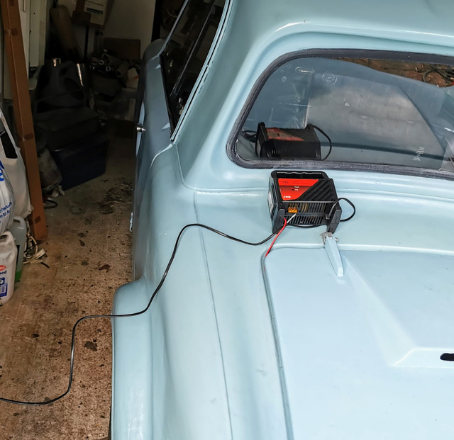

With the van back together and now accessible I was able to dig out the backup backup battery charger out of the service locker.
So basically back to where I was hoping to be when I wrapped up yesterday!
It's a cheap and nasty thing but will do just fine for a bit of a boost. Think everything is struggling a bit just between winter and lack of regular use.
