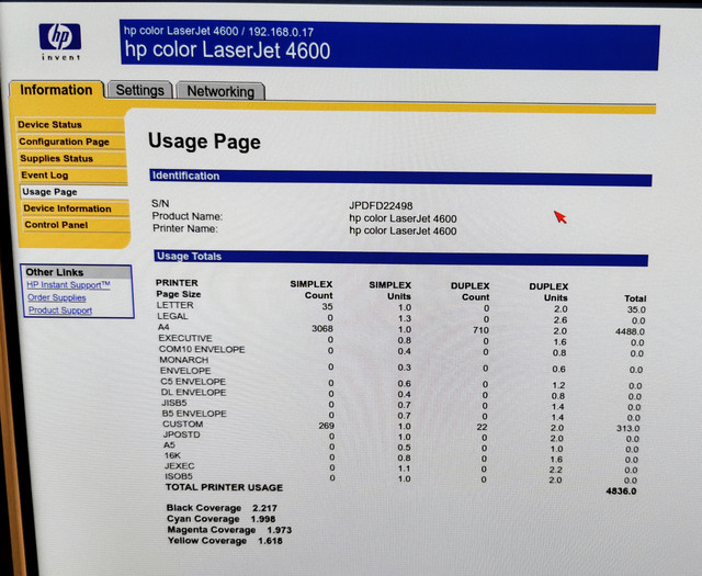

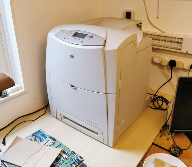

This morning I was expecting a package to arrive. What I wasn't expecting was a PALLET to arrive. It had this cocooned on top of it (we had to de-pallet it as that was too wide to fit through the door).
We only nearly died twice getting it up the stairs, but sensibly decided to hold off fully unwrapping it until it was situated on the desk which is its new home.
We had the scales to hand in the room so weighed it - 47.8Kg. Not as heavy as some of the early LaserJet models, but plenty heavy enough that you don't want to move it often!

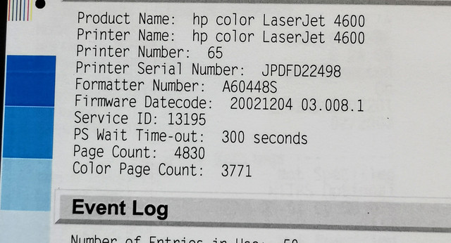

The company we'd bought it from (who had also reconditioned it) had helpfully printed out a status page before wrapping it up. Nice touch. It's worth bearing in mind that this model was rated by HP for a duty cycle of up to 85,000 pages per month. Being from 2002 you'd tend to expect this to have pretty well earned its living by this point. Especially being the top end version with the duplexer fitted.
Yes, that does indeed show a total page count of 4830. The term "barely run in" springs to mind. Kind of like finding an XUD Xantia with 30K on the clock.

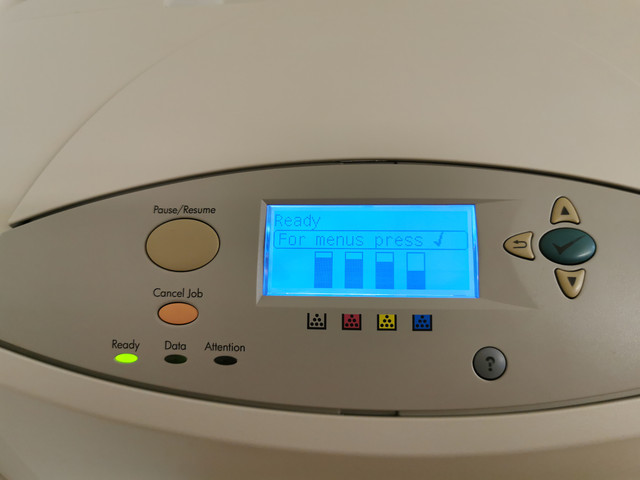

The supplies were listed as having a minimum of 40% on any of the toners and a nearly new transfer belt and fuser. The consumables printout confirmed this was a bit pessimistic really.
Can't complain at that...and this seemed to be borne out by the status readout when I turned the thing on.

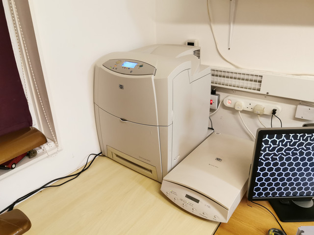

In theory what should have then followed was plugging in a network cable, setting the network configuration to "auto" and calling it good. Of course that's nothing like what happened. Not least because of the fact that our router (seriously...I can't wait until we're rid of it) is beyond awful and the DHCP server will seemingly randomly take exception to certain devices and refuse to allocate them a valid IP address. No huge issue...setting up a handful of addresses manually isn't the end of the world.
Two and three quarter hours of swearing and bashing my head against several walls later I figured something out. You can set IP addresses manually...however the fluffing Sky router won't actually speak to anything that's manually configured above 192.168.0.20. So my having picked ...150 because there was nothing else on the network in that vicinity of course resulted in no network connectivity. Well...that's not actually strictly true. I could *see* the printer on the network, to the extent that my PC would spot it and set it up...but couldn't then establish communication to talk to it or print anything. I must have wasted over an hour chasing my tail here...until trying a low end address...and suddenly when I tried ...17 (I've got other devices on 16 and 18) it "Just Worked."
Finally.
This then allowed me to get into the configuration page and prove that it does indeed have a crazy low page count.
With it now working (and several test prints run through which came out lovely) I was happy enough to scoot it all the way back into its corner and to rebuild stuff around it.
For the £120 I paid for it I'm well pleased. It seems to be barely used, has £150+ worth of transfer belt and fuser in, and is incredibly clean - which given it's kinda prominent on my desk is nice. Tucked away in the corner it doesn't actually take up much bigger a footprint than the Epson it's replaced despite obviously being far greater in actual volume.

I used to work on and repair those printers Zel
They are very good and consumables have a long life...
You're right, one of the last of the old-school HP printers...
Good to see the Fuser and Transfer Unit has a lot of life left
Well bought! £120 was a steal

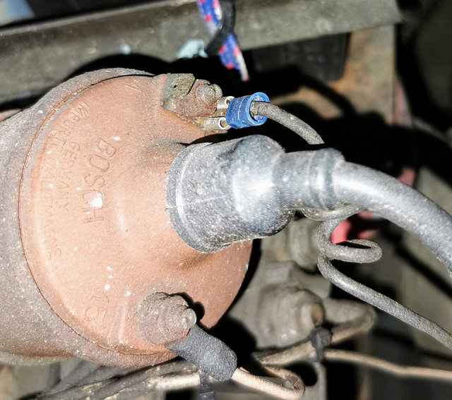

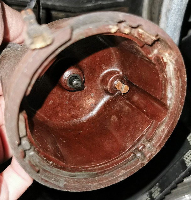

Decided it had been far too long since TPA had been out. Had intended to get her out last week but torrential rain ended up putting paid to that plan, mainly on account of the windscreen demister being pretty much useless. Issue is basically that because the duct is so long and narrow there just isn't enough airflow. The heater really needs a decent blower which can both shift a decent volume of air and also produce decent static pressure so it doesn't just get choked by the ductwork. That was the issue I had with the axial blower I tried originally...it shifted masses of air in the open but couldn't handle the back pressure from the heat exchanger and all the ducting.
It was obvious on start up that she wasn't happy. Just wouldn't idle properly, no matter what I did. Felt more like an ignition than fuelling issue to me so decided to go over the basics.

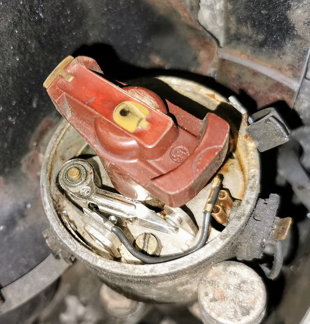

Gave the distributor cap a wipe down and the contacts a scrub up.
Wasn't terrible but equally could be better. Given this is the cap which came with KPL and spent goodness knows how long open to the weather I really should just change it...
The rotor arm looked fine so just gave it a very gentle clean. That's not a dark spot by the way, there's just a polished spot where the centre contact sits and it's reflecting shadows.
Pretty sure dirty points were to blame as there was a bit of oxidisation present. Gap was fine though once the contact surfaces had been given some attention with some fine Emery cloth.
While I was in the area I changed the somewhat ropey crimp terminal on the switched line from the coil.
I have previously noted that I could stall the engine by wiggling that wire before so had been meaning to change it for a while.

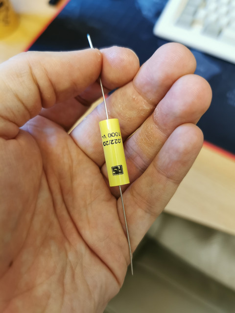

I did note when testing that there's a bit more of an arc at the points as they open than I'd like. So I reckon the condenser is on the way out. May well be behind the original issues today.
Given how terrible the quality of most automotive replacements these days I'm not even going to bother with them. These condensers almost always seem to be in the 0.1-0.3uF range that I've seen values stamped on, so as I've got good quality polyester film caps in stock in 0.22uF/1kV I'll just be fitting one of these.
I will probably gut the can of the original and stick it in there so it'll be a nearly invisible upgrade. This cap should essentially be a fit and forget solution as these caps don't tend to degrade appreciably and damp doesn't affect them as they're properly hermetically sealed.

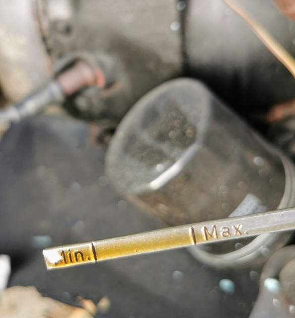

I still keep expecting this engine to use oil for no really valid reason and it keeps surprising me when the oil level never moves.
