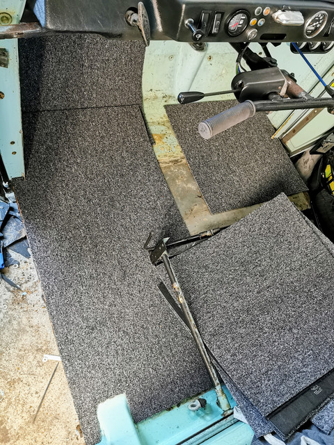

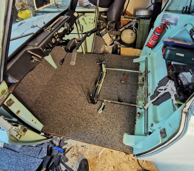

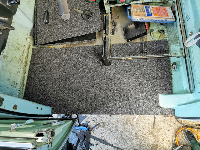

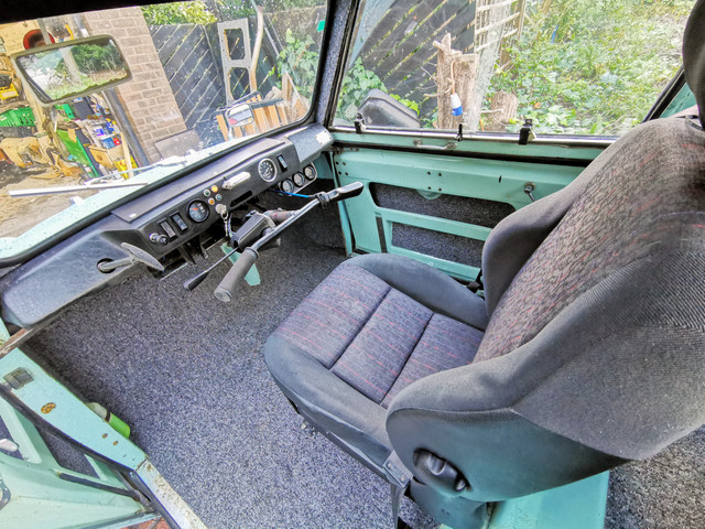

You can start to get a feel for how it's going to look now I think.
These are the new kick plates that might be going in.
I'm still undecided...whether they get used or not will probably depend on whether I can get the originals back to a vaguely presentable state...currently they're awful.

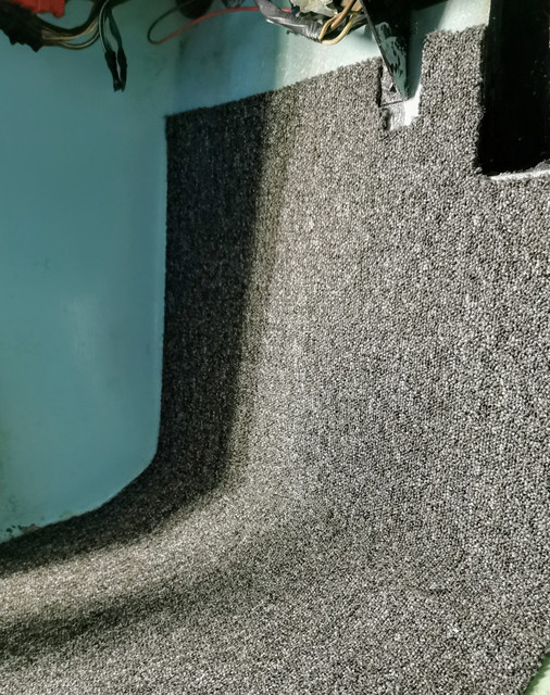

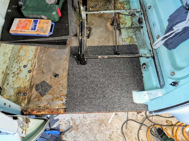

I'm basically making the left carpet, right carpet (which is *mostly* just a mirror image) then will cut an infill to go in the middle.
Nothing is being glued in place yet. Before that happens I need to rotate the car 180 degrees so I can do the same knackered rivet replacement on the offside, paint the seat base, find a rubber boot for the gear selector linkage where it passes through the bulkhead and thoroughly degrease the entire floor and front bulkhead. Depending on how things sit I may apply some foam underlay. I think that this will really make a huge difference to the feel of the interior.
As the seat can only be moved a few inches to either side I'm also doing away with the sliding capacity. Two bolts will be going through the rear of the frame to secure it in place. As the latch is at the front of the frame the rear of the seat tends to shift an inch or so every time you change direction, and it's quite annoying. If someone wants to undo it in the future it will just require a couple of bolts to be removed. Should make the driving experience a bit more pleasant. The seat wobbling around really doesn't instill confidence, so I'd really like to stop it doing that. I reckon this is probably more of an issue with my seat than it would be with the original as this provides a lot more lateral support than the original one would have.

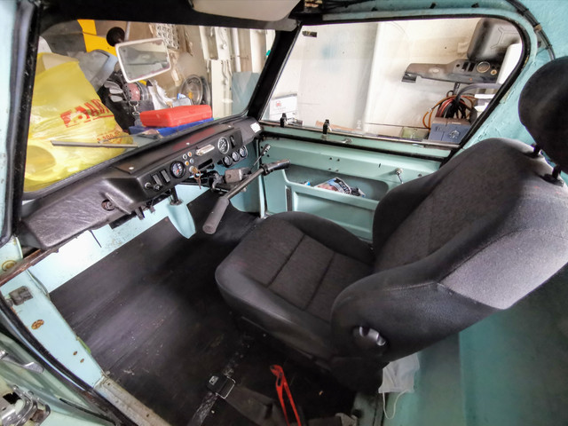

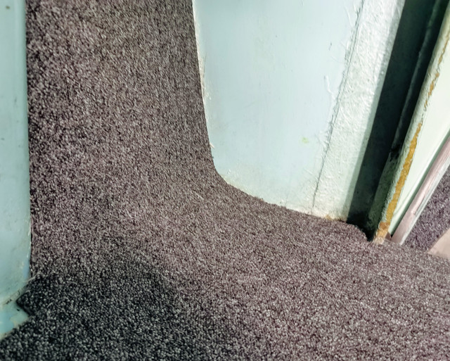

This is actually starting to look like I've got any idea what I'm doing...
The joins will be far less visible once things are actually glued down. Plus the bar across the middle isn't bolted down at the offside yet hence the bump there.

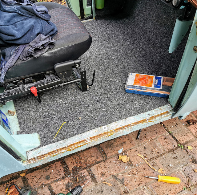

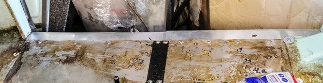

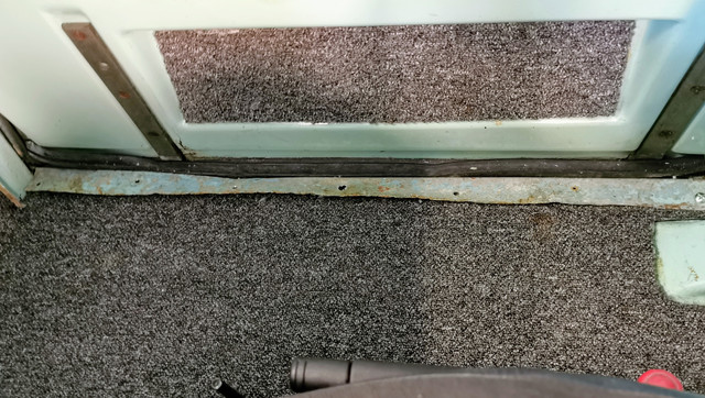

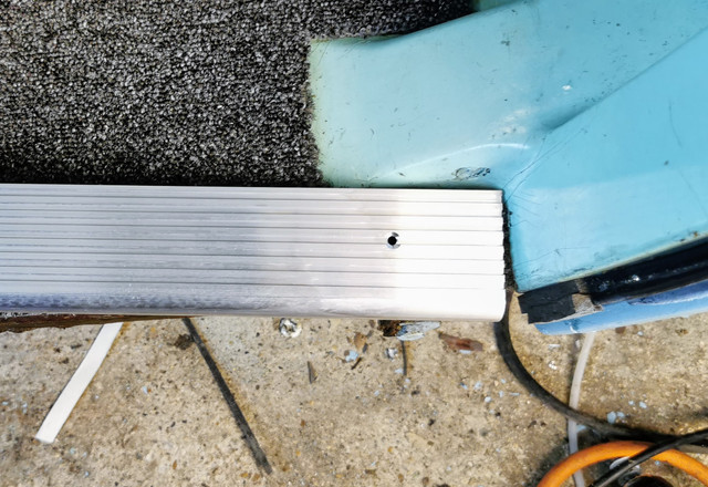

New offside outer "sill" made up from some ally sheet and bolted in place.
I tapped the edge at the overlap flat with a hammer, though as this will be under both the carpet and sill kick plate I'm not really too bothered about how it looks.
I then went on a similar rivet replacement mission as I did on the nearside before giving everything a thorough wipe down then starting to get the carpet glued in.
After an hour or so getting distinctly high on carpet adhesive fumes we were three or four pieces away from the floor being done.
Closer look at where it's following the contour of the front bulkhead to show how well it's formed.
Yes I fouled up the bit by the steering yoke bracket...an infill will be cut to disguise that oops.
Sadly three or four pieces short of being finished I ran out of time! Annoying having to stop so close to being finished, but that's how it goes sometimes.
Should get it finished tomorrow and get things put back together tomorrow. Have a few more bits to fit as trim but they're a bit less of a faff than the floor where you're working around the seat base.

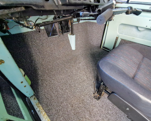

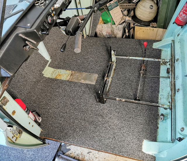

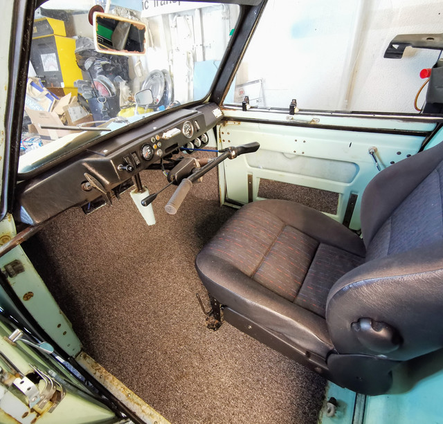

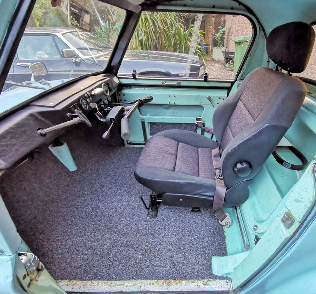

I think it's fair to call this is looking a bit more welcoming.
Here's a "before" photo for reference.
It's astonishing how a bit of trim can change the feel of the cabin.
The offside kick plate still needs to be secured, but I need direct access to that side of the car for that so it needs the rain to stop for five minutes.
There will be a few more bits to go in. To name one I'll be lining the door cavities in matching carpet, and the roof will get some at some point. That may well be a lighter colour and be actual automotive carpet though so it's easier to shape though...and will likely wait a while as removing the roof will make lining it massively less awkward.

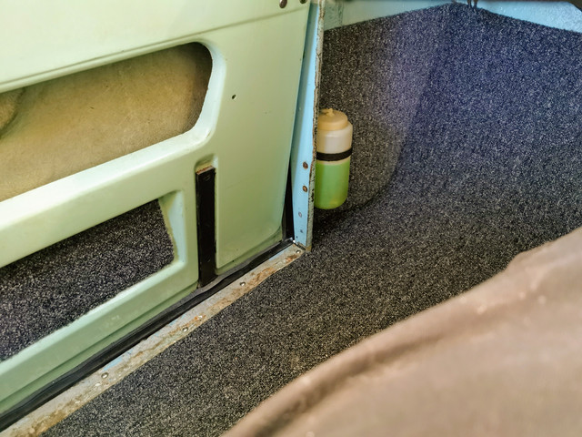

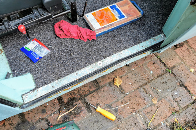

After attending the funeral of a friend this morning I found myself with a couple of hours free this afternoon so I decided to try to crack on with getting the offside kick plate sorted.
After a couple of hours of hitting things with hammers and swearing at it we had the kick plate in place. Once I got the bolts in I was able to pull the kink out at least. They'll both want to be stripped and painted but that's a job for another day. Will be a hammered black finish we'll go with to match some of the other details in the cabin.
Then the seal was reattached. These will be changed for tubular section seals at some point as I reckon they will work far better.
This was the last part of this project which involved stuff being apart so I was able to remove all the tools and nonsense from in the car and put things back together again. Longest job there was finding the seatbelt which I had helpfully hung over a hook on the garage wall...right in front of my blind face. Took me half an hour to spot it. Idiot.

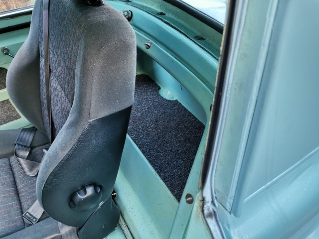

From the previous round of work I noticed that the side "cheek" behind the windscreen washer bottle clearly had lifted while the adhesive was curing before (lack of patience on my part likely to blame as it was the last bit I fitted). So this was peeled back re-glued and was left with a screwdriver wedged behind the washer bottle for half an hour or so to keep it sitting flush. Sorted.
While I'm calling this job fundamentally done there are a couple of bits which will want a little further attention.

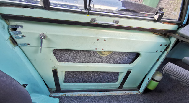

[] Door cavities. To match the visual aspect of the rectangular cutout at the base, and to help cut down drumming from these pretty large flat panels.

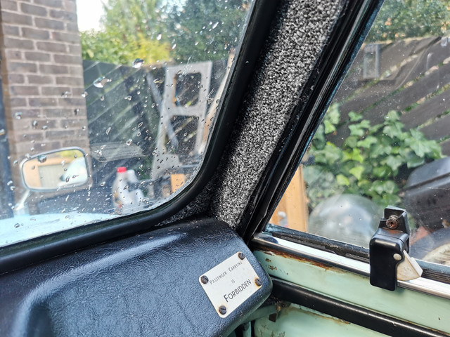

[] I may also do the windscreen pillars as the black semi gloss paint on there is *really* bad for reflections when the sun is even vaguely low. Plus the metal is quite pitted in a few areas so it would look tidier.

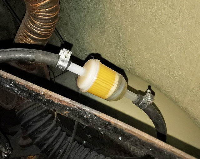

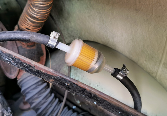

When I first started the car up it became apparent that the carb was lacking a working idle circuit again, presumably due to a bit of grime finding its way into the (tiny) idle jet. This cleared after a few minutes of running thankfully...but the reason it happened quickly became apparent.
If you look closely you can see the metal cap over the end of the filter element in the fuel filter has broken away. I'm really getting hacked off with how hard it's getting to find decent quality consumables these days. Think I'll see about getting some filters from a marine specialist as I did with the fuel lines, being a more safety conscious field hopefully the quality control will be better...

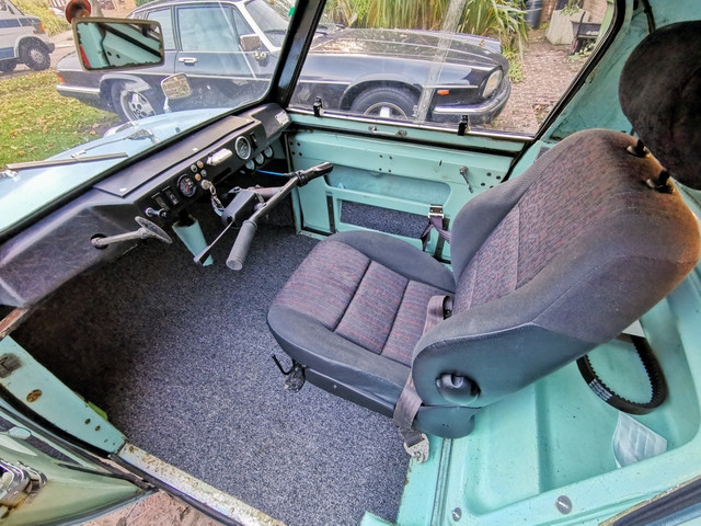

I think I can now say that Phase 1 of the Invacar retrim project is complete.
Having been out to run a few errands today I can definitely vouch for the fact that the general noise levels have been vastly reduced. By far the most annoying thing in that regard now is the nearside door which rattles quite a bit. I think if we get some better seals in there I'm hoping that might improve things in that department, we'll see. I suspect that there's a certain element of "they just do that" due to the design though. As it is though the car is far more pleasant to travel in now than it was.
Phase 2 will be lining the roof and replacing the cracked dash moulding with my spare one...not sure when that will happen, but likely a job for either the depths of winter or early next year I think.
I'm quite pleased with how this project has turned out, especially as I've never done anything like this before.

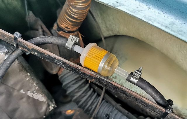

Additionally the fuel filter which had fallen apart internally...
...Has now been replaced.
I have a glass bodied filter which can be serviced on the way as I'm guessing all of these filters in the bag are likely as bad as each other.

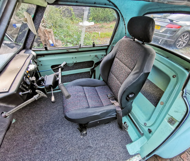

I noticed last time I was out in TPA that there seemed to be a bit more wobble in the top of the nearside door when I closed it (you need to give it a good old slam, and that puts a lot of strain on the top of the door because of where the pull handle is - usually I open the window and pull on the door top for that reason, but it was raining hence not wanting to open the window!). A quick check today revealed that the rearmost bolt through the window runner into the door top was loose. Not sure if I just didn't tighten it enough of if it had just worked loose. For good measure I added a shakeproof washer before I put it back together today. I will need to try to convince everyone for the next few days that I've not been self harming...Just reaching one of the most awkward fasteners on the Invacar! You can see why they used rivets originally.
Now the interior of TPA is looking so much tidier it's really starting to show up some of my earlier bodges. Especially the "repair" for the split in the top of the nearside door.
I'm open to suggestions for the best way to repair this. I was reluctant to use glass fibre/resin at the time as this goes right down the hole for the rear latch, and is directly above the latch mechanism and the last thing I want to do is goop that full of resin! Especially as this is the door that I actually use as the other one has issues with the runner. If it was on the other side I wouldn't be quite so bothered!
Yes I fouled up the measurement on the bit of carpet at the base of that door. I've got another piece cut out in the right size (actually measured with a tape measure rather than eyeball) waiting to go in. I didn't realise how bad it was until I saw the photos.

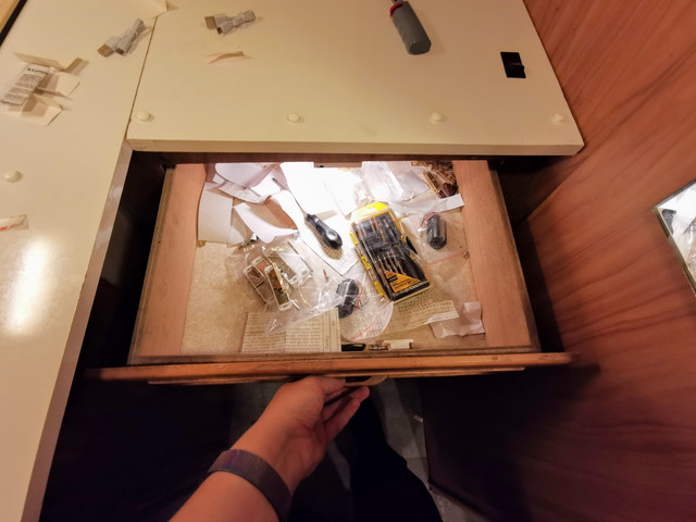

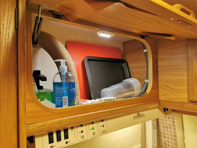

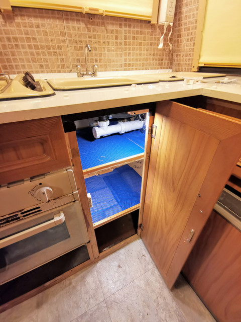

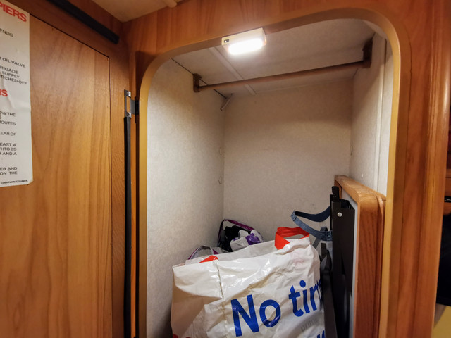

I stumbled across a box of things I bought a few weeks ago for the van and promptly forgot about. Some little self contained rechargeable lights which have IR sensors so they can detect when doors in front of them are opened. These have been deployed in the kitchen cupboard and a couple of lockers which are kind of black holes without illumination. The results speak for themselves I think.
They have magnets in the back and just attach to metal plates which stick or screw in place where you want them to go. The package quote something like three months of runtime on one charge. I've little interest in that, this is the sort of thing that we'd just make a point of charging them before we were actually going out to use the van for camping.
Under sink cupboard is probably the biggest gain.
Really quite impressed with them to be honest. £11 for the set of six I think it was from Costco. As with most things from there, they feel really well made.
