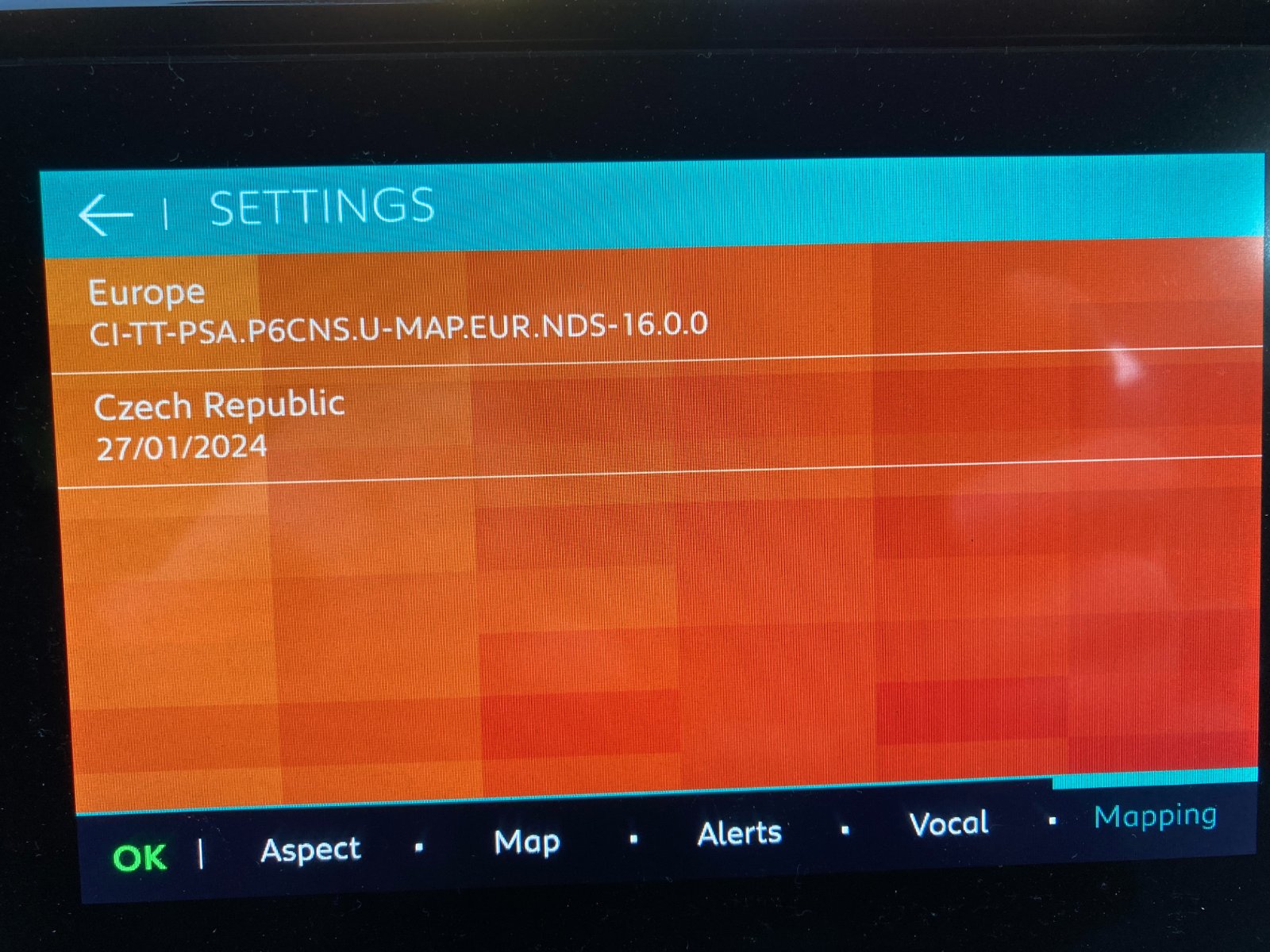

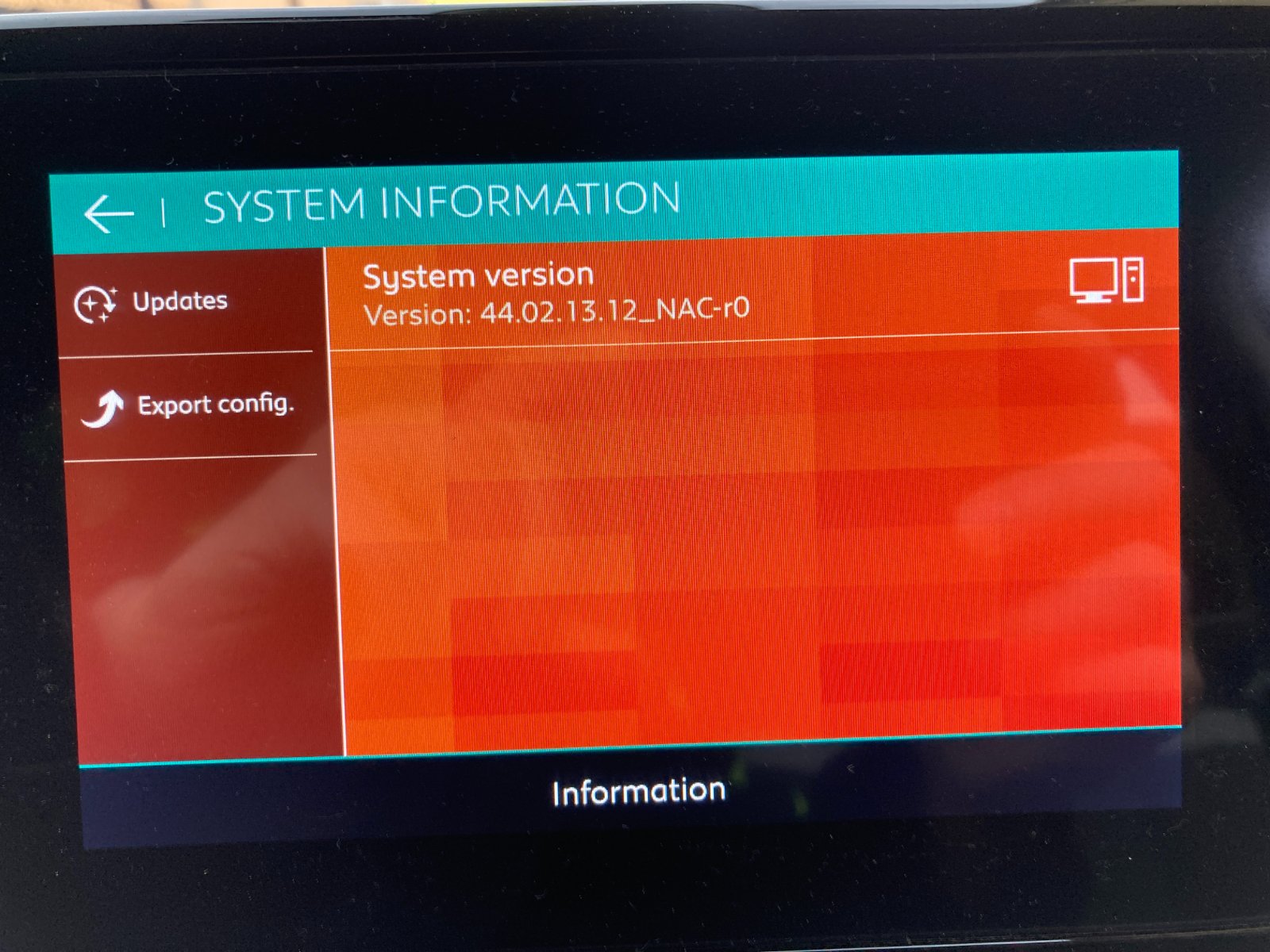

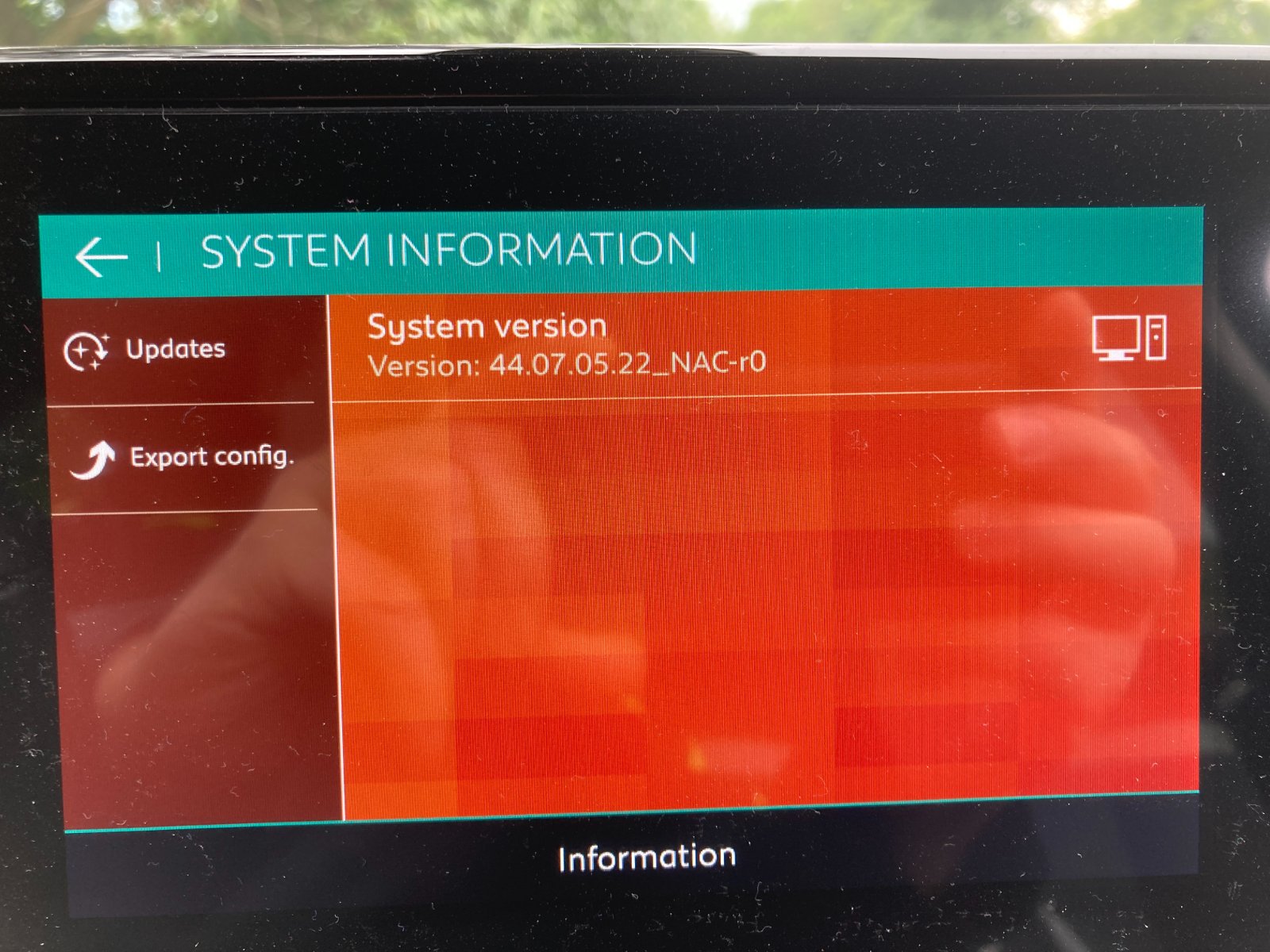

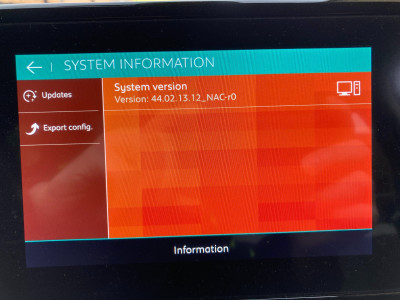

Marc, thank you very much,
with your help and the 44-02-13-12_NAC-r0 file, I successfully bridged the Wave 3 to Wave 4 firmware.
After that I installed the last firmware 44.07.05.22_NAC-r0 directly without any problems.

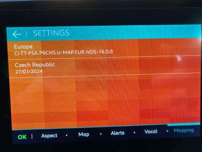

And finally I installed one map (16.0.0) size 196.1MB also without problems, it took 28 minutes.
Next time I will try to install all the maps. I hope it doesn't take much time.
I think all those map files are always copied to the internal memory.
Once again, thank you very much.
