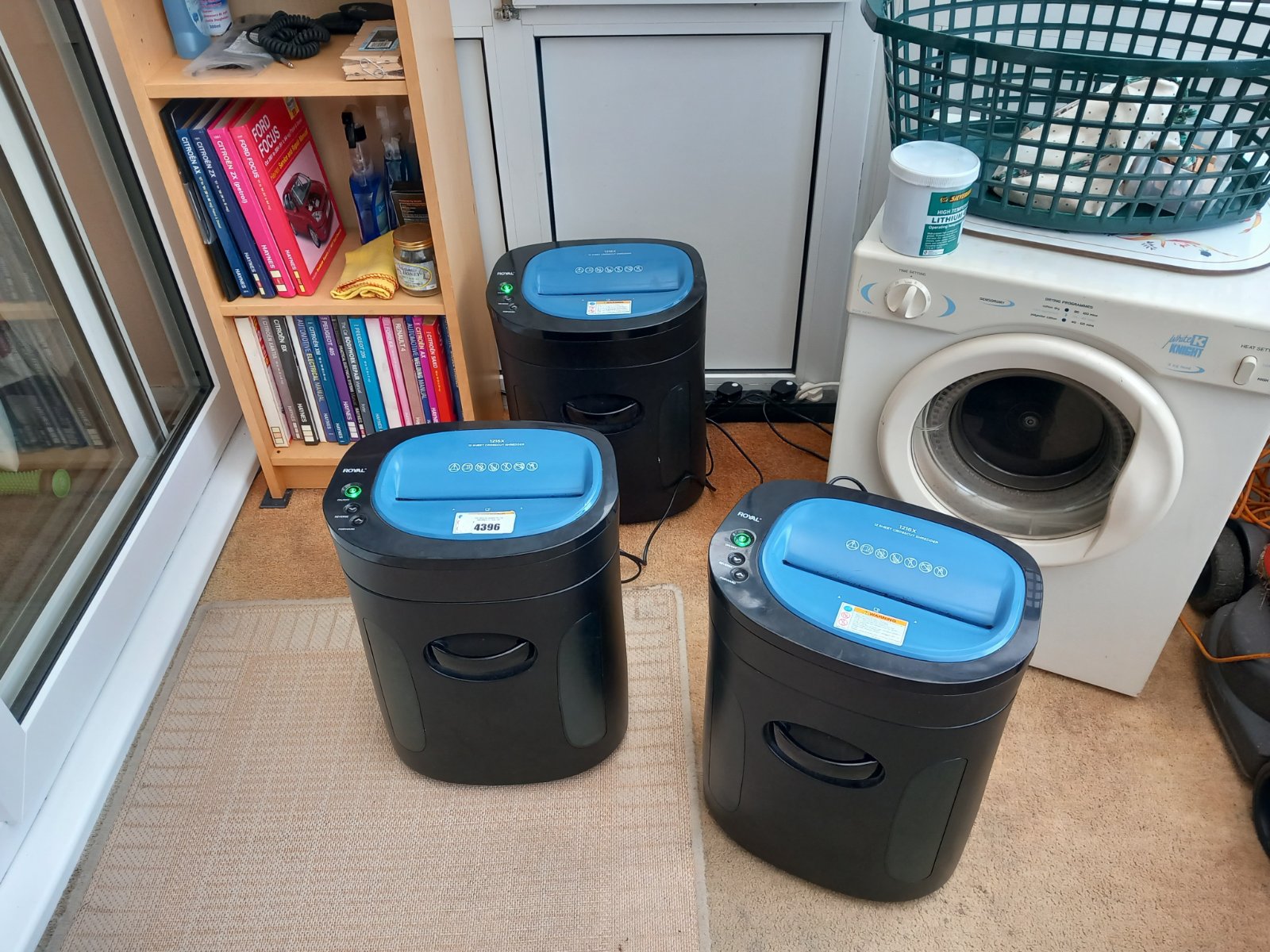

The three shredders in all their glory...

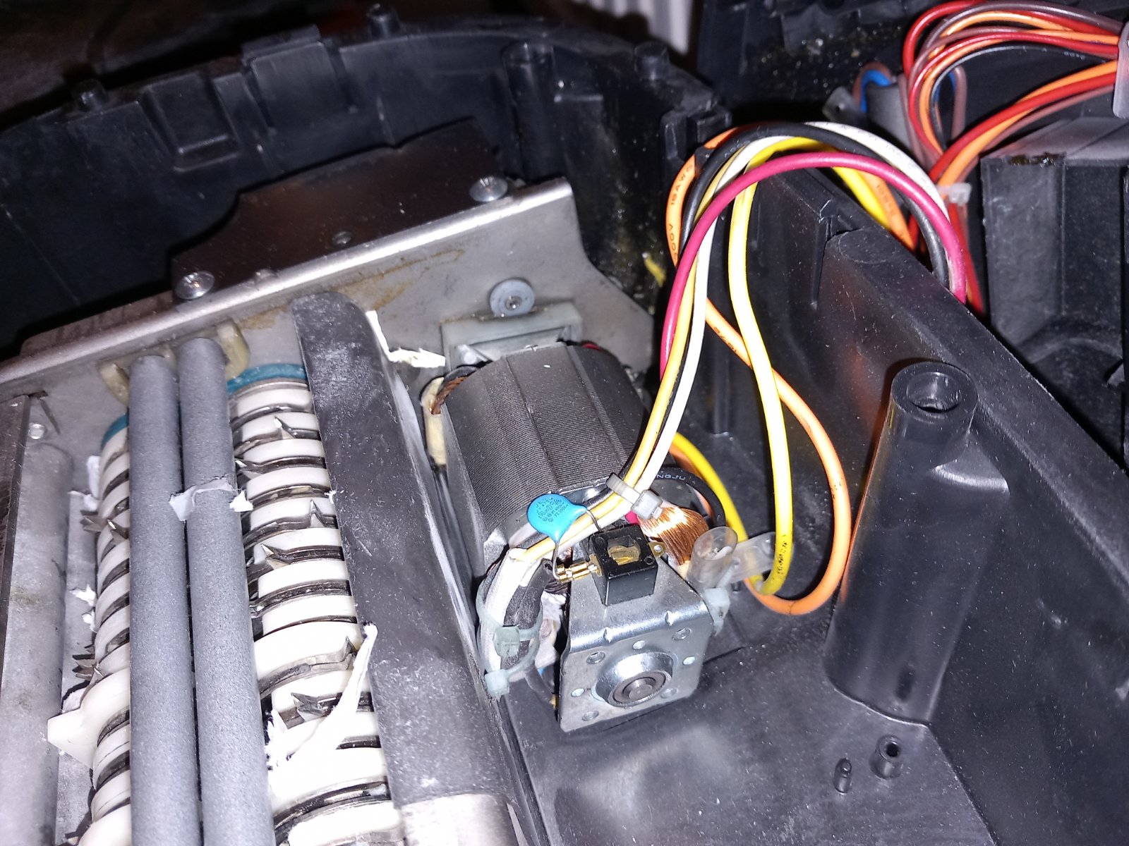

And one of the bearings, showing no wear
