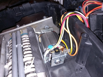

Way back in this thread I posted a bit about some dead shredders with duff gearbox bearings and my adventures in finding suitable materials to make some new ones.
This project went on a far-back burner as other projects took priority. Yesterday and today I have had a bit of time to resurrect this project.
To recap, aluminium was rubbish, brass wore surprisingly quickly and phosphor bronze was good but a 'mare to turn on the lathe.
I now have three shredders working reasonably well. One with a combination of phosphor bronze and original bearings, one with brass - which I know will not enjoy a long life but will be fine for light domestic use - and now, as a further trial, one with hard nylon bearings.
I turned them using Nylon-66, the same stuff as I have used in the past to make Xantia Activa rear ram bushes. Prima-facie it is as close to the original bearing material as I can tell.
This material will be given a stern test tomorrow when a mountain of shredding will be put through it. If they're good, I may retrofit the other two with hard nylon bearings.

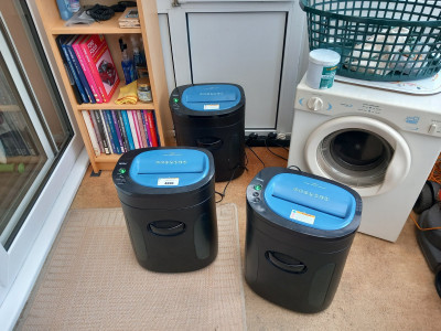

The three shredders in all their glory...

Here's the proof
And one of the bearings, showing no wear
We did find the motors don't like continuous duty. They get very hot and loose power. They're fine once cooled down...
So now I'll make sets of Nylon-66 bearings for the other two...
The three shredders cost a tenner. I must have spent at least twice that on experimental bearing material
