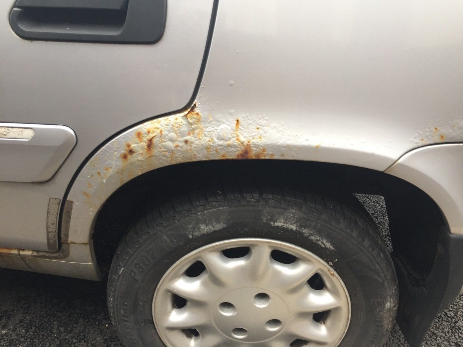

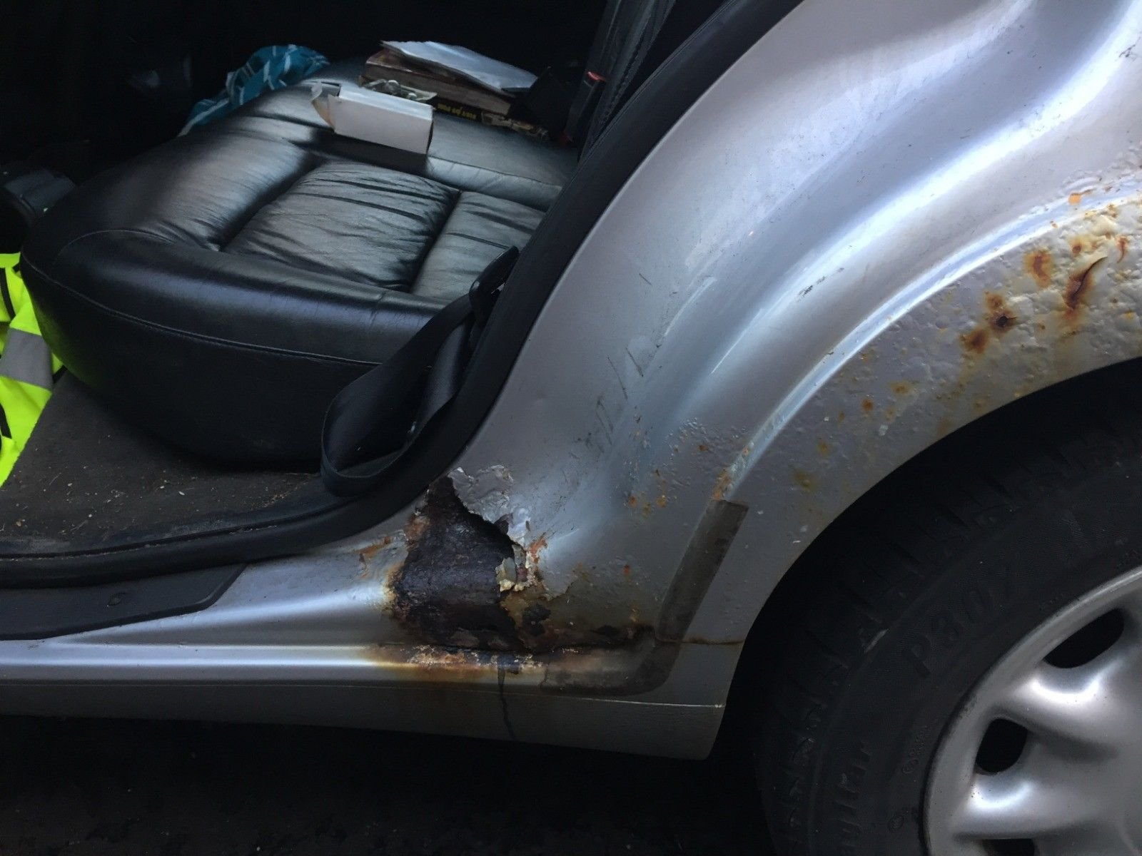

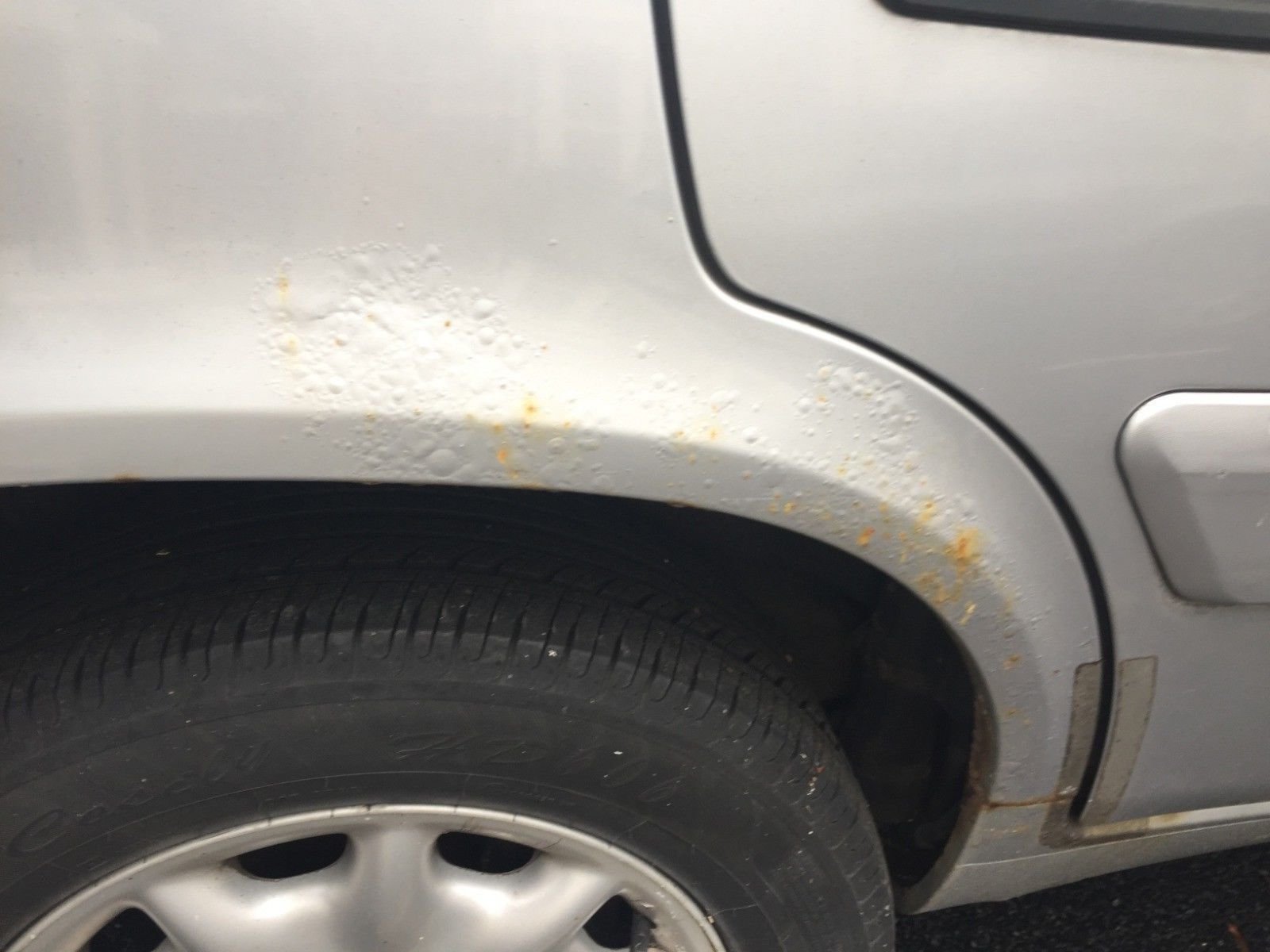

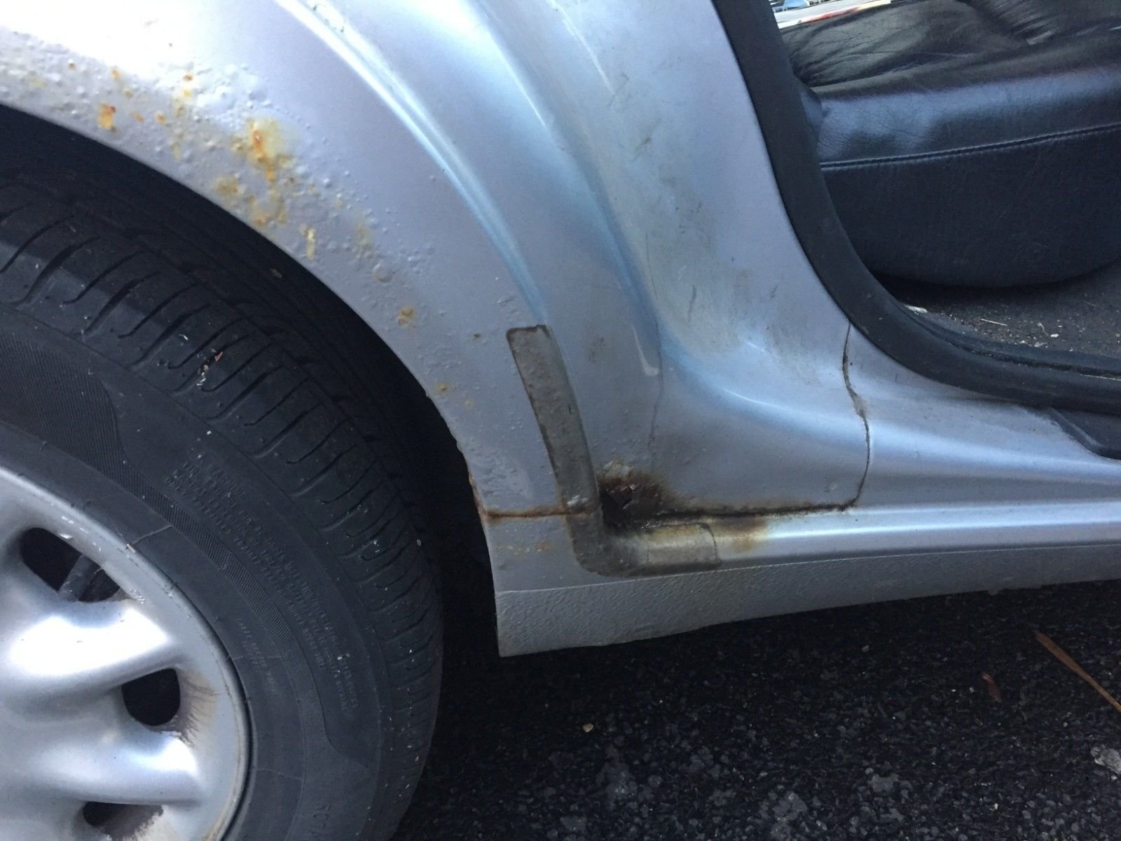

Stickyfinger wrote: 30 Nov 2018, 11:14 Post an image of the rusty rear arches, there are a number of reasons for them to go.
This has been bugging me ever since my initial response, because I knew I'd done it before. Anyway, here goes:-

That is due to the open rear wheel arch and inner/outer wing sealant/adhesive, normally very extensive rot takes place before it shows. I hope you are lucky but budget for a bad result when you start looking.
Go in via the boot, remove the carpets and the side wall carpets, look into the inner wing area.

Not very encouraging - but better to be prepared. There had been structural issues in recent years but that's supposed to have been sorted at Chevronics [vendor was a fan - & a good customer (looking at some of the other bills)].
If that's all that has been wrong AND I'd got it for the silly money I'd hoped to I'd intended to get it done early on. Now it has to prove itself - & endear itself to me over the coming 11 months, say; then I'll think about whether I really want to spend that sort of money on it.
