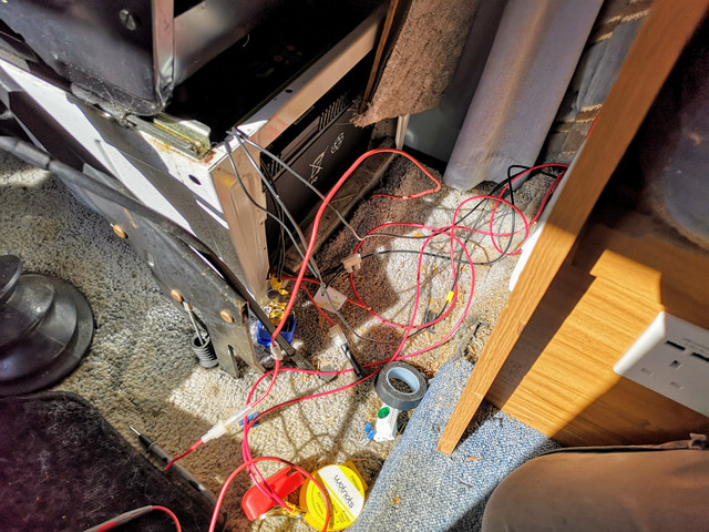

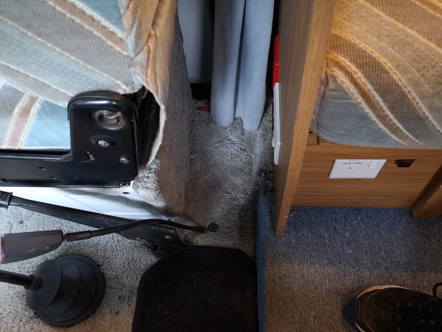

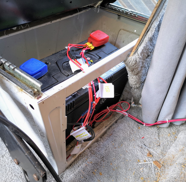

Right...for the best part of the last two years I have been trying to ignore this mess.
I had already pruned quite a bit out of here by the time I took this photo.

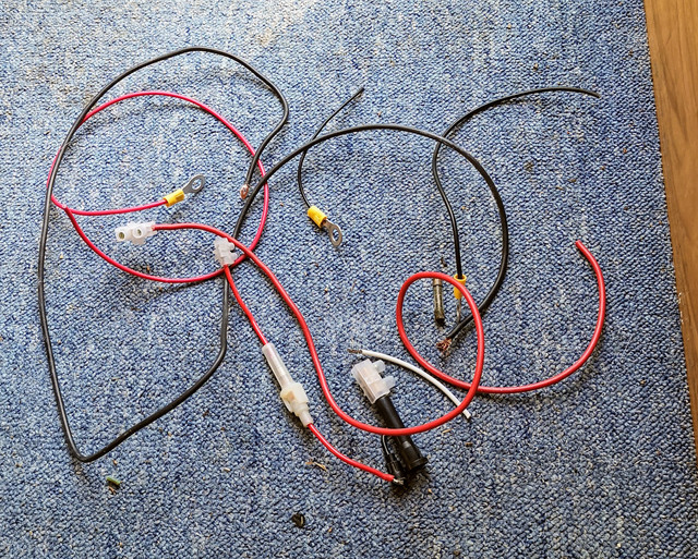

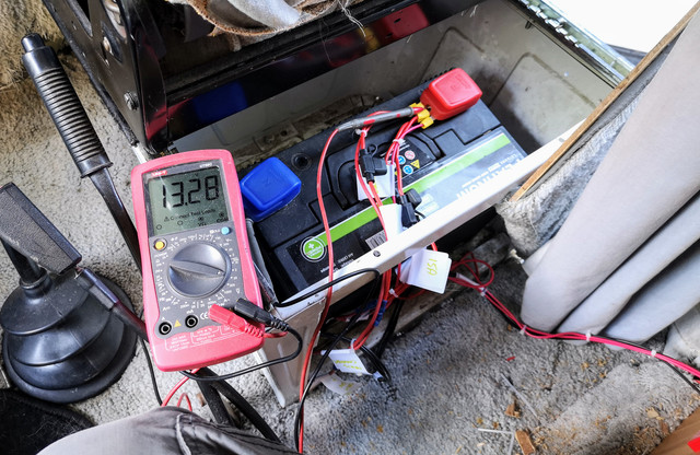

After a couple of hours of multimeter bingo I'd figured out where *almost* everything went. We've still got one mystery red wire. That has been left disconnected and safely terminated until I figure out what (if anything) isn't working. It's quite likely the answer is "nothing" as there has been a huge amount of bodgery going on in here. I've pretty much decided that this side of things will be gutted and rewired at some point down the line. Because everything disappears into (by this point in time very brittle) ducting the moment it appears under the floor it's nigh on impossible to follow anything without some pretty major destructive surgery.
It's still hardly pretty...but everything is securely connected, is labelled and is sensibly fused.
I'd really like to know where all the ground wires come from as it seems utterly unnecessary...it wouldn't surprise me is 50% of the voltage drop we see when high power things like the water pump are used is because the ground lines run the full length of the van and are unreasonably skinny. I may well see if I can improve things in that department a bit.
While tracing the wiring out I did find continuity through to what appears to be the split charging relay in the other battery box.

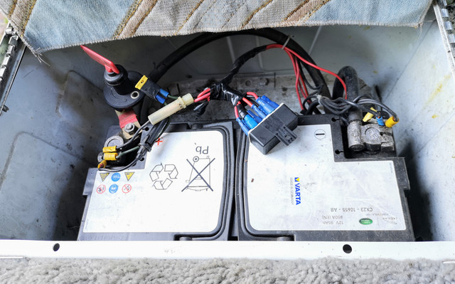

The split charging system has never worked since I've had the van. This far I've never really done much to investigate this as it seemed a bit of a lost cause given the state of the spaghetti surrounding the leisure battery. Having sorted that out though it was worth a look.
Turned out the 5A fuse in that white fuse holder, running to one of the coils in the relay had blown. Not sure how that could have happened...though given the degree of messing around I've seen it could have been hooked up wrong at some point. Replacing the fuse and starting the engine resulted in...
Yep...the split charging system is now working again.
I need to route this lot under the floor to the battery box at some point or enclose it in a little duct to tidy things up. Once everything was back together and we'd gone over everything with the vacuum cleaner looked a bit tidier.

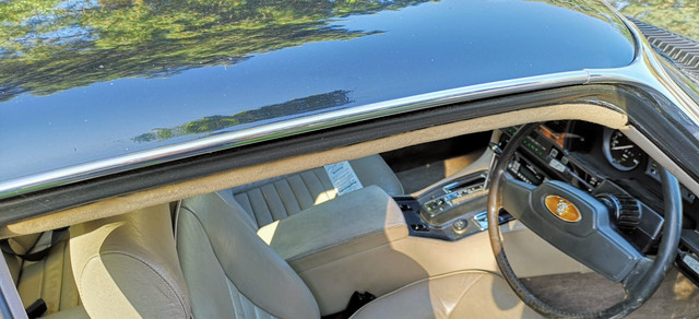

I also finally lost patience with that bit of trim over the door on the Jag coming loose and attacked it with some spray adhesive today.
Hopefully it will stay stuck this time.

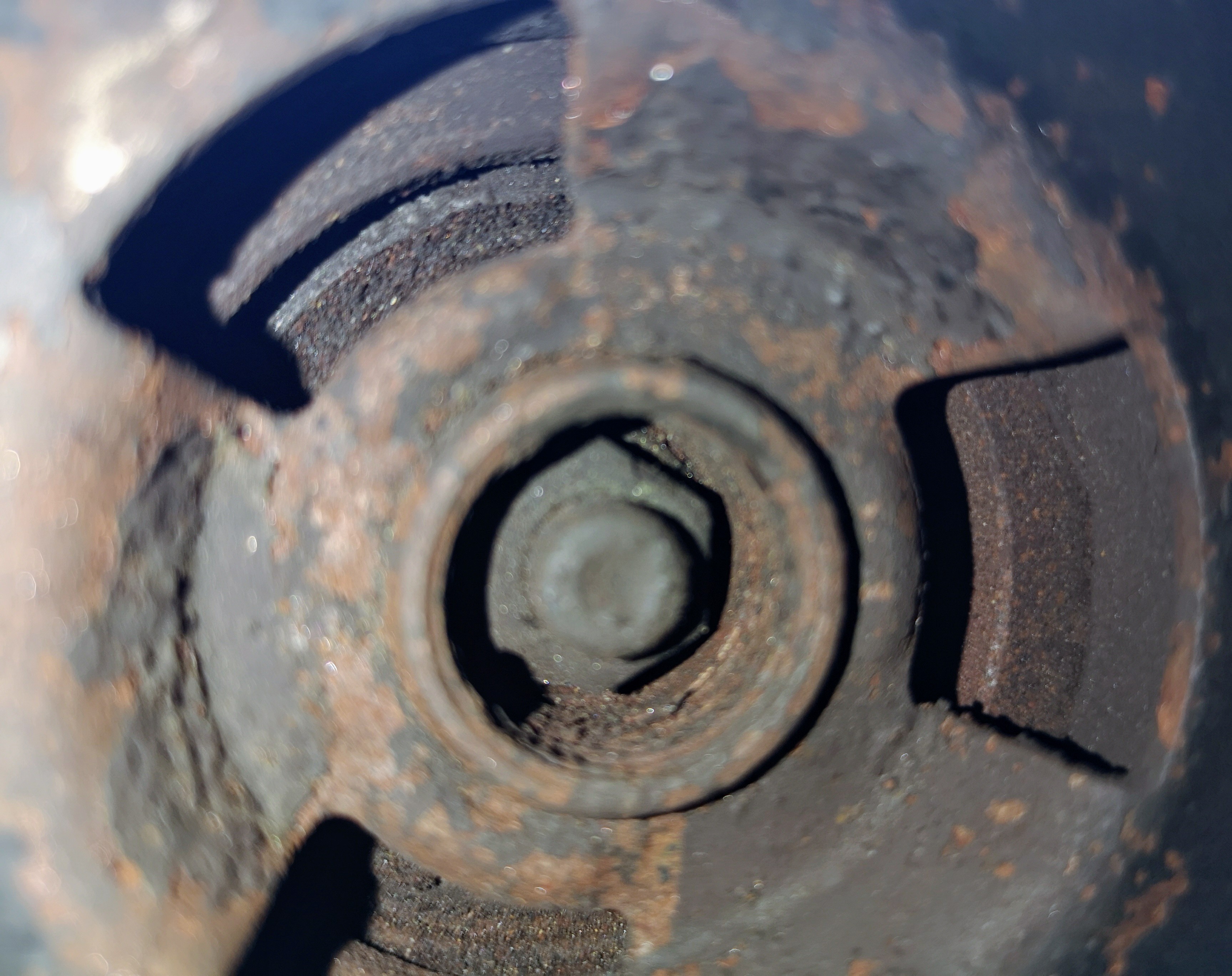

Getting the 14mm nut off the compressor pulley involved downright alarming levels of force but did eventually crack off.
Unfortunately that is as far as I got as apparently I finally need to actually buy a puller. The clutch assembly is well and truly stuck on the compressor shaft. Old school levering and swearing isn't going to cut it this time.

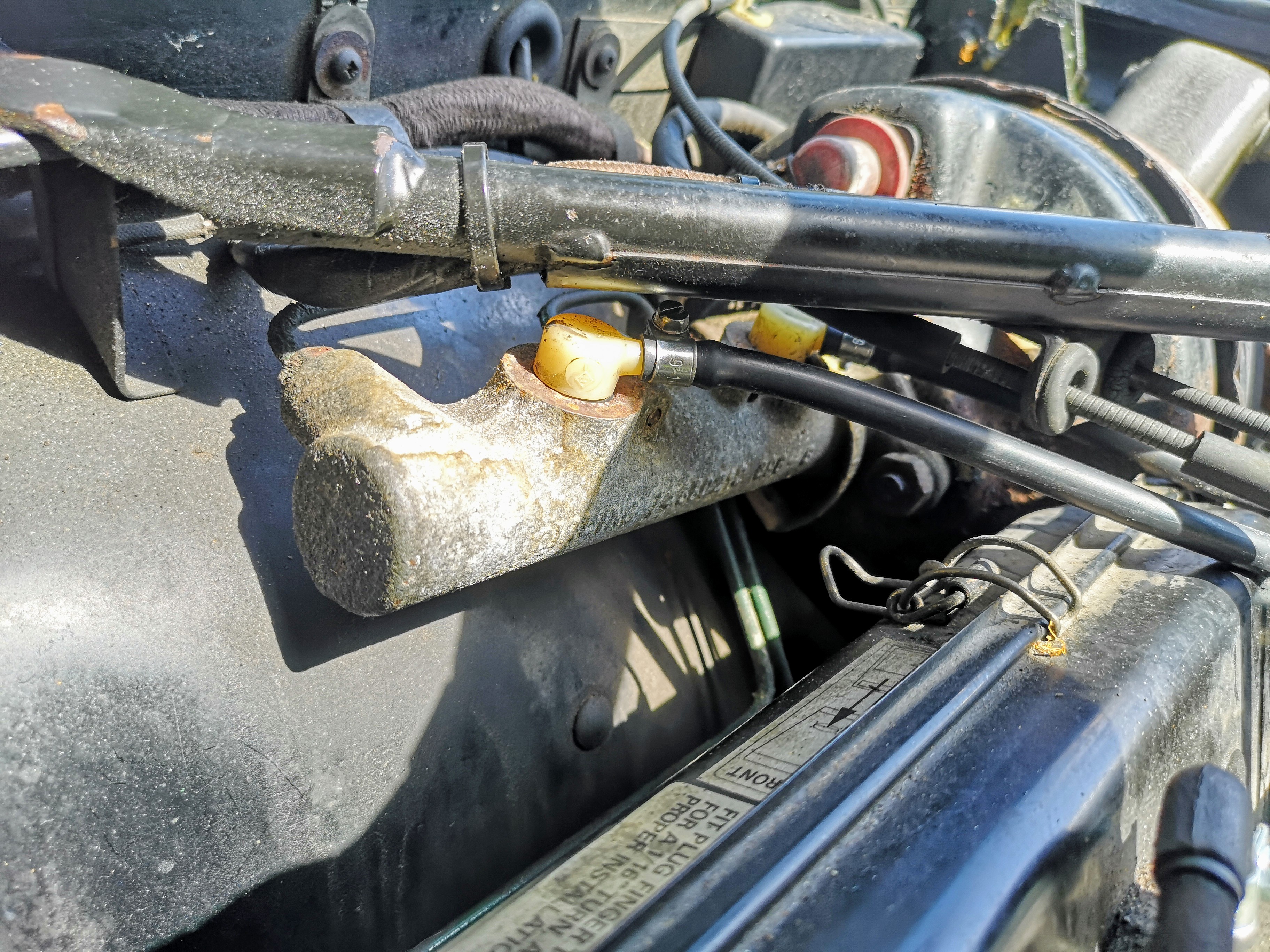

On the plus side the brake fluid leak does indeed appear to have been sorted by fitting the new hoses from the reservoir. Still bone dry now.
At least that's one thing I can tick off it looks like!

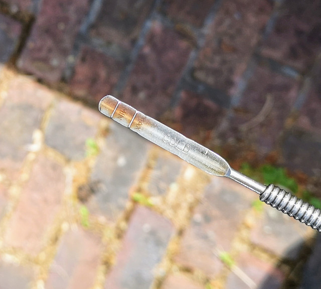

First was a general fluid etc check. I didn't expect anything to have moved on anything aside from the Jag, but everything on that is treated with complete suspicion at all times. Especially given how much oil it appears to leak.
Nothing had moved...to be honest, as usual. Had been meaning to properly check the gearbox oil for a while though beyond "there's some in there."
Can't complain there. Slightly high reading is expected due to the slope of our driveway.

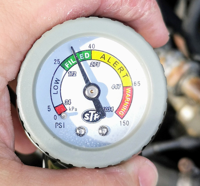

Had a look at the A/C, I left it with about 35psi in it after nipping up the leaking hose clamp a couple of days ago.
That's an improvement...it was down to about 5psi after this time last time. I really need to find my proper gauge set. It's in the garage somewhere. Will check it again in a week and see if the gas has continued to stay put.

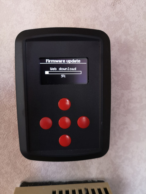

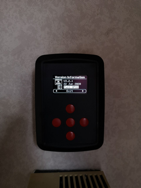

The only other thing of note today was spotting the heating controller in the van flashing at me that there was a firmware upgrade available - and being web connected meant that with a couple of button clicks we had the upgrade on the way.
...And done. 3.2.1 is the current version.
If only all modern technology behaved this well!

Things I learned yesterday: You need a special tool to wind off/on the clutch pulley on GM/Harrison A6 air conditioning compressors. A normal puller won't cut it, and obviously won't get the pulley back on - it's a friction fit on the compressor shaft, the nut is a safety feature rather than the main means of retention for the pulley.
If I'd used half a brain cell and read up on the job before starting I would have known that and made sure I had said tool in stock. It is now on the way, but if I'd used me head it could have arrived with the new clutch.

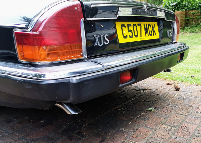

Following the rear silencer delete experiment I wanted to at least get a ballpark figure for likely costs involved, however it turns out that our local stainless specialist looks to still be closed. Fair enough to be honest, not really surprised. To be honest there's one over in Cambridge which I'm probably going to be using anyway as several folks have recommended them to me.
It's also about item 28374638 on the priority list. The horribly out of alignment tips had to go though as they made it look like I'd reversed into a low wall and made my OCD twitch every time I walked up to the car.
The only way I could make them sit even with each other resulted in them pointing upwards by about 20 degrees, meaning the system filled up with water whenever it rained.
The purists will probably hate me for it, but I reckon this both solves my immediate issue and actually looks better than the stock exhaust tip arrangement anyway.
No it's not stock, but I think it doesn't look out of place.
In my opinion, the spindly little double elbow looks right on the saloons, but something like this suits the XJ-S better.

Hmm...I appear in a moment of "I wonder if I could..." to have bought a big (way bigger than needed but it was all I could find locally) sheet of really easily malleable metal...I wonder what my plans for that might be...

Well that worked well...Mission Burble has been a success.
Well...refined rumble anyway. Burble is more of a V8 thing.
Pretty much what you want really. Quiet refined Burble at the low end, but proper howl above about 3500rpm.

I was thinking that having the tips pointing up might (with a bit of work) allow you to have a couple of tall roster tails when travelling at speed!

Downforce? With 425Kg of drivetrain up front we really don't need any extra downforce!
What was the deal with that metal sheeting then?

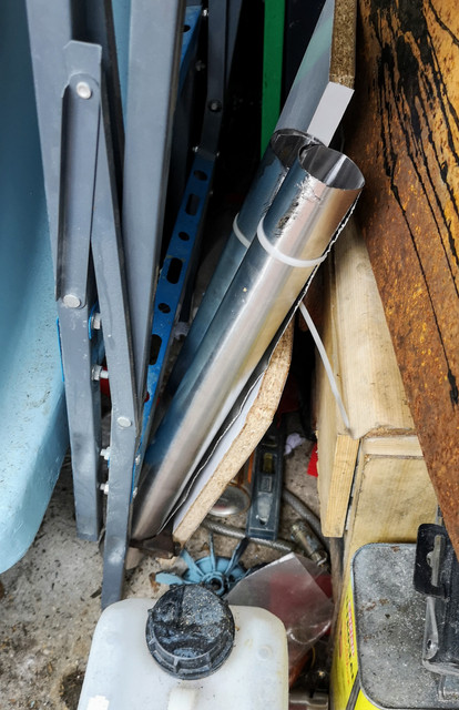

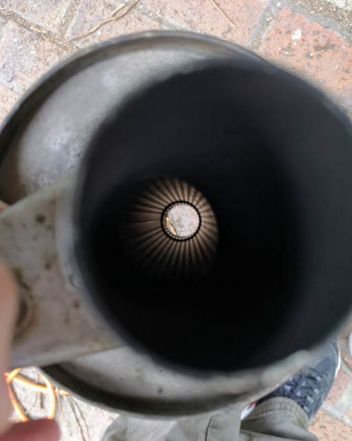

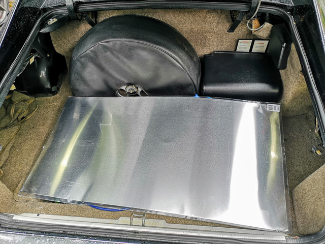

Well I noticed something when I last had the tail pipes off. They're just deresonators, so a straight through pipe with a perforated section surrounded by wadding. You can see straight through them.
This got me thinking...Could I be really sneaky and essentially just bypass the wadding by slipping a sleeve in? Longer term I do intend to have some proper straight through tailpipes made up...but with the world being a bit nuts at the moment it looks like it will be a while before that's really viable...so time to experiment.
This was just the rough cut, things were trimmed back to fit nicer before I actually tried this. I figured given the way things are designed it's dead easy to remove again (it only takes five minutes to pull the back boxes) it was a worthy experiment.
The plus side is that thanks to the shape of the silencer, the cranked bit is on the outlet...so the only way the sleeve can come out is back through the inlet side, so there's really no way that it could fall out the pipe while driving or anything daft like that. It does mean that section has lost about 0.75mm worth of cross section...but I doubt that really makes any difference...it's still about 10mm wider than where it passes over the rear axle.
The initial result was shown in the previous post, but later in the day I managed to get out for a proper test run.
I'll take that as a win! That's pretty much exactly the sort of balance I was after. A nice growl at the low end, a proper howl above 3500rpm, but no real drone at either 60 or 70mph which I was most worried about. I think the car sounds like it looks like it should now...
Yeah...I think we have our blueprint for getting something made up properly down the road.

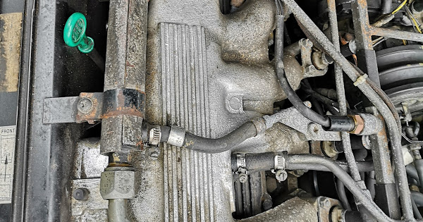

The ominous sounding ticking/chuffing noise has been identified. It's an inlet manifold leak right next to the injector for cylinder 6A.
I could tell pretty much for certain that it was nothing to do with the exhaust because it was coming from the wrong place. It seemed to be coming from within the V rather than the outside. Hence me wondering if it was combustion gases leaking by the plug or possibly signs of a leaking head gasket.
Then I noticed a bit of oily residue (because everything is covered in oil) that was "wobbling" in an odd way on the manifold to head joint just forward of the fuel injector.
I was just about able to capture this on camera, though access is appalling, because V12.
Reasonably sure this is the source of it as if I stick a bit of grease on the end of my finger and put it there the ticking immediately stops. Though this is the first time I've ever heard a leaky exhaust manifold like tick from a leak on the inlet side.
Well as the inlet manifolds are scheduled to come off as soon as the injection parts arrive anyway that should be sorted at the same time as obviously new manifold gaskets will be going on then.

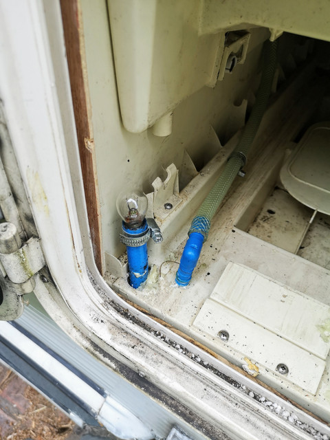

Got around to actually blanking off the water supply to the toilet in the van so that I can still use the sinks to wash my hands when I'm out with the dogs etc until I get around to sorting the leak. After scratching my head for about twenty minutes I eventually found something which was precisely the right size.
Slightly unconventional but it works! Still really irked by this fault as sorting it is going to require me to dismantle about 60% of the bathroom. Whether the toilet itself gets repaired or replaced will basically depend on how impossible to get into the casing it is. I suspect that rusted screws will be the order of the day. If it puts up much of a fight it will probably be replaced.

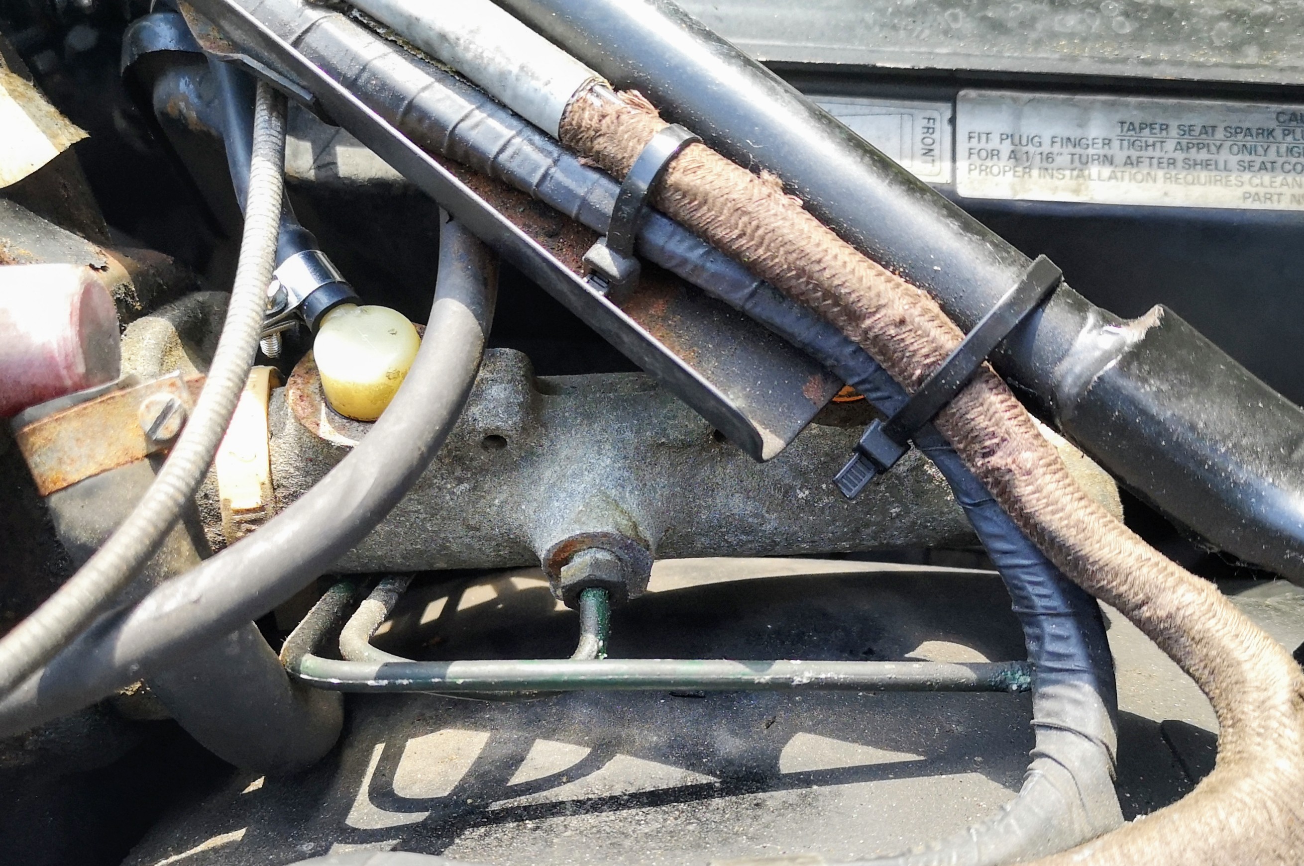

Have started to do a little bit of cleaning up in the Jag's engine bay while I was hunting for the ticking noise, just to make it slightly less unpleasant to touch. To be honest I really just need to hit the whole engine bay with the degreaser and pressure washer as there is just so much caked on congealed oil in a lot of places it's not even funny. The timing cover on A bank has obviously been leaking in such a way that it's dripped onto the alternator fan, which has done a fantastic job of liberally coating that entire quarter of the engine bay from sump to bonnet level in the stuff. Also explains why the belt keeps slipping!
There were a couple of obvious leaks I could easily do something about short term though - the PCV connection into the manifold on B bank had obviously been weeping slightly for decades, just isn't a particularly snug fit on the barb the hose sits on. One hose clip added to hopefully resolve that problem.
It's very obvious where I've given the inlet manifold a bit of a scrub around where the oil was..So the manifolds *will* clean up okay with a bit of a scrub. Just a shame so little of them is actually accessible!

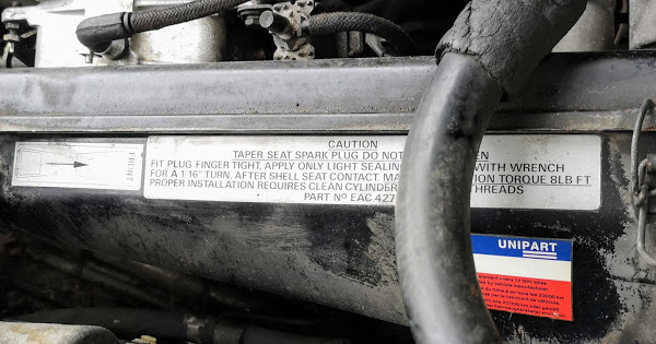

Information labels are mostly actually in surprisingly good shape under the grime.
The whole lot really needs a darn good scrub from top to bottom. I'll probably look to give it a going over once before I start pulling manifolds off as I really want to reduce the odds of me dropping gunk into the engine - though properly blasting all the crud off the lower areas may as well wait until after I've sorted the cam cover gaskets as I'm reasonably sure that's where about 90% of the oil is coming from. Though getting rid of at least some of it will help show up what's historic and what's still currently escaping. I've never had to actually top the oil up - but having said that it does take something like 11.5 litres of it so you need to lose quite a bit I imagine before it will show on the dipstick!
