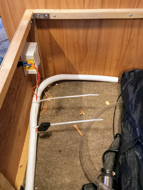

There are indeed far more bends than I'd like. Smells at least shouldn't be an issue as they're all downstream of the trap aside from the one actually at the sink outlet.
There is a great temptation to remove a bunch of that faff on the outside of the cupboard and replace it with a single 90 and single 45 degree elbow though.

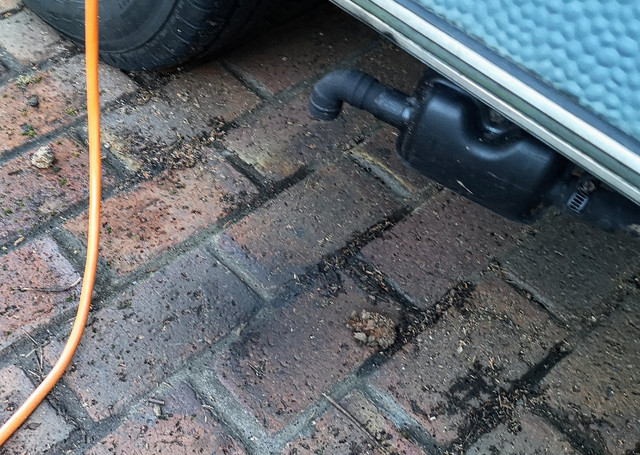

Well we will find out I'm sure!
Not surprised it drained somewhat slowly with the original trap in place, the inlet in the (now binned) trap dropped down to a 10mm square internally where it entered the bowl of the trap, so it was never going to flow well. It's worth remembering that it drops down to the old convolute line immediately after the vertical drop in the gas locker too.
You've talked me into trying to tidy up the pipework in there though...will grab a couple of angled fittings today and have a bash at tidying it up.

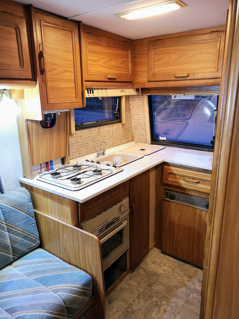

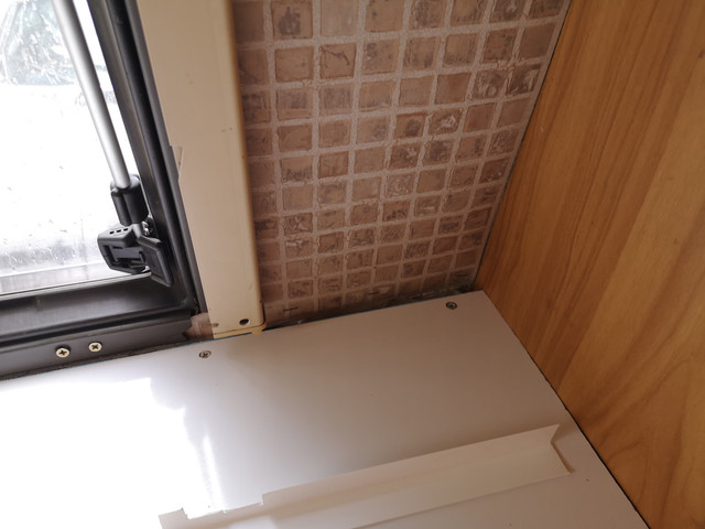

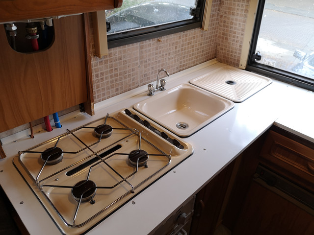

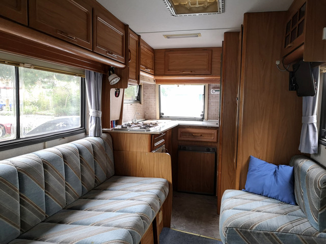

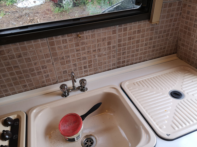

Finally we've made it to a point where all the heavy construction in the kitchen is done.
Few cosmetic things that still need to be done such as fitting these edging strips around the worktops.
These will tidy up a few of the gaps and rough edges like this (this bit was a particular pig to do as every edge of the space I was putting it into was off-square). It's just sitting here at the moment as I'll need to get some sealant to go behind it - and more edging as I currently only have one strip.
You get the idea. It will also hide the gap I've been left with behind the worktop on the offside due to the drop in height.
It's actually starting to look halfway decent in here I think.

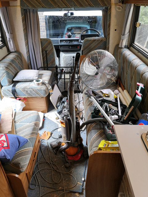

I had however created a certain amount of mess that I had to then tidy up!
It looked worse than it was though to be honest and half an hour had things looking far less manic. Jobs like this always make a lot of mess, but when you're working in such cramped quarters it tends to pile up even more.
I do still have a bit of a to do list in here, but it's all little things really.
[] Patch up dividing wall between the gas locker and under sink cupboard.
[] Dremel the ends off a few screws.
[] I'd like to tidy up the drain pipework in the gas locker. I reckon I can get shot of that triple elbow nonsense with an angled connector and an elbow which should flow better.
[] Apply edging at back of units.
[] Make a door for the cupboard under the oven (may make it a drawer actually as it's so low down).
[] Add proper latches to all the cupboard doors.
[] Paint inside the cupboards.
[] Cap off worktop retaining screws.
[] Wire up in cupboard lighting (waiting on arrival of parts).
[] Touch in paint on the draining board.
[] Give the sink a really good scrubbing to see if I can remove any of the stains in the bowl.
[] Fit some surface dressing on the cabinet faces/frame.
[] After a bit of actual testing of the kitchen we'll make a decision on whether to trim the edge of the worktop back at all. Once that's made I'll trim a radius on the front corner and apply the edging trim on there.

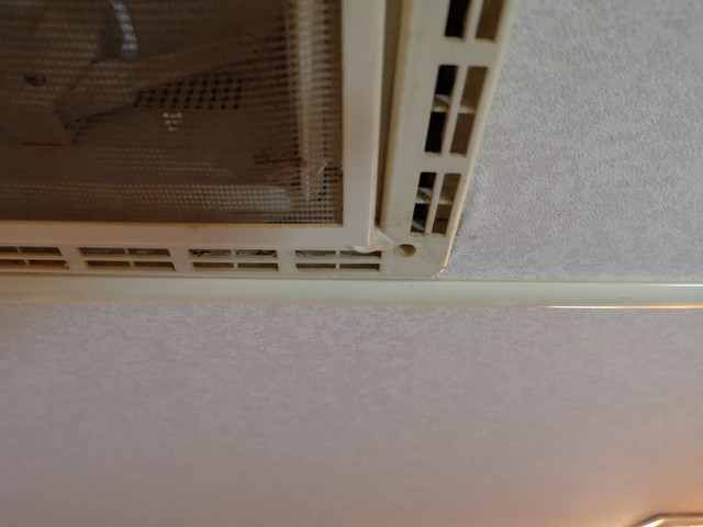

As any van owner will tell you there's a rule that you're never allowed to finish one job without finding another. While I was tidying up today I got dripped on. Right down the back of my neck.

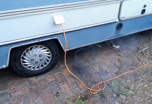

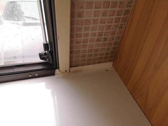

A bit of a search revealed water beading on the two forward edges of the roof light over the living area.
This roof light has already been noted as being worse for wear because several of the screws look to have been overtightened and it's cracked the frame as a result.
It was absolutely hammering it down today so if we were going to have water getting in at any time it would have been doing so today. Conveniently it's dripping off the frame in very specific locations so a temporary solution has been deployed. I'll need to move "buy and fit new roof lights" up the priority list a bit it looks like.
Despite the appearance of a leak I feel quite positive about what we've got done today.

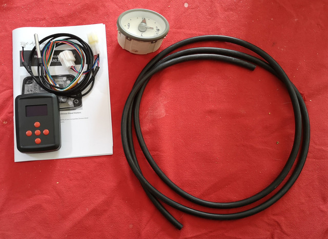

Yesterday I had a few things turn up in the post.
In here we have:
[] 1/4" EPDM hose to replace the leaky brake fluid reservoir to master cylinder lines on the Jag.
[] Afterburner Heater Control kit for the van.
[] A Series 1 Ford Ka dash clock just because I've always liked the design and I stumbled across one on eBay for £0.99 and fancy sticking one in a nice little case to put on my desk.

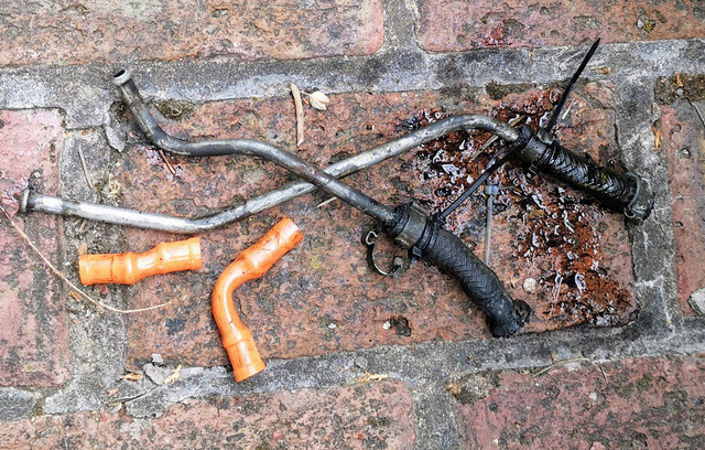

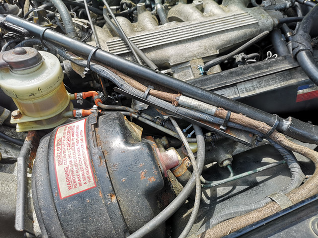

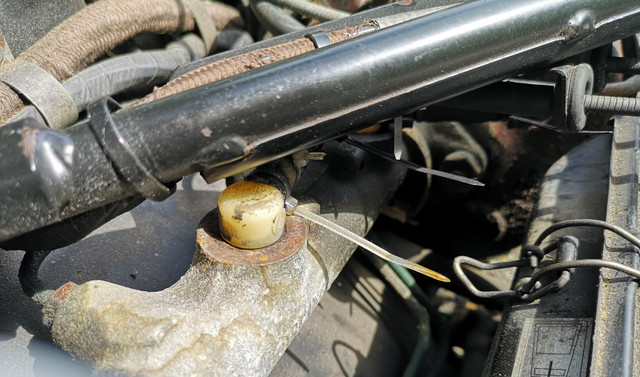

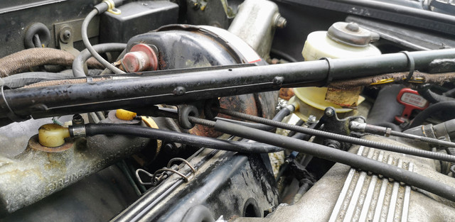

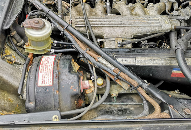

Our first task was to do the brake feed line on the Jag as it seemed a pretty simple job.
This is the overcomplicated mess that was on the Jag when I started out.
Small stubs of hose coming off the reservoir (I don't imagine the orange hoses are original), which then feed onto steel lines, before jumping to fabric braided hoses (which do look original) which connect on to the stubs on the master cylinder itself.
Looking closer the hose ends being the source of the leak was evidenced by the fact there was brake fluid running down the cable ties which I'd used to help stem the leaks a few days ago.
My intention was to do away with the metal lines entirely here. Too many unnecessary joints. There are eight potential points of failure here rather than four. So this lot came out.
With that destined for the bin (figuratively speaking...those metal lines will be cleaned up and definitely stuffed into the "box of potentially useful things" for future use), this is what replaced it.
I've sleeved the one where it's just sitting on the air cleaner housing since the photo was taken, I don't think it's likely to be a problem, but best to be sure.
Why Jaguar didn't just do this originally rather than messing about with those metal lines I've no idea. So far "because Jaguar" is the best I've got! While it's obviously not, I think this looks a lot more "stock" than it did.
Interestingly given that this didn't involve actually interfering with the brake system (I had the pedal held down while the hoses were changed), suddenly the car brakes a lot more evenly! It's always had quite a pull to the left on braking since I picked it up...but now it does it far less! So yeah...a full system bleed through definitely needs to happen sooner rather than later.
That was a relatively simple job, only made slightly profanity inducing because of the master cylinder being buried under that brace.

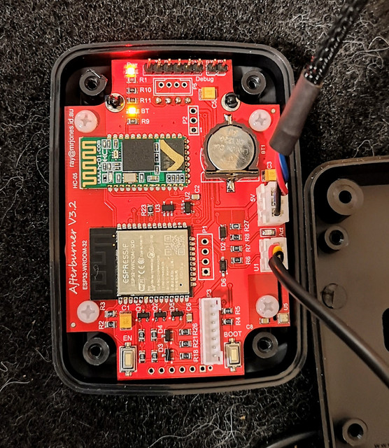

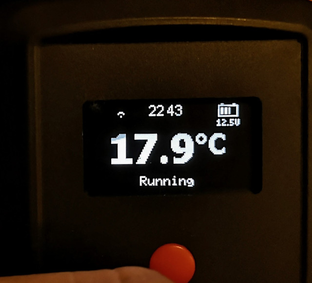

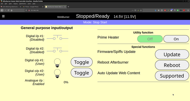

Next in line was a bit more of an involved job, fitting the Afterburner controller to the heater in the van.
The Afterburner, in case you haven't heard of it is a replacement for the controller that the Chinese diesel heaters which are widely available ship with. While the heaters themselves aren't actually bad the controllers are...sub par. This came to the attention of an engineer over in Australia who decided that this was a ridiculous situation, and took it upon himself to "build a better mousetrap" as it were. He reverse-engineered the communication protocol used by the heater and the stock controller and basically built a better one. In doing so (the design has been refined over a few years) has allowed in addition to far better basic control of the heater, addition of a far richer feature set including wi-fi connectivity, timers, frost protection modes, several GPIO channels which you can access, a humidistat, and a proper high quality temperature monitoring head.
The details can be found on the creator's webpage over here.

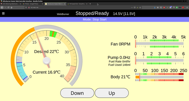

Looking at the back of the PCB it's immediately obvious that an engineer is behind this thing...Immediately obvious and labelled programming/debugging headers and a plethora of status lights blinking away at you.
When you initially hook it up you need to attach it along with the original controller (there's a socket on the harness for that purpose) to download the unit specific fuel tuning data from the original controllers. This is clearly documented in the instructions that came with the unit and took all of about 30 seconds. After this is done and the power is turned off the original controller can be unplugged and removed. I gave the system a good test with the controller just lashed up to make sure everything was behaving, got it hooked up to our household wireless network etc.

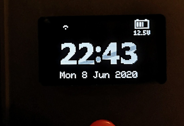

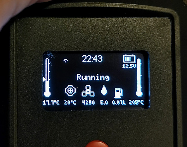

In these days where more and more devices hide away as much data from the end user as possible the data this little screen is willing to show you with one button press is refreshing...and has that look of "yeah, an engineer has put this together."
Quite a bit of data here...so here's the run down.
Doing this left-to-right unless otherwise stated.
Top row: Wi-Fi signal strength (it also shows additional network status messages there when relevant). Current time. System voltage & battery charge state.
Middle: Current running mode.
Bottom row: Current room temperature. Target room temperature (also shown by the arrow on the thermometer graphic on the left). Fan speed. Fuel pump rate in Hz. Fuel used since last reset. Current burner case temperature.
In recognition of the fact that everyone doesn't want to see all of this all the time, the home screen can be set to show either the current room temperature or the current time as shown below.
In addition to the data which the main system display can show in person...having this hooked up to your Wi-Fi network means that there's the ability to get data out of it that way. There is actually a web server running on there which you can access from anywhere on your network.
This gives you the ability to turn the heater on/off, change modes, adjust the thermostat etc remotely...which is pretty cool. You can access all the stuff from the GPIO ports as well, so the ability exists to turn things on and off in the van remotely as well if hooked up to this controller.
The Afterburner itself broadcasts a wireless access point as well (if turned on), so if you're away from home you can still hook up to it with your phone etc to get into this interface - probably the most useful item there is the priming option as that's a bit buried in the menus on the actual unit, and is something that you might want to access while standing on your head wherever the heater itself is buried in your van. In mine it's quite a ways from the controller.
Quite cool.

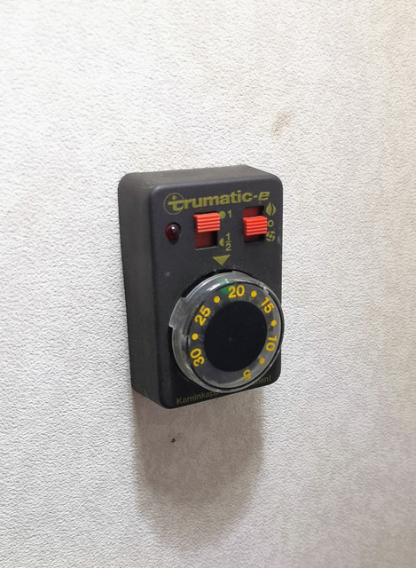

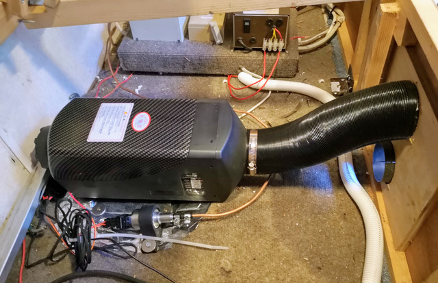

Having it working hanging out of the spot where I'd had the original controller was one thing...however I wanted to actually get it neatly integrated, ideally where the original heater control for the gas fired heater was. That looked like this by the way, which is why I chose the black and red enclosure for the new one as a nod to originality.

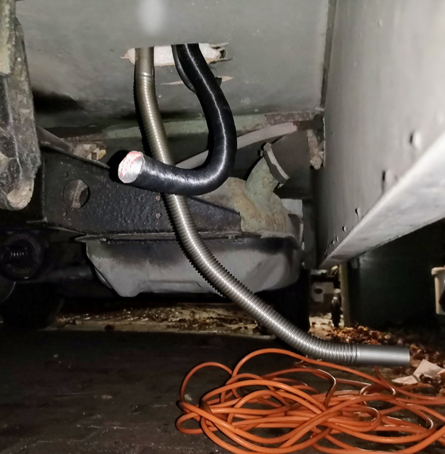

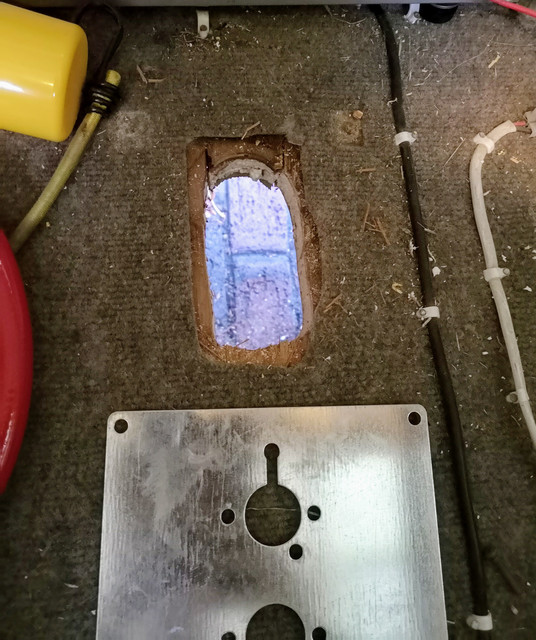

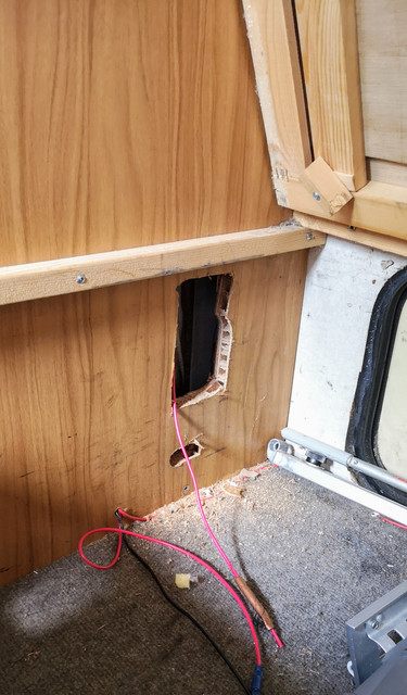

Getting this in was always going to be a bit of a pig of a job.

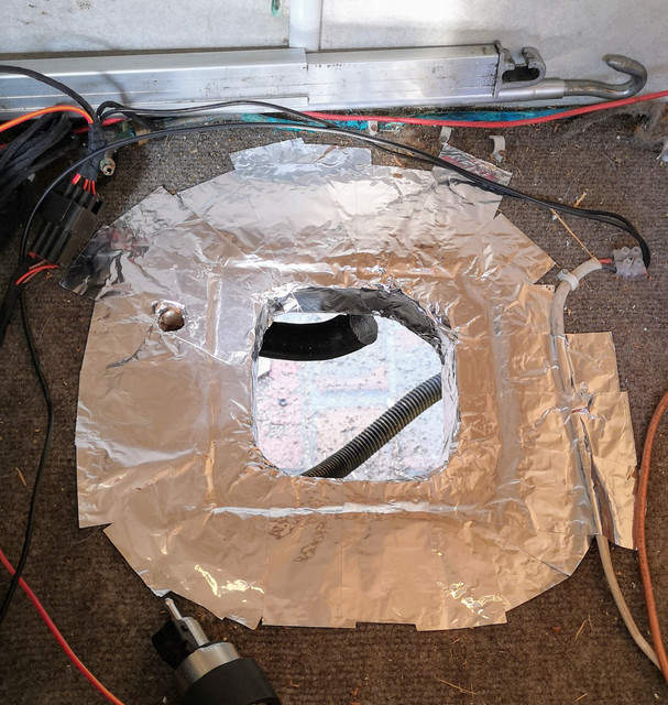

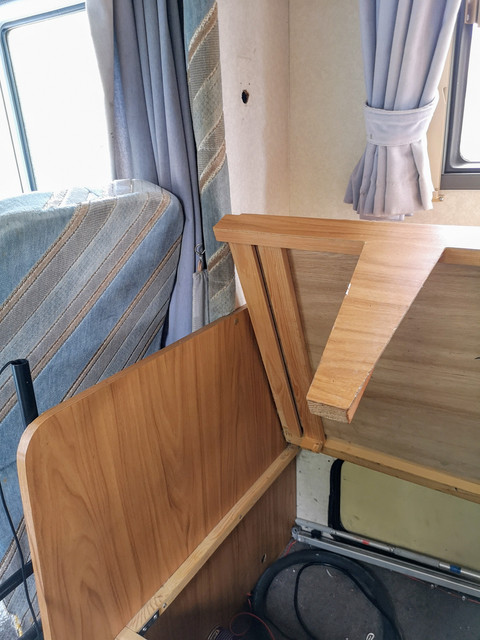

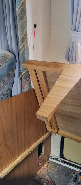

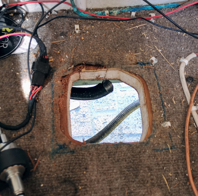

I need to get the cable from the hole down in the locker under the bed to the hole in the wall behind the driver's head.
This sadly wasn't as simple as dropping something in there and fishing it out. Firstly the plug I needed to get through was bigger than the holes, so they were always going to need to be enlarged a bit...secondly it had to come up from the bottom as the other end is tethered to the heater body.
What made this fifty times more difficult I discovered is that there is hollow fibre insulation material in the wall so even if you drop something in there it won't fall all the way down. I was able to with a bit of swearing and attaching a weight to the end of a bit of wire to get it about 3/4 of the way down but that was the best I could do. The only option I was left with realistically was to cut an access hole at the bottom that I could get my arm or at least my hand into to try to get hold of things to pull it past the insulation.
You can see here the red wire going in the top and out the bottom - I wedged a bit of pipe I found laying around in the locker on there as a weight to help it drop down inside the panel and to be something big and obvious enough for me to get hold of when hunting for it inside the wall cavity.
While cutting a big hole in the wall wasn't ideal I'm not too bothered about it. This is within the locker under the bed so making a perfectly functional cover will be easy, even if it's not maybe invisible. Additionally, I will be wanting to install a junction box here to allow connections to the additional input/output options from the controller in the future anyway - so that can also cover a significant portion of the hole.

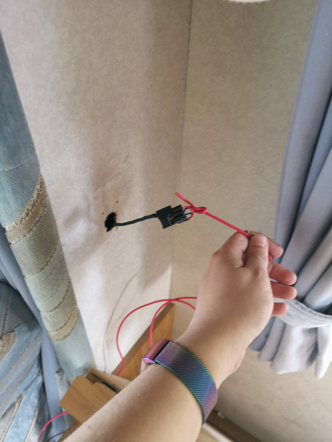

I was then able to hook the heater loom onto this wire and drag it back up through the wall cavity (after enlarging the hole very slightly so it would fit).
Bingo!

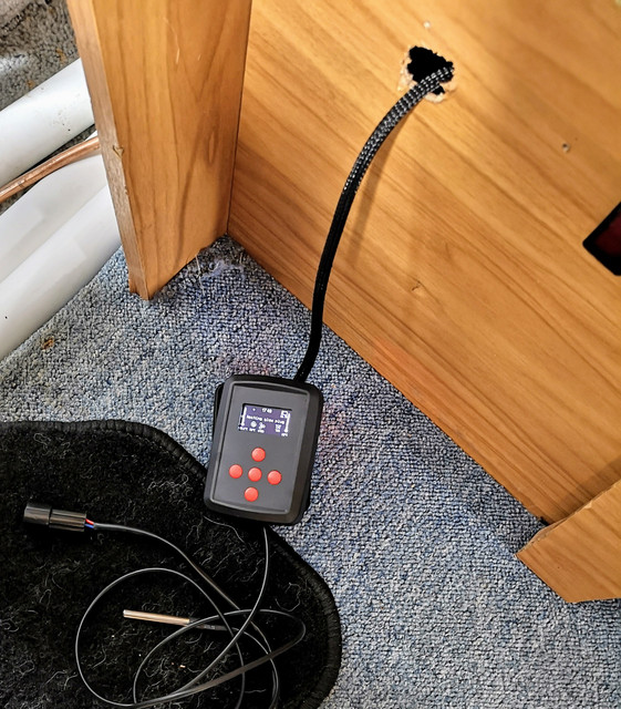

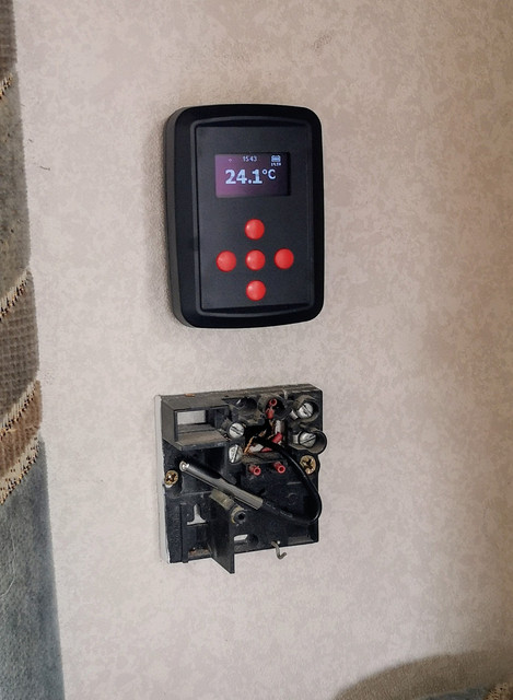

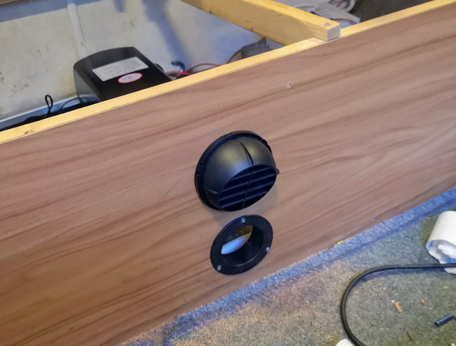

Then it was a simple matter of attaching the new controller to the wall. Oh...and figuring out where to put the room thermostat. I had a brainwave at this point, remembering that when I upgraded the thermostats in the house to wireless programmable ones I kept hold of the housings that the sensor heads used to live in. Being made to house a temperature probe they would obviously be designed to handle airflow correctly etc...and being from 1981 when our house was built, would look at home in the van.
Temperature probe fitted nicely into the enclosure sideways. A small cable tie around one of the posts in there will make sure it can't work loose and rattle around.

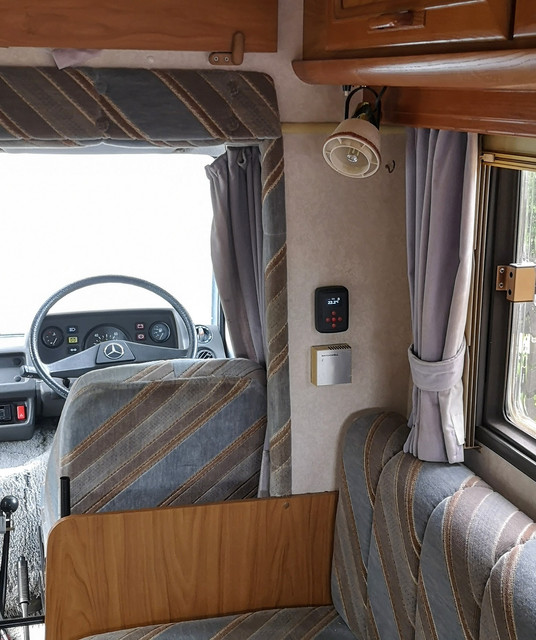

With the cover refitted I think this looks absolutely like the enclosure could be original to the van.
The base could do with a splash of black paint at some point, but I'll worry about that at some point down the line. It looks smart enough I think. Especially from a distance I think that I've achieved the sort of "it could be stock" look I was aiming for.

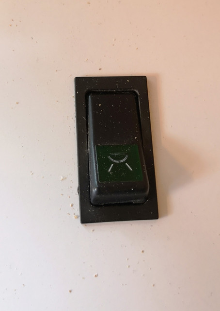

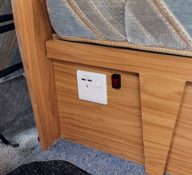

One of the additional digital inputs I will be wiring to a switch in the cab as a simple override to turn the heater on, the other I will probably hook up to a float switch as a low fuel cut off. Not major features, but "nice to haves" I'll look to add down the road.
I've probably waffled on about the Afterburner more than enough here already, but if you've got and questions about it please feel free to ask. I think this will be a really nice addition to the van though and well worth the money.

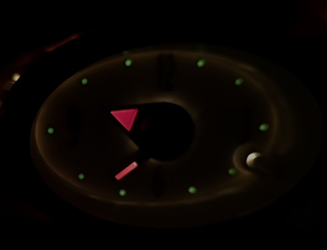

Last little project for the evening was to track down the connector wiring for that Ford clock. Didn't take long to find, so I'll look at getting a case made up for that somewhere down the road. For now...here's an example of one of the worst examples of backlighting of instrumentation in a modern car.
Trying to read this while driving at night is like trying to do a crossword while riding a unicycle. I still like it though, and look forward to it living on my desk. The dim backlighting there will work well as it won't be annoying at night.

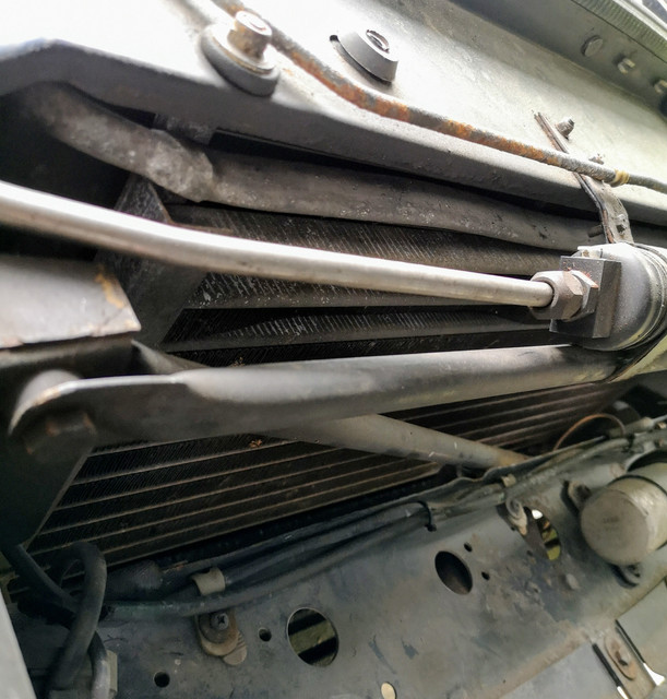

Now I have the air conditioning compressor clutch assembly in my hands it's time to start looking at getting the system recommissioned.
There are a couple of limitations in the system on this car which means I want to do a few checks before just bolting the new clutch on and sticking the belt back on.
The biggest of these is the lack of what are generally considered to be standard safety devices that we are used to be seeing on HVAC systems. Most notably pressure switches. Instead there is simply a thermal fuse on the compressor which cuts out if the compressor itself gets too hot. There's also no way to run the car with the A/C off unless the entire ventilation system is set to "off" - whenever *anything* on the heater is turned on, the A/C is running as the system on the XJ-S is a true automated climate control system...Quite unusual for a design from the 70s.
As such I wanted to do everything I could before getting things set up to give everything the best chance of working correctly. Obviously the very first thing that will happen once everything is back in place is it will be getting taken to someone with all the gear to be the remains of any residual charge recovered, leak tested etc and recharged. Before I go to that expense though I'd like to at least have some idea of what's in there and to be reasonably sure that it will pass the leak test. While the condenser looks like absolute hell, there was some pressure still in the system despite it not having been touched as far as I can tell since 2012, which has to be a good sign. Not very much pressure at all...but anything that's enough to move the gauges has to be considered at least vaguely hopeful on a system this old.
Given the state of this I was surprised to find anything in there!
I'm not kidding myself for a second...This condenser will need to be replaced at some point in the (probably not too distant) future. Aside from the fact that it's probably going to leak sooner than later, the heat rejection capacity will be greatly reduced in this state - and the system will already have taken a performance hit when it was converted from R22 to R134a back in 2012.
Having explained the situation to the garage I normally used for this sort of thing they agreed to do me a favour and stick a scoosh of nitrogen into the system for me so I could go around the car and do a check for any major leaks.
While it's hard to see the whole thing, there weren't any obvious leaks on the condenser, and watching the pressure it seems that we're not dropping massive amounts. This ties in with us still finding some pressure in the system. A dig around with the leak spray though did track down one obvious one in the engine bay. Give you two guesses where.

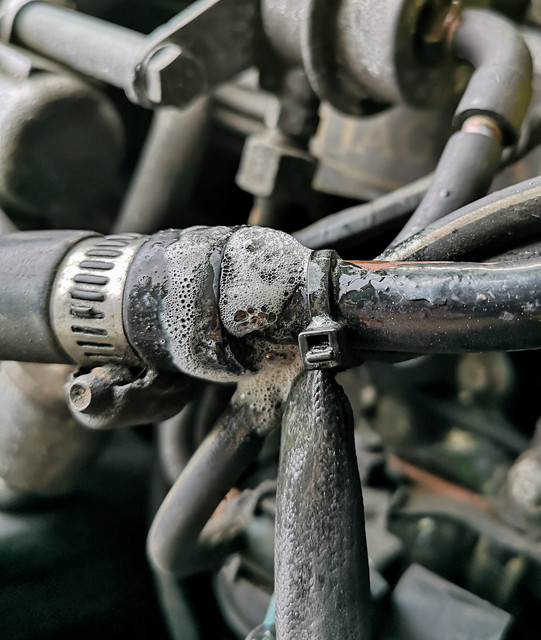

Yep...You remember those two connections on the line from the compressor to the condenser which are held on with jubilee clips which made me skin crawl as they have no place on any HVAC system beyond a condensate drain line?
Bubbly bubbly! Only one end though, the other side seems gas tight surprisingly enough. So we will need to get this line changed before we can look to get the system properly charged. Obviously we may well find more issues when we've actually got a decent head pressure on the system, but it's a start at least.

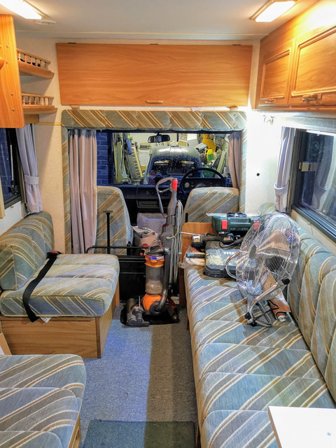

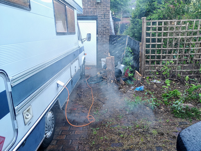

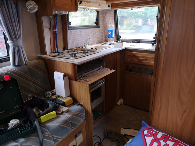

Nothing major done on the van today other than tidying up. I've now removed all of the tools and nonsense from the construction work so it's actually in a usable state again.
The eagle eyed of you might notice a black thing at the far right of the worktop. That's the switch which will control the lighting in the cupboards once I've fitted it. This was scavenged from a dead minibus years ago.
Knew there was a reason it was staying in the parts stash...see it's finally got a purpose for which the legend on the switch makes perfect sense! Plus being illuminated means we're slightly less likely to leave it turned on by accident.

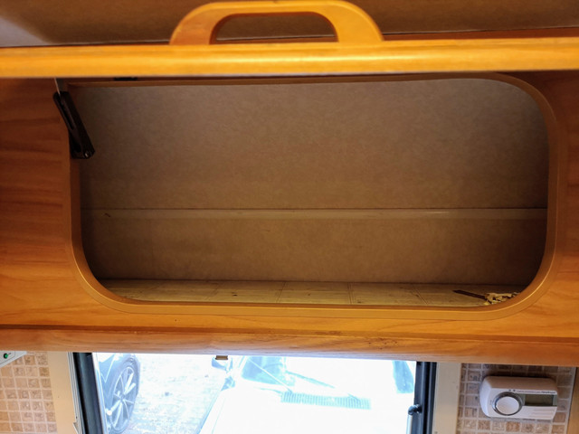

While I was on a roll with cleaning today I also set about clearing the upper kitchen locker, which has been full of random tools and bits of general vehicle maintenance nonsense since about two or three days after I got the van. This is I think only the second time I've actually seen the back of it!
There must have been the best part of about 20kg of assorted detritus in there...That can't have been helping the amount of rattles in the cabin! Following on from this I then went to have a rummage through all the lockers, cubby holes etc and pulled another five bags worth of miscellaneous junk out of the van. Given we've only got 78bhp to play with, lugging around unnecessary weight isn't something we want to be doing...plus getting a camper into a state where driving around doesn't sound like you're in a tumble drier full of spoons falling down a flight of stairs is enough of a challenge without having unnecessary nonsense floating around in drawers, lockers etc. One thing I will be doing now most things are empty I'm going to be putting non slip rubber matting down in all the drawers etc to help keep things still and further reduce the potential for things making a racket.

While you have the A/C system empty to fix the hose, you need to replace the 2 square section o-rings where the inlet and outlet maifolds fasten to the compressor. Tehy alway go hard with age, and old ones will start leaking as soon as you get the system working. Tehy are very easy to obtain and change.
My eariy XJ-S did not even have the thermal fuse on the compressor, and the failure warning device was smoke from the paint on the compressor, or maybe the compressor clutch catching fire. Amazingly mine still has the original compressor fitted, and the original condenser, but it looks even rattier than yours. Last time I had the system worked on, I had a new drier fitted and a trinary pressure switch fitted to the drier.
Posts: 14302
x 3303
Re: Zel's Fleet Blog - Xantia Activa, Jag XJ-S, Sinclair C5, Mercedes 208D, AC Model 70.
Try PMing DickieG about the A/C. He has the equipment AND the knowledge on how to use it properly. CitroJim knows him.
Zelandeth
Posts: 5300
Joined: 16 Nov 2014, 23:36
x 1593
Unread post by Zelandeth »
xantia_v6 wrote: 11 Jun 2020, 05:51 ...you need to replace the 2 square section o-rings where the inlet and outlet maifolds fasten to the compressor...and a trinary pressure switch fitted to the drier.
Thanks for the heads up. This car had a new compressor fitted in the *relatively* recent past, but seeing they reused the old clutch there's no guarantee they changed things like that! The drier is obviously relatively new so at least they changed that. I'll need to unbolt stuff from the back of the compressor to change that condenser line anyway so will be an ideal time to swap it out.
Fitting a combination high/low pressure switch like on the Xantia definitely seems a smart upgrade. Given most of the connections on this are with flare nuts it wouldn't be hard to add a service T in somewhere and hook one up.
Hell Razor5543 wrote: 11 Jun 2020, 06:23 Try PMing DickieG about the A/C. He has the equipment AND the knowledge on how to use it properly. CitroJim knows him.
Cheers! I do have a proper gauge set still from my days helping out our local (and nearly resident!) HVAC tech back when we lived by the farm, though of course I can't find it at the moment. Plus my experience with smaller systems like automotive ones is far more limited and my knowledge is massively rusty. At least the basic principles are the same though so I have a reasonable idea what I'm looking at.

xantia_v6 wrote: 11 Jun 2020, 19:51 There is quite likely a blanked-off switch port on your drier.
I never even thought to look for that...Will investigate!

I have just been catching up Zel and I noticed you had some grief with getting a cable through a cavity wall. I always used to use a simple trick with a steel tape. Fold the tape back on itself and then push the loop through the front wall panel until it hits the back panel. Keep pushing and the tape will expand in both directions along the wall giving you a huge target to drop your cable or drawline down into. Once you are sure you have dropped enough to go well beyond the tape, withdraw the tape and your captured line will come through the hole.
In this rather pathetic attempt to video the procedure you must imagine my finger and thumb as the front hole and the wall is the back wall, then you should see what I am getting at!! It may come in handy in the future and save you cutting huge holes in the wall to recover your cable:

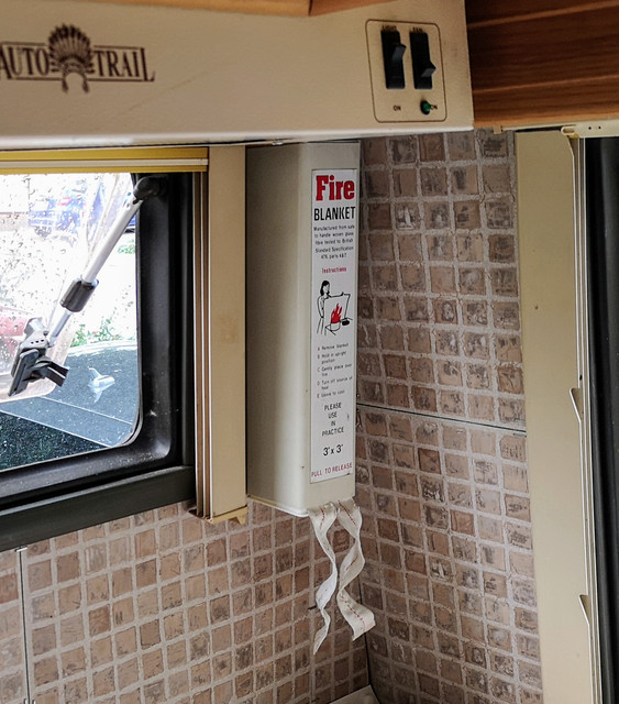

Something very boring but very important was refitted today in the kitchen.
Hopefully it's never needed, but nice to know it's there. Has been installed a good distance away from the hob, given that's where it's most likely (though hopefully never) to be needed.
Thinking about the air conditioning hose I need to replace on the Jag a bit yesterday and remembered and that was I had actually already tried to replace the condenser hose...however this happened when I actually tried to order the replacement.
Digging around in the evening on the internet revealed that there don't seem to be any actually available outside the USA (other than one stratospherically expensive one in Germany). Hmm.
Okay, we'll pull the pipe off and take it around to Pirtek and see what they can do with it. Couple of fittings and a properly crimped hose and we should be sorted. I'll bet it will be cheaper than getting one shipped over from the US.

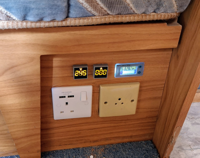

A single mains socket was probably sufficient for the needs of the camper van owner in 1990 when they would have had maybe a kettle, hairdrier and possibly if they were fancy a portable telly. In 2020 however not so much. Thinking about it though, we don't actually have much call for direct access to actual mains electricity these days...I think the only thing which is routinely plugged into the socket in there is the vacuum cleaner. 99% of our things are battery powered these days, and nearly all of them at least in our case charge from a USB socket these days.
The single socket was therefore swapped out for one with an inbuilt USB charger.
The round pin socket is a 12V DC outlet. The only thing I currently use it for is to hook up the submersible transfer pump for shifting water from the Aquaroll to the onboard tank. I'm not likely to even need this much longer as my intention is to fit a 12V socket outside for that purpose to save me having to dangle leads out the window. Once that's done I will probably replace this with a 12V based USB charger solution, assuming I can find something that will fit into a standard faceplate. The mains meters aren't really necessary, but are simply there to act as a visual indicator that the mains hookup is connected and live. I do need to tweak the position of the ammeter though, it's a hair too low.
As I had a hole in the front of the locker where the original controller for the new heater had been so this made sense as a place to install a second mains socket. That gives is four USB sockets in relatively close proximity of the bed, that should be sufficient to keep everyone's phones and assorted tech charged hopefully.
That red switch to the right of the socket by the way is the master switch for the heater and controller.
While I had the locker open it seemed a good time to attack a few of the other tasks I'd been putting off sorting in there.
A lot of these matters surrounded the heater.

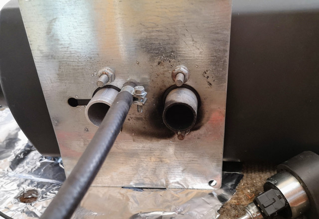

Particularly I had been wanting to add a bit more of a safety margin in the "Making sure it can't set fire to stuff" department for a while...but especially now that the new controller is fitted, which essentially has command authority to start the heater up under certain circumstances now irrespective of whether the van is occupied or not.
When I originally installed it, I cut the hole in the floor for the air intake and exhaust lines using the nice little template in the instruction manual.
I did foil line everything after that trial fitting by the way.
At a glance this might seem fine enough, especially given the original 1.5kW gas heater didn't bother with any clearance...but it's very easy to forget how powerful this thing is. 5kW is a lot.
Putting that into perspective, the most powerful electric heater that you can plug into a domestic electrical socket is 3kW. So this thing kicks out some serious heat - a significant portion of that being that it's combustion based goes straight out the exhaust. So it gets toasty. Toasty enough to have blued the metal over the entire length of the exhaust. I'd *really* rather have more than 1/2" clearance between that and my floor thank you very much.
That teeny tiny hole was made rather larger to get the floor further away from the exhaust.
Then some heat reflective tape was applied around it (this stuff has adhesive sufficiently strong to remove your fingerprints), wrapping well around onto the underside of the floor on all sides - there are three or four layers here.
I will obviously go back and trim some of the excess later.
While I had the heater free of the floor it seemed a good opportunity to replace the worryingly squidgy original fuel line to the burner with a nice bit of Nautilus Fuel Master, I trust that a couple of inches away from a burner exhaust far more than something that came in a box from China that has nothing by way or markings on it.
I wrapped the first couple of inches in foil as well...I know this hose won't need it, but it makes me rest easier knowing I've given that extra layer of protection.
It's very clear that the exhaust hasn't been fully sealed, so I made sure to put a smear of sealant on there before it was reattached.
In the cabin I wanted to make an alteration to the outlet. Previously I had just hooked it in to the lower one from the original heater because it happened to line up nicely. This wasn't ideal however as it results in the lower panel of the door getting very warm, but the rest of the van taking a good deal longer to warm up than it needs to. Being completely flush with the front of the locker made it far easier than I'd like to block the outlet completely too. So an adjustable outlet was fitted into the upper cut out instead.
The lower one serves as a return duct, though obviously it's not exclusive as the locker is far from airtight. I will add a grill or screen to it at some point just for aesthetics and to try to stop quite so much dog hair finding its way into the locker.
I do want to add some additional ductwork at some point though. Rather than the one outlet we currently have I'd like to branch three lines off. One venting out the rear of this locker to heat the kitchen area, likewise at the front towards the cab (or possibly an adjustable one like above) and I'd like to tap off a small line to provide a little background heat into the bathroom. I don't need it to be as well heated as the rest of the van, but currently it's like walking into a freezer in there at night. It's a job for the future, but would definitely make things more comfortable. Would probably make the heater a bit quieter too. Decent safety feature too as you'd have to be trying pretty hard to block off four outlets at the same time.
With the heater back in place I started doing something I should have months ago, and generally tidied things up a bit. It's always going to be a bit of a rat's nest down here with all the wiring, but I can at least try to tidy it up! It's still a work in progress as I ran out of time today, but we're getting there.
The conduit will obviously be attached to the side of the locker once I'm finished. There will likely be one along the other side too as there are quite a few random wires wandering along that way. Still need to remove the remains of the old gas line for the old heater as well.
That carpeted box all the mains stuff is sitting on I'd really like to get rid of. It just makes accessing anything incredibly awkward. I may well just pick up a small consumer unit like the ones for sheds or garages and redo that whole lot from scratch at some point as this is just a mess. Especially bearing in mind I've vague plans to install solar on this van at some point in which case I'll definitely be wanting to bring some sanity to this spaghetti. The DC stuff is a mess too, there's a lot of nonsense like red wires being used for multiple purposes (as you can see on the battery charger output at about 1 o'clock in the above photo) that I inherited with the van. I'm guessing that's a former keeper to blame rather than the factory...though with hand built vehicles you sometimes just never know...
Before anyone says the supply line to the front socket is too small, it will be fine. It's rated for 13A, and the two sockets are both attached to a single 7.5A RCD, so it will never be stretched. I'd be massively surprised if anything ever gets plugged into the mains socket up front anyway!
I would really like to install a guard of some sort to ensure that there's no way that the air intake on the heater body could be accidentally blocked. I will probably install a partition to separate the utility area at the rear from the general luggage locker at the front. That should do a pretty good job of keeping things away from where they shouldn't be. Though I will need to include some means to still stow the supports for the awning (the metal things to the left in the above image) as they do extend a fair ways back.

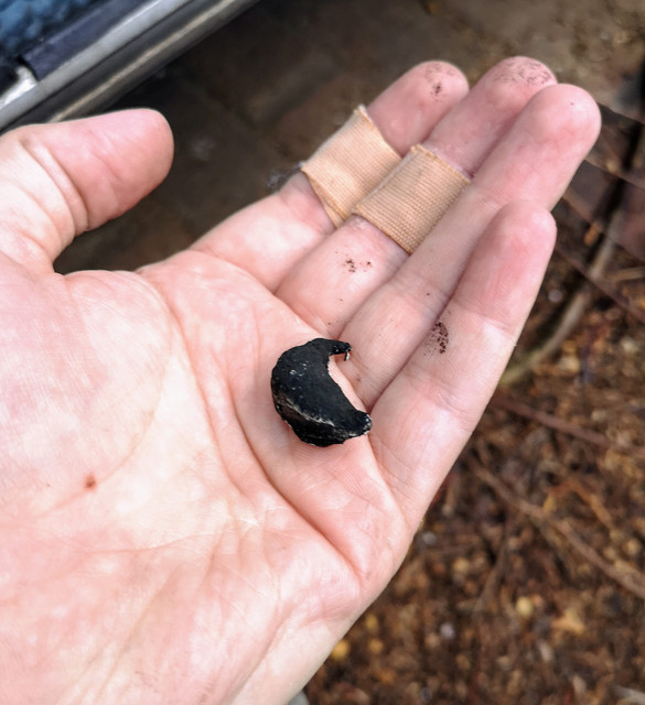

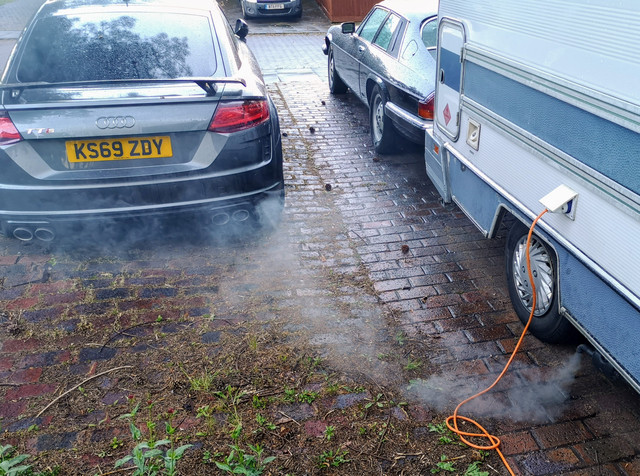

It was at this point we ran into a slight snag which took me a couple of hours to get to the bottom of.
Having changed the fuel line I needed to re-prime it. Didn't figure it would need much though given it was only the 10" or so between the fuel pump and the burner. Plan was to just run the pump in priming mode for 10 seconds or so. Given the control panel is a bit awkward to get at when the locker is open like this I decided to use the web interface to do this. Which would have been fine if my phone hadn't decided to drop my wifi connection the millisecond that I turned the pump priming mode on. I then spent a good minute fighting with it before realising that I could just turn the master switch off.
I was expecting this to result in some pretty impressive white smoke on startup then as there would obviously be quite a bit of unburned fuel having been dumped into the burner. It should clear after running for a bit though.
Except it didn't. In fact it got worse, and started to become denser and darker. This just doesn't look right.
It was also lingering impressively enough to attract the attention of our next door neighbours.
Something clearly wasn't right.
Thanks to the additional data visible on the Afterburner display it was obvious in addition to the smoke that it was struggling to make it up to full running temperature. The heat exchanger usually stabilises at full power around 220C, however it was struggling to get over 120C, despite blanketing half of our neighbourhood in smoke and the fuel pump running at the maximum rate of 5.0Hz.
After a certain amount of head scratching, and messing around swapping controllers back over in case it was a problem with the fuelling map etc, the fault was found.
You remember how I put some sealant on the exhaust? Yeah...a bit of it had managed to ooze into the pipe itself, where it had then puffed up when the pipe heated up and blocked a good 2/3rds of the pipe. So we were getting poor airflow due to a choked exhaust.
Once the system was started up with this removed and it started to get actually up to temperature the amount of soot that got blasted out the exhaust was truly impressive. There were honestly bit chunks of it. Not quite the fireworks you sometimes see from DPF equipped cars doing the first forced regen after months of town driving, but still impressive enough.
It did smoke for quite a while too, though given it spent probably an hour running with a very restricted exhaust that didn't really surprise me. It did clear up though after 20 minutes or so, and the heat exchanger temperature soon stabilised at its normal level.
Stupid mistake on my part using too much exhaust sealant! Entirely self inflicted.
I set the temperature control to max and just left it running for a full hour at full throttle to make sure everything was properly cleaned out. This also meant I was able to check and confirm that the floor around the cutout under the van is no longer getting worryingly hot. The fixing plate still gets quite warm, so it does get pretty toasty, but no longer *alarmingly* hot! Given it only takes about 20 minutes to get the cabin from 0C up to a comfortable temperature anyway it's pretty unlikely to be left running flat out for all that long anyway so this was a pretty good test from that perspective.
