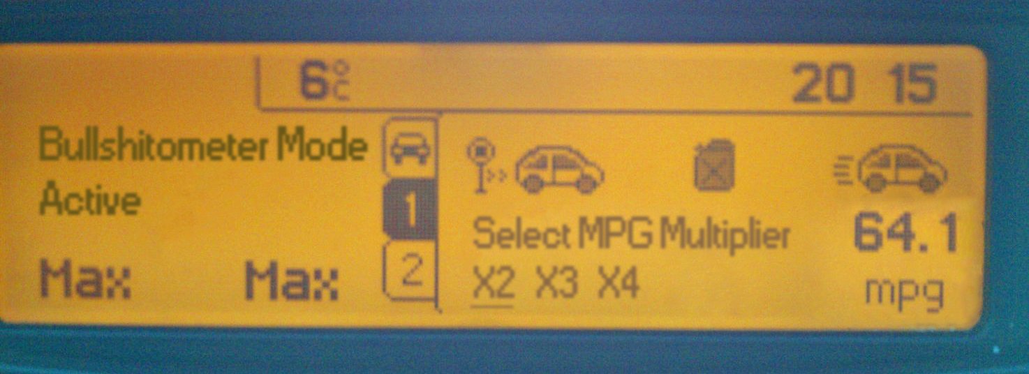

I think you've got the wrong firmware on your display Mike
It should be showing the following:
- Posts: 14318
- x 3298
Re: MikeT's C5r 1.6 hdi Estate
GiveMeABreak wrote: 17 May 2018, 17:11 I think you've got the wrong firmware on your display Mike![]()
So THAT is why the third generation C5 reports such a high MPG. It is, after all, known as the X7!

MikeT
- Posts: 4808
- Joined: 11 Jun 2007, 16:17
- x 232
I got it off a VW
