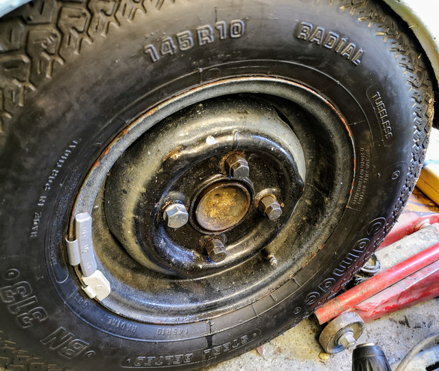

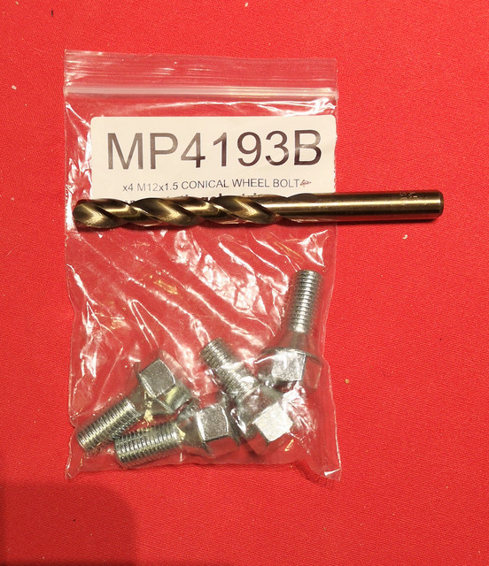

Was a day or two back that these things I'd been waiting for turned up.
These were hopefully the last things I needed to finally get the nearside wheel on the Invacar reattached to the hub in all four points. Sadly it would be another couple of days before I'd have a chance to get back into the garage.

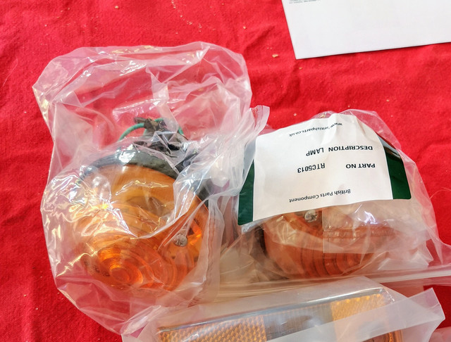

This morning another little package arrived.
Which will allow me to tidy up the front indicators. Just out of shot is also a couple of oil filters.

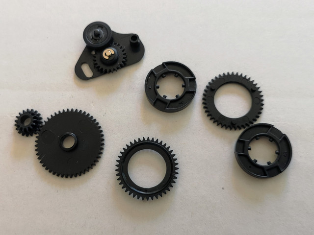

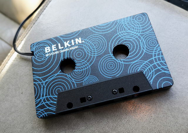

Had a brief sidetrack attacking the tape adaptor I've been using in the Jag.
While it worked fine it had a major drawback in that it made a horrendous racket.
The easiest solution I've found for this in most cases is to simply remove the innards from it. Some cassette decks won't work if you do this as they rely on the rotation of the reels to detect the end of each side. This one however doesn't, and will quite happily run without anything inside the tape. So this lot can go in the bin.
This means that I now can listen to music without a horrible clicky squeaky noise in the background.
Back into the garage.

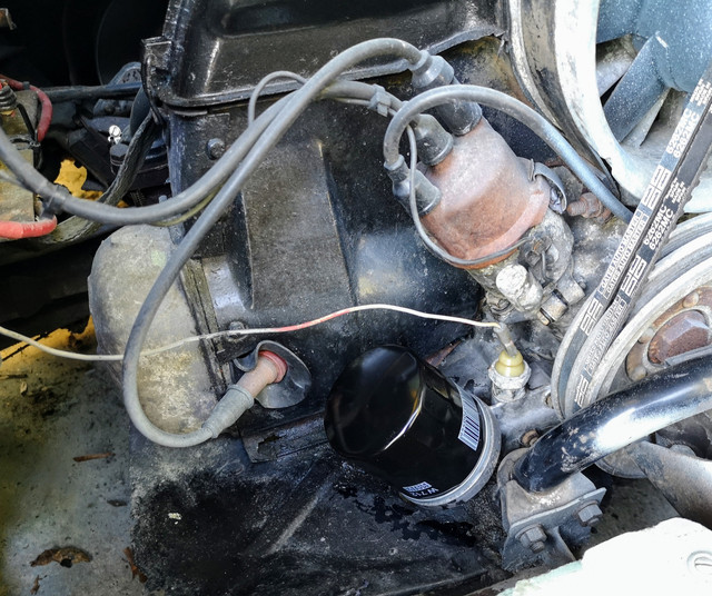

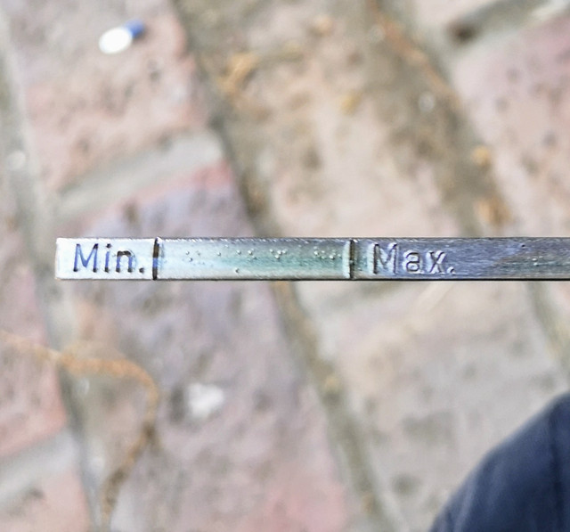

First up, having finally got hold of a couple of oil filters (having thought I had them in stock but discovering 3/4 of the way through the oil change that I was wrong) I could get that fitted and finish the oil change.
I'm going to have to spend some serious time cleaning up in here soon...everything is just covered in paint because I was an idiot and didn't properly mask off the engine bay before doing the paintwork. That's a job for another day.
Speaking of clean though, this is the first time that the oil hasn't turned visibly darker the moment it's poured into the engine - this had been running for a few minutes.

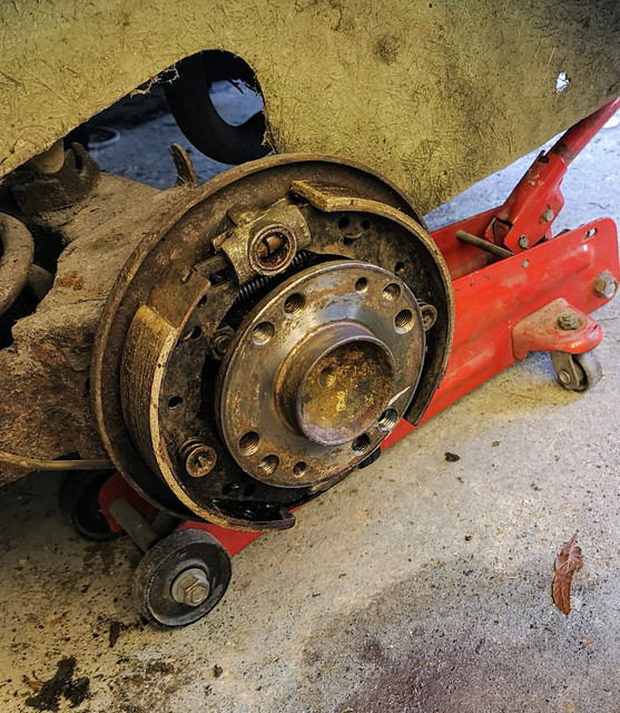

So having spent a good portion of the afternoon putting it off it was back to fighting with the hub.
Even with a good cobalt drill bit drilling into this hub is an absolute nightmare. After the best part of an hour of fighting with the drill and then the tap...
...Yes! For the first time since the start of September the wheel is actually attached at all four points and tightened up properly.
The shonky using-old-wheel-nuts-as-conical-washers arrangement there on the other bolts was only intended to confirm the thread size in the hub and to prove that bolts would work. It's been confirmed that wheel bolts from a Mk I Morris Minor have the correct thread and right sort of conical head, so there are a set of those on the way.
If the hub wasn't such an absolute pain to drill and tap I'd seriously consider using the M12 bolts in all four holes as they're substantially beefier than the 3/8" ones.
As it is I'd not be able to drive it like this anyway as the 3/8" bolts currently in there are too long so they foul on the brake shoes.
Huge step forward though!
Next step will be to pull the wheel and drum off to clean the inevitable swarf from the drilling and tapping operations out of the drum, then once the new bolts arrive we can get back on the road!
...Then we can see A: Which gremlins I've forgotten about in the last nine months, and B: What new gremlins have developed while she has spent nine months sitting dormant in the garage.
This will be a good thing given that the Jag isn't exactly...frugal...on continuous local runs! Van is actually astonishingly frugal around town, but as 3/4 of the places I've been needing to go lately have height barriers so it's not an option!
Looking forward to buzzing around in the Invacar again. Especially as I'd just got the CVT sorted out when the whole wheel stud debacle started.

Hopefully the new wheel bolts for the Invacar will turn up in the next couple of days. In preparation for that I pulled the wheel and brake drum off so I could clean things up ready for the road again.
Wasn't actually as much gunk in there as I was expecting. Bit of swarf, but nothing too difficult to clean out.
The long term plan is still to change the hub as I'm not 100% happy with how close the wider drilling has taken it to the edge of the casting. The thread hasn't been cut as well as I'd ideally like either, though I did give it a good old heave today on the bolt and it didn't strip, so I'm not too worried.
I had a look at something today. The difference between the 4X100 PCD (used on the Invacar) and the original 4X98 that Fiat originally used.
The bolt holes in the brake drum are actually big enough that there's enough clearance for these holes to be used. The only thing actually preventing them being used is about 1mm of metal on the wheel.
The question springs to mind of whether a specialist would be able to make that tiny modification. It's a question I think I might ask of a couple of companies...seeing some of the mad banding mods and such it would seem a relatively easy job. If it *was* doable that would eliminate the potential stud headaches once and for all.
Before folks ask, yes I have looked at the 12" Fiat wheels from the 500 - the offset is significantly different so the tyre would foul on the wheel arch (can't remember on which side off the top of my head).

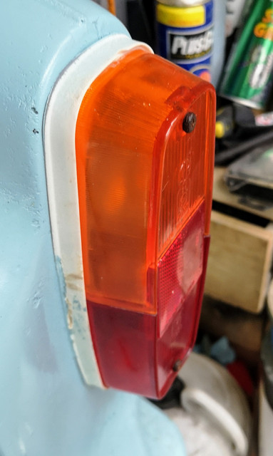

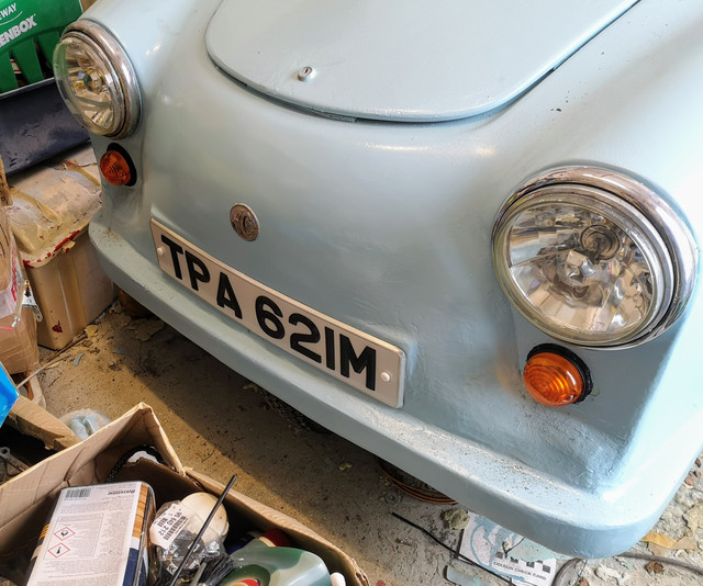

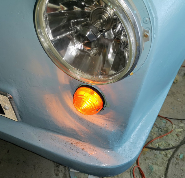

I've got one of the front indicators swapped out. Just need to go back in with a brush to touch in the paint around where the old seal was removed, was fully expecting that to be needed as the construction of the new unit is slightly different.
I will see if I can get the old lenses cleaned up properly though as the moulding of the original lenses is of a far better quality (unsurprisingly).
The other one will be done when I next have the car out the garage as the offside front corner is really awkward to get at when it's all the way into the garage.

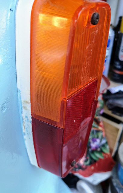

The indicators looked odd without the gasket behind them, even though they're not really needed to form a seal with how the new units are constructed. So I went out and set about removing as much of the paint from the old gaskets as I could then refitted everything.
Not totally sure why the one on the offside appears to have swollen up a bit (assuming it's reacted with the thinners in some way) but the other one hasn't...will have a dig through the boxes and see if there's a spare floating around in one of my boxes of assorted junk.

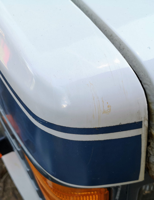

Slightly irked I decided to revert to type and faff around clean things.
When I first started the paintwork I was grossly naive where quite how far the overspray would travel which had resulted in a bit finding its way onto the tail light lenses (I honestly have no idea why I didn't just remove the units entirely and put them somewhere well away from the painting).
A bit of a scrub with some G3 cutting paste sorted that out.
I assume there should be a gasket of some sort between the lens and the back plate, does anyone know if this is a flat gasket or just a tubular section rubber one?
Something worth bearing in mind - when folks say that that soda blasting media gets everywhere, they mean it! There must have been a quarter of an inch of it inside both tail lights! Gave everything a good clean, greased up all the contacts in there so as to prevent any issues with future corrosion.
When we were pulling down the trees a week or so back I slightly underestimated the flail range of one Leylandii tree when it came down and managed to swat the front of the van. It was just the brushy bit at the top so no damage done save for a scuff.
Nothing a quick bit of polish couldn't sort.
Glad there's no actual damage done. Lesson learned - everything gets *fully* removed from the driveway before we do anything like that again.

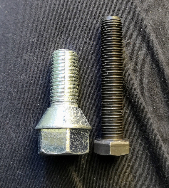

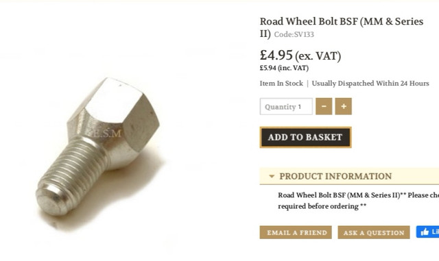

*Bashes...head... against...wall*

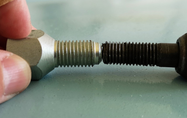

Either the existing bolts I've got aren't actually 3/8" BSF as I ordered, or Morris Minor wheel bolts are not actually 3/8" BSF.
Ignore the damaged bit on the end of the thread on the longer bolt, because it's too long it fouled on the brake shoe when screwed in.
The Minor bolts are BSF, but not 3/8". Guessing 1/4"?
I was all set for this being a ten minute trip into the garage and this would be sorted sufficiently to leave alone for a while...so much for that.
At that point I was about ready to go full Basil Fawlty on the thing or toss a lot match into the garage.
A bit of further digging this evening revealed there was a front hub assembly still available on eBay. Been there for a while actually. I'd originally been dismissing that as I was sure I'd read somewhere that the front hub used conventional splined studs as per the Mini.
The parts manual however simply lists one part number for the wheel studs and shows a quantity of 12 per car...so they should be the same. Closer examination of the photographs on the listing shows that they are indeed screwed in. Suffice to say I clicked buy it now at that point without a moment's further hesitation. I'll still need to source new wheel nuts and figure out how to extract the studs from it without damaging them... that's half how we wound up in this mess!
Though I'm telling you right now that if everything wasn't closed, that hub would have been off and on its way to a machinist today to have all four holes drilled out to take M12 bolts! My only worry there is how close it is to the edge of the hub itself - and I'm wondering if that's why they used such an oddly small diameter stud.
So it's not going to be sorted this weekend...but we're getting closer. Hopefully!

I thought that Morris (before the Austin merger) often used metric threads. Are they M10?
Zelandeth
Posts: 5319
Joined: 16 Nov 2014, 23:36
x 1605
Re: Zel's Fleet Blog - Xantia Activa, Jag XJ-S, Sinclair C5, Mercedes 208D, AC Model 70.
Unread post by Zelandeth »
xantia_v6 wrote: 10 May 2020, 00:42 I thought that Morris (before the Austin merger) often used metric threads. Are they M10?
Entirely possible. Either way they don't fit which puts me back to square one!
