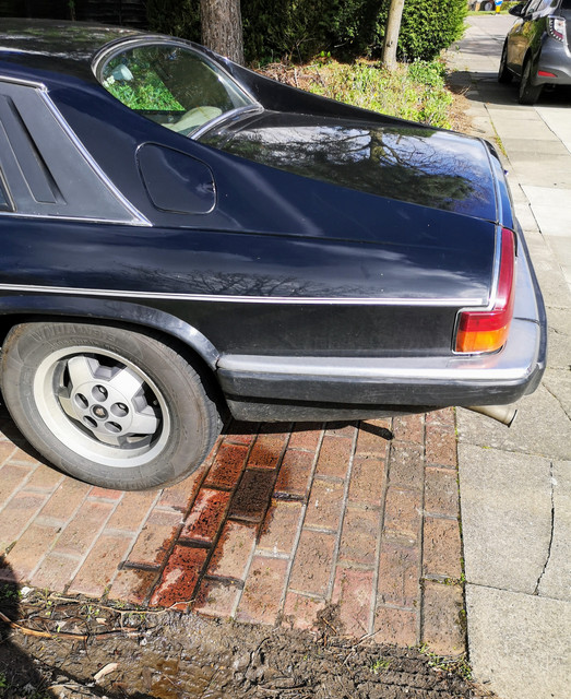

Not content with averaging 13MPG the Jag apparently decided this morning that merely using its fuel wasn't bankrupting me quick enough!
Yep...it was caught dribbling fuel all over the floor.
I had fuelled up in the last hour, our drive slopes slightly downhill towards the camera and it's been quite nice and sunny here so far today.
As such I reckon things have expanded in the tank and it's forced fuel bank out the filler, probably due to a compromised tank vent line (which I've suspected for a while on account of a distinct pong of fuel in the boot). Though I've never noted and excessive pressure/vacuum in there really. It was weeping out around the cap seal itself then draining down the spill line in the filler surround today. Turning the car through 180 degrees so the filler was at the high rather than the low side sorted things.
Obviously only an issue when the tank is really full (so about 3 miles worth of driving then probably!) and on a warm day, but something I'll need to be aware of until I can investigate the venting system properly, and possibly renew the seal in the filler cap as it's a little perished in a couple of spots.
Have to wonder if this happened unknown to me at some point during the random sub-10MPG tank a couple of weeks ago...hard to say as the evidence is gone minutes later!

The tank ventilation system on your car is probably "interesting"... There were a few variants fitted, depending on the year and target market.
Yours probably has a vapour separator can mounted above the right hand end of the tank with about 5 hoses going to it, most being tank vents, but one to drain fuel back to the tank and another being the external vent.
On US market cars the external vent line goes to a carbon canister etc. on UK market cars, until the early 80s, they just vent to atmosphere through a hose that couples into the drain from the boot lid channel. In about 1985, the EU apparently introduced a vapour emission spec, but it was more lax than the US spec. I can't remember if the system has an electric valve with purge to the engine intake, but when the engine is not running, the fuel tank is sealed off, with a pressure relief valve (above the center of the tank IIRC) that lets vapours excape if the tank pressure exceeds about 2psi.
The net effect is that if the tank cap does not seal 100%, it becomes the weakest link and vapours (and potentially fuel) get pushed out past or through the filler cap on a hot day.

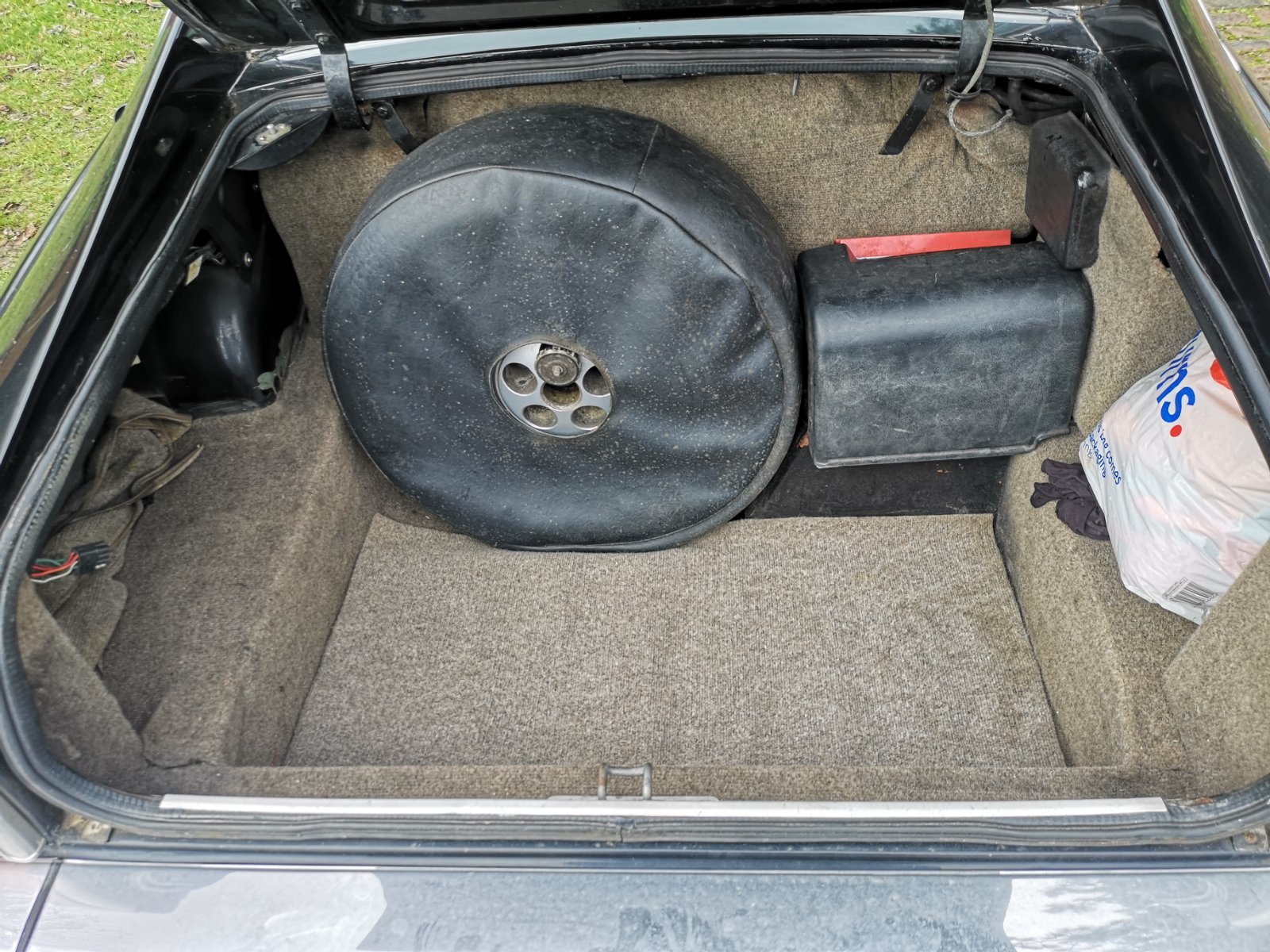

There's always been a strong smell of fuel in the boot so going over the venting system in detail is already on the to do list.
Edit: Plus having cleaned the base carpet it's showed up how grubby the rest of the carpeting in the boot is so it all wants to come out to be cleaned anyway.

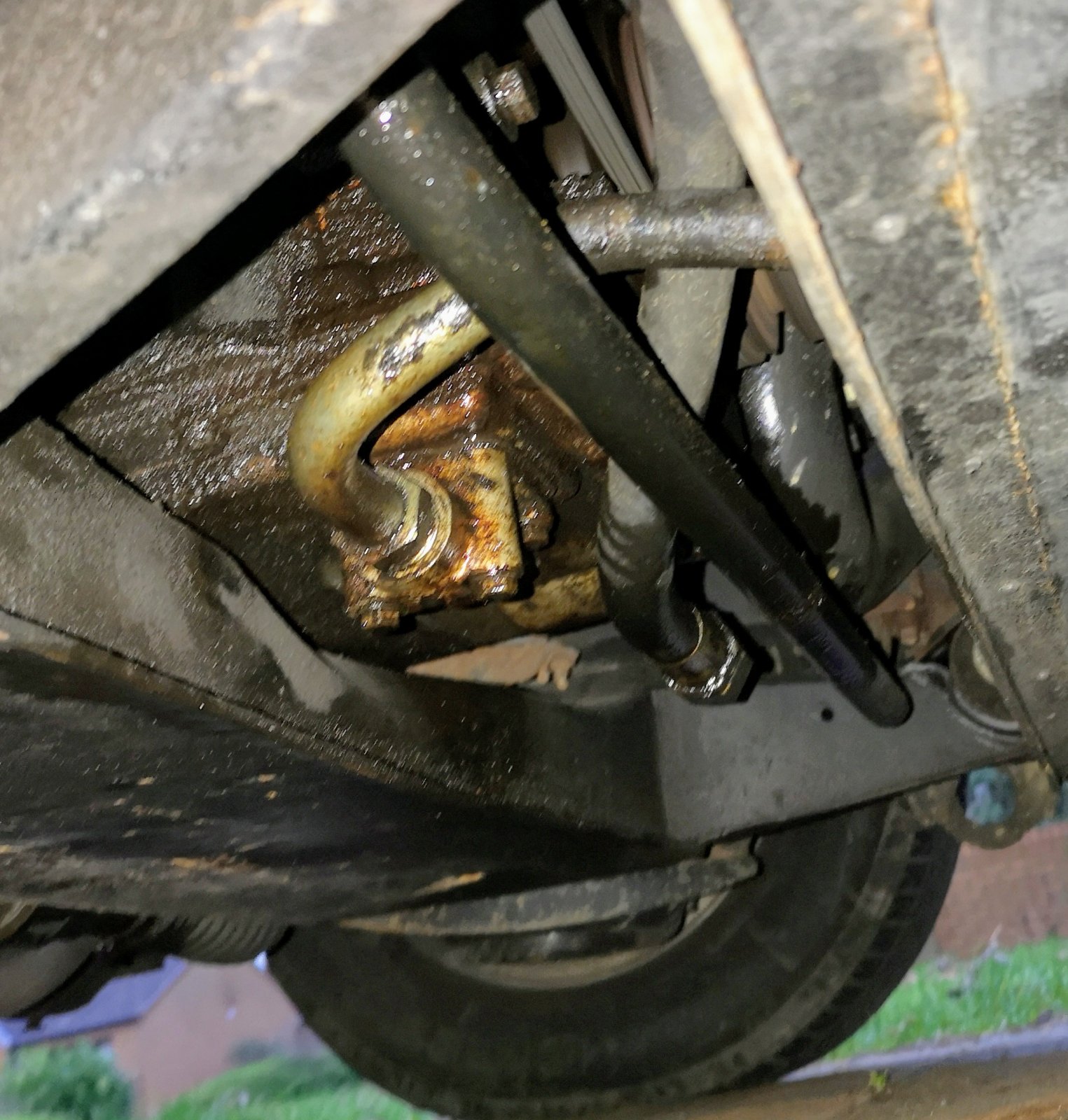

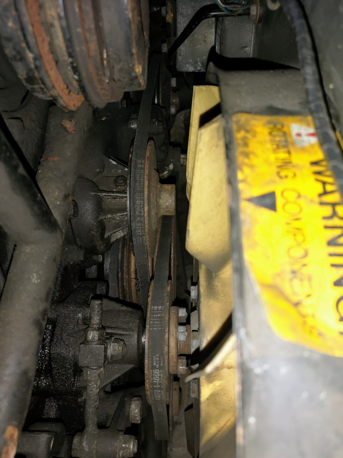

Other than less than stellar access (on an XJ-S, surely not!) is there anything I need to keep in mind while doing the belts? Looked like the adjusters and such were pretty standard setups...just as usual on this car it's a bit hard to actually see what you're looking at as there's so much car in the way. Few folks have suggested removing the bonnet but that's definitely a two man job and I don't have a helper, so we're not going down that road. I do have ramps (assuming I can get the car onto them with how low it is), is this a job which can be done more easily from underneath? To make sure I give it as much opportunity to drop oil up my nose as possible...

It is a while since I have changed the blets, but they are done from above, except the alternator belt which I think is adjusted from below.
On the pre-HE engine, the oil cooler pipes make any access from below to the crank pulley almost impossible, I can't remember if that was slightly improved for the HE (probably not).

xantia_v6 wrote: 15 Mar 2020, 00:27 On the pre-HE engine, the oil cooler pipes make any access from below to the crank pulley almost impossible, I can't remember if that was slightly improved for the HE (probably not).
Doesn't look exactly access friendly!
