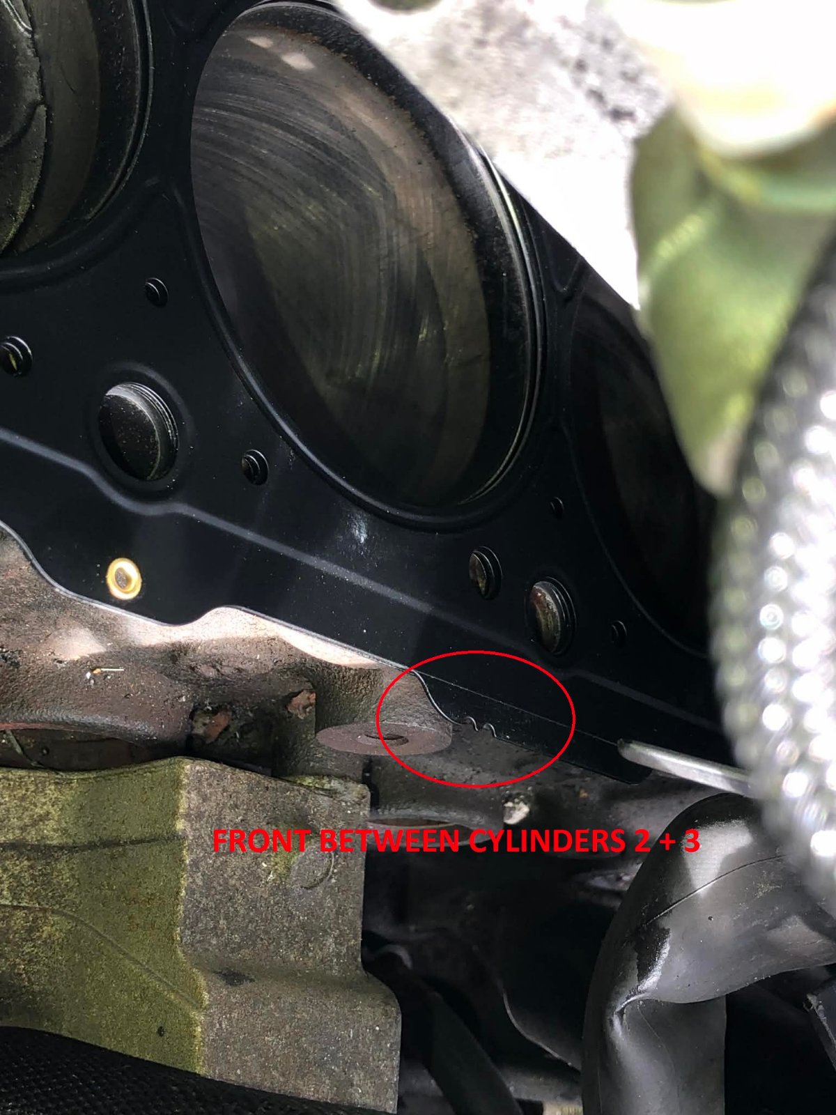

Well suffice today it would be ready for a drive by now if I'd only made certain it was orientated correctly the first time :oops:
I've managed to split the engine again today with the help of my hoist
Skull's - Mind The Gap
Just enough room to get my hand in the gap and clean up the surfaces ....
Skull's - Cylinder Head cleaned up again
New Head Gasket in place (both dowels moved to the block to stop it sliding off)
Skull's - 2nd attempt
Head Gasket in correctly this time
Skull's - CORRECT Head Gasket
New Head Bolts fitted but they aren't very deep heads and easy to chew them up 8-[ .....

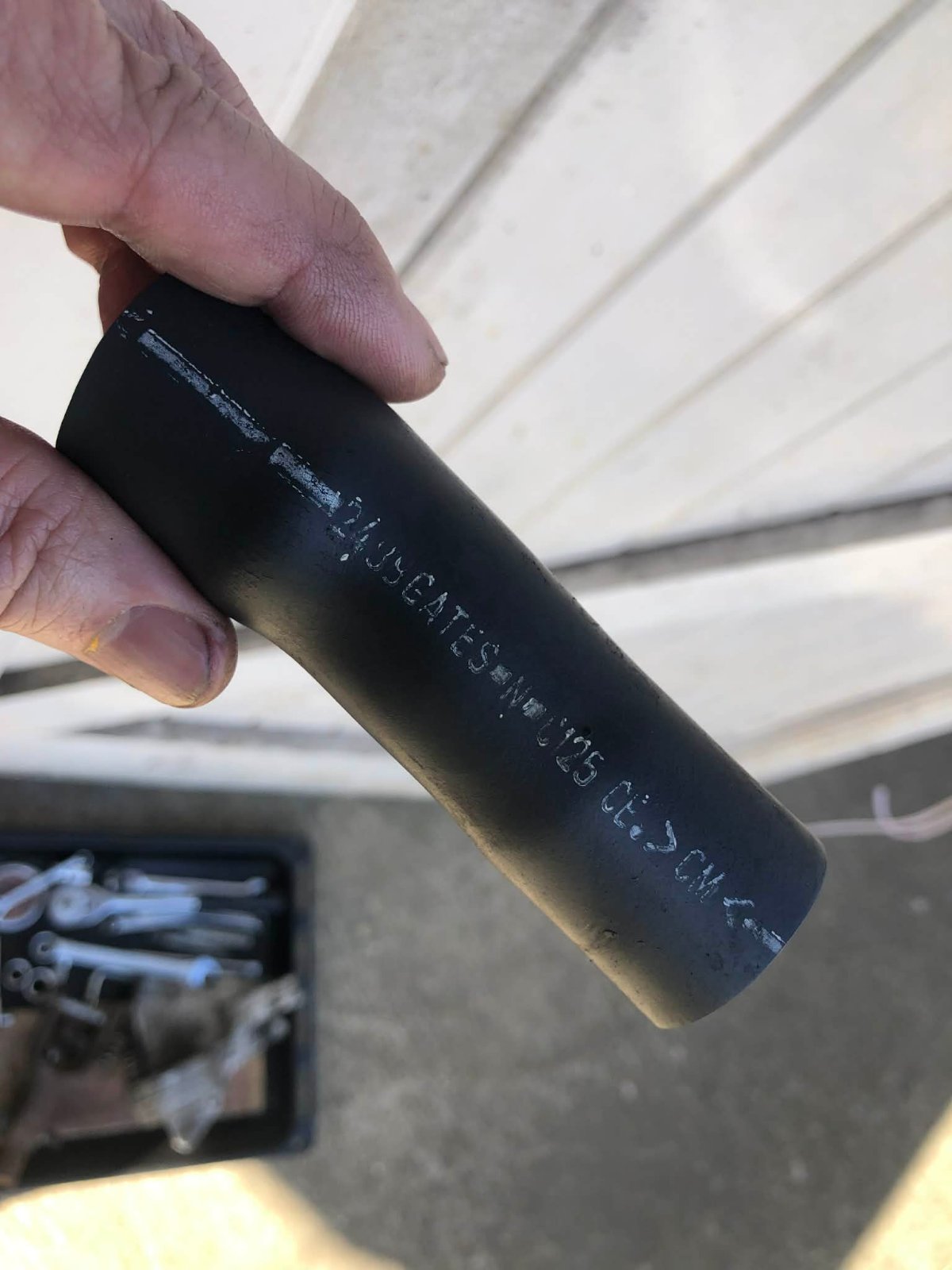

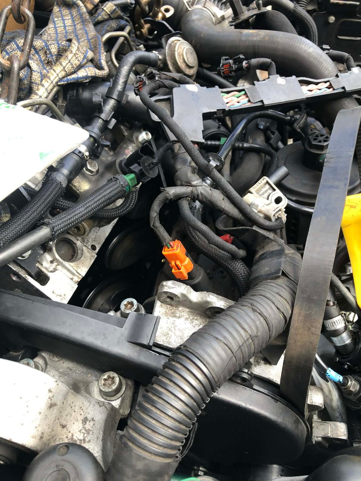

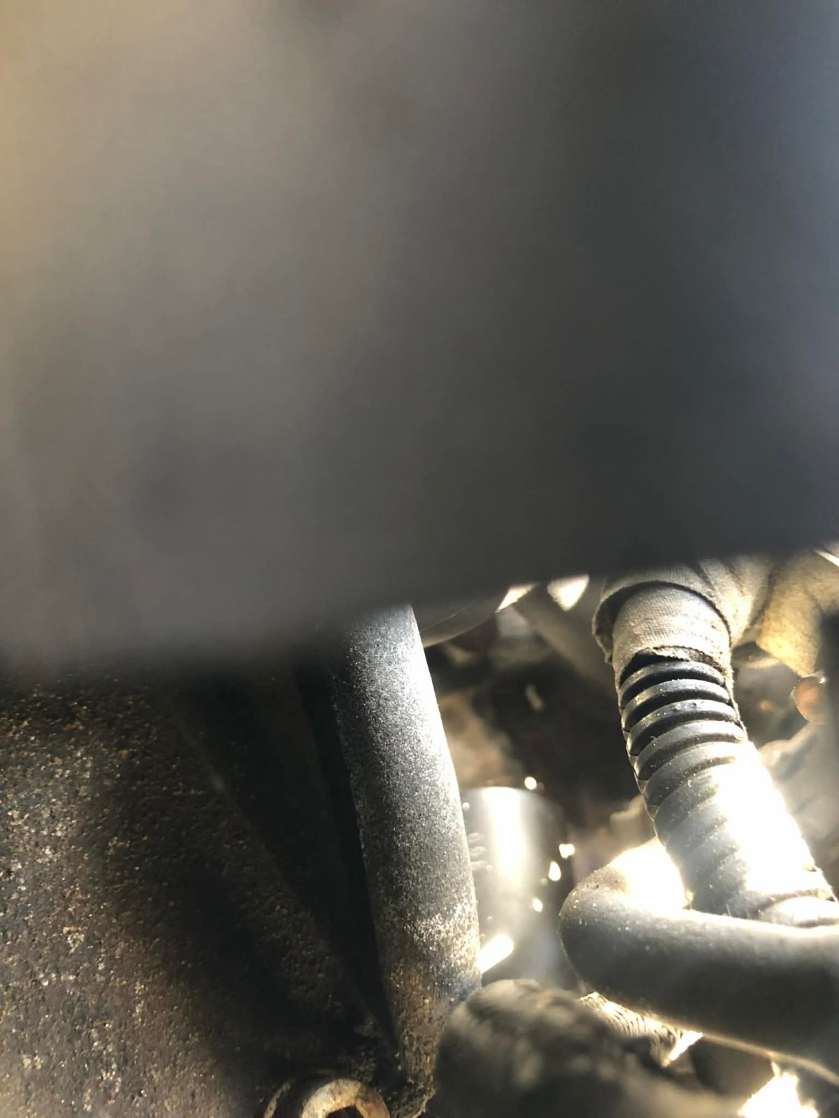

Cheers Guys ... sticking evrything back together ...I dropped the small 8mm nut off the glow plug feed....whilst looking for it I noticed my long lost rubber pipe hiding behind the fuel filter!
Skull's - illusive pipe spotted
Skull's - Missing Pipe retreived
Reunited but no sign of the missing glow plug nut yet....
I've just got the Catalytic Convertor to refit and replenish the Coolant and Oil and I should be ready for a re-start :yeah: ...
I am expecting to need a new cambelt tensioner as there was a whirring noise after I'd disturbed the belt previously, but I'll see if the engine runs before I tackle that and the ABS ring that needs replacing before I refit the Drive Shaft...

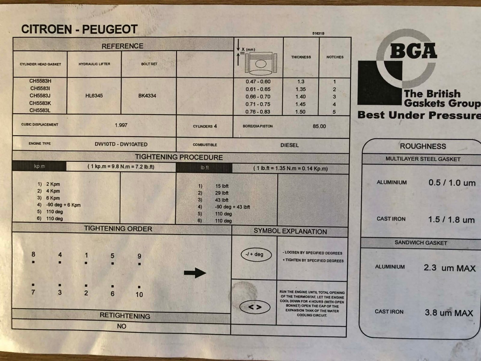

Well the big day has arrived .... finally started the engine again [-o<
It started up nicely on the second go (fuel pressure) and sounds a lot better than when Jim and Mick were here (last year :oops: )
Still a bit smokey but I followed the instructions, allowing a heat cycle and a long cool down and will try it again tomorrow.
Skull's - Head Gasket Instructions
Previously back in October 2025
Today
I'm hoping it will run cleaner than today after the diesel is burnt off the Catalytic Converter :?:

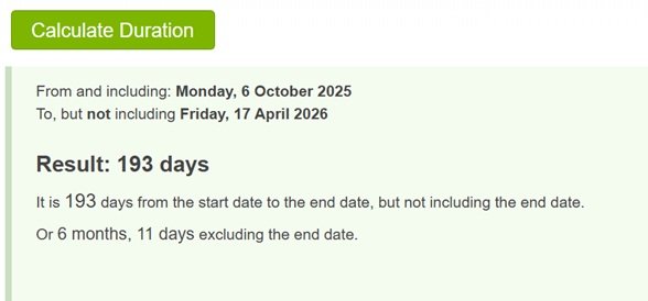

XANTIA HDi RUNNING ROUGH Sorted 193 Days later!"
Nice to see it back together Gary. A bit of gentle rehabilitation, and proving on a few trips out, and a few photos out and about, and back to motoring for pleasure.
Back in 2010 ish when I resurrected my Xantia Turbo Diesel, when the timing belt snapped, by swopping heads with a spares car I had on SORN I took the resurrected Xantia on a trip from Northumberland to Pickering in N.Yorks up Sutton Bank and all. Couple of hours there, couple of hours back! It managed to survive it!
From 2010 the Falcon Xantia!
I think my earlier calculations were a bit suspect...but well done for the persistence of the last 193 days Gary, quite an achievement!
