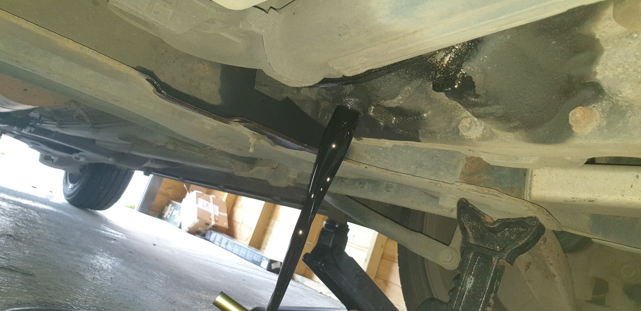

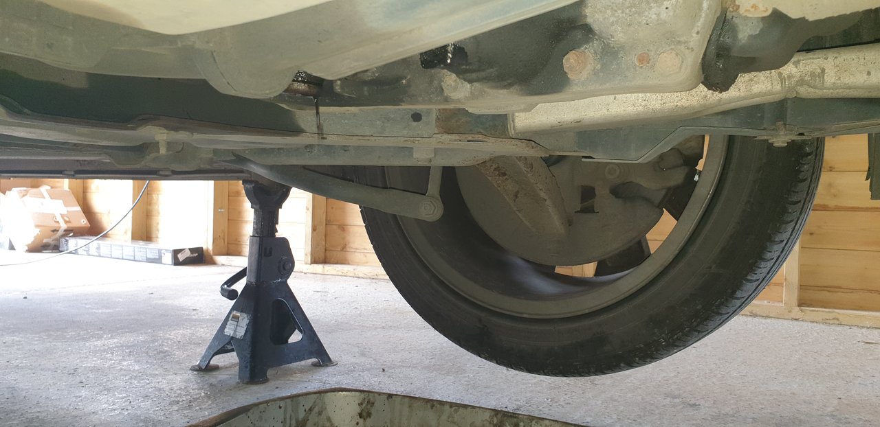

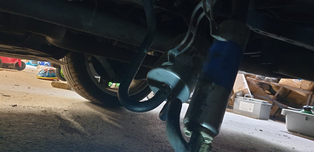

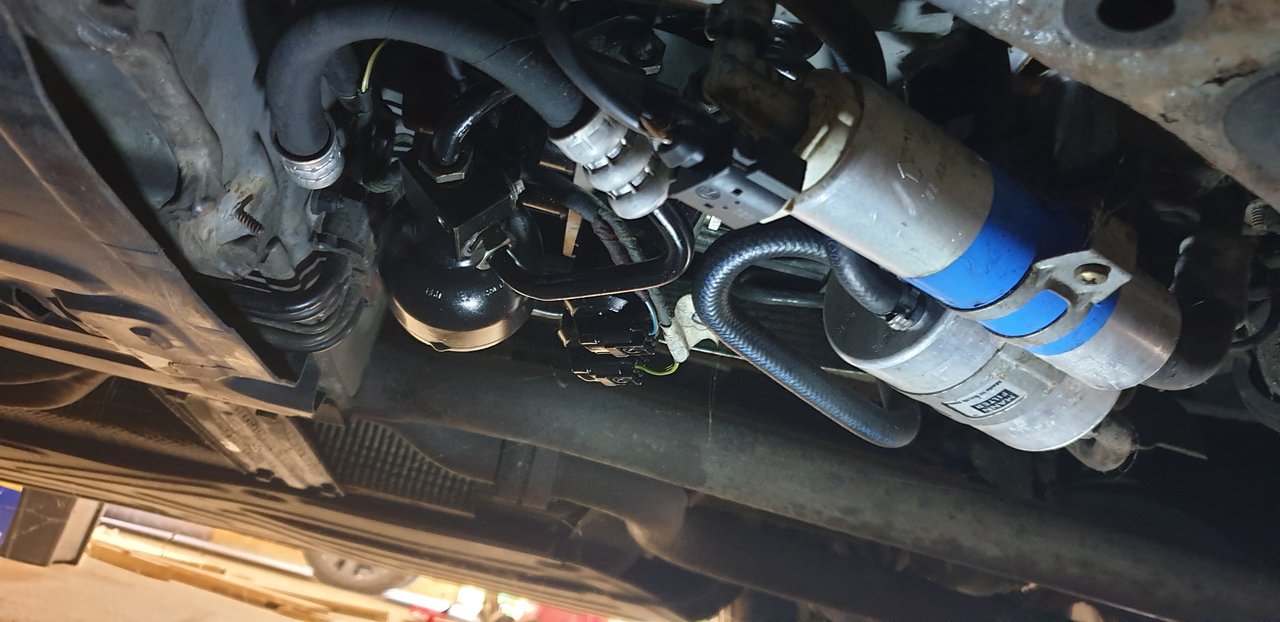

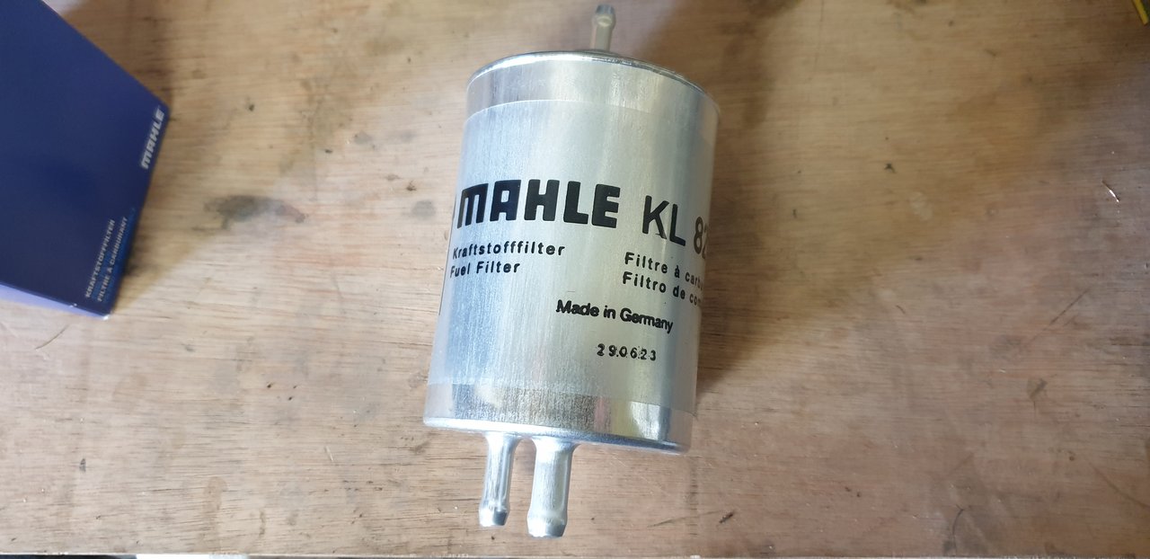

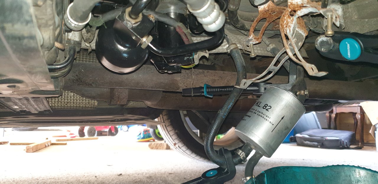

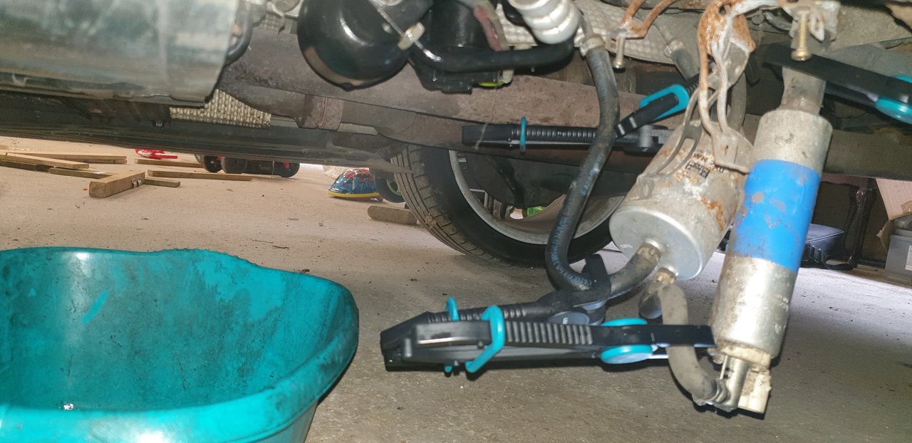

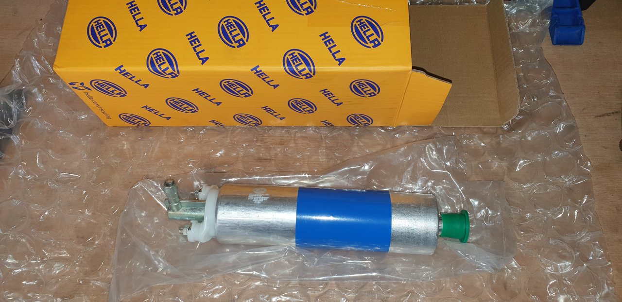

First update is on the CL500, and I continued my previous investigation into the rough idling by changing the fuel filter and fuel pump on Sunday 21st July.
These are both located on the underside of the C215 chassis Mercedes, and are quite easy (if a little messy) to replace.
Fuel filter:
Fuel pump:
They are located here:
Released, clamped pipes, and changed them over, spilling lots of brown looking fuel in the process...
With all that back together, the car does seem to run better, and the idle is fine when cold, but when it heats up the idle gets rough again... so it needs more investigation.

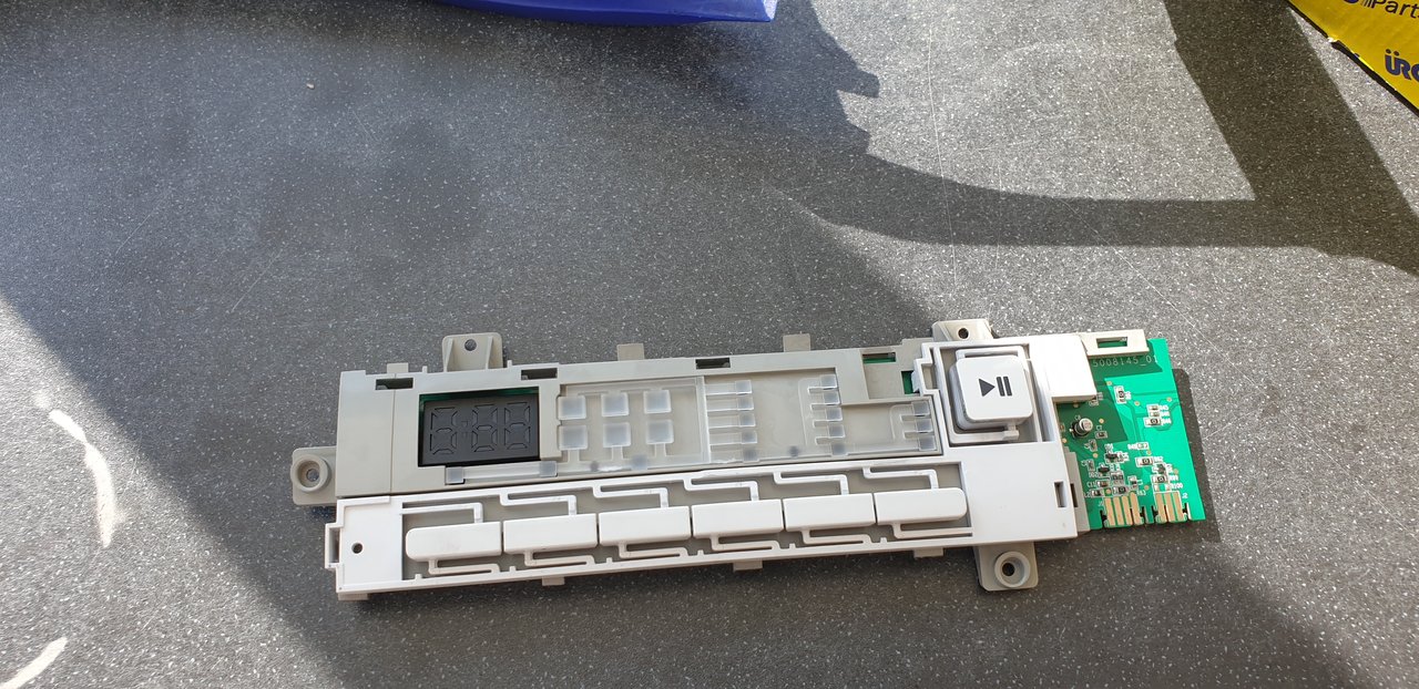

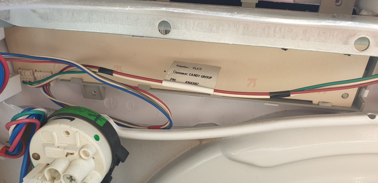

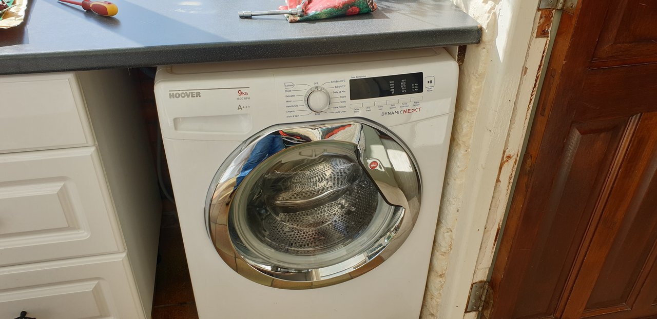

But I had to do a job first, fix the washing machine!
The control knob had failed, so I bought a replacement online and fitted it - along with the board with all the buttons on too, as they came as a set.
I've repaired this twice now, and it's lasted us over 10 years... I am very pleased with it!
So with that done, I could go back to cars.... lots to do!

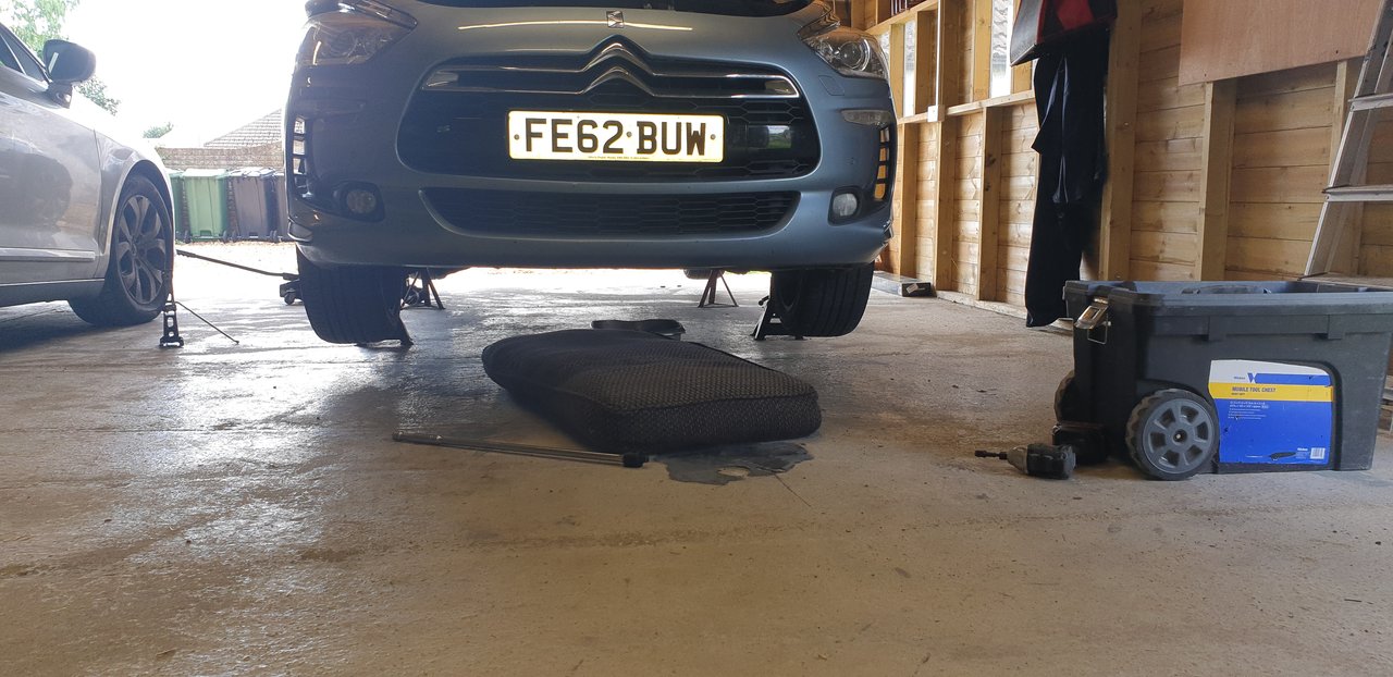

First car job of Saturday? Flush our and replace the gearbox oil in the DS5 of course!
This video was fantastic, and told me everything I needed to know.
How To Change Transmission Oil Aisin Tf-80 / AM6 Citroen DS5 (DS3, DS4, C4, Peugeot 3008, 5008, etc) - YouTube

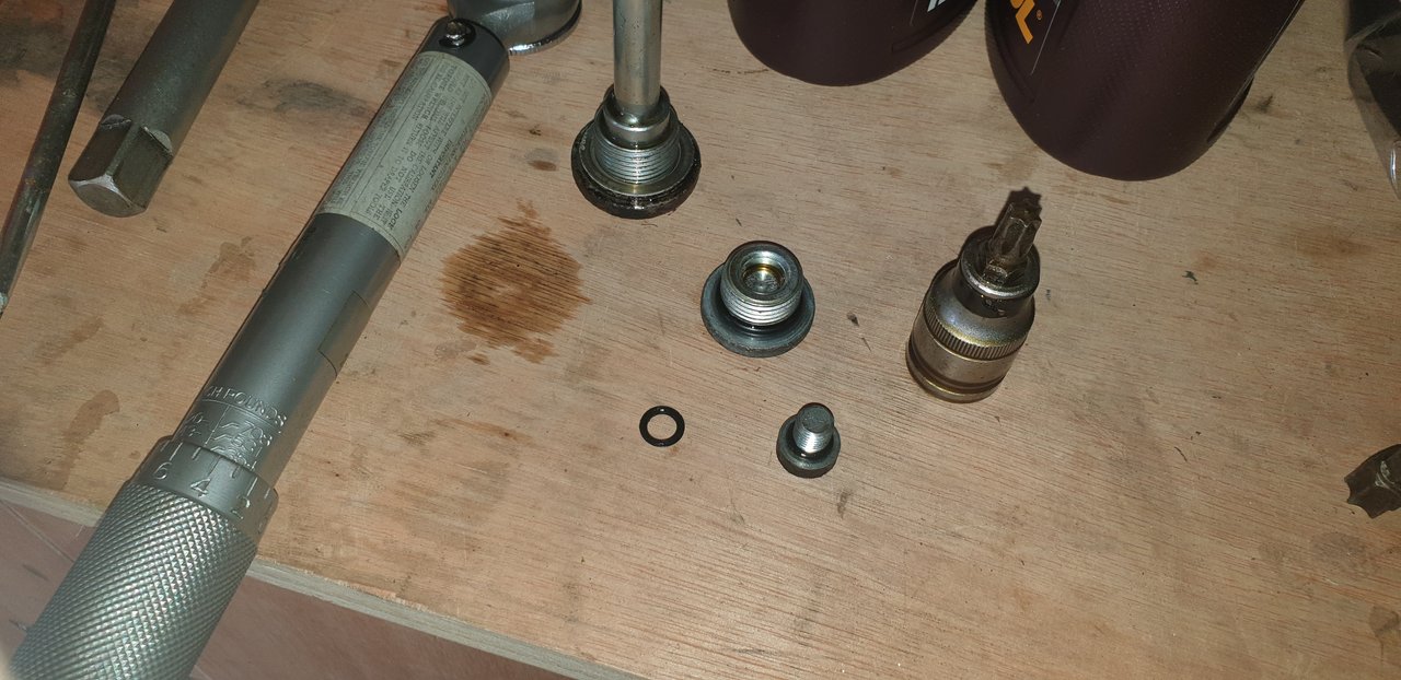

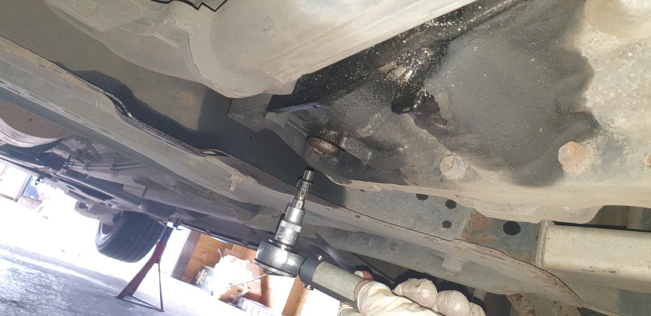

To get to the oil filling bolt, you have to remove the airbox. The screws holding it looked very suspect...

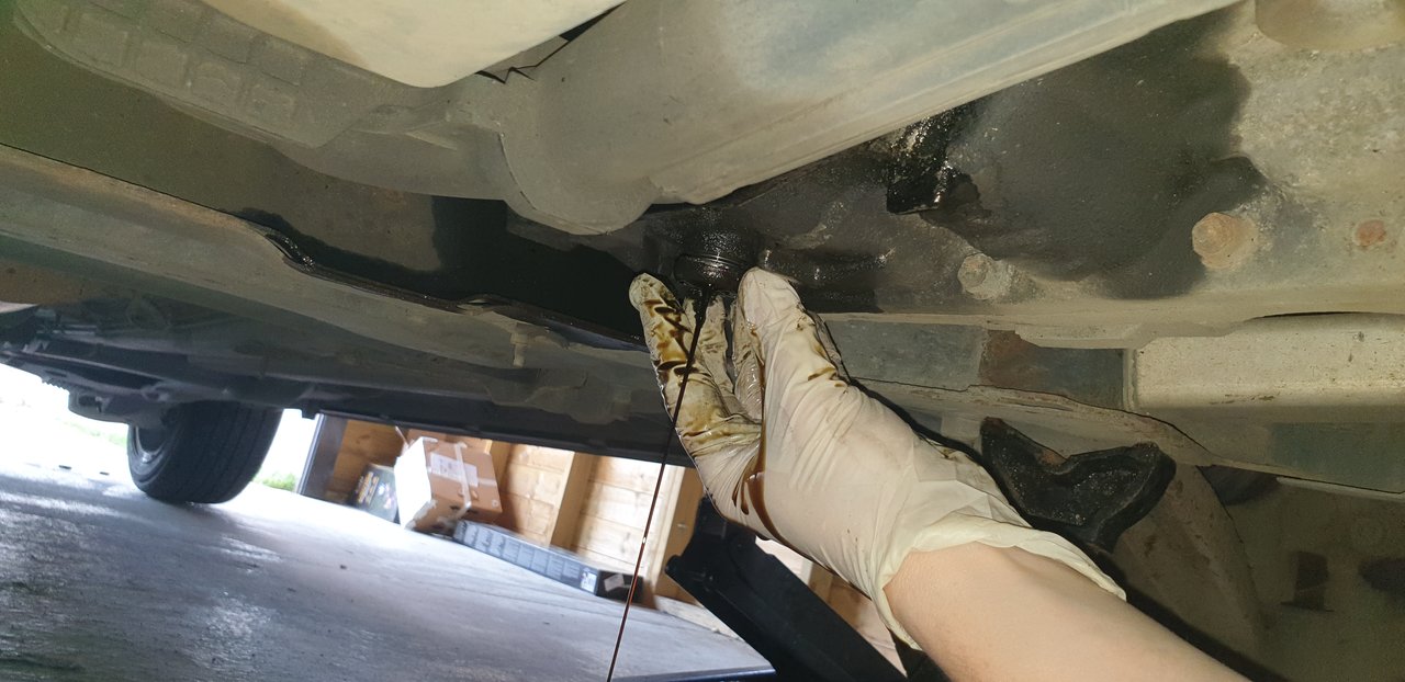

Once done, I dropped all the oil out - this is a 2 stage process where you first remove an inner fixing, then the main plug bolt.
The main plug bolt is the one with a tall upstand on it shown below. The idea is you overfill the gearbox slightly, then remove the smaller fixing from inside this bolt. Excess oil then flows over this upstand and down the centre of this bolt. When there are only drips coming out you know the level is right. A very clever idea.
Torqued the plugs back up correctly.

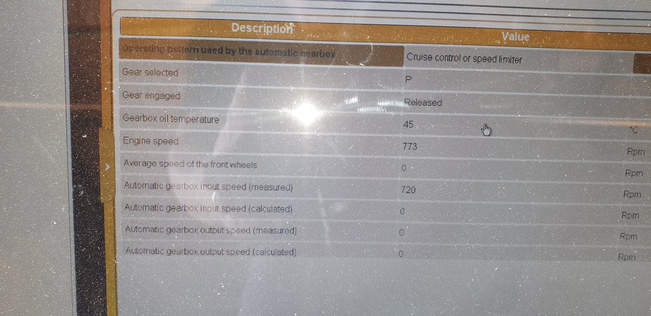

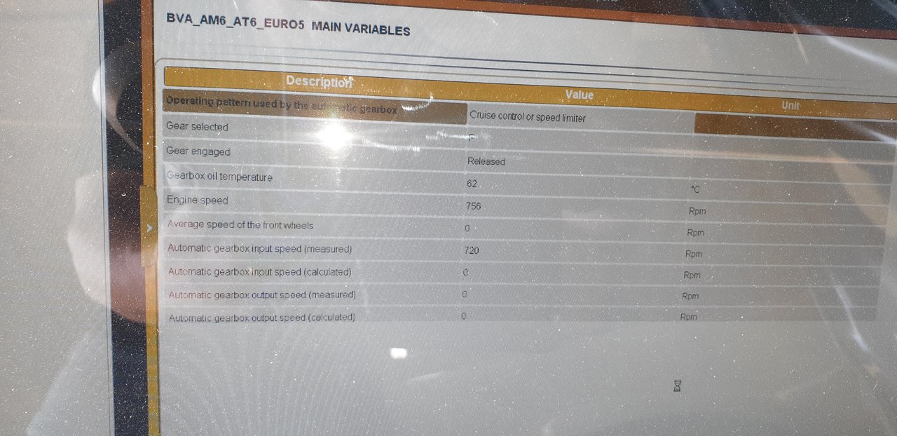

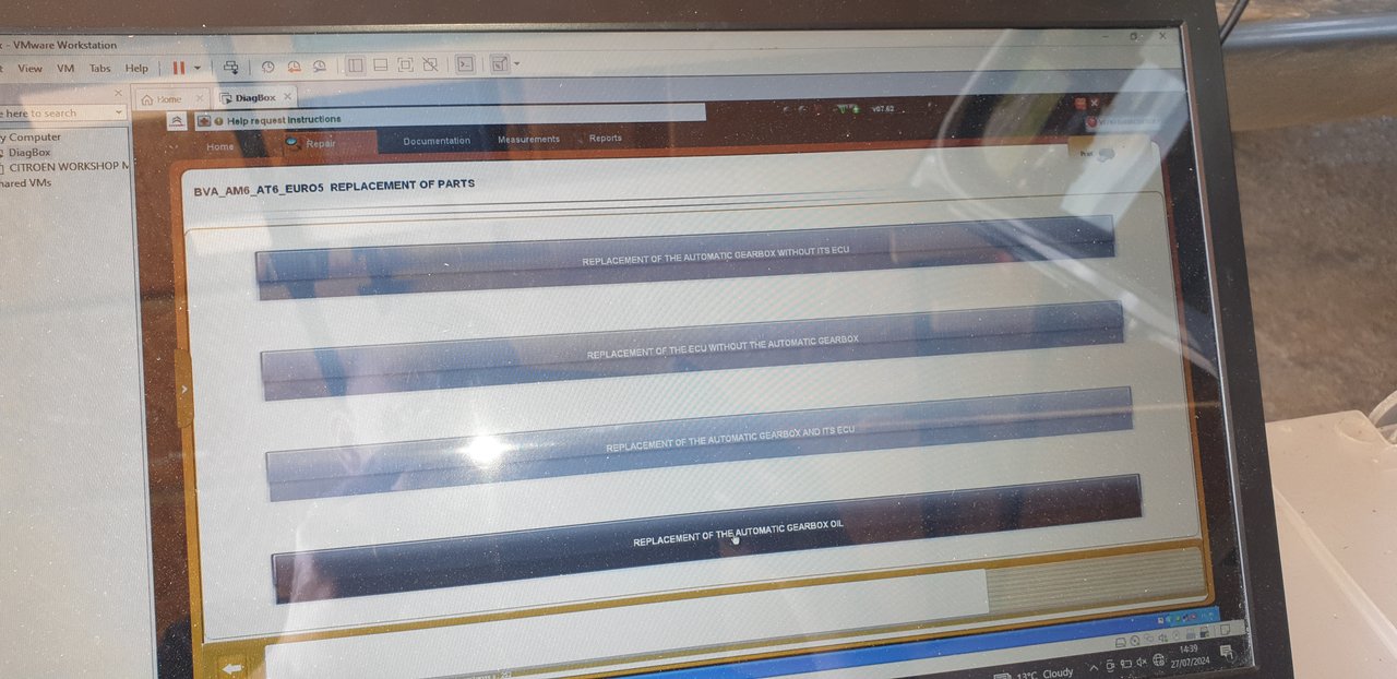

Then used DOGBOX to reset the gearbox oil counter.
Then lastly I started the car, and used DOGBOX to monitor the temperature of the gearbox oil.
When it was warm enough I removed the centre drain plug to release the excess oil.
That was this complete, and I must say it was very easy. I took the DS5 for a short run and I have to say the gearchanges do feel smoother, even if it's just my imagination.

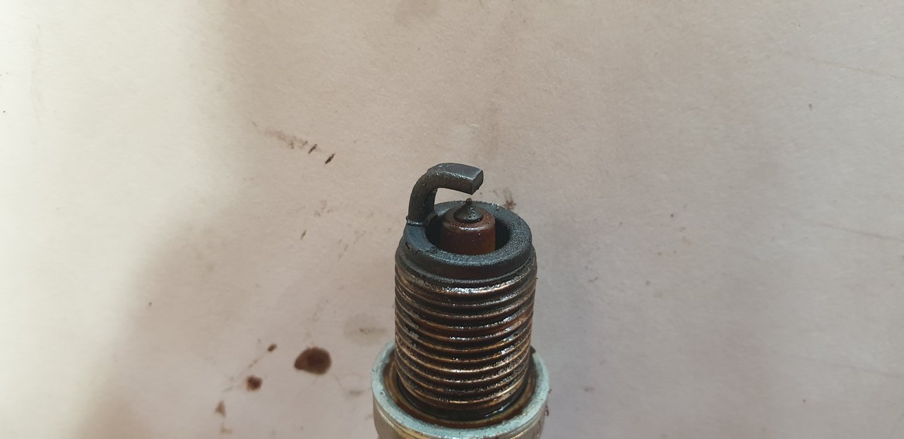

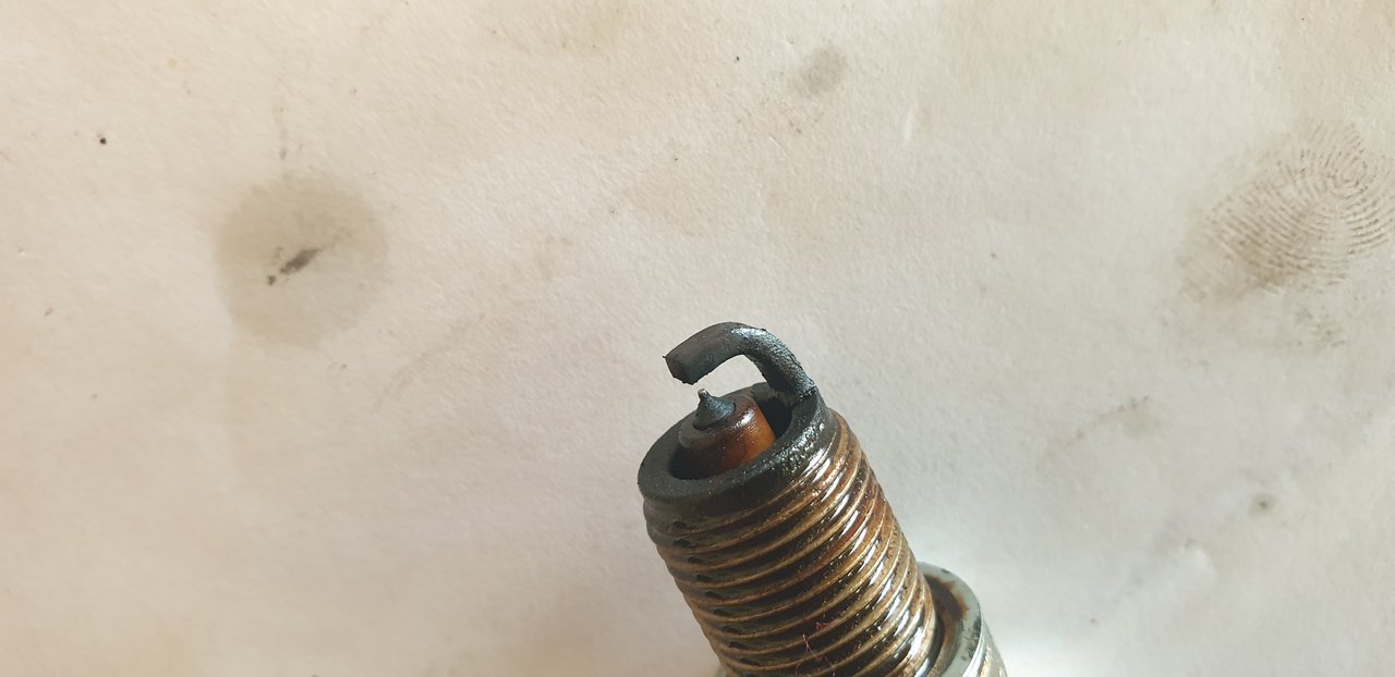

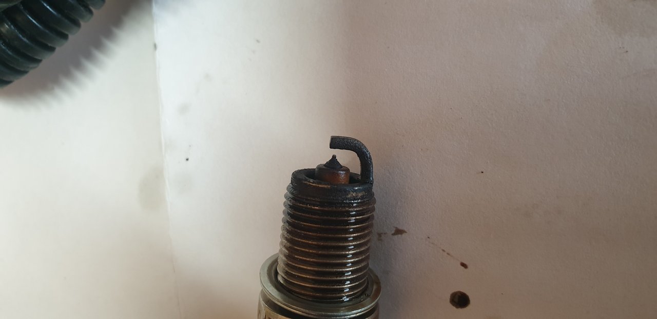

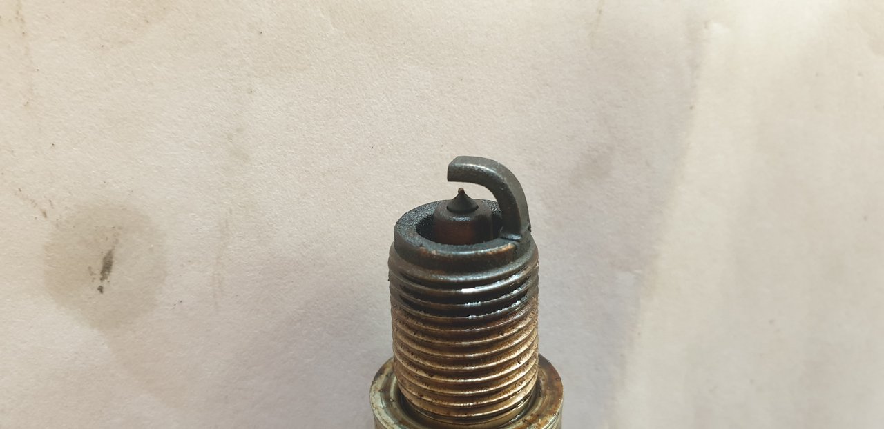

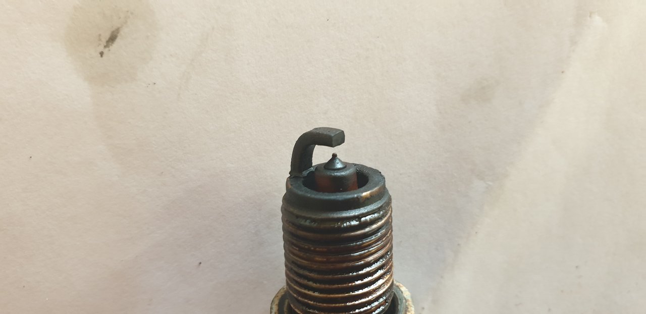

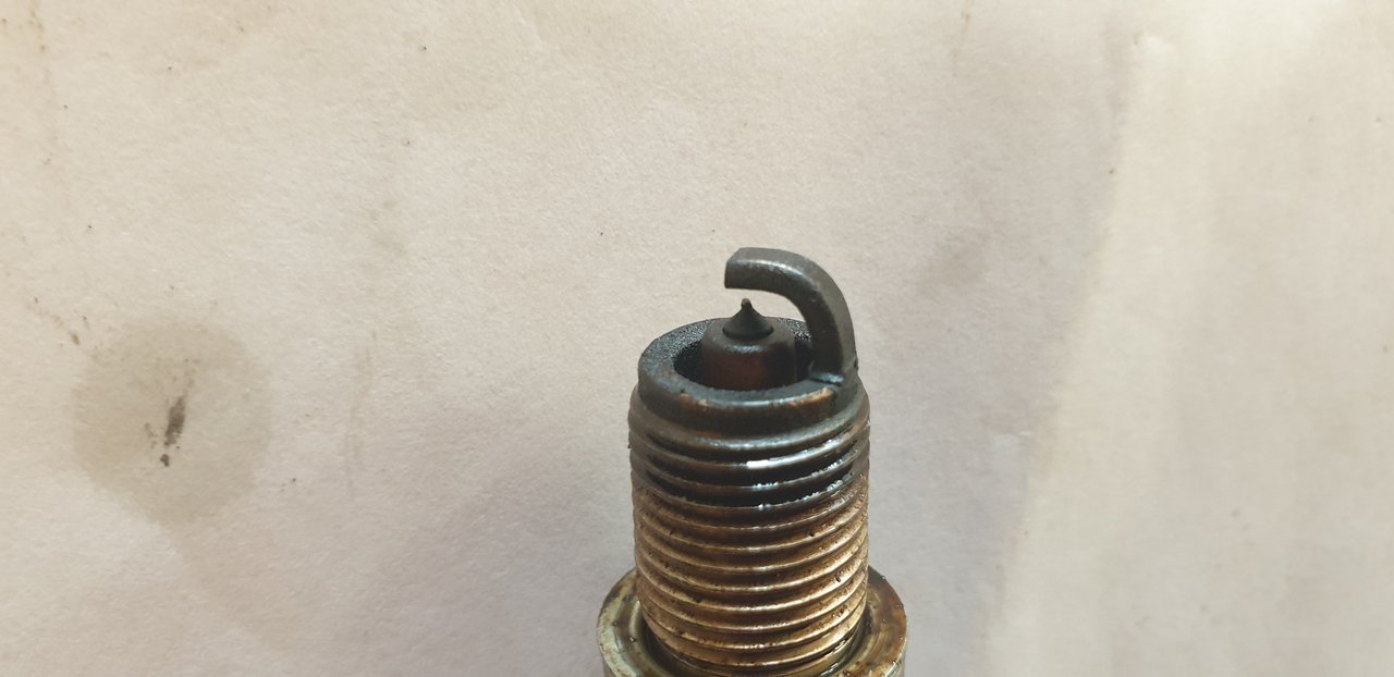

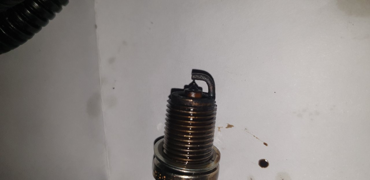

I then turned to the CL500, as I wanted to remove and inspect the spark plugs.
All removed....
I took a look at the plugs. They look very dirty and I cannot imagine they are the best, but I am not knowledgeable enough to know if they are particularly bad...
Here are a few random ones.
If anyone knows much about spark plugs, I'd love their thoughts...
But in any case, I have just ordered brand new plugs, and also brand new leads too, which I will replace in due course... I am hoping this will get the idling of the car back to where it should be!!![/size]

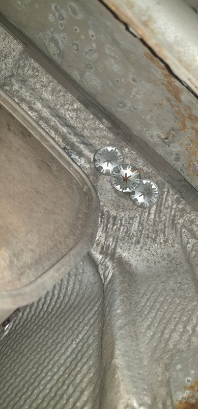

So then the last thing I did on Saturday was fix the exhaust heat shield in place on the Citroen C5, as it has been rattling.
In two places it had rusted too large for just one repair washer, so I interlinked three!

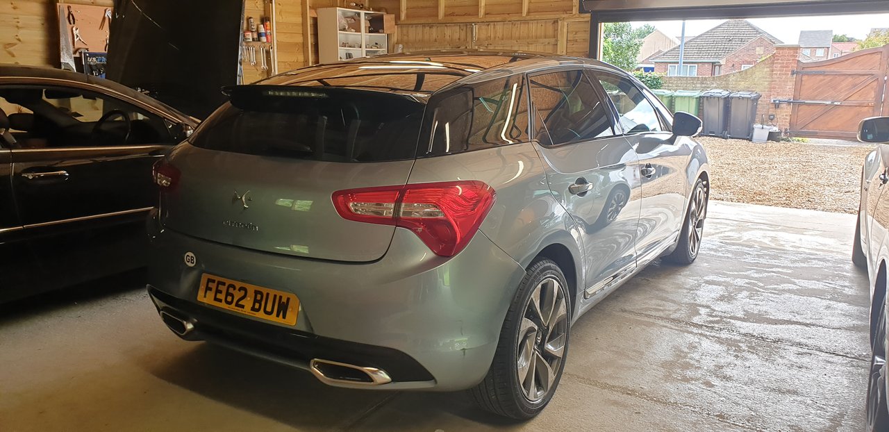

So I decided the time has come to pop it up for sale, and I gave it a clean so I could take some photos for the advert.
Here it is after the clean, I think its a tidy looking car for the age, and given there are a few knocks and scrapes...

Those plugs look fine to me, they're just in need of a good run to get them nicely hot to burn off all the cold-running deposits. I guess the car has not been out for a good long thrash in a while.
Do that and I think all will look a lot better...
That is a great way of checking gearbox oil levels.. I first saw this on the AL4 autobox and is better than the traditional level plug arrangement.
That old ATF looked quite mucky! Well due a change by the looks of it.
