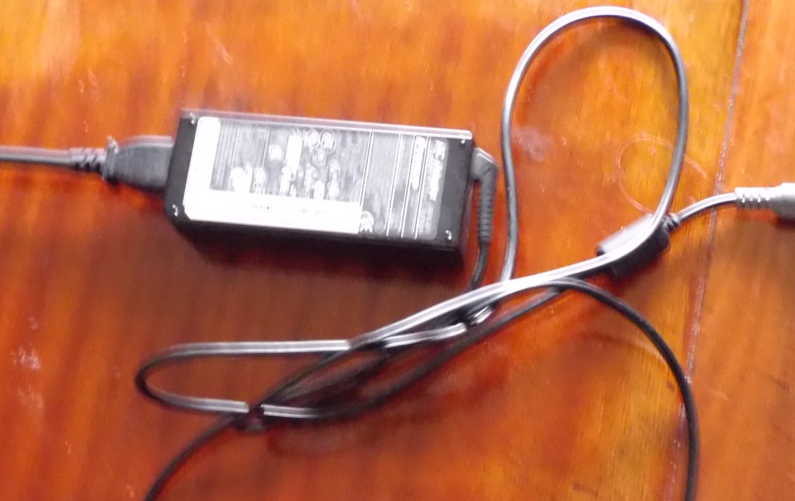

I'm going to sell off my Lenovo laptop, it sits here unused for weeks on end so if anyone needs one and would like to make an offer before I pop it on ebay I'll add some detail later.

I may be interested Gibbo as I have no backup now. The detaila I need to decide are:
Screen Size
RAM, size
HDD size and type
PROCESSOR make and generation
Ports
If you can list them I'll let you know

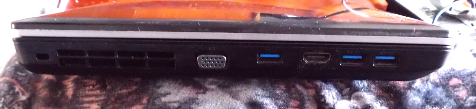

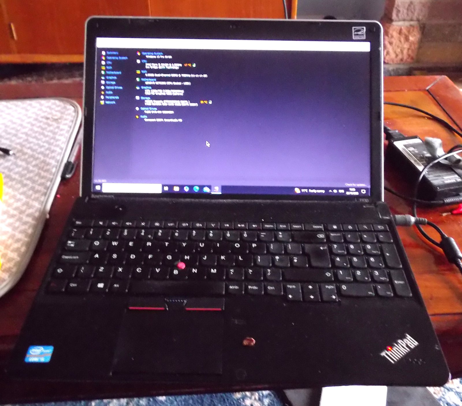

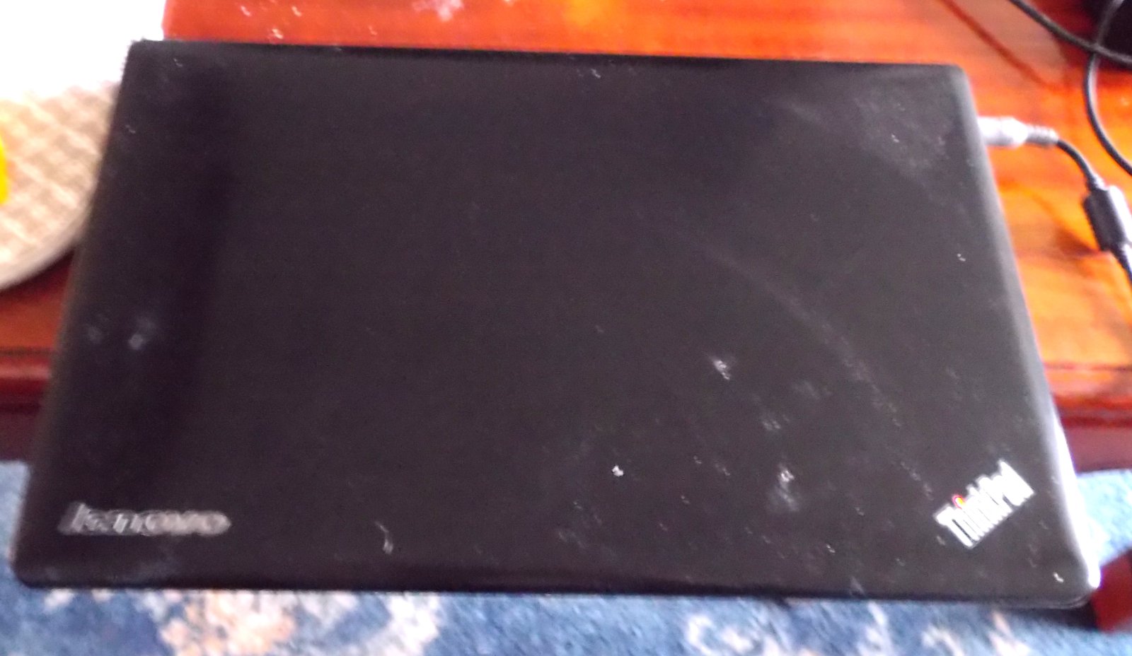

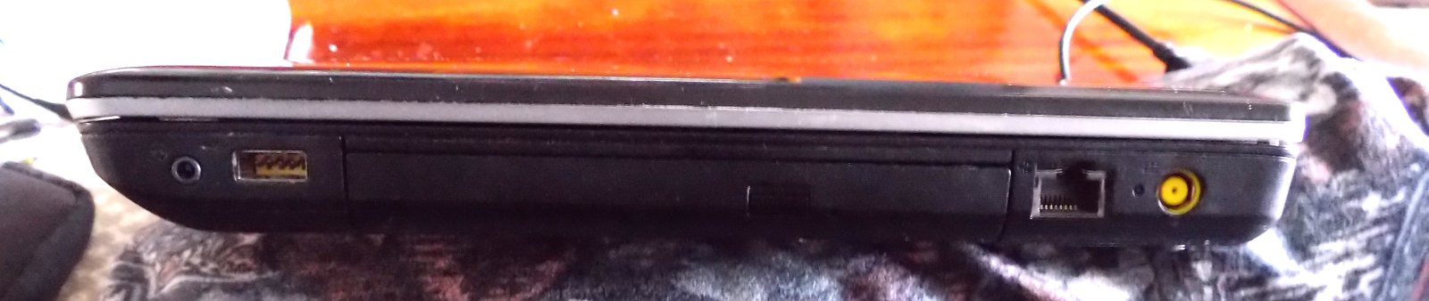

- x 2941
Here's a bit of info taken from the screen this morning but I'll be setting it back to factory before it goes. The top's cleaner than it looks in the photo.
