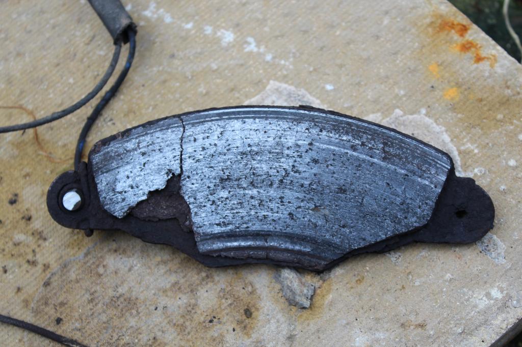

Right then here we go, "my man that can" and I spent some time together on Tuesday and Wednesday and he's replaced the brakes all round that new disc's and pad's, Here's a shot of the front brake pad's showing just how worn they had become...

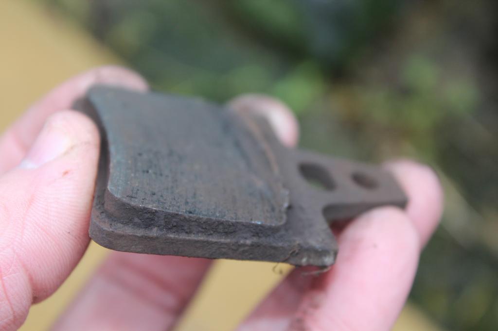

This one shows one of the rear pads, it shows the damage caused to the pads because they had become twisted, as you can see, there is a "lip" at the top of the pad, where it hadn't been touching the disc.
THis one shows the rear caliper, if you look down between the pads you get a better idea of the problem

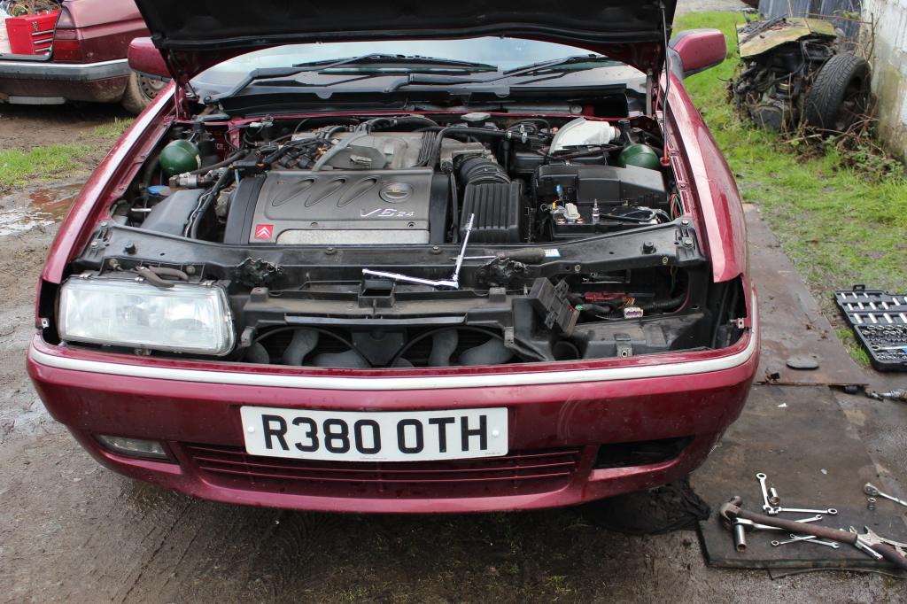

The next thing we looked at was the cruise control, with the help of Jim's guide to fixing it, and it turned out to be a split pipe at the opposite end to where it would normally split, however this did require the front of the car to have some surgery to make room to get at it.

did you check the rear calipers for the dreaded metal contact electrolysis?

... i nice dollop of copper slip between the faces and in honesty there wasn't that much alloy dust between them..

Copper slip or a nice piece of baking paper cut to slightly larger than the face size is the best trick long term mixed in with regular checks to keep them being a pain
