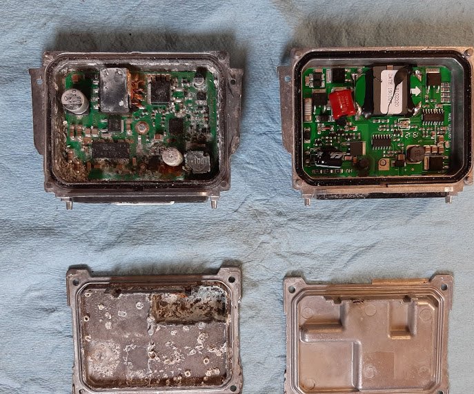

Here's the genuine VAG and aftermarket copy together...
Genuine on the left...

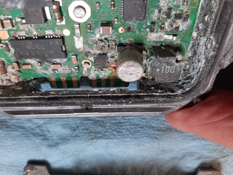

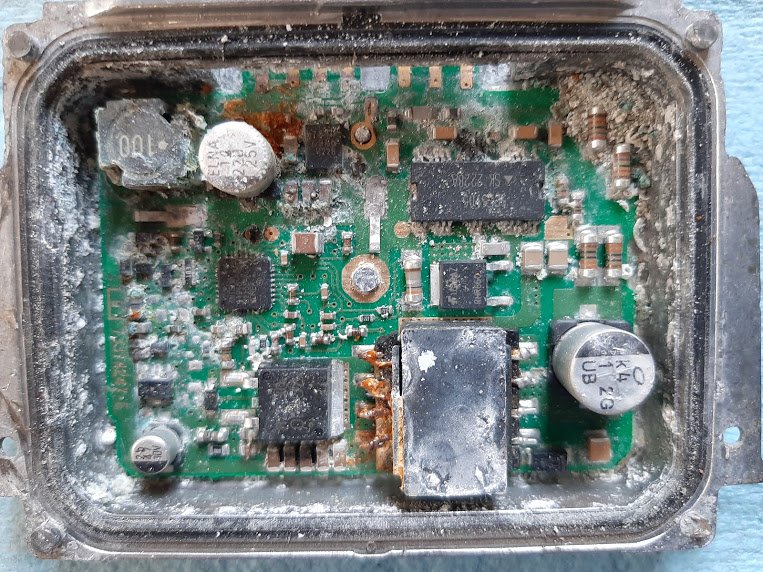

You can see clearly the VAG one has suffered serious water ingress and concomitant serious corrosion .over a long period.. I suspect because of a failed lid gasket...
Corroded VAG Ballast

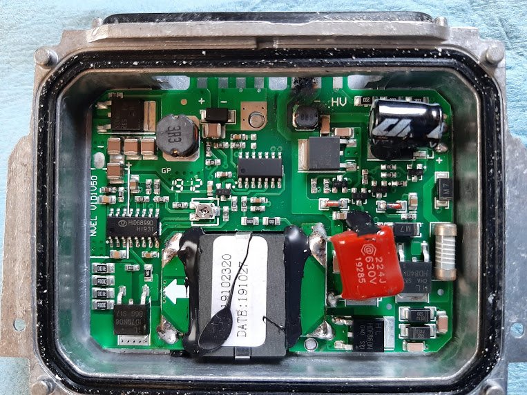

This is the internals of the copy...
Copy Internals
Copy Internals

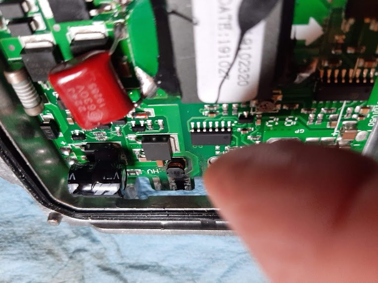

I can see why the copy failed... It suffered a flashover across its high voltage contacts. You can clearly see the scorching in this picture:
Scorcher!
Scorcher!
I suspect this is because the connector contacts on the printed circuit are only (badly) tin-solder plated rather than being gold plated as they are in the genuine VAG Ballast...

This may have resulted in a poor contact and the resultant initiation of a flashover which killed the ballast.
May I suggest you check the connector plug contacts for cleanliness and good contact to ensure the same does not potentially happen again... As the genuine one died from being very wet for a protracted period, there may be corrosion in the connector plug...
