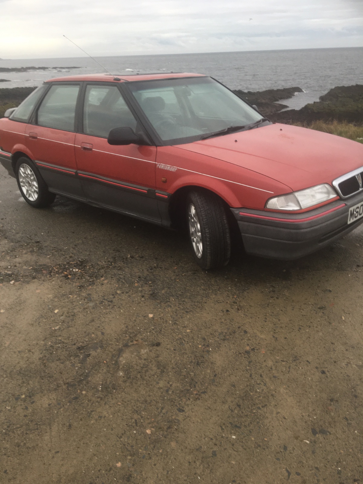

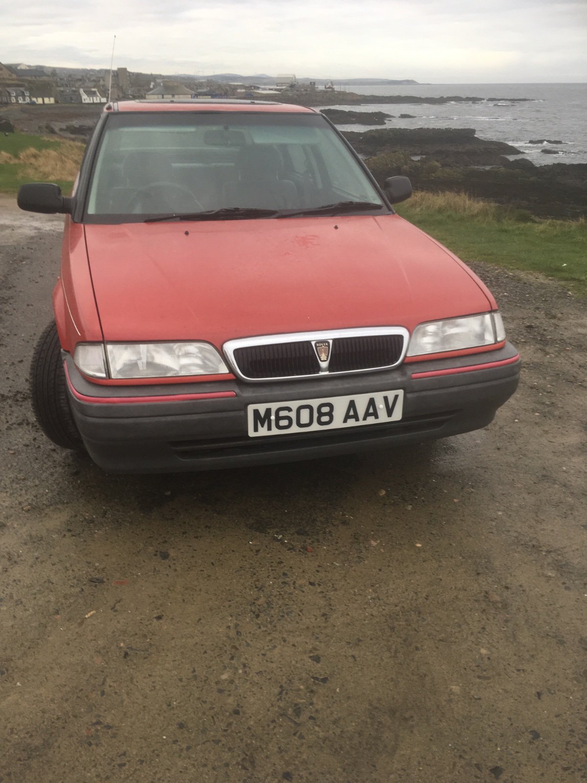

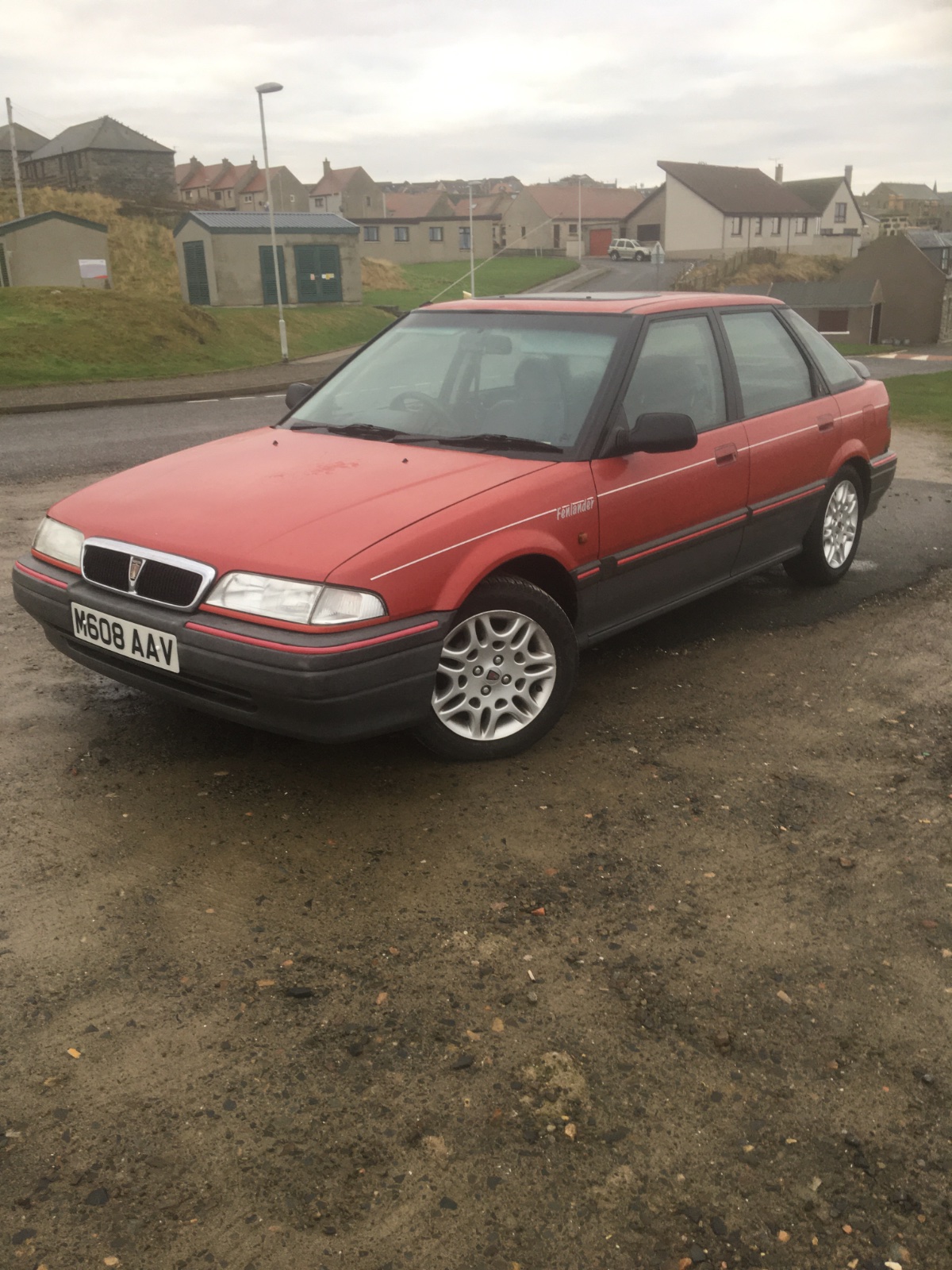

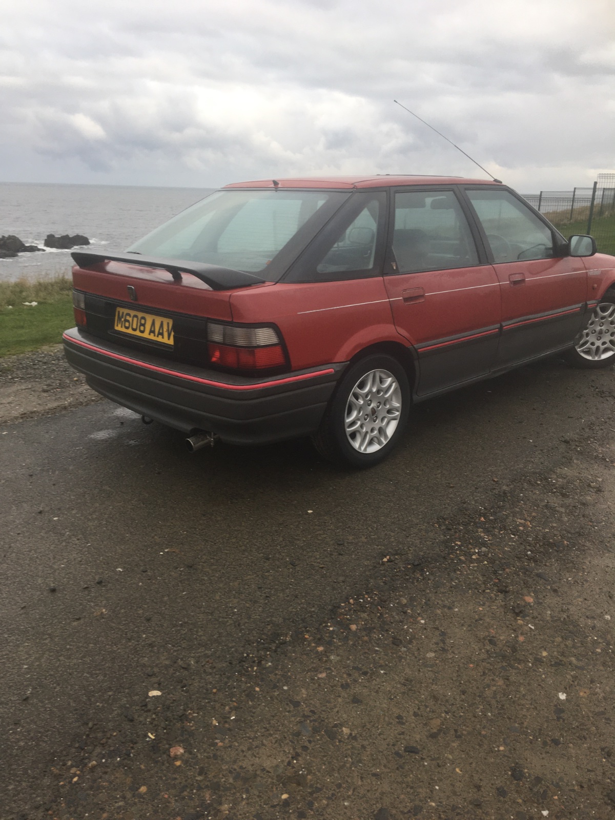

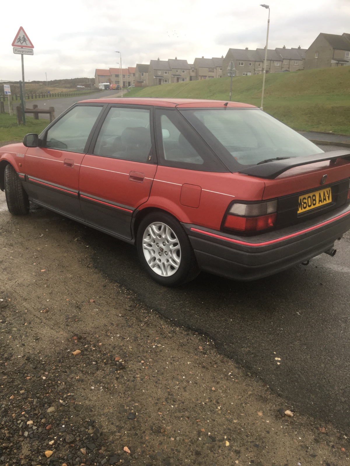

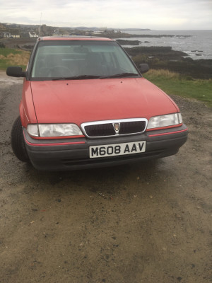

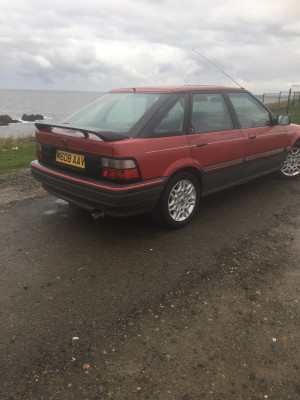

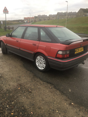

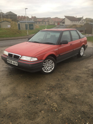

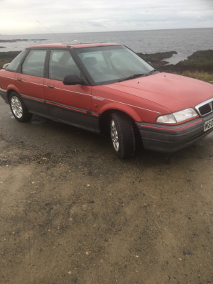

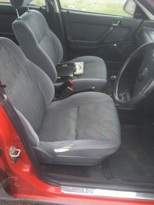

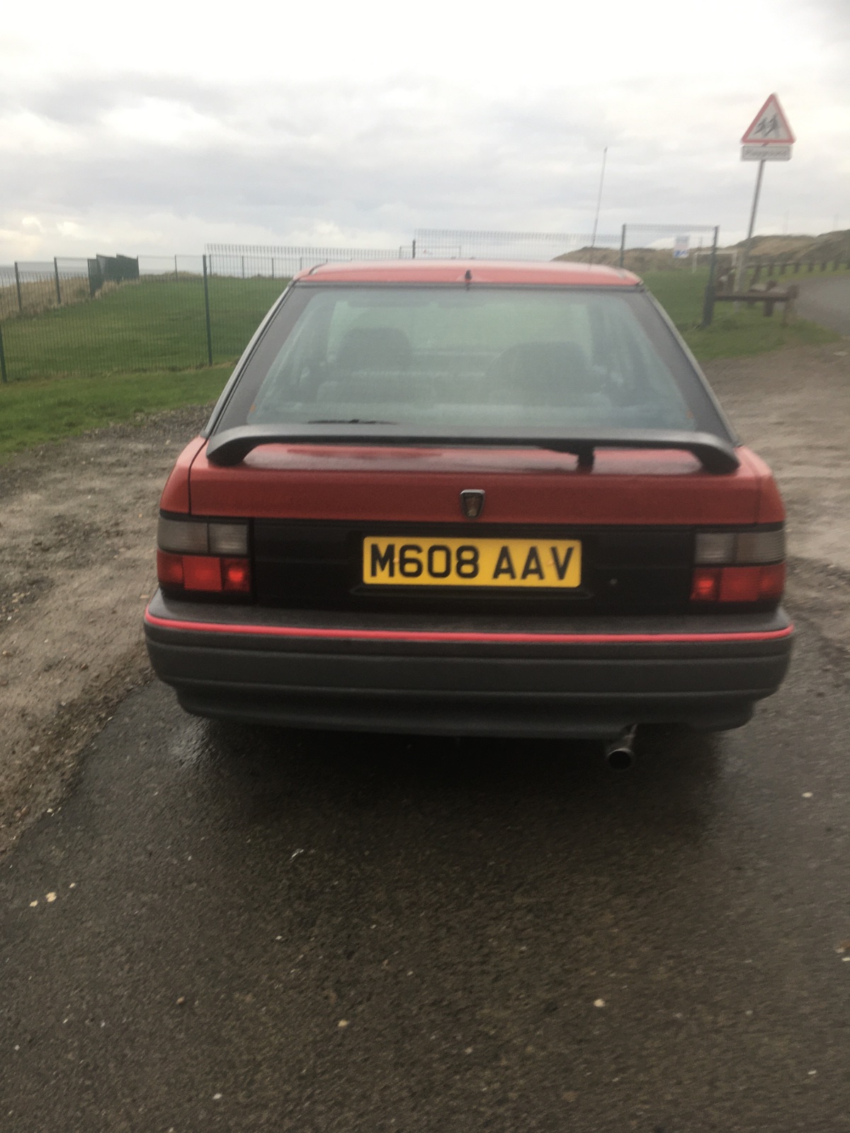

Here’s the rover in all its glory. Pics do flatter it a bit, the paint is poor, lots of fading and lacquer peel. And a couple of minor dents! What do you expect it’s a 25 year old rover. It drives ok with a typical xud rumble at idle when cold, but ok on the move. It’s for banger duties at the moment, so deliveries for the meantime. I now need a bit of a clear out. Shauns 107 is here, out of mot, he has the Vw bora now which he is intending buying outright. I’m going to keep the hilux, I love driving it, I have a Hyundai Getz here, it belonged to a friend who has left the country and I’ve been left to sell it for her, the Leon I should keep but it is so boring I have no real impulse to drive it so it’s due mot and going to be sold on soon. The rover, too new an arrival yet to decide on its future.

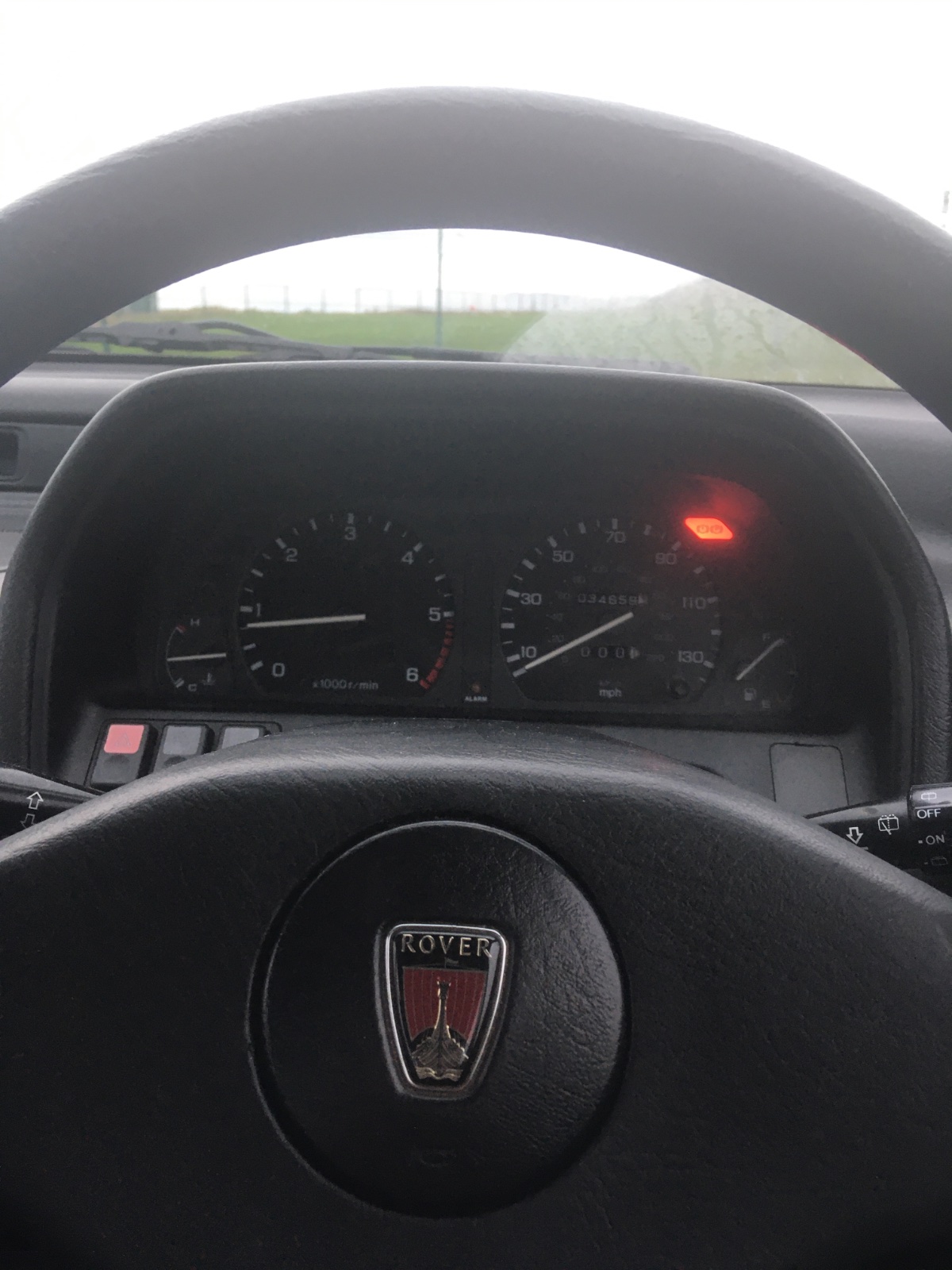

I think it has the MT gearbox Jim. The speedometer doesn't work, the previous owner had fitted a digital one which he has left. The car has been lowered, but not stupidly low, and has a sports back box on it. Its riding on a genuine set of rover alloys with what looks like recent tyres, although an unknown brand. I havent consulted the handbook/service book yet, the wallet with the books are there. Also 2 Haynes books of lies, one for the rover 200/400 petrols and one psa diesel engine.

The speedo problem, if an electronic one, could well be the sender in the gearbox... If the speedo is cable driven it could be just a duff cable or stripped gears in the gearbox sender...
In either case the sender/gear drive will be easily replaceable with spares from any PSA 'box and new speedo cables can be remanufactured if not available as a service part...
I'm looking to get Daffodil's remanufactured as her speedo, like so may PSA mechanical speedos, is very flickery now...

I had an issue with the speedo on my BX being erratic (bouncing anything up to 5MPH either way), and a friend suggested I dribbled a little 3 in 1 oil down the cable, which I did. A couple of days after I did this the speedo settled down to a stable reading.

I need to try exactly that on the BX here, James. Oddly, better in cold weather (down to 5°C early morning), but waggly between 40 and 60km/h. Will try some lube.
I do remember a very odd Leyland/A-R speedo cable fault, where the cable could "wind up" gearbox oil, and bring it up into the instrument cluster. I think a one-off.

Don't use WD40 Chris, works initially but once it evaporates it makes it worse I found. I used sewing machine oil on my BX and as James said 3in1 is good too.

Thanks - will try a light oil. WD is OK for freeing things up, but no great shakes as a lasting lubricant.
3-in-1 used to have a grizzly reputation for going gummy, and leaving a stiff varnish-like residue behind - good for protecting your lawn-mower, but not so good on light machinery, and certainly not clocks or sewing macines! The giveaway was the yellowy stuff which accumulated on the top of the 3-in-1 cans after months of use. Sun Oil did rather well out of this, by marketing their light machine oil as "non-gumming". Hopefully the 3-in-1 stuff was long ago reformulated.
