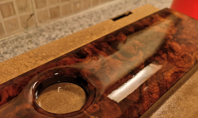

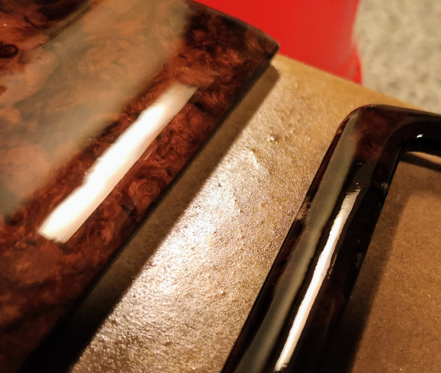

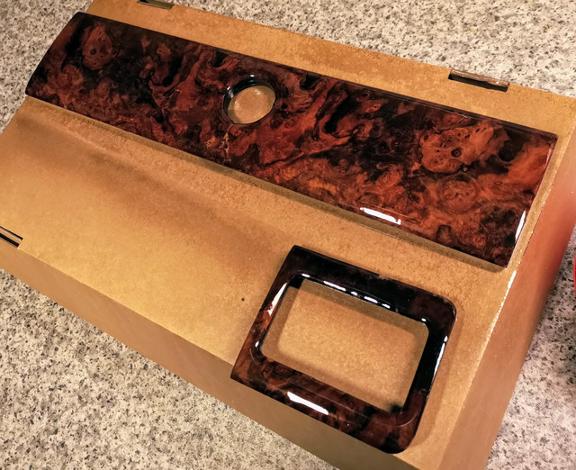

I wasn't 100% happy with the finish I had achieved on the glove box lid. It ended up looking a bit less smooth than I was really aiming for. So today I pulled the trim back off and gave it another few coats. Is now looking a lot better.
The helpful bit of workflow I added to the mix today was to set the heating running in the back of the van to a nice toasty 25C and use that as my drying room. That understandably sped things up a good deal and seems to have helped achieve a better finish.

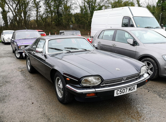

So despite the weather I decided to try to get to the breakfast meet up this morning.
Despite a not insignificant amount of debris on the road there I got there without incident. 1700kgs of very low car is a pretty good formula for "doesn't care about side winds."
I wasn't the only one mad enough to be there either!
This was the point that I got the call telling me that the roof was about to blow off the shed, so I had to leg it back to base.
Despite the legendary hate that all British cars are apparently meant to have for rain, the Jag handled getting well.and truly drowned today without complaint. Though I do apparently have a point of water ingress I'll need to look into.
Chasing that is a job for when there are less bits of tree getting blown around and inserted into my ear by the wind. To be fair though, she had been travelling at speed through absolutely torrential rain immediately before I spotted that so I don't really begrudge the car for letting a bit in.

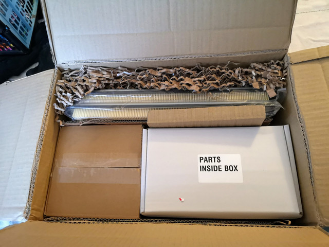

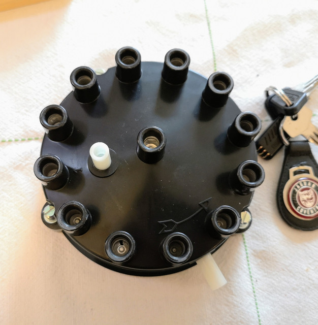

Little care package arrived this morning.
Contents:
[] Air filters (X2).
[] Distributor cap.
[] Rotor arm.
[] Oil filter housing gasket (not sure if I need it yet, but it was £1.34, so made sense to get it in stock).
[] Number plate light lenses (X2). Quarter of the price of used ones on eBay for some reason.
[] Drive belts (PAS & Alternator/Fan).
The sheer size of the distributor cap still surprises me. Keyring for scale!
I've also got a set of timing cover gaskets (the later type as used on the 6.0 version which are apparently actually oilproof) on their way too. Once they arrive I'll get stuck in. I want to clean up and lubricate the distributor advance system, but given the amount of bits that need to come out to get at it, I figured that it made sense to get everything together so I could tick as many things off in one pass as possible.
I know the distributor cap was changed back when the previous owner had the car, but the stub for the breather system has snapped off (looks like someone has tried to glue it back on at some point), so it needs changing.
Need to confirm the hose sizes involved then will get some marine hose ordered up with a view to getting the fuel system gone through end-to-end so it's all guaranteed to be ethanol safe. Given the lack of any markings whatsoever on most of it my assumption is simply "I don't consider it safe until you've changed it." Especially in light of the V12 XJS being somewhat known for engine bay fuel leaks with the obvious potential for fire as a result even before they went and stuck ethanol in all of our pump fuels!
