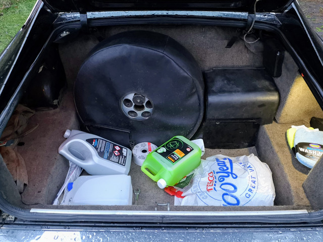

Have changed the bulbs in the boot lights for two 5W LED ones I had rolling around. They've got a horrible colour temperature, but for the boot I'm really not bothered about that. That's basically why they have been following around the "misc automotive lamps" box for the last couple of years.
The difference is obvious here where one is the original lamp, the other the LED...there is actually enough light to be useful now.
The warm colours of the carpet manage to make them look less horribly blue too, which is a bonus.

Seeing you posted that image, I should point out that the engine ECU is behind the trim panel to the right of the battery. The idle mixture screw is accessible there, but requires a special tool which can be bought or fabricated, or you can open up the ECU and cut a screwdriver slot on the adjustment shaft.
Zelandeth
- Posts: 5328
- Joined: 16 Nov 2014, 23:36
- x 1607
Re: Zel's Fleet Blog - Xantia Activa, Jag XJ-S, Sinclair C5, Mercedes 208D, AC Model 70.
Trust Jag to put the idle mixture control in the boot!

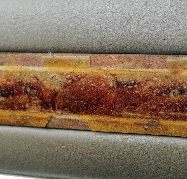

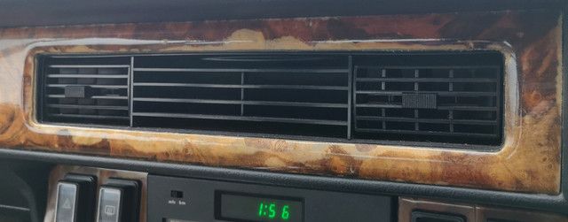

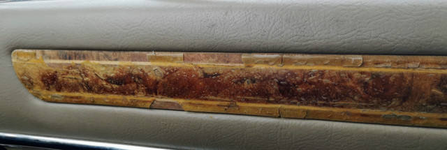

Something I need to have a look at is what I can do with the wood trim. It actually looks to be sound, it's just the clear coat that's coming away. Just like a Dante Red Citroen!
The rough plan I've got in my head. Obviously once I've figured out how to get it off the car.
Step one will obviously be to strip the existing lacquer off - I'm just assuming it won't all flake off and I'll need to get some stripping agent involved. I don't think sanding it off is a good idea as there are areas where it's already missing and I don't want to create pits. I also have no idea how thick the veneer is.
Step two will be to go over it with the sander with some very gentle paper on just to smooth out any bits which are standing proud.
Step three. Apply a coat of stain to give it some colour.
Step four. Sand over it again with high grit paper again to key the surface.
Step five. Apply goodness only knows how many coats of clear coat. Given the way it's peeled off I'm guessing the original stuff was water based. I imagine polyurethane varnish would be the normal approach for this sort of application? Though part of my brain does wonder why normal rattle can automotive clear coat couldn't be used...saves me trying to avoid visible brush strokes, lost bristles etc...and I already have it in the garage.
Nope...never done anything like this before so I'm making it up as I'm going.
It's very much the first thing anyone notices when opening the door these days, so I'd really like to improve it. Doesn't necessarily need to be absolutely perfect...but anything has to be an improvement.
Open to advice from anyone who has experience with restoration of things like this if I'm barking up totally the wrong tree. This is the first car I've had with actual wood in, never mind the first time I've had to restore it.

I did the wood trim in my 1985 XJ-SC, I think that the existing coating does come off with a suitable solvent, but I can't remember what I used. I do remember having several attempts at getting a perfect unblemished final coat on.
Zelandeth
- Posts: 5328
- x 1607
Don't suppose you remember what was involved in actually getting the trim out of the car do you?
Door trims and glovebox I imagine will be screws from the back. Bits on the dash are a bit less clear as there's no obvious way to get to the back of the panel without dismantling half the car.
Though dismantling half the car is probably the correct procedure. It's a Jag after all!

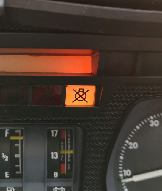

However on departing the house to run one of many errands I was presented with this:
The way the lamp failure system works in the Jag is that if an appropriate amount of current flows through the lamp, a bimetallic switch in closes after 10-20 seconds after the respective lighting circuit is turned on to tell the system that the lamp is good, at which point the indicator on the dash goes out. If it doesn't detect this "lamp good" signal, the indicator stays lit.
In this case examination revealed that a number plate light was indeed out. Simply tapping the fitting restored it to operation though rather than the lamp needing replaced. So I'll add "clean number plate light contacts" to the to do list.
Good, because I could have done without standing in the pouring rain sorting that!
