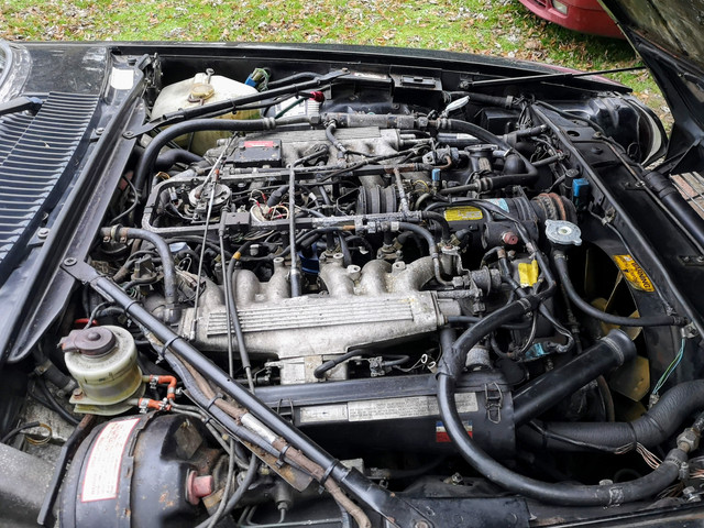

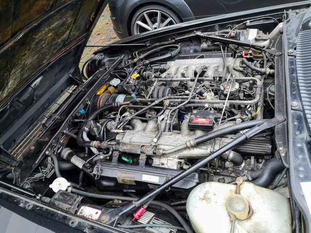

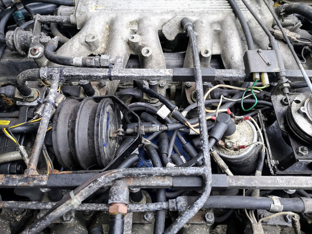

Figured it was time to stop cowering in fear and actually open the bonnet again.
No huge surprises to be honest. Hasn't used any detectable amount of oil or coolant on the trip home which is nice to see.
Quite a lot of surface corrosion on everything which fits given that the car has barely been used for a not insignificant number of years.

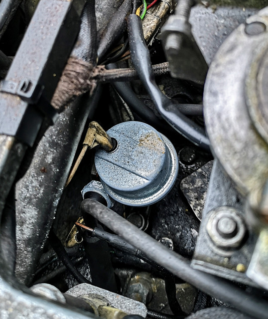

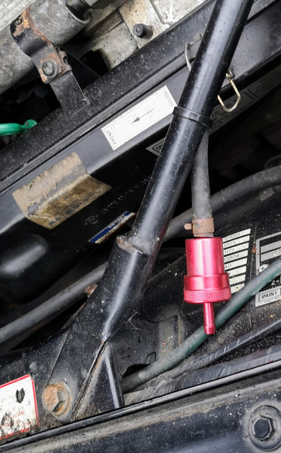

Slightly intrigued by the little red anodised cylinder by the nearside brace.
In the absence of anything to suggest the contrary I'm guessing this is either a filter/silencer or a check valve attached to a vent line of some description as there doesn't seem to be anything nearby which could connect to it. Guessing the original unit died of old age. At the very least this one will get painted black as it currently looks daft.
Looks like the distributor cap will be "fun" to change.
The HT leads at least seem to be relatively recent - based on how supple they feel anyway. Even though it will be an utter pig to get to, I'll probably change the cap sooner than later as it's the sort of thing I usually do as a matter of course on any new car.
The throttles definitely need balancing I reckon. Just based on how much air it feels like is being pulled through each of the air intakes it feels like the left bank is doing far more work than the right.
The raspy noise when the throttle is blipped all sounds to be exhaust. It's hard to tell from a video, but in person that noise is very definitely all coming from the rear of the car.

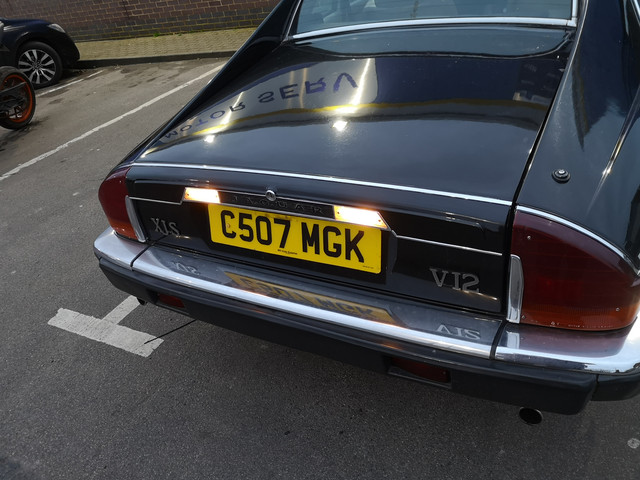

One fault I had noticed was that I only had one functioning reversing light and that looked very dim. Quick examination revealed a dead 21W lamp in one side and a 5W one in the working light...explains why it was so feeble. Nice easy fix.
Helped by Jaguar having used stainless steel fasteners on the light clusters...oh how I wish Saab did...

Those under-bonnet photos explain why you prefer the bonnet shut! And I thought P6B and 2.5XM were cluttered enough. Looks like Jag designers just went for function, and to hell with how it all looked. V6 Citroen a model of tidiness by comparison!

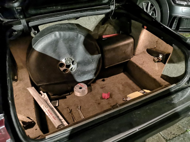

Do have a Haynes manual at least. This lot was in the boot.
The worst thing about that engine bay is that it's pretty much that packed all the way down...not just the top layer.

That is the distributor breather filter. Earlier cars with the V12 engine had a tendency to collect fuel vapour inside the distributor cap, resulting in the distributor exploding and showering pieces of cap around the engine bay. It has never happened to one of mine, and I think that there was probably an upstream problem causing the crankcase fumes to have lots of petrol in them.Zelandeth wrote: 11 Jan 2020, 21:19 Slightly intrigued by the little red anodised cylinder by the nearside brace.
So Lucas, when redesigning the distributor for the HE version of the engine, added a "flash shield" below the distributor rotor and a ventilation system that sucks fresh air through the distributor, the thing you see there is an after-market replacement for the filter, which is usually a clear plastic fuel filter with the open end of the hose tucked away under the bracket that the big diagonal brace bolts to.
The distributor caps don't give trouble (other than the exploding ones).Zelandeth wrote: 11 Jan 2020, 21:19 Looks like the distributor cap will be "fun" to change.
I strongly recommend that you remove the distributor (I can give some tips on making that task vaguely possible), so that you can wash the original grease (if still present) out of the advance mechanism and lubricate it properly with some oil. You also need to check that the vacuum advance capsule is still working. Ignition timing is crucial to fuel economy on these engines, and unfortunately they were designed before electronic control of timing advance was a thing. Electronic timing was fitted from 1988½, with a Magneti Marelli system, but it is also flawed and not really practical to retrofit.
The idle air is all taken from the LH intake which gives a very misleading impression of the throttle balance. The official procedure for balancing is also misleading and usually produces the wrong results.Zelandeth wrote: 11 Jan 2020, 21:19 The throttles definitely need balancing I reckon. Just based on how much air it feels like is being pulled through each of the air intakes it feels like the left bank is doing far more work than the right.
If you have an exhaust gas analyser, the best way to get the idle balance correct is to adjust the throttle stop screws to get the same CO reading on each exhaust (as the inject fuel quantity is always identical on both banks).
I use a simple manometer tube for balancing the throttles above idle.
That looks like the correct one, although there were at least 2 similar looking devices.Zelandeth wrote: 11 Jan 2020, 21:19 The oil pressure gauge sender was investigated while I had the bonnet open (I still love the opening/closing action and the way the latches pull the bonnet closed when you reset the handle). No part numbers I can see on it.

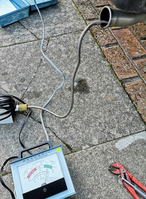

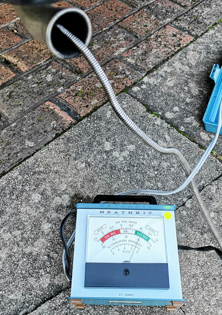

The throttle actuation rods were waaaay out of whack, meaning that the throttle pulley was resting a good 1/2" off the closed throttle stop. This was due to the left one. The right one is currently seized in its bushing but has been left soaking in Plusgas so I'll give it another poke in the future. At least with my foot off the throttle the throttle position sensor will be seeing that the throttle is actually closed now.
When I checked everything at rest after that was adjusted, we had 4% CO on the left bank and 0.5% CO on the right.
After adjusting the stop screws I was able to get things stable at 1% on the right and 1.2% on the left. I was kind of hoping I could aim for 1.5% (smack in the middle of the 1-2% quoted in the handbook), but I couldn't open the driver's side up any further without opening the throttle itself because I couldn't adjust the actuating rod on that side.
Right:
Left:
It's a lot closer to correct than it was. The car smelled very obviously rich before, it doesn't now so it seems I've done something right. Idle is very obviously smoother too.

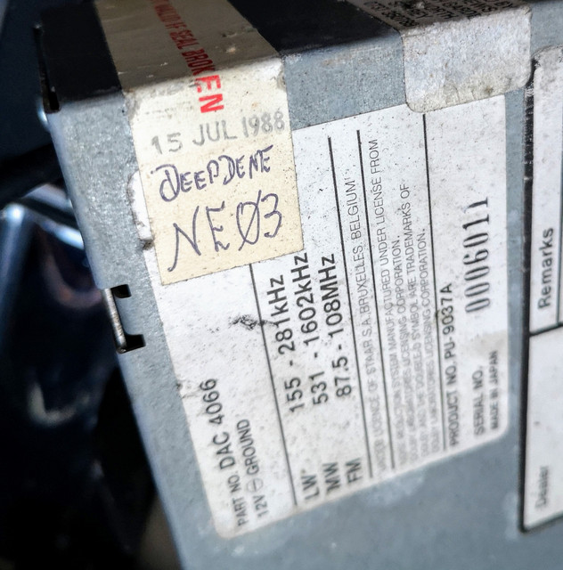

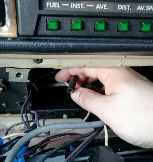

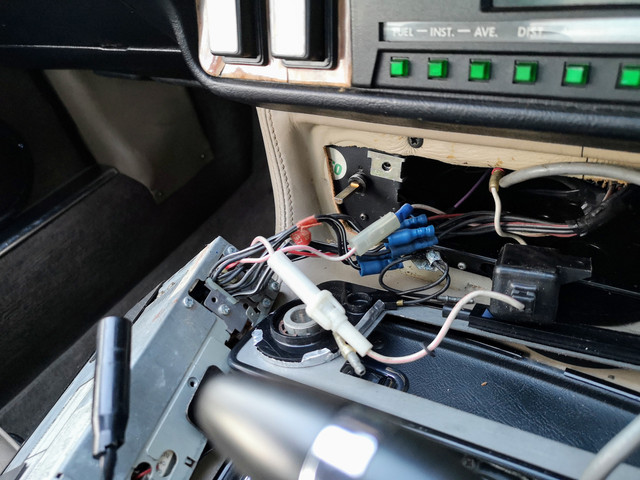

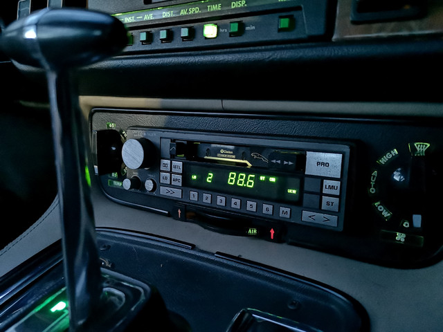

Next up was some detective work to figure out why the lighting in the stereo was refusing to go out.
Pulling it out of the dash revealed clear evidence that someone has been in here before.
Have to wonder if this was more recently when the speakers were changed or if it was back when the head unit was replaced back in 1988.

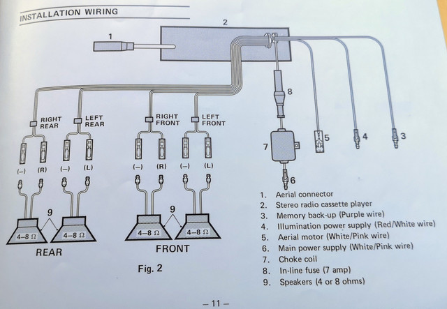

Helpfully the handbook for the head unit contains a clear wiring diagram which made the detective work a lot easier.
Didn't take more than a couple of minutes to track down that someone had connected what should be the permanent live for the memory backup to the line which should be connected to the dash lighting circuit. That will be why it was always lit up then. Goodness only knows how long it's been like that.
At first I couldn't actually find the wire for this, but after groping around blindly for several minutes I found this.
...Which when tested turned out to have 12V present on it when the headlights were turned on. That will be the illumination feed then.

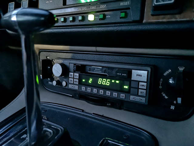

Having connected this to the appropriate terminal, tested it and stuffed it back into the dash it initially didn't work. Well it did but I couldn't receive anything because the terminal for the power antenna had been pulled out. Second time round, having more carefully routed the wiring bundle we had better luck.
Headlights off:
Headlights on:
It's hard to tell from the photo, but the display is dimmed when the lights are on. Sadly the bulbs which should provide lighting to the buttons on the stereo have burned out, so I'll need to conduct some microsurgery to sort that at some point in the future. For now though it has solved the problem with it refusing to switch fully off. Do wonder how long this has been causing issues with battery drain...
The four screws which were meant to secure the cage for the head unit to the dash were also missing...so someone didn't take much care when they were in here last.
Headlights off:
Headlights on:
Feels like a reasonably productive afternoon.
