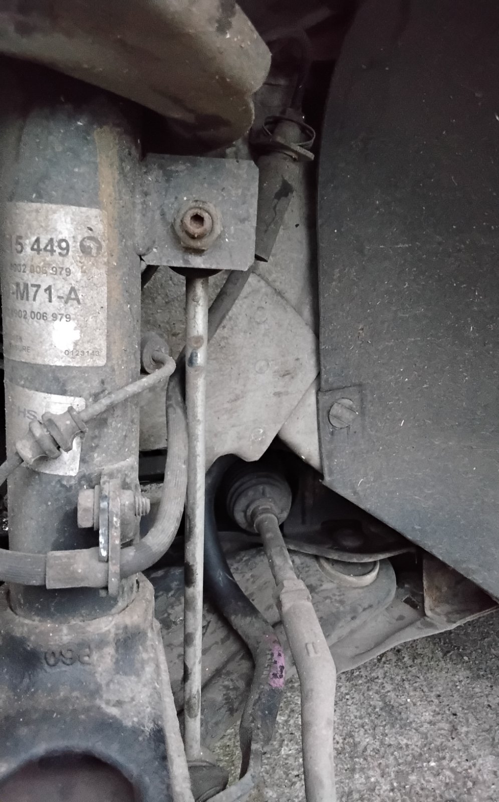

#-o #-o not for the clutch as ,Gears ok, clutch brilliant all working as it was made to do, BUT Job now is lower balljoints caught another bloody pot hole over the weekend ..... get one thing done then this. Also from this morning when i was diagnosing the issue , which side to side wiggle of the wheel car jacked up of course , made the lower balljoint wiggle and dance like a fish out of water !!!

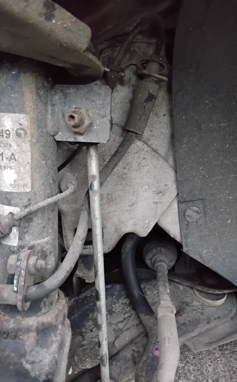

The other issue ..
Correct me if im wrong but im sure that flexi hose isnt routed correct ?
:-D
Forum Treasurer
Posts: 12578
Joined: 07 Aug 2002, 17:12
x 1487
Re: Citroen c3 picasso
Unread post by RichardW »
No, that should be in front of the ARB link; surprised that hasn't failed an MOT!

Me 2 , only thing i can think of is when i had the clutch all done after the mot the drop links were going to be change then the mechanic as i recall rang me up & said they didnt need replacing so put it back on, i had all the front suspension parts put by as a just incase , but was told everything was ok , so im putting it down to a lapse of concertration , im going to be changing the lower wishbones hopefully in the morning so will sort it then. Next time i see my mechanic im going to mention it , plus a kick up the ass too. Thanks to another pot hole in the dark & rain ive now got to do a job i was hoping not to do till spring . Oh well ..

NS lower wishbone all replaced brake pipe now sitting where its ment to be. OS will be done another day , thanks to thick hard drizzle just as the wheel was being put back on so todays weather finaly put the mockers on the other front side being done . I did how ever jack up the driver side and tested for any play , none at all, very pleased, so the passenger side was as lose as a secret on TIKTOK :rofl2: :rofl2: :rofl2: :rofl2: :rofl2: :rofl2: :rofl2: :rofl2: :rofl2: :rofl2: :rofl2: :rofl2: :rofl2:

Well done Husky, good to get that flexi hose back where it belongs to ensure it doesn't get rubbed on the drop link!! :-D
