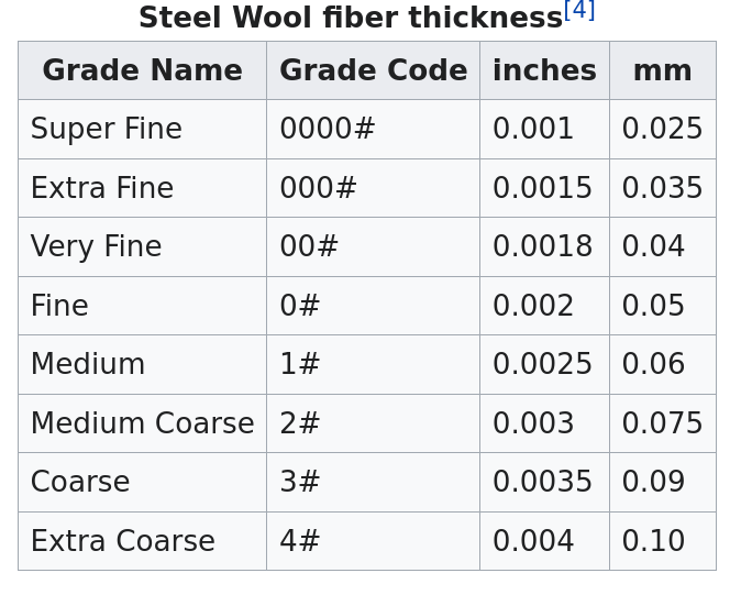

For the final five coats I had dug out some wire wool (doesn't scratch like sandpaper and is better for curved surfaces) and discovered some that was like cotton wool, very fine and soft, that 'polishes' the varnish but leaves microscopic abrasions for a further coat to key to.
I imagine that that would be a possibility for cleaning glass/plastic lenses. I'll give it a go on my specs (not).
Daughter binned her Megane with the Milky Headlights so can't experiment on that.
No label on mine and haven't a clue where I bought it, or why, but it is probably 00# or 000#.
Used 2# to prepare it, mainly as I had been using it to prepare my shovel for painting.

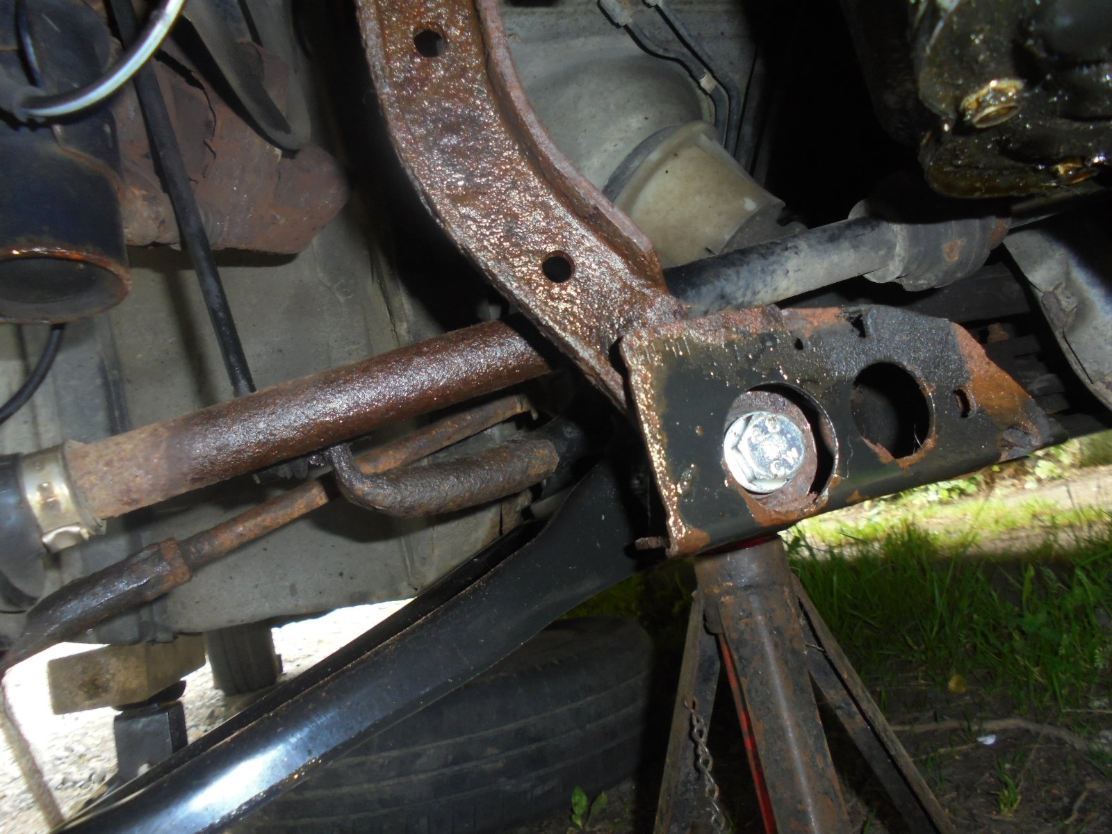

I havent yet tried the next stage of renovating the headlights yet, faffing about with that lower arm.
One of those very simple jobs which took the Autodoc guy all of 4 minutes without using an anglegrinder.
Anyway that came off and new one arrived Wednesday simple fitting job. Already took the you tube tip of having the driveshaft and hub in as horizontal a position as possible to get the arm into place. True enough easy.
Three bolts and nuts to fit, starting with the rearmost then the front-most long bolt which on the Micra goes through a subframe mounting link with a bush, before going through the bush in the arm.
Easy enough to line up the bush in the arm, but the subframe link I was finding frustratingly impossible. Abandoned it for a couple of days. Today I had a brainwave. Like a good boy I had mounted the car on an axle stand which I tend to place under the subframe as a matter of course but with the Micra the lower arm front bolt when removed allows the subframe to be "free" at the bottom end bush of the subframe link. With the weight of the car resting on the axle stand the subframe is free to rise as far as the link bush allows and the holes dont line up.
The solution jack the car up off the stand, and hey presto the long bolt simple slips through the subframe link bush, and the lower arm bush, and probably 2 hours of frustration the other day, which would never have been solved that day, was solved this morning in a matter of seconds.
The words maybe don't explain it too well, and the picture probably not much better but at least its done now!

Well done, it does look like the upper arm and drive shaft could benefit from a coat of Kurust and then black hammerite to give them a few more years!!

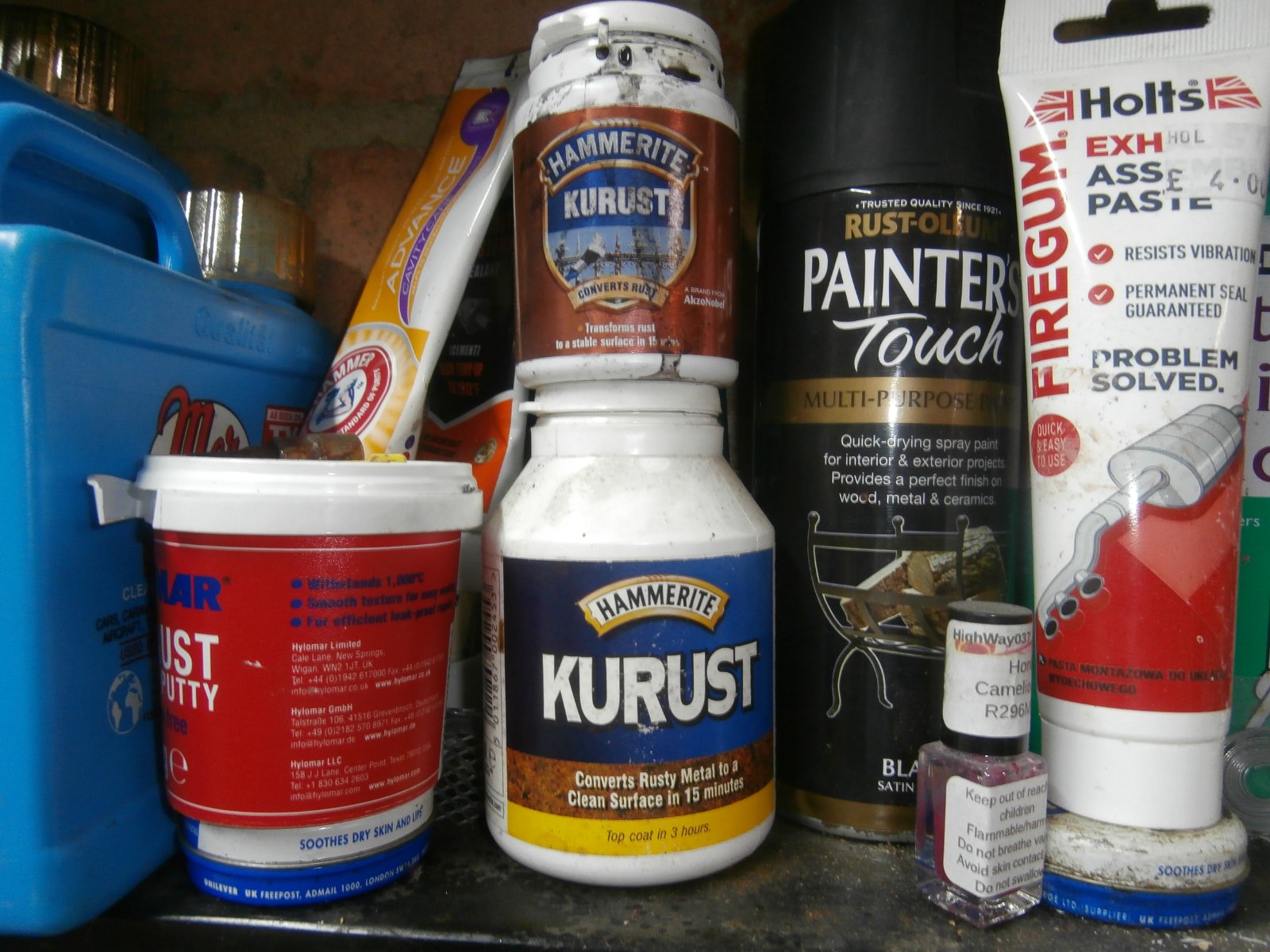

- Posts: 21345
- x 8156
Re: Bargain Basement Motoring
This is the stuff I was referring to, available from many outlets around here!!:

I have to ask - what do you use the Holts Ass Paste for ?
Burning holes ?

Its great for treating flatulence, as you can see it says on the tube Resists vibration, Permanent seal guaranteed!!bobins wrote: 23 Jul 2022, 21:11 I have to ask - what do you use the Holts Ass Paste for ?Burning holes ?
