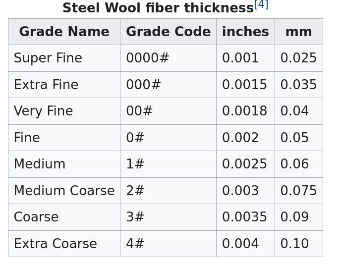

For the final five coats I had dug out some wire wool (doesn't scratch like sandpaper and is better for curved surfaces) and discovered some that was like cotton wool, very fine and soft, that 'polishes' the varnish but leaves microscopic abrasions for a further coat to key to.
I imagine that that would be a possibility for cleaning glass/plastic lenses. I'll give it a go on my specs (not).
Daughter binned her Megane with the Milky Headlights so can't experiment on that.
No label on mine and haven't a clue where I bought it, or why, but it is probably 00# or 000#.
Used 2# to prepare it, mainly as I had been using it to prepare my shovel for painting.
