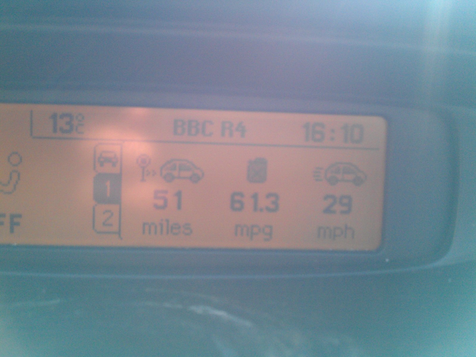

Mum's taxi today - off to Tesco first (where Citroen was showcasing new C3 and C4 Aircross), then picked up a "perch" chair she wanted to buy - all town driving. The mpg is still showing 61.3mpg! Usually it'll drop initially on warm-up and can be coaxed to recover that loss.

Meanwhile, the mpg has not only held at over 60 for the last 150miles, it's actually improving! I wonder if a lump of EGR goo broke off and caused a temporary restriction until being eaten by the engine? It's quite bizzare to have it go from high 40's to low 60's.
