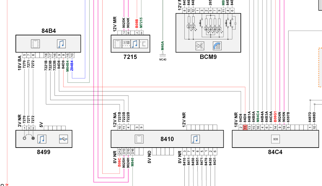

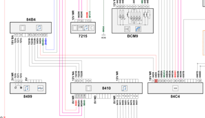

Well. it's beyond me, these diagrams just do not match up to your car - no matter what configuration I use. On one it shows 8499 : external audio input block - but no bloody cables from the USB!:
84B4 : portable multimedia unit ?
84C4 : independent telematic unit ?
On another diagram, the telematic option shows a USB on the front central console and connected to Audio unit - so that can't be it.
The other problem I have is the with / without services module - your specs don't say - but from the photo I can see you have the SOS and Service buttons (I assume these work). So the diagrams DO NOT match your car.
So whether trying to connect the usb directly to the RT6 and trying to play an MP3 might determine if it works???

But how to connect it? From the hand rest USB port the harness shall go to Part C from the big connector from unit, perhaps? I have already tried to insert a usb stick into USB port and it is not recognized by Rt6. I was thinking to connect the wires from part C with the usb dedicated connector from doner, wire to wire....but how? ...... so so strange.... but before with my old rd4 everything went perfect with usb.

I can't tell how your old one is wired up, because as you can see above there are NO WIRES from 8499.
