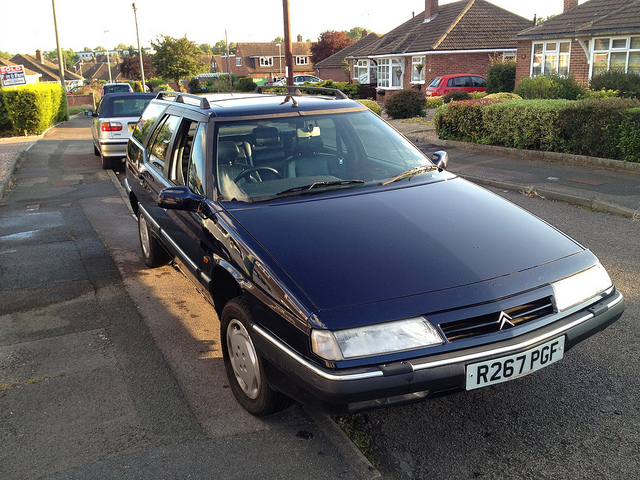

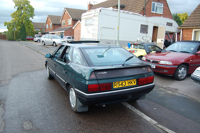

would you like a decent set of mudflaps for the XM? I still have the ones I took off your car as I didn't like the look of them.
As evidenced here!
DSC_7886 by messerschmitt owner, on Flickr
They're yours the first time you are back in Gloucester. Just let me know when you're passing and I'll dig them out.

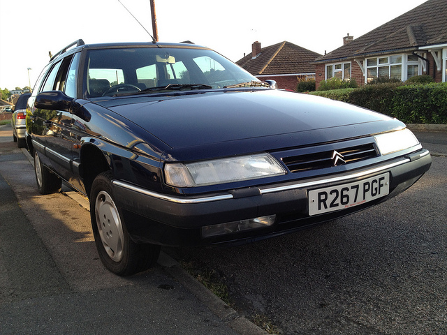

Also, here's my latest XM - this one was last taxed in January 2008, just retaxed on Saturday and ready to go after a new exhaust and wiper blades.
It drinks fuel though, being a TCT.
IMG_0850 by messerschmitt owner, on Flickr
IMG_0851 by messerschmitt owner, on Flickr
new suspension spheres are ordered for the rear and should be fitted, rain willing, later this week.
Image My XMs
