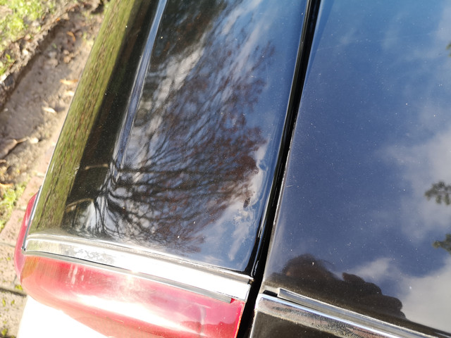

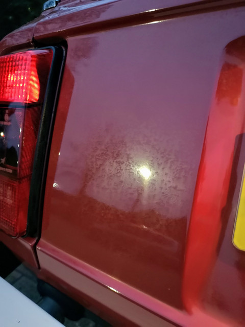

Having been on daily duties for the last couple of weeks the car was generally a bit grubby, not in a condition I really wanted to hand it over in.
Not having time to give it a proper clean myself today (especially as I was rapidly running out of daylight by that point) I decided to run round to one of the hand car washes need us which I actually trust. Sadly I discovered they're closed on Tuesdays...so reverted back to the one just round the corner from us.
This it turned out was a mistake. Despite me telling them no less than four times NOT to spray TFR all over the car...they did anyway.
So I wound up with a car which was no longer shiny and was covered in splotchy marks. They were very apologetic and then spent half an hour frantically hand polishing it, which made it slightly less dull but still covered in splotches. Not amused.
That's the third time they've done that now...suffice to say I won't be darkening their door again. Ever. I usually try to do this sort of thing myself...but if I don't have time it will be Magic Hand over by Tongwell who will get my business. They have never failed to follow my instructions - and in fact the first time I was there specific said to me before I even got to the front of the queue that they wouldn't be using any of the stronger chemicals because it would dull my paintwork.

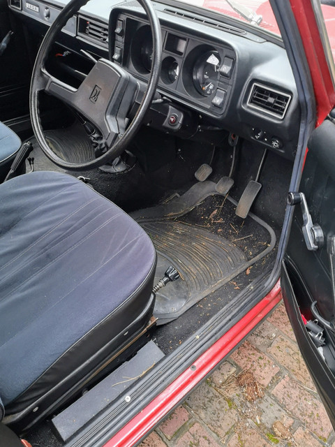

At least they didn't do a bad job of the interior.

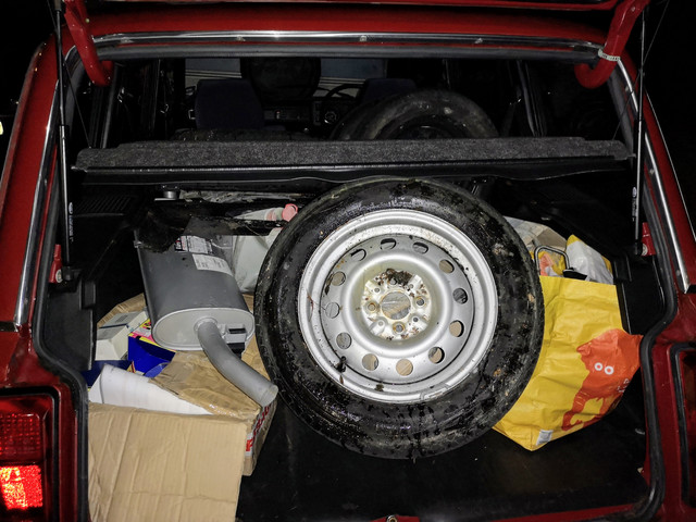

Next step: digging all the bits of Lada out the garage and from out back.
Couple of things I've not been able to find and I'll need to send on later, but the vast majority of things are now in the car.
So she's about as ready as she's going to be. 0800 tomorrow we'll be fuelling up then heading north.

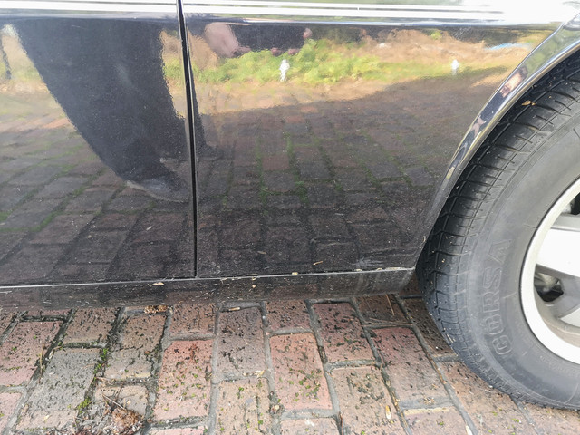

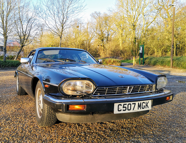

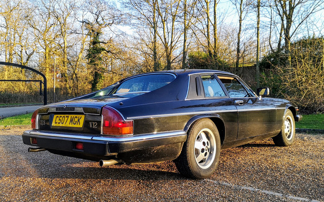

Today was new car collection day. My destination was roughly 160 miles away, so a nice little run without being too much of a slog.
First order of business was of course fuelling up, for the last time. I'll miss the comedy lack of damping of this gauge. With half a tank the reading could vary between off-scale full or having the warning light on depending on which direction you were turning.
Breakfast was then consumed and we set off. Did take a quick break to grab a drink at Norton Canes Services, and took the opportunity to snap a last photo of the Lada sticking out like a sore thumb in a modern car park.
Little bit later and we found ourselves in an unassuming little back street, where I had a lovely chat with a gent I know from one of the other forums I'm on and handed him the keys to my Lada. Oh, and goodness only knows how many spares that I crammed into the back of it yesterday.
I will definitely miss that car, it definitely will be up there on the list of favourites.
I drove away in something rather different though...in many ways...many, many ways.
Which rather narrows things down doesn't it?
Yep...I've gone and taken leave of my senses!
There were a couple of points of concern. The first was that she hasn't had a decent run in forever, had been sitting in a damp garage for the last three months, and was running on fumes. Thanks to the first few points she was running on what sounded like about seven and a half cylinders. I had a feeling though that she would clear up once warmed up properly and able to clear her throat so to speak.
First step though was to very carefully limp to a fuel station as economically as possible and fuel up.
Turns out I probably wasn't running on fumes as the gauge appears to be a little on the pessimistic side.
My theory that we were facing a combination of fouled up plugs and a damp ignition system seemed to be on the money, as after ten or fifteen minutes once we got onto the motorway she smoothed out. Obviously I'll need to see if that remains so when next started up from cold...but I reckon she'll be fine. Ignition system service will definitely be on the to do list anyhow though.
Back home a few hours and 180 miles later, she was running really sweet.
I also made a quick run round to our local Shell fuell station to throw some V-Power fuel in. Running the numbers from the trip home showed an economy figure of 18.7MPG. Given she was running horribly for a portion of that and we had a fair bit of stop start traffic on the M1 that's actually better than I expected. If I can keep my average in the high teens I'll be very happy...though around here I'm not expecting it! MK is just murder on fuel economy, and there's really not much you can do about it.
Safely home.
Fun fact: Photographing a black car after dark is really hard.
The important details.
Original stereo still fitted which is nice to see, though the speakers have been upgraded at some point.
The lamp which provides illumination of everything aside from the instruments, trip computer and gear selector via fibre optics is obviously in need of replacement as it barely manages to provide a feeble glow - though they're not the most effective at the best of times.
Dash lighting is just fine at least.

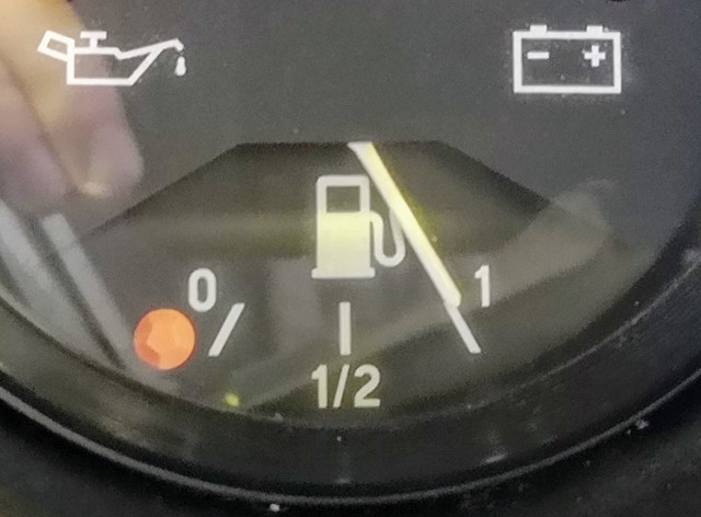

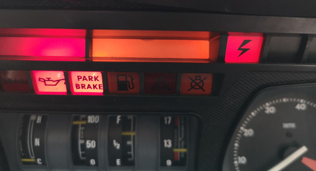

Speaking of the instruments...I was surprised to see that the indicator lamp on the dash for the rear window demister is green...know that was quite common back in the 60s and 70s, but surprised to see it on a car from 1985 in green rather than amber.
For all they have their drawbacks it's hard to deny that Jaguar used to make some incredibly inviting interiors...
Also it has to be noted that I love the camera on this phone. That was taken completely freehand.
Observations.
[] Drives far, far better than expected for a 30+ year old Jag which has actually been used rather than pampered every day of its life. Absolutely no knocks or clonks from anywhere in the suspension etc.
[] Judder when braking (noted by former keeper), suspect a flat on the brake discs from when the car was standing around a couple of years back.
[] Electric mirrors refuse to adjust (noted by former keeper), suspect dirty switch contacts.
[] Air conditioning disabled (noted by former keeper) due to the clutch on the compressor pulley failing.
[] Veneer on most of the interior wood needs refinishing (been wanting to try to do that for years!).
[] Cruise control doesn't work.
[] Windscreen wiper blades need replacing as a matter of urgency.
[] Interior is a bit musty courtesy of spending months in a damp garage.
[] Exhaust was knocking against the underbody when we started out, but it cut it out once the misfire sorted itself out.
[] Tyres aren't the best.
[] Needs a thorough clean inside and out.
Very happy. Very, very happy.
Really looking forward to getting stuck into things tomorrow and getting to see if properly in daylight and get to know the car a bit better.
I'd originally been planning this to be a way to scratch the itch for a Jag which has been there since I spent a while driving the dark green one here.
Not really intending it to become a long term resident...however can already see it getting under my skin.
It just feels exceedingly special...

You seem to have a few little jobs waiting for you on the XJ-S. The non-working cruise control is sometimes caused by someone plugging the vacuum hoses up wrongly so that the cruise gets no vacuum, or even someone discarding the bellows unit for easier access to the spark plugs. The other common fault that I remember is the vacuum valves in the bellows unit getting gummed shut. Note that there is a safety valve on the cruise that was added in a recall (after an american wrote off his car in a car park and then blamed the cruise control), and this does not appear in the service documentation for a car of that year.
On the subject of spark plugs, be very careful when removing or replacing them, as they are threaded into the alloy heads at an odd angle, and many have been previously cross threaded and strip very easily, particularly the front plugs which are mostly hidden by the A/C compressor. Most plug spanners wont reach these, the plug spanner originally supplied in the tool kit will, or you need to find one with a U/J very close to the top of the plug.
When you are feeling a little more adventurous, I can give you my method for balancing the throttles.

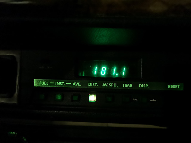

Yesterday the clock being wrong was driving me round the twist. I am somewhat autistic and have borderline OCD where things like that are concerned. After far more random jabbing of buttons than it really should have taken (eventually doing exactly the same thing I'm sure I tried twice yesterday!) I got it sorted.
For future reference, you hold down reset while pressing the buttons with the secondary markings for hours and minutes. Still surprises me that the lights in the actual buttons of the trip computer are incandescent lamps, figured they would be green LEDs, even this far back.

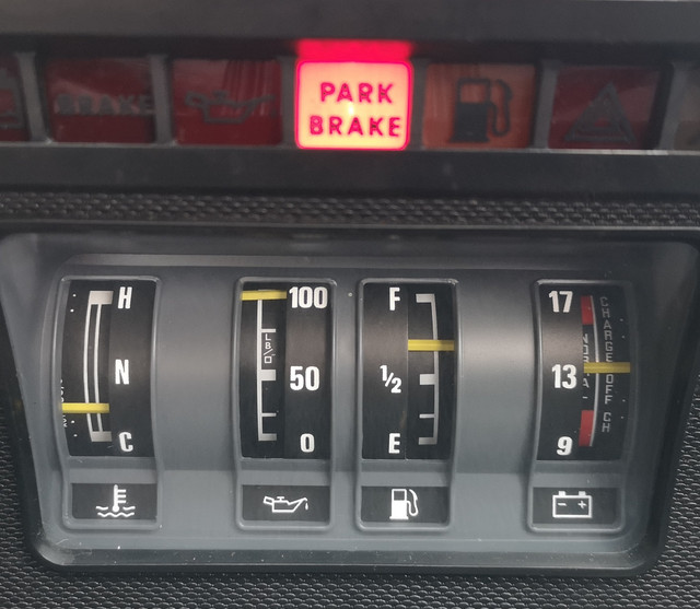

The oil pressure reading looks suspiciously high, these engines have (by design) a very low oil pressure at idle, usually about 25 psi when hot, but Jagaur said that 5psi was sufficient for warranty purposes, and Smiths made a special oil pressure warning light switch that operates at 2 psi, as early owners were complaining about the warning light coming on with standard 4 psi switches.
I Think that the lightning bolt warning light is just for the alternator charging status. There is no diagnostic output at all from the Lucas fuel injection system, and no computer diagnostic port. Software upgrades are done by changing the EPROM.

Interesting. So is the warning light with the conventional battery symbol on it a "state of battery charge" indicator instead then? I'm familiar with that concept as Lada had a setup like that on the later Nivas. Explains why it fades out slowly after the engine starts though.
There is an issue with the oil pressure gauge itself we think. The sender was changed because it used to jump to full scale as soon as the ignition is turned on. New sender it does the same thing. Disconnecting the sender however and the gauge drops to zero, so it's not a grounded signal wire. Makes me feel a bit better about the oil light taking a moment to go off on startup though.

Can you take a photo of the oil pressure sender and note any numbers stamped on it? There were at least 3 incompatible versions fitted (the one originally fitted to my car was only used in 1975 and 1976 and is is impossible to find). Your symptoms indicate that an early sender from an E-type or XJ12 S1 has been fitted, as these are cheaper and easier to find (but don't work in an XJ-S).
Thinking about it, the lightening symbol warning light is an over-voltage warning,

Interesting. The first car I've seen an overvoltage warning light on. Sensible thing to have though.
Not a bad shout if there are multiple sender's which will physically fit. I believe Moss were the source of the sensor, and I don't recall them having the best track record for providing the right parts. I'll get a photo of it when I get a chance...and once I find it. To the rear of the left hand cylinder head if I remember correctly. There are a couple of manuals in the boot, though I've no idea which ones yet.
Had precisely zero time to do anything practical today. I did manage to snap a few better photos while on the way home from running a couple of errands though, and grabbed a couple of videos while en route. Was getting tired of not having any decent shots to show anyone of such a good looking car.

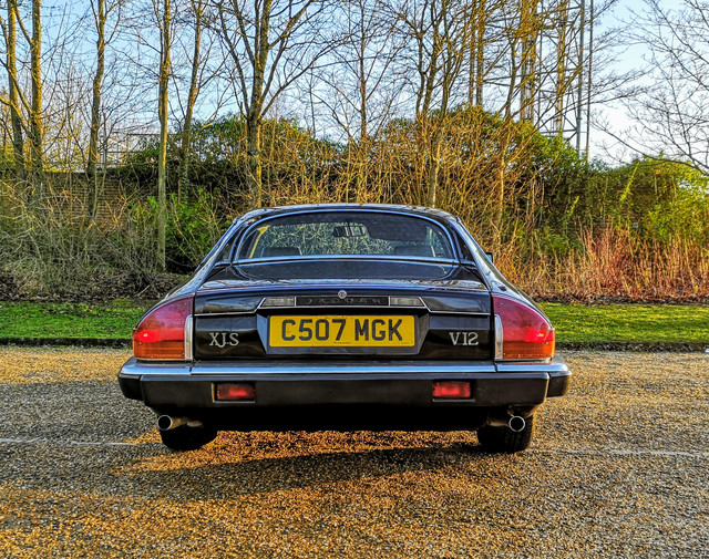

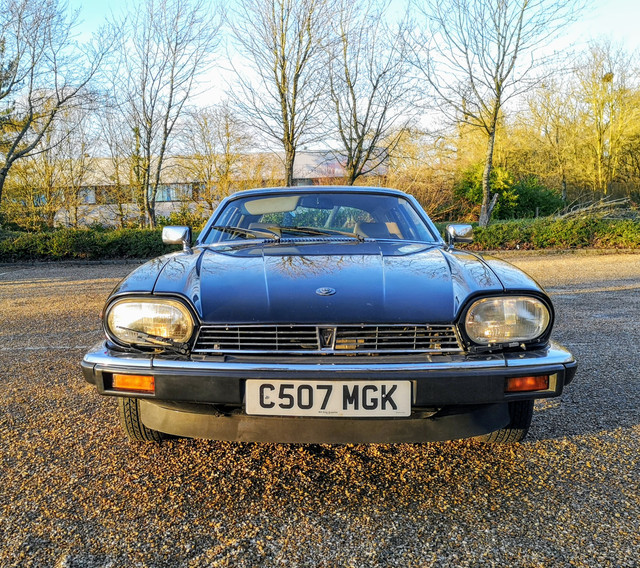

Here we go. This car park is very useful for this purpose - even if the sun being so low was a little awkward.
Quite the menacing front end to see in your mirrors chasing you down...
Though realistically...this is what you'll most likely see. Briefly, before it disappears into the distance anyway.

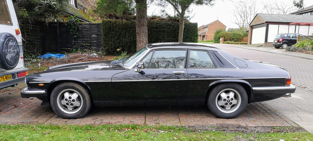

Will obviously have to retake these once she's been properly polished and waxed.
The photos do flatter the car a bit, she's a ten footer really. There's been a respray done at some point which is neither fantastic nor terrible. There are a few imperfections (mainly some runs in awkward areas).

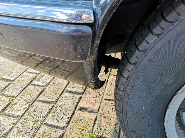

Here are a few random closer photos, showing areas where I seem to recall rot being an issue on some cars.
Offside front wing.
Offside rear wheel arch. This has been dubbed back, treated with Vactan and then drowned in Dinitrol or similar by the previous keeper with the aim of stopping it from rusting any worse until it could be tackled properly. Can't really fault the logic there.

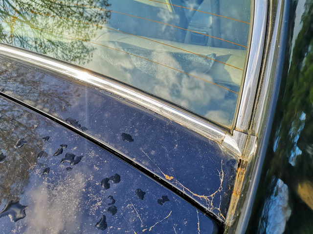

Rear screen surround. Could see this being an utter nightmare to sort it there was any serious rust here. Thankfully doesn't seem to be much beyond a few spots.
This is one of the areas of less than perfect paint. Not sure if there's a rust bubble under here or if it's been a reaction with the original paint. It's solid and not crunchy at least.
Couple of tiny blemishes by the screen surround.
Nearside front wing.

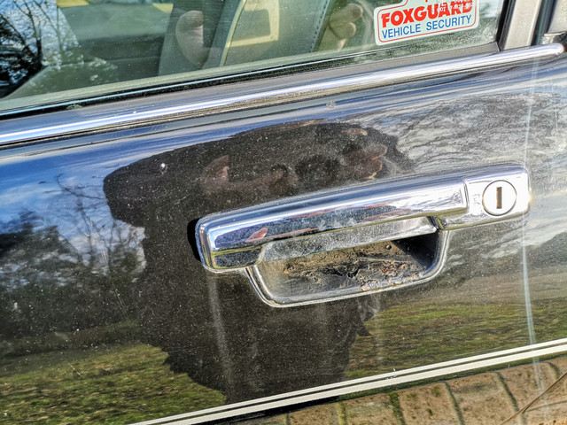

Nearside door handle needs some help.

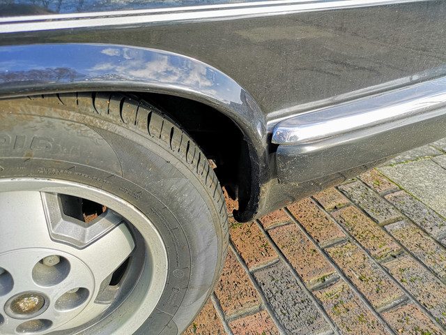

Nearside rear arch is pretty much identical to the offside one.
Wheels have a couple of small blemishes but are in astonishingly good shape to be honest.
So she's no concourse winner, but is absolutely presentable I think and will clean up lovely with a bit of elbow grease.
Offside front wing.

The oil pressure sensor should have a single off-centre spade terminal on the top. If it has a double spade connector in the center it is the wrong sort.
