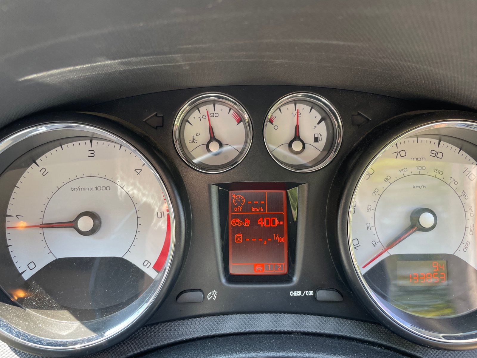

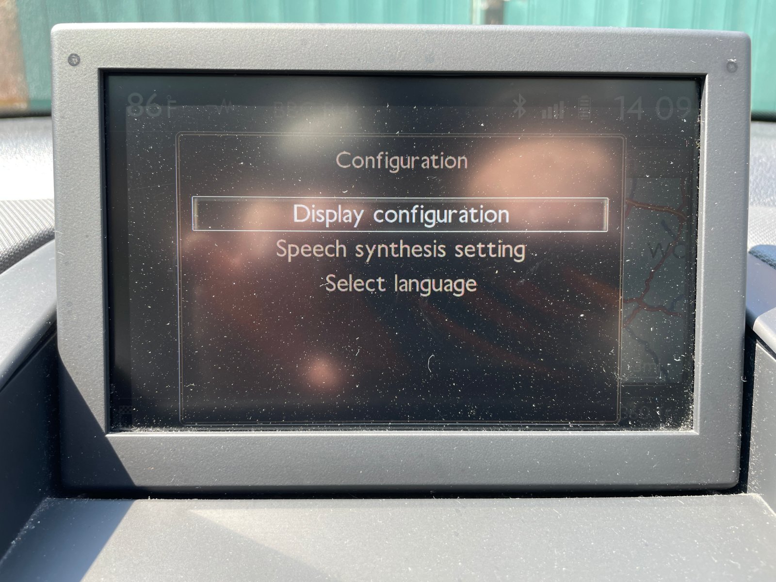

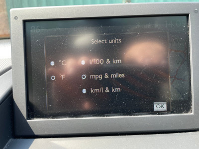

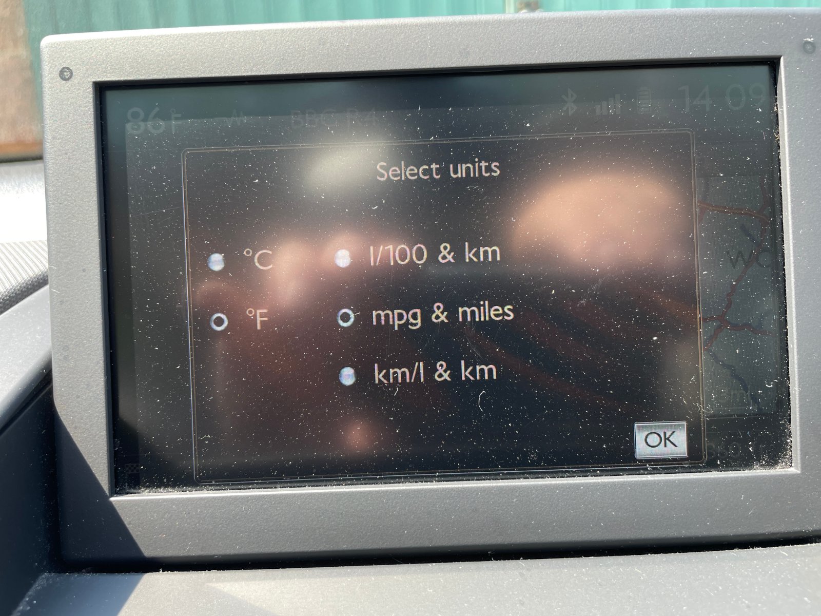

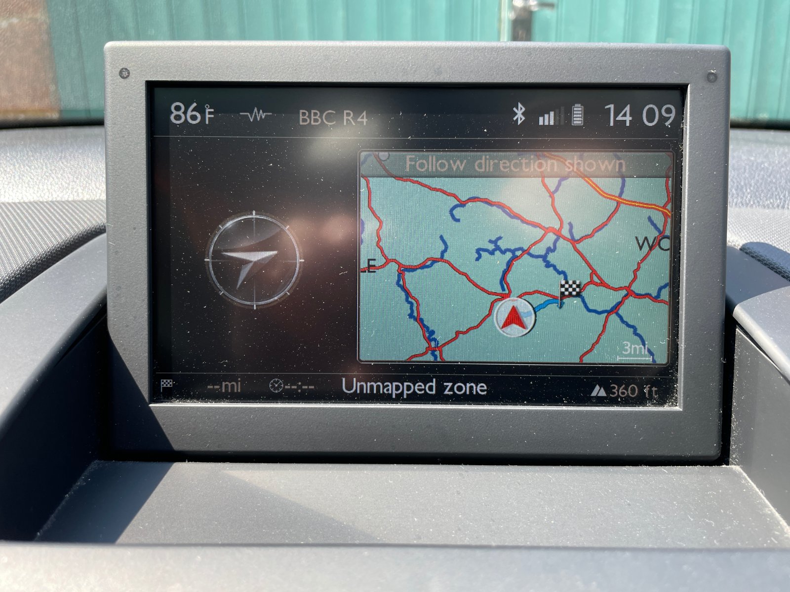

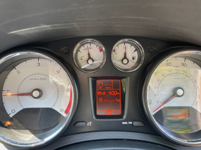

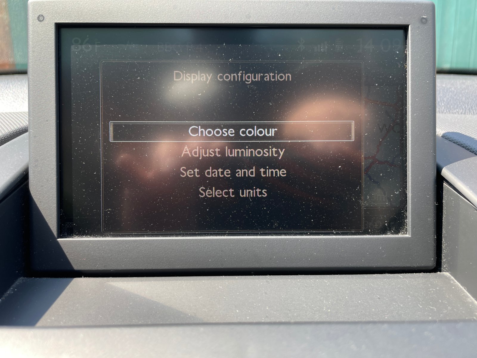

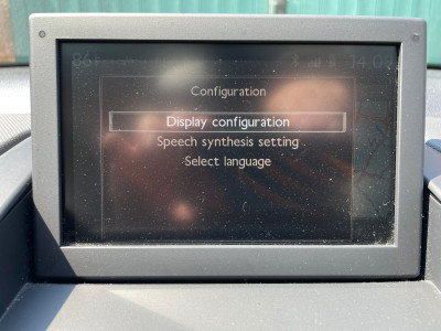

Right. After a few days of hit and miss and then hit again with Diagbox, i have everything working on my 308cc RT6 Retro fit. Nearly
The one thing left is that the RT6 unit doesn't seem to communicate with the screen between the clocks,(rvc counter/speedo).
Before i used to get nav turns shown and was able to set to MPH on the trip and mileage. I can choose MPH on the RT6 unit, and this shows on the map screen, but not anywhere else.
I have spent hours going through the different options in Diagbox, but none seem to affect the outcome .
Also, there doesn't seem to be as many config options with the RT6 unit/screen as there used to be.
I have added a few photos.
Is everyone else still have theses options?
Ta Mike

- x 6945
Re: How to Replace the Internal MicroSD Card - RT6
Your issue will be related to the instrument panel ECU - specifically the LCD or Matrix screen. These need to be calibrated to accept NAV info IIRC - but I can't advise what the setting is and where. Some people I know had to change a certain value in an obscure field to get the display to show NAV instructions - it wasn't obvious too. Most people don't have to change anything when replacing the RT6 with an RT6, it's only where they had a different telematics unit (RNEG) or no telematics unit prior to the upgrade that this was an issue.
I've just recalled now it was a chap who was upgrading his non telematics to an RT6 on a C5 X7. He had the 'zone not mapped' issue on the instrument display. He fixed it using Mirascripts, (version specifically for the RT6 only). He states "The parameter is 1.9.146. and it can be within 0-4 range, the setting that worked for me was 3 (2 was almost working, with no street names displayed)."
https://mira308sw.altervista.org/en/index.htm
I can't help you with this off course, but you may want to live without it. It is risky so make sure you know what you're doing as this can directly alter the RT6's configuration.
Whether your screen will even support this feature I can't say either, and may of required a later or different display.
