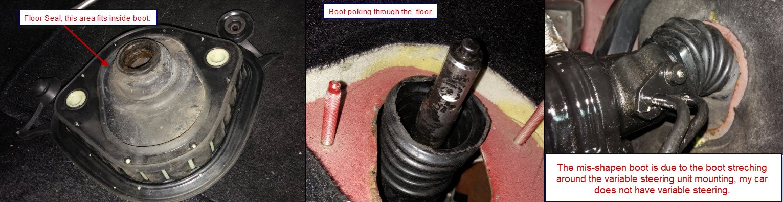

That looks a neat bit of protection, that should keep the weather out, and gets around the problem of "the lump".
Needs to be done before any problems arise. Wonder how many owners would do that? I certainly would.

Nico1981 wrote: 18 Mar 2020, 21:36 Just wanted to share my modification. I've used a cv boot to protect the pinion shaft. I'll let you know in 12 months if its worked but can't see why it won't.
Well done Nico, I am assuming my Trackrod end gaiter was version 1, fixing around the lump was tricky, but you version 2 (If we call it that) is a better and probably creates a better seal, as version 1 only sealed around the rubber on the bottom of the steering bulkhead gasket buy luck and was a pain. :clap:

I'm about to embark on this, having nursed the car through the last two years with a seeping rack. So I managed to pick up a 'new' rack that has been on the shelves somewhere for a while, about 6 months ago, and now its time to have it fitted . Nico, your mod looks like it should be pretty effective, so I intend to follow your lead. It looks like you are just relying on the tension in the boot to make a good seal at the base is the case?
I'll let you know how I get on.
