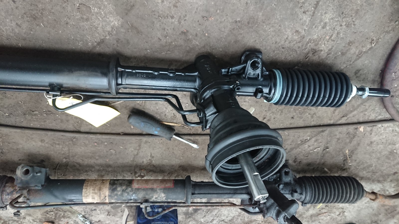

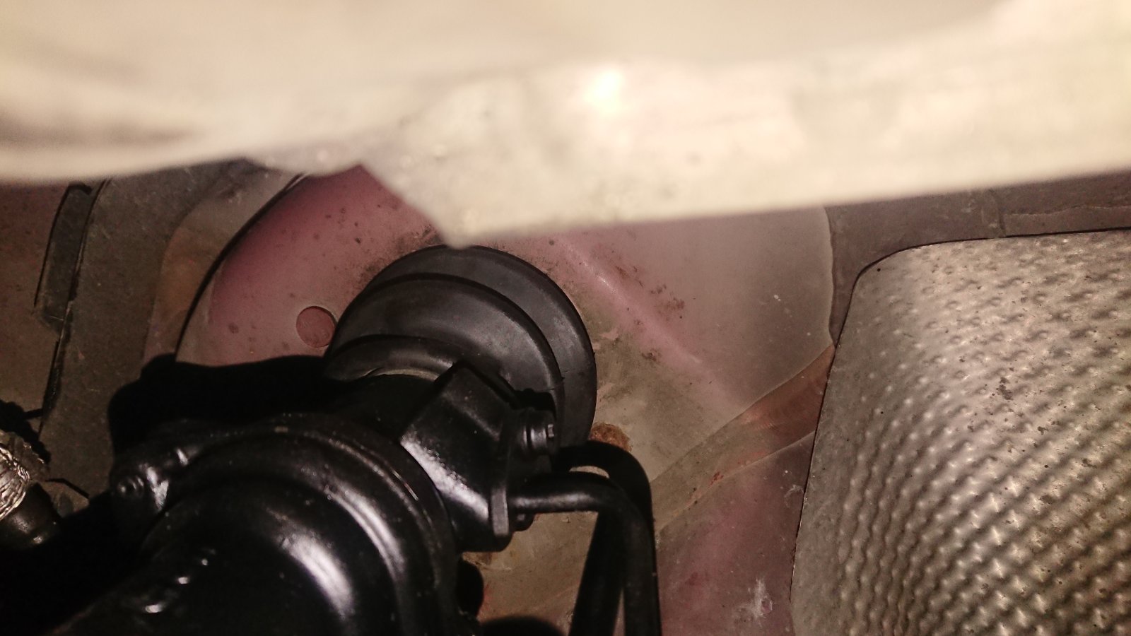

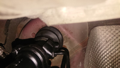

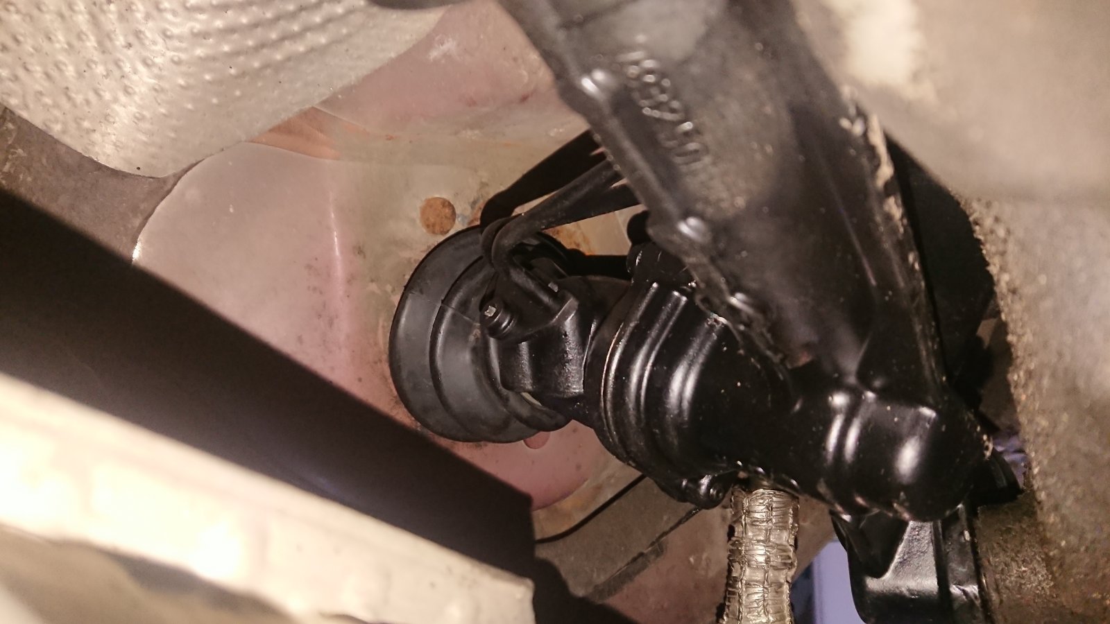

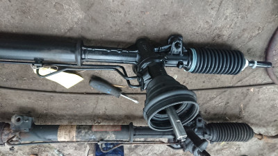

Just wanted to share my modification. I've used a cv boot to protect the pinion shaft. I'll let you know in 12 months if its worked but can't see why it won't.
