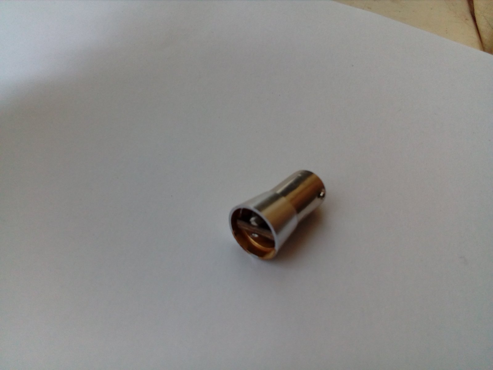

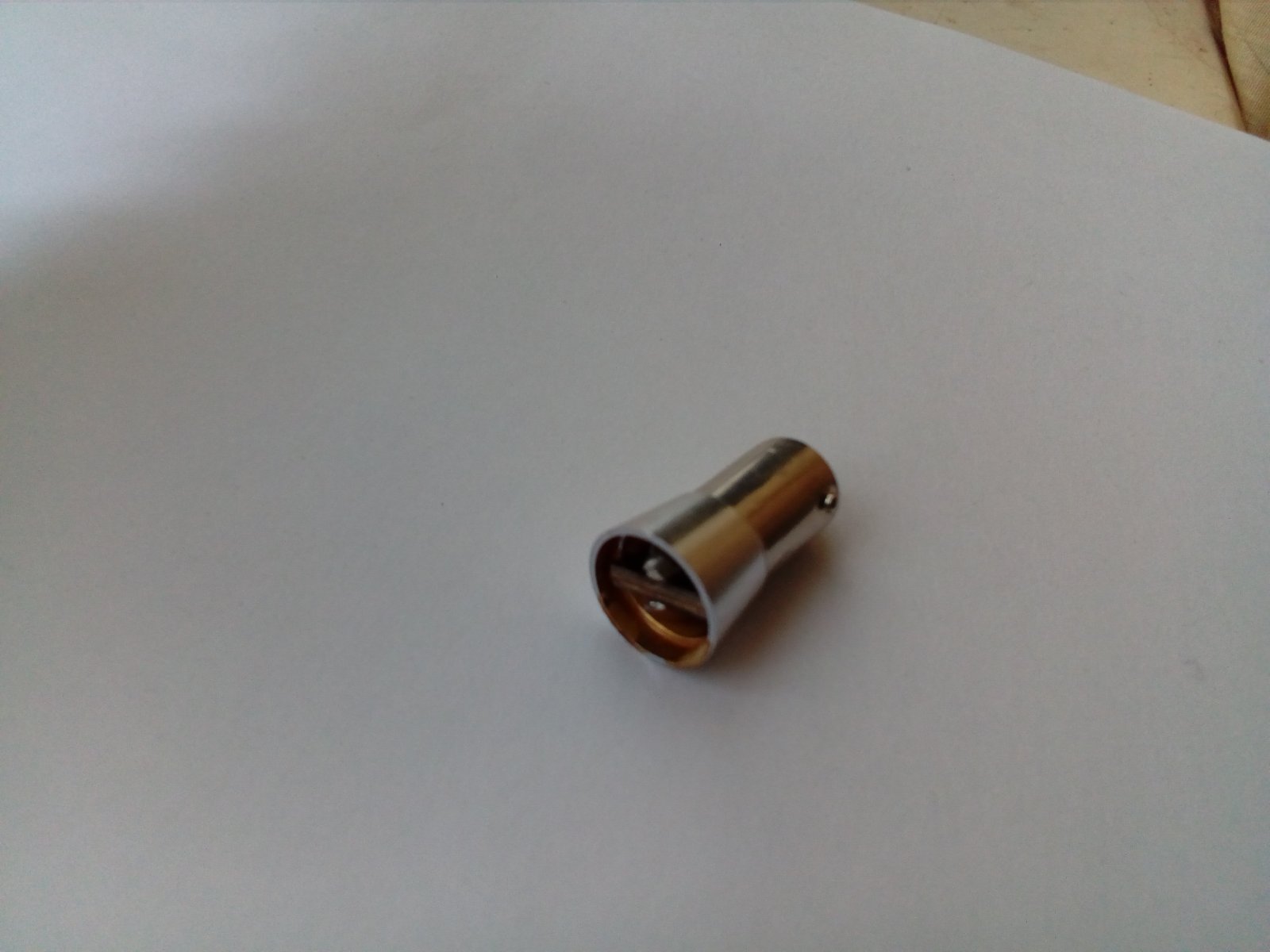

Meanwhile, the failing sidelight saga just keeps on giving!
Following battery removal procedure, the (not so) old sidelight led was retrieved....
...well, part of it.

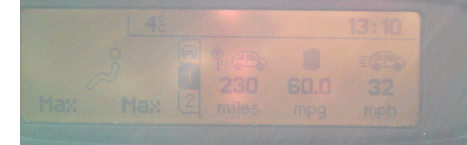

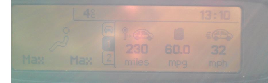

What a difference a few months can make. I didn't want to mention it before but my economy plunged around late Jan early February.
The tank-to-tank refill average fell to high-40's whereas previously (since ownership in fact), have never seen it below 50 more usually around 55 or better as shown above. Even during previous winters I never noticed any significant loss like this.
A lexia session yesterday backed this up showing a reduction in the average distance between regens falling to ~430kms compared to previous 500km and higher.
Thankfully, it's recovered this week. Having shown an average 48/49mpg over the last 250miles, I was pleasantly surprised to see it creep up to a more normal 54.6mpg following a single 40-mile round trip on mostly fast roads. I haven't done the mental arithmetic but that seems quite a substantial hike for such a short journey?

MikeT wrote: 13 Apr 2018, 10:59 Meanwhile, the failing sidelight saga just keeps on giving!
LED replaced and working without causing a BSI upset removing the battery, even though I use an abbreviated procedure to that commonly quoted.
No idea where the LED half of the old sidelight went, though.

GiveMeABreak wrote: 17 Apr 2018, 17:09 That'll be inside the sidelight housing part (as in your Avatar Pic Mike), no doubt! With a bit of luck a magnet should be able to pick it up as you 'encourage' it back to the opening. Unless it came off as you were extracting it from the housing in which case is's probably helping to fill in the potholes on your local roads.
I can't see any sign of it inside the diffuser - though that's no surety it isn't still in there, obviously. They're not magnetic either.
Someone else pulled it so am hoping it dropped into the area all the other dropped small parts go to hide rather than remaining inside the housing to cause further mischief.
(btw marc, it's the one's you linked to off ebay and I'm wondering if build quality was to blame of it parting company so you might want to check yours. It seems the two parts are joined only by two small solder contacts! There is resin inside the bayonet cap but it didn't extend to joining the two parts as I suspect it should have).

I assumed those had some resistors built in on the LED blade part from memory - so hence the suggestion that there would be some metallic components on the board that you could pick up with a magnet.
You could try and contact the seller to get a replacement - they are pretty good - just send them a pic - you never know; though at this point, with all the issues you are having with your lights, I think you'd be better off with candles.
