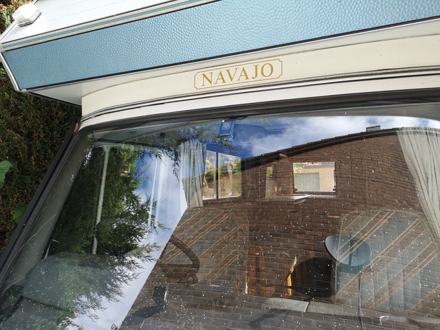

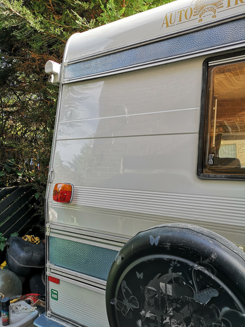

Back is looking almost presentable now.
The rear window was covered in a lot of very fine scratches before which gave it a cloudy appearance. Glad to report that it revived to an as new finish without any headaches.
Calling the back done for now. This isn't a final job, I'm just wanting to get to a presentable finish...need to get the spare wheel off and the tall ladder out to properly reach the top and the middle of the bumper.
Definitely need to get all the beading off here and re-seal under it. I'm just going to work on the assumption that they all need doing as that way I'm far more likely to have a water tight van afterwards. Especially as bathroom sealer seems to have been the material of choice for the most recent round of repairs by the previous previous keeper.

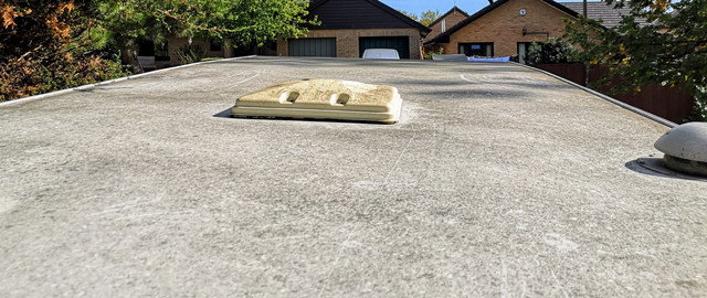

Speaking of the roof...yeah... it's been a few years since this was clean.

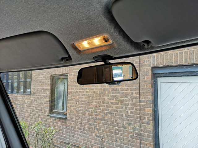

That front roof light will be getting changed soon. That one does leak very slightly under really heavy rain... probably just needs a new head of sealant around it, but as the frame inside is cracked in a couple of places it just makes sense to change it I reckon. Sadly I suspect finding one in anything other than white seems unlikely these days...

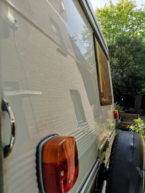

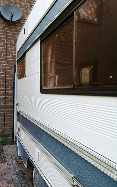

Moving on to the offside...yep, it was as bad as everywhere else.
You should be able to see my reflection here...
Yep...can definitely see where I got to!
This was probably a couple of hours work - albeit feeling like far more because I kept getting interrupted.
Once this is done the next step will be to basically drown the thing in wax to protect the paint as best as I can.

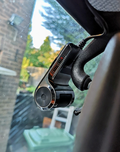

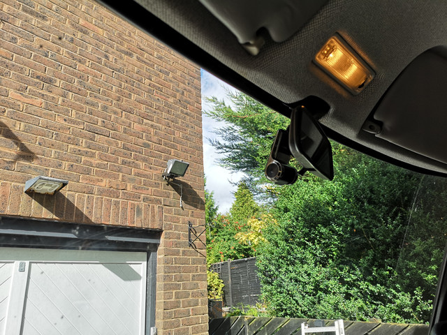

Main thing done since the last update has been finally getting the dashcam fitted to the van. It obviously wasn't doing any good sitting in a box on a shelf where it had been for a few weeks. I despise having obviously modern stuff stuck all over an older vehicle but given some of the nonsense I've seen on the roads lately (including a few near run ins with what was obviously someone trying to run a crash for cash scheme - cutting in front of you on a 70mph dual carriageway then slamming on the brakes in a car with no working brake lights) I just decided that it was necessary for peace of mind.
The unit I went with in the end tucks away pretty discreetly behind the rear view mirror and isn't really conspicuous.
It's visible from the passenger side in the cab, which is pretty unavoidable.
However is more or less invisible from the driver's seat so I'll call that a win.
Getting the wiring for that routed was an absolute pain. The term "solidly built" definitely applies to the cab of this vehicle...so getting enough slack in the headlining to move the edge the 1/8" or so necessary to tuck the wiring away required quite a bit of dismantling. Both sun visors, the rear view mirror base bracket, passenger side grab handle, driver's side grab handle blanking plates, both door seals all had to come out. Power is coming from a splice into the dashboard 12V socket into an additional socket tucked away behind the fuse box. Will make it easier for me to swap things out in the future rather than directly hard wiring it into the vehicle loom.

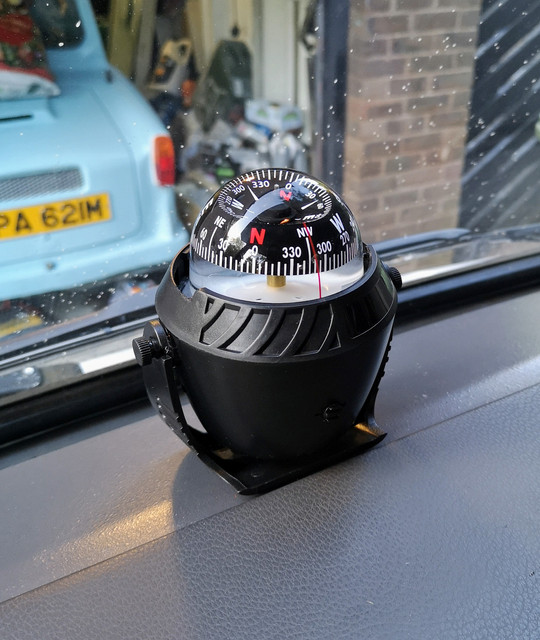

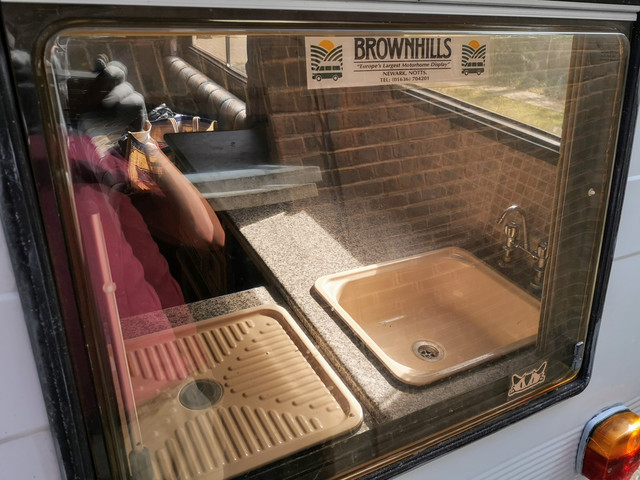

While I had the cab somewhat in bits I also turned my attention to this.

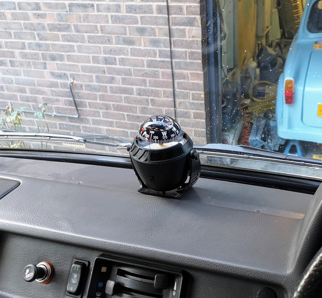

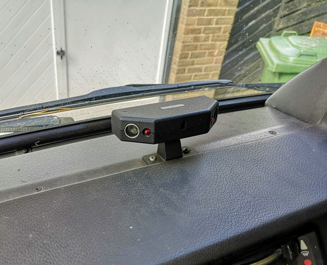

It's the sonar detector head for the original alarm system. This is totally redundant as a far more modern and discreet system has been installed (plus a couple of personal improvements to what I felt were shortcomings in it out the box). I had left this in place though as removing it would have left three holes in a really obvious location on the top of the dash.
Having had a bit of a think I decided that this was something I could replace the defunct alarm sensor with which would also do something at least vaguely useful.
Doesn't look like something you would be surprised to see in a camper designed for exploring I reckon. Yes it's a bit tacky, but it's better than a hole in the top of the dash and doesn't scream "hey this vehicle only has an alarm from 1990 still fitted" quite so loudly.
Also yes, the dash really is that filthy... really need to give the cab a good valet.

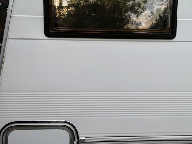

Back to my actual fleet. Not really had a chance to do much lately but finally did get a free half hour this evening before the light faded, so wanted to do something useful.

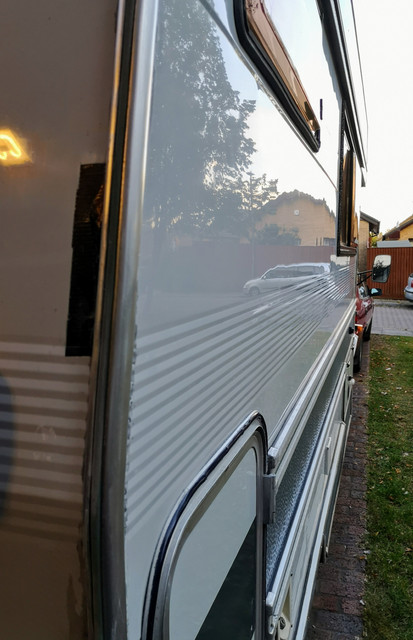

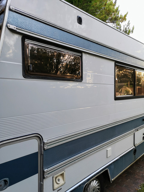

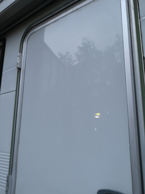

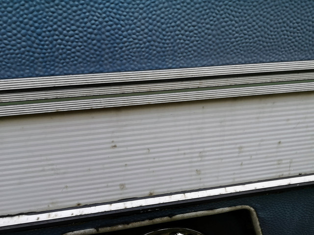

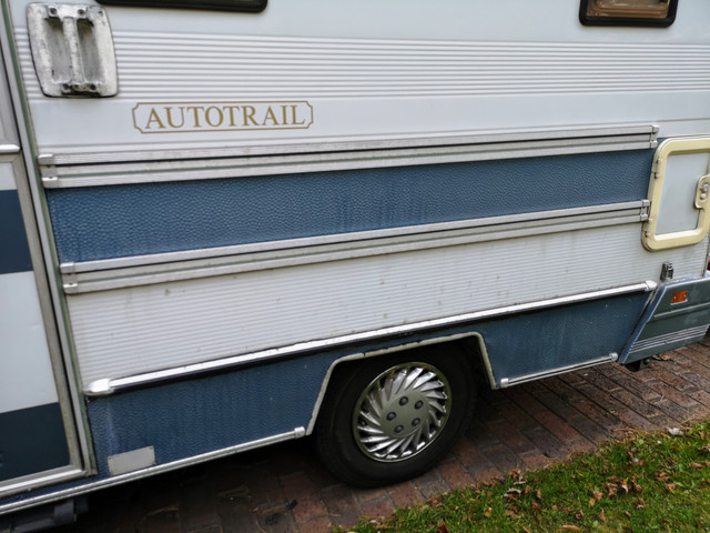

The one thing which has really been making the van look extremely shabby is the paintwork on the nearside. The offside is really dull and in need of a polish, but that's it. The nearside though has really nasty staining and what look to be runs from someone attacking it with TFR at some point. Seriously folks...don't do that to old school paint finishes like this.

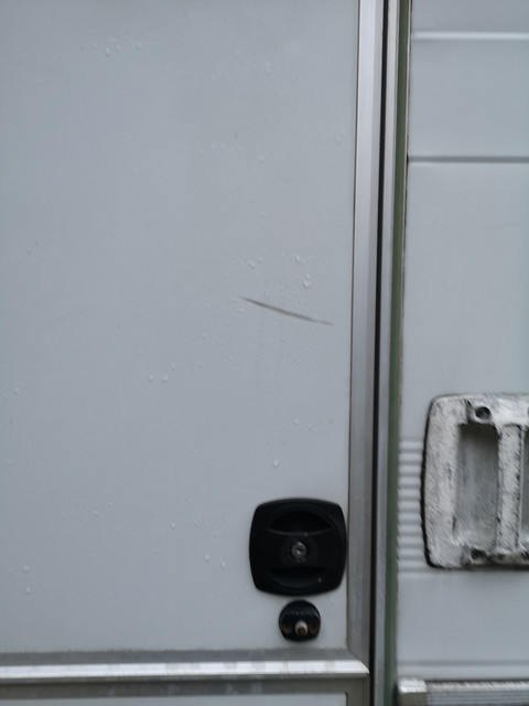

There was also a black smear on the door which wouldn't shift.
I had previously attacked it with polish by hand to see if it would shift and hadn't managed to make any headway. Today though I was armed with cutting compound and a power polisher...so did that work any better?
What do you think?
Sorry...not a great photo as it was rapidly getting dark.
I reckon that's taken about ten years off it! Ran out of daylight so the white section below the rubbing strip in front of the door hasn't been done. Also haven't touched anything above that...I can still see a bit of the run pattern in the blue area bit it's far better. So I think one more skim over with the compound should get rid of it...then the whole side will be gone over with Autoglym Super Resin Polish and unreasonable amounts of wax to protect it.
The power polisher is a godsend dealing with a vehicle this size...shudder to think how long it would take me to cut, polish and wax this thing by hand!

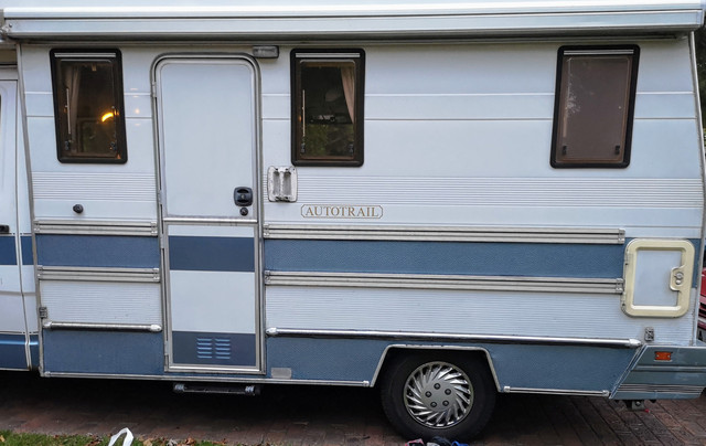

So far I've only come across one AutoTrail van in person that's not built on a Merc chassis - there's an old Bedford CF one that lives not far from here (on a B plate I think) which I'd really like to get a photo of next to mine. Would also like to speak to the owner just to ensure it has a safe future...but it's in a really awful spot to stop, so it's a bit tricky. Might need to wait to make contact till I'm out that way in the Invacar as it's way easier to tuck out of harm's way than a normal sized car...
There are quite a few still out there on Talbot Express chassis (I know of two), and I know this range was also offered on the VW T4 Transporter. Interesting though is that I've never come across any examples of a survivor of one of those yet. I have to wonder why that is...whether it just didn't sell well (unlikely I'd think given that the VW T4 makes the Merc T1...and I'm speaking from the point of view of a motoring reviewer here rather than a classic car enthusiast so forgive me...seem hopelessly old fashioned in every way). I'd have expected folks who wanted the premium badge but with modern performance figures and luxuries like power steering would have gone for the VW in a heartbeat.
It doesn't surprise me that Merc T1 examples are relatively common. Few reasons...firstly is that so long as you keep on top of the rust, they'll keep going pretty much forever. They're easy to work on, and at least until very recently parts supply has been a doddle thanks to Mercedes themselves having legacy parts supply that's second to none. Even most body panels are pretty easy to get as there are so many of these still about in the EU, and they had such a long run, having first rolled off the production line in 1977. While they're not racing cars, they're also endowed with enough power and a sensible gearbox which means that they're not a hassle to drive in real world traffic. Bumbling along at 60-65mph is entirely possible without overstressing anything.
Merc T1 owners also seem to be a group who become dangerously attached to our vehicles and will sell our major organs if necessary to keep our vans alive.
Maroon over cream is the standard AutoTrail colour scheme of this era. Two other colours were available though, albeit as a special order I believe. These were the blue over white of mine, and the really rare green over white.
While I'm obviously somewhere biased, I really do think the blue variant is the best looking. Seems to be more commonly seen on the Merc than other platform too, purely based on how many pictures I've come across...not actual production data!
Really do need to join the owners club...sure facts and figures for silly stuff like that would be the sort of thing they would have on hand...

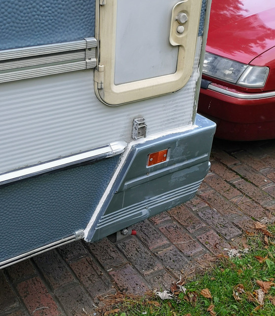

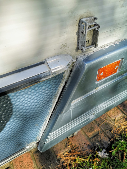

One thing which was obvious yesterday when working with the polisher was that the nearside rear corner was looking rather ratty because of the sealant between the side of the van and the bumper had disintegrated. This has been letting water get in behind there too which can't be a good thing.
Bit of fresh sealant has improved things - though it didn't go on quite as tidily as I'd hoped.
The bumper needs painting anyway so will need to come off at some point anyhow. As such I'm not worrying too much about it for now...keeping the weather out has priority.

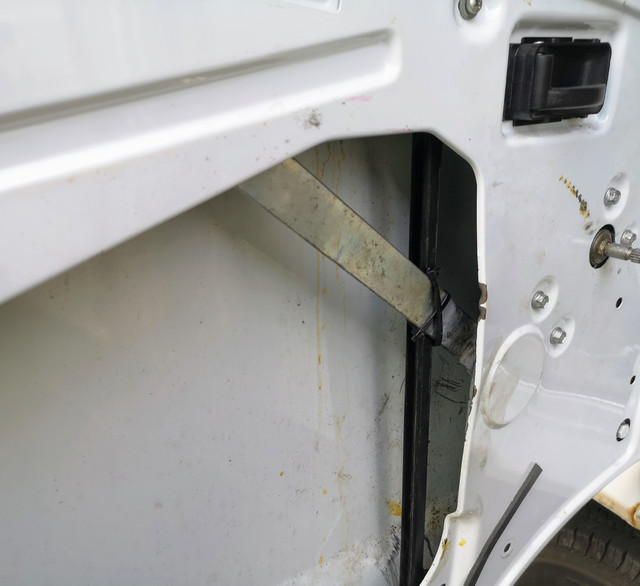

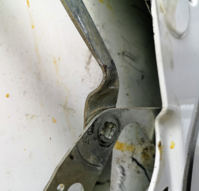

Biggest issue I've been noticing in the last couple of week is a downright horrific squeaky rattle in the cab coming from the passenger door. This was rapidly driving me insane. The window winder on that door has never worked in my ownership of the van, though the window could be manually slid down by a couple of inches. So a suction cup had been employed to stop it from dropping open. I was pretty sure that the rattle and the dodgy window were most likely connected.
The moment I started stripping things down I immediately became suspicious. The screws holding the door handle on were cross threaded and this was found wedging the captive nut in place...
Yes, that's a self tapper held in place with blu-tac. This suggested to me that I was very likely to find that Billy the Bodger had been messing around in my door.

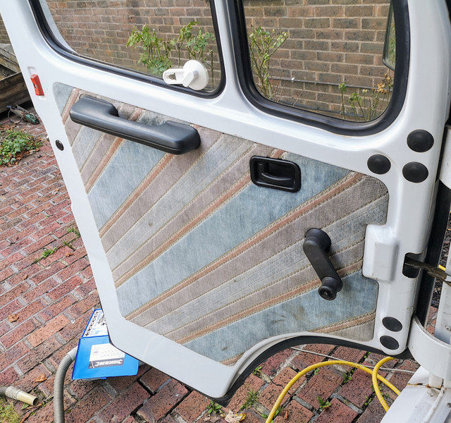

Yeah...I wasn't quite braced for what greeted me when the door card was removed.

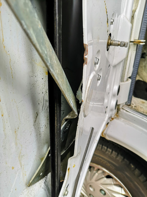

Okay...that linkage should be straight. It's a good 2mm thick, so must have taken some serious effort to bend! This was wedged around the wrong side of the window runner and jammed against the base of the door, presumably to keep the window up. Cue a bit of investigation to try to figure out what on earth was going on.
This appears to be the root cause of the trouble.
This fits through the whole assembly, with the coil spring slotted into the back of it. Now I need to track down a diagram to ascertain whether something has broken off this or whether there's meant to be an external clip to hold everything together. It looks like there may originally been something involved with a square section involved.

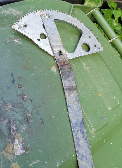

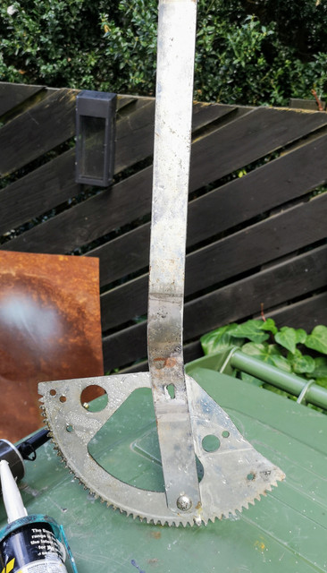

Before I could do anything though I needed to try to get the linkage back into something vaguely resembling the right shape.
I've no idea how they bent it like that...but getting it back involved getting it cherry red with the MAPP torch and battering it with a 4lb lump hammer.
Better. Though they've managed to bend it in this axes too.
Don't think this will stop anything from working though.
This allowed me to reassemble things to prove that everything was there fundamentally - I stuck a bolt temporarily in the place of the aforementioned fastener just to hold everything together for testing purposes.
Well that looks a bit healthier doesn't it? You can see the scratches by the bottom of the window runner showing where the lifting quadrant used to be. The cable ties are locking things in place just now as the bolt through the middle allows a bit of movement so the winder doesn't reliably stay meshed with the teeth on the quadrant. As stated though this was purely a test.
I think once I've sorted that "thing" in the middle this should be back in action. The teeth on both the winder and the lifting quadrant look perfect, the runners all seem fine etc. Just need to figure out what bits are missing and replace them.
While I had the door apart I took the opportunity to make sure the drainage channels were clear in the bottom of the door and vacuumed thirty years worth of detritus out of the bottom of the door. The paint is flaking off quite badly in several areas, so it will shortly be getting drowned in rust convertor and cavity wax.

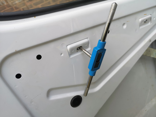

Reassembly required a little remedial work too as I'd mentioned earlier, the screws holding the grab handle on were utterly cross threaded and good for nothing but scrap.
Luckily the ones on the driver's door were fine so I was able to confirm the screws were standard M6 items. The nuts in the door responded fine to being chased out with a tap.
Suitable replacement screws were sourced from the drawer of random fasteners and the door put back together.
The suction cup previously holding the window up can go now...it was mainly being used to ensure the glass didn't drop on my head while I was working inside the door.
While I've not had a chance to take it out yet, it doesn't rattle at idle any more and now clonks shut rather than clatters shut...so hopefully will be quieter on the move. I do need to look at adding some sound deadening in the doors though as they do drum something rotten...I get the impression some Dynamat (or similar) could knock a huge percentage off the noise levels in the cab. Replacing some of that which has been removed from the bulkhead and floor when welding has been done in the past probably wouldn't go amiss either.

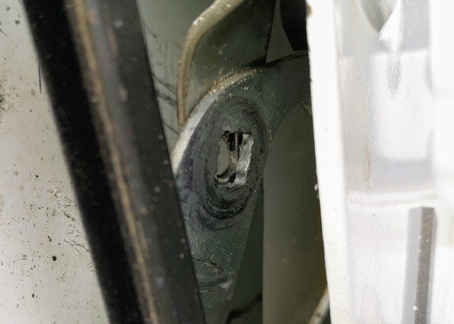

The door needed to be pulled apart anyway though to investigate the window winder issues so it wasn't time wasted anyhow.

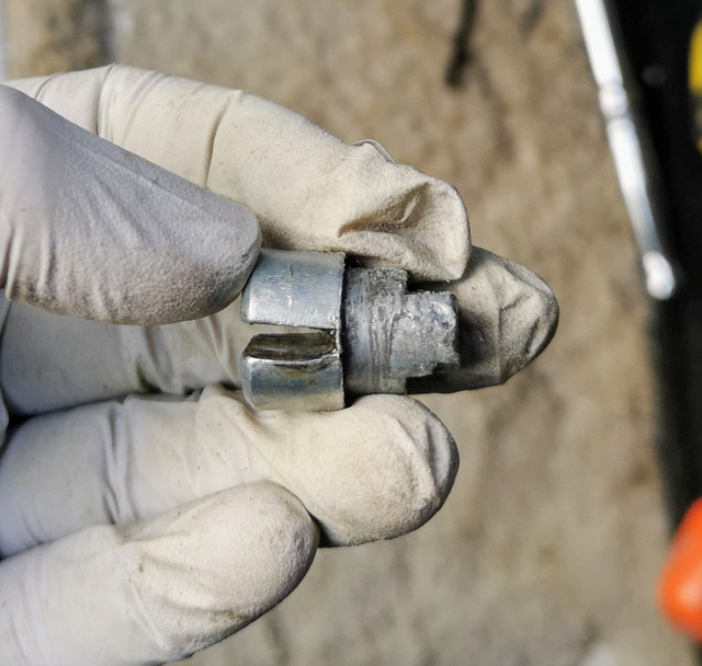

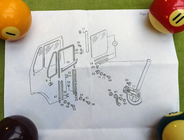

Speaking of the window winder I dropped by the Merc dealer today to see if they could track down a proper diagram of what should be in my door so I could confirm nothing else was missing and hopefully see how it was meant to be held together. Unsurprisingly their magical parts lookup system didn't even break a sweat looking this up for a 30 year old van.

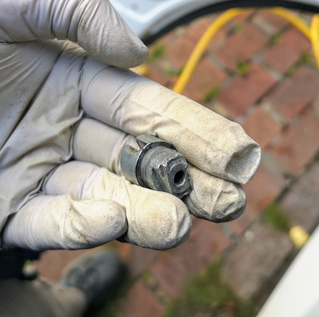

This however shows me something I was half expecting - that something has actually broken. That odd pin thing which runs through both the lifting arm and winder quadrant should be permanently attached. The whole lot shouldn't come apart...as such bits of it aren't available separately.
At least I now know that. In itself that's useful as I can start thinking about how to manufacture a solution rather than just being able to pick one up.
Not going to waste too much time on it though (especially as the lifter arm is still slightly bent and I'm not totally sure if that will affect operation) as the whole winder/lifter assembly is available from Mercedes for £81 including the VAT.
Going to have a closer look at it though as I reckon it should be possible to fix it...given I've some other big bills coming up the window winder will need to wait if it needs a replacement. Anyhow it's firmly closed now and if need be can wait until the spring when I'll obviously want to be able to open the window again.

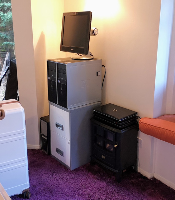

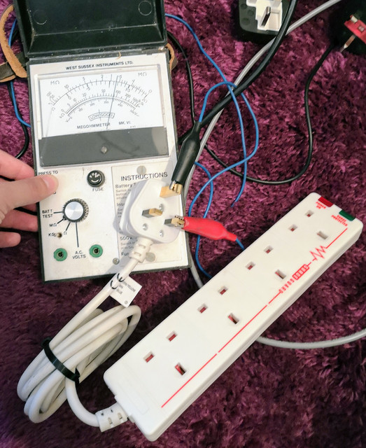

This afternoon I was cut off in mid sentence by our beloved RCD tripping out yet again. This has become an almost daily occurrence over the last couple of weeks, so figuring out what the heck was taking it out was high on my to do list. It was nothing obvious from a quick run round the house...so it was a matter of unplugging EVERYTHING and testing everything individually with the Megger and pray that eventually I find a suspect.
Well, I wouldn't have called this one...
Yep...an extension cord.
Roughly 0.75 Meg leakage from live to ground would do it. Bit of math suggests that would equate to 33mA of leakage. The rated trip current for the RCD is 35mA.
I expected a little bit of leakage to be apparent on these surge protected strips...but not that much! At least it's something cheaply replaceable.
Annoyingly, this strip while being a cheap thing to replace, was buried deep down the back of the bank of machines hosting my server and little distributed computing cluster...and getting to it meant hauling the whole lot out. Of course this then meant it would have been daft not to tidy things up while I was at it, given that several machines have been switched and swapped since I last had the corner in bits.
So I took the whole lot apart and rebuilt things.
The monitor is mainly there for the benefit of the tower down on the floor as it is frequently cranky about booting and requires me to poke it to get it to start (and is to be honest probably one failure away from the scrap pile). The rest are pretty much exclusively managed over the network. The electric heater is pretty much just something to keep the laptops off the floor too...no heating is really needed in there these days - the computers do a pretty good job of that.

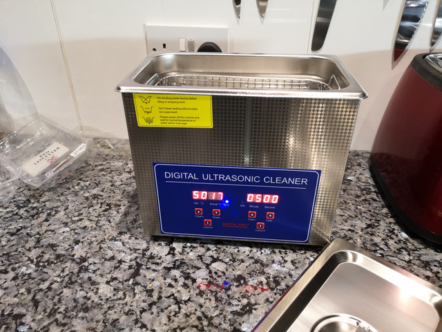

This should be a nice little addition to the garage workbench.
Only a relatively little three litre one - but an order of magnitude better than the 0.6l one I already had. Should be big enough to clean most stuff that's sensitive enough to need it, just might need to do it in a few steps. I might look to upgrade to a 15 litre one at some point a few years down the line once everything is properly set up if I find myself tinkering more with old engines, but this will be really useful in the meantime.
Have only given it a really quick test in the kitchen to prove that it actually works. It does, and is plainly massively more powerful than the old one (which in fairness is really intended for jewellery etc rather than use in the garage). Look forward to giving it a proper test run in due course.
