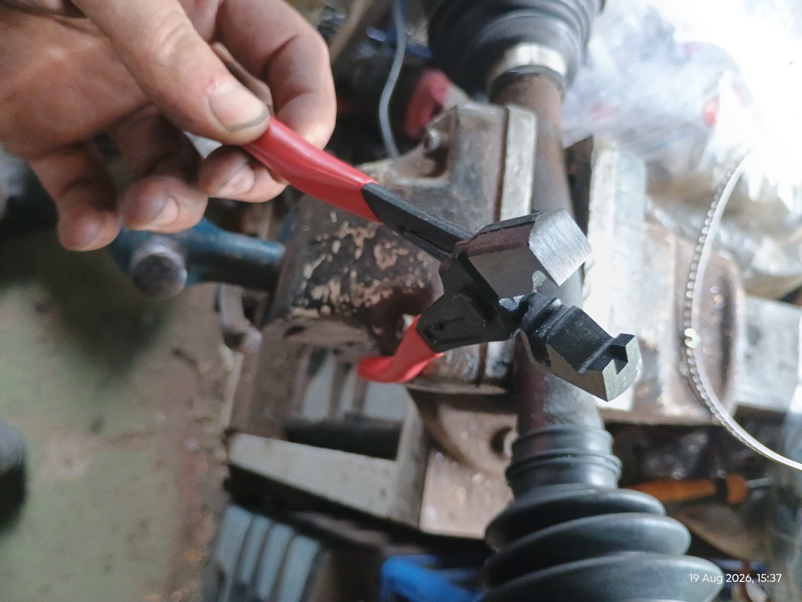

Huskyxantia wrote: 17 Aug 2026, 09:34
Snap!
First use of my pair

Unread post by MattBLancs »
Work well those

Unread post by Huskyxantia »
Nice one , I'd say that will do a better job than cable ties especially being a diesel aswell move force and all that good stuff..

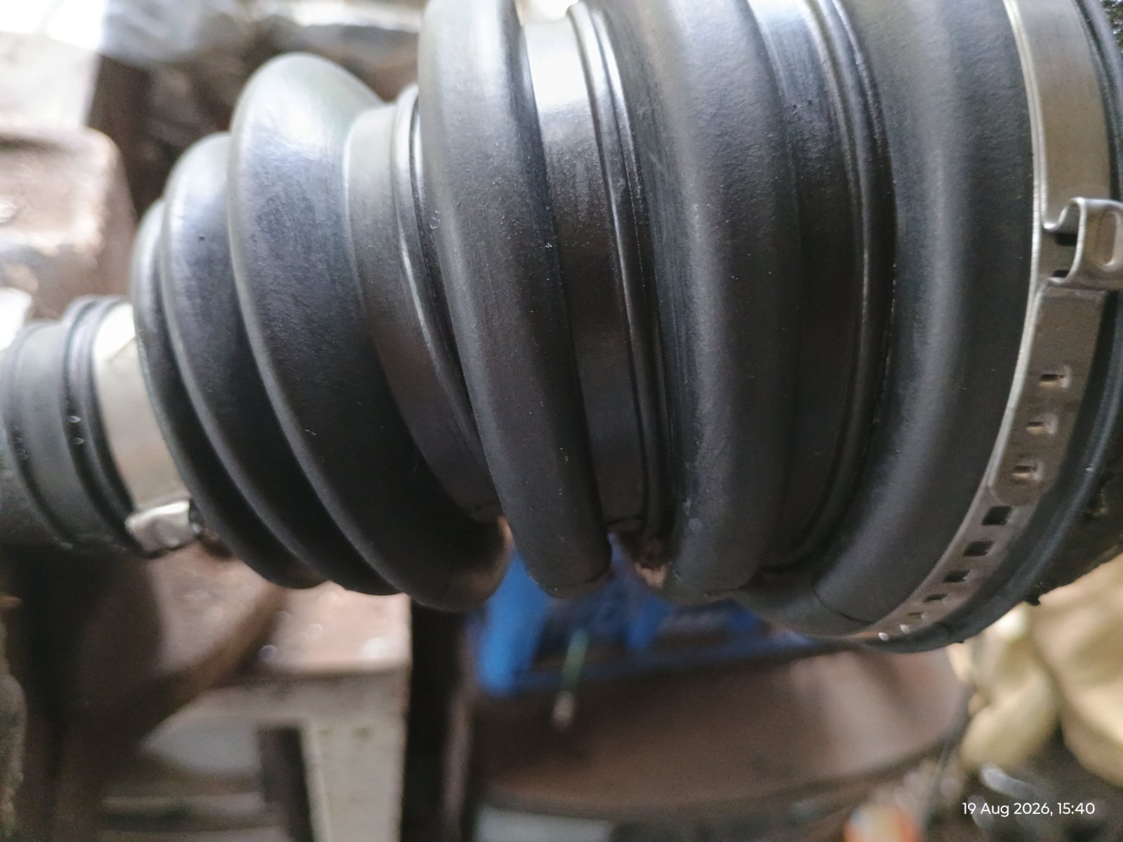

Huskyxantia wrote: 19 Aug 2026, 19:52 Nice one , I'd say that will do a better job than cable ties especially being a diesel aswell move force and all that good stuff..
Yes, pleased with that clamping effort. Not sure how long lived the stretch boot will prove to be - the rubbery material feels very thin!

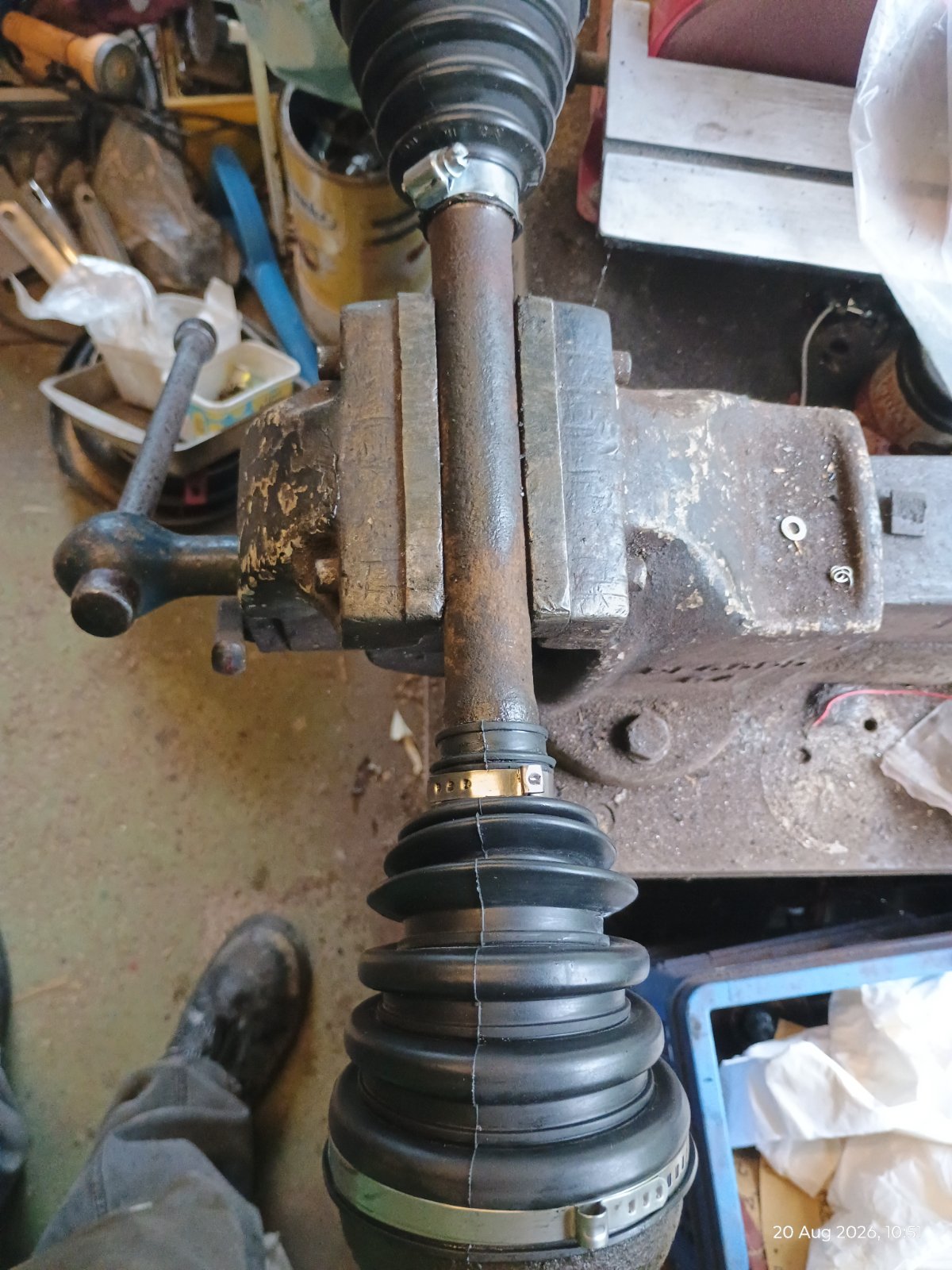

MattBLancs wrote: 20 Aug 2026, 10:04 Brightening slightly
Ha, that was optimistic!
CV boot job done. Video of the other end in a moment - an odd "failure" at that end.
