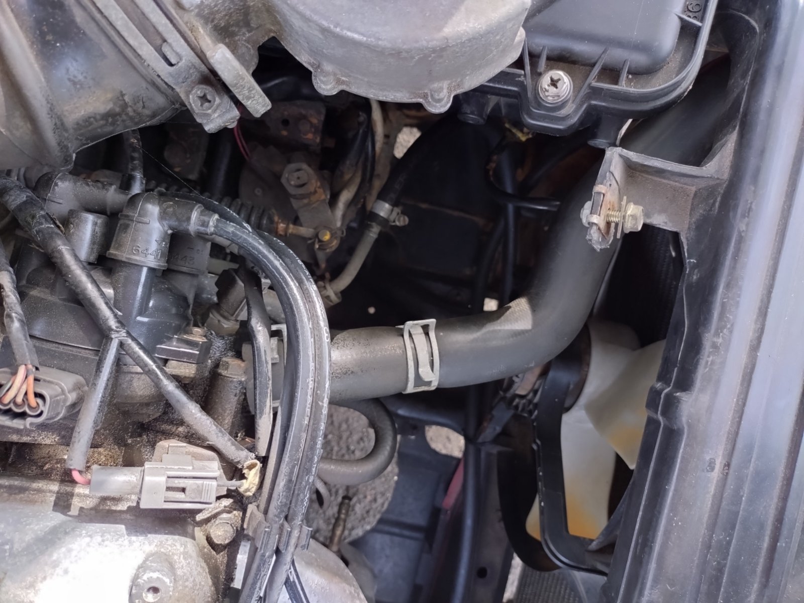

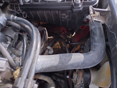

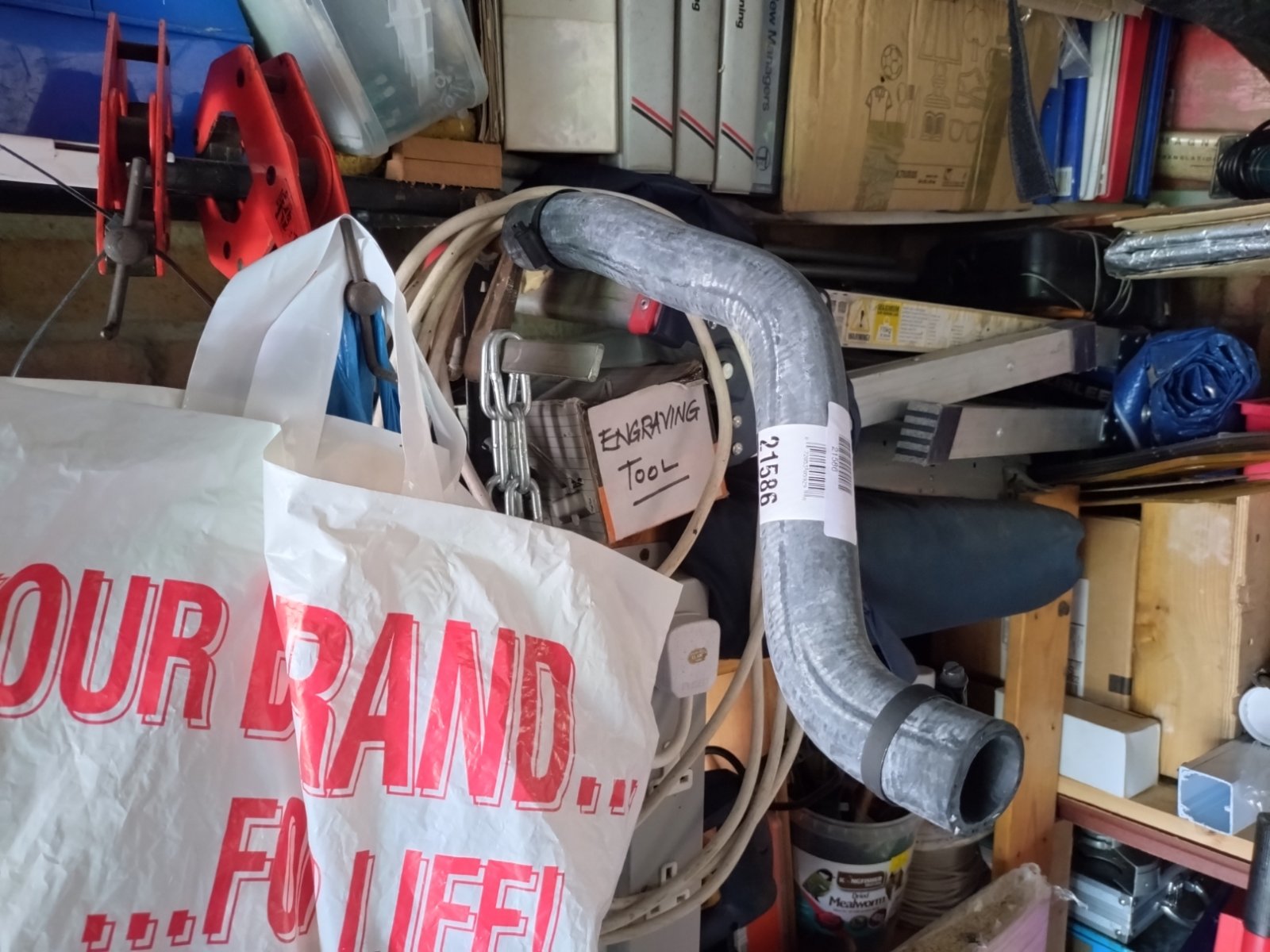

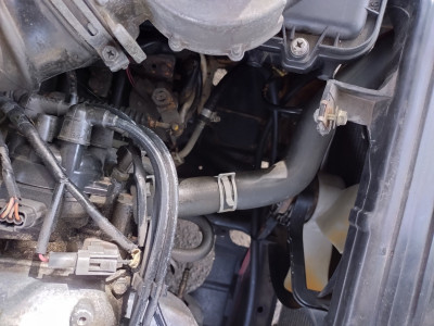

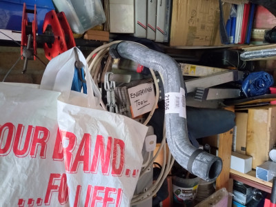

I popped out to the garage this morning to get SWMBO's car out for routine inspections and I noticed this:

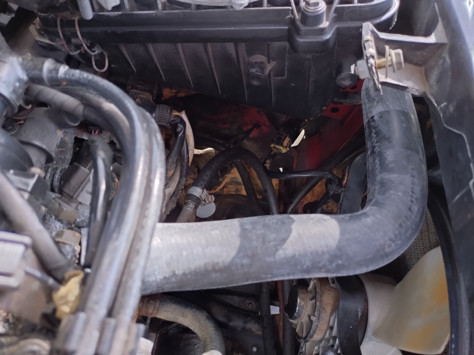

Aah thought I, that needs putting where it belongs. You may remember I replaced a hose clip on the MX3 a couple of weeks ago but the last time I used the car there was still some steam seeping out from the radiator end of the top hose, so I ordered the new one to replace this one:
Five minutes of blissfully simple screwdriving later and the job was done:

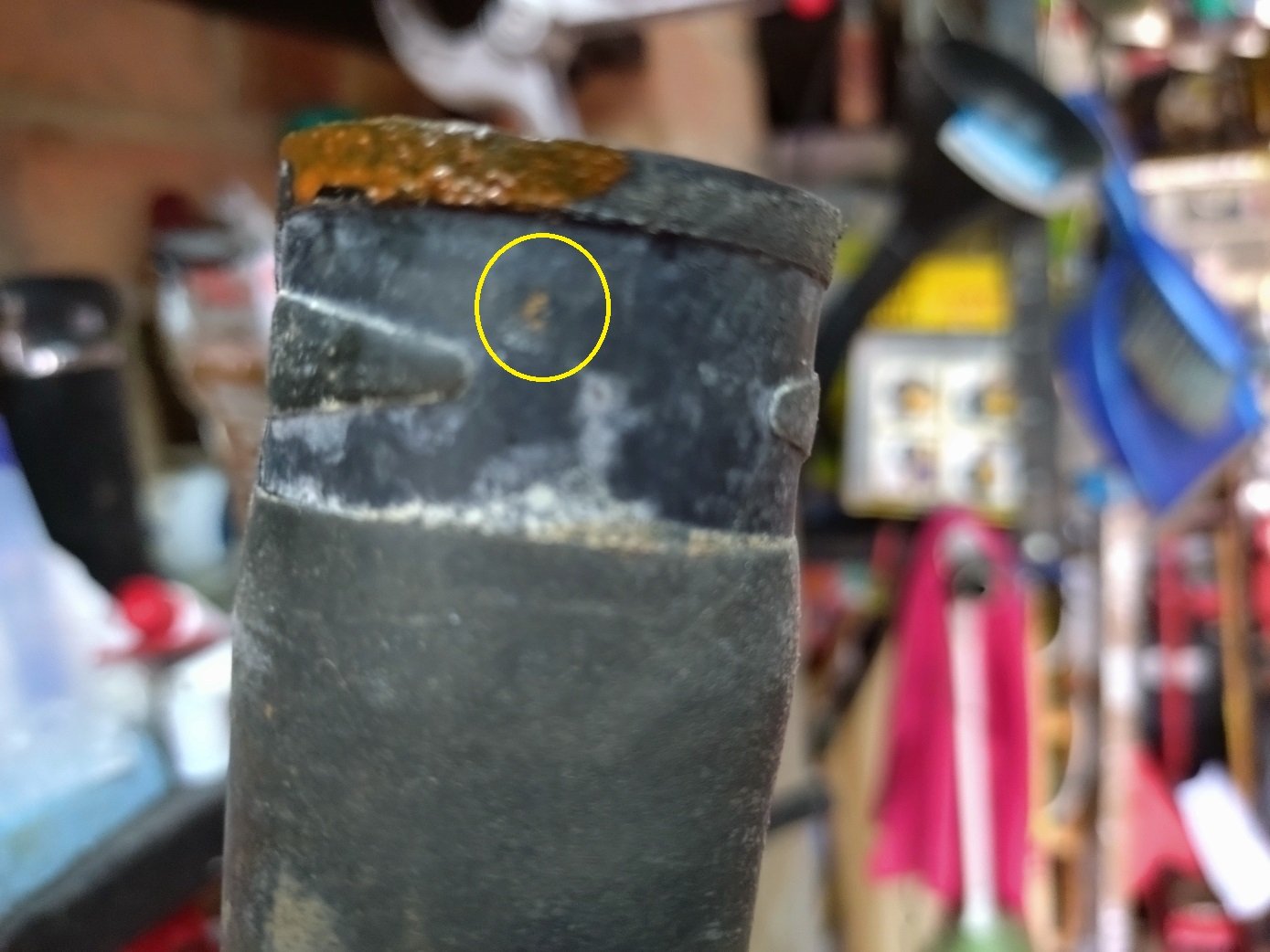

Of course once I had the original on the bench I felt a forensic investigation was required but it didn't take long to spot this:
So that pinprick hole had been the cause of the steam and now I'm pleased to say having run it up to temperature there is no steam evident. However when I switched off I'm sure I heard a slight hissing for a couple of seconds but by the time I got my ear to the place I thought it came from it had stopped. Hmm... watch his space......

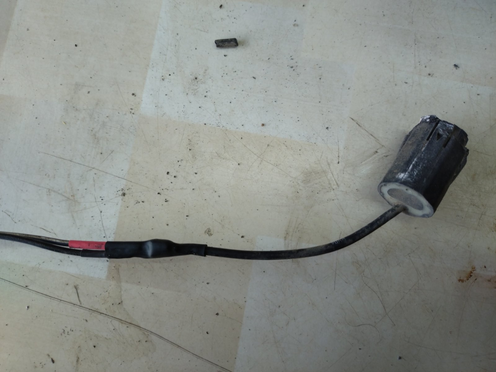

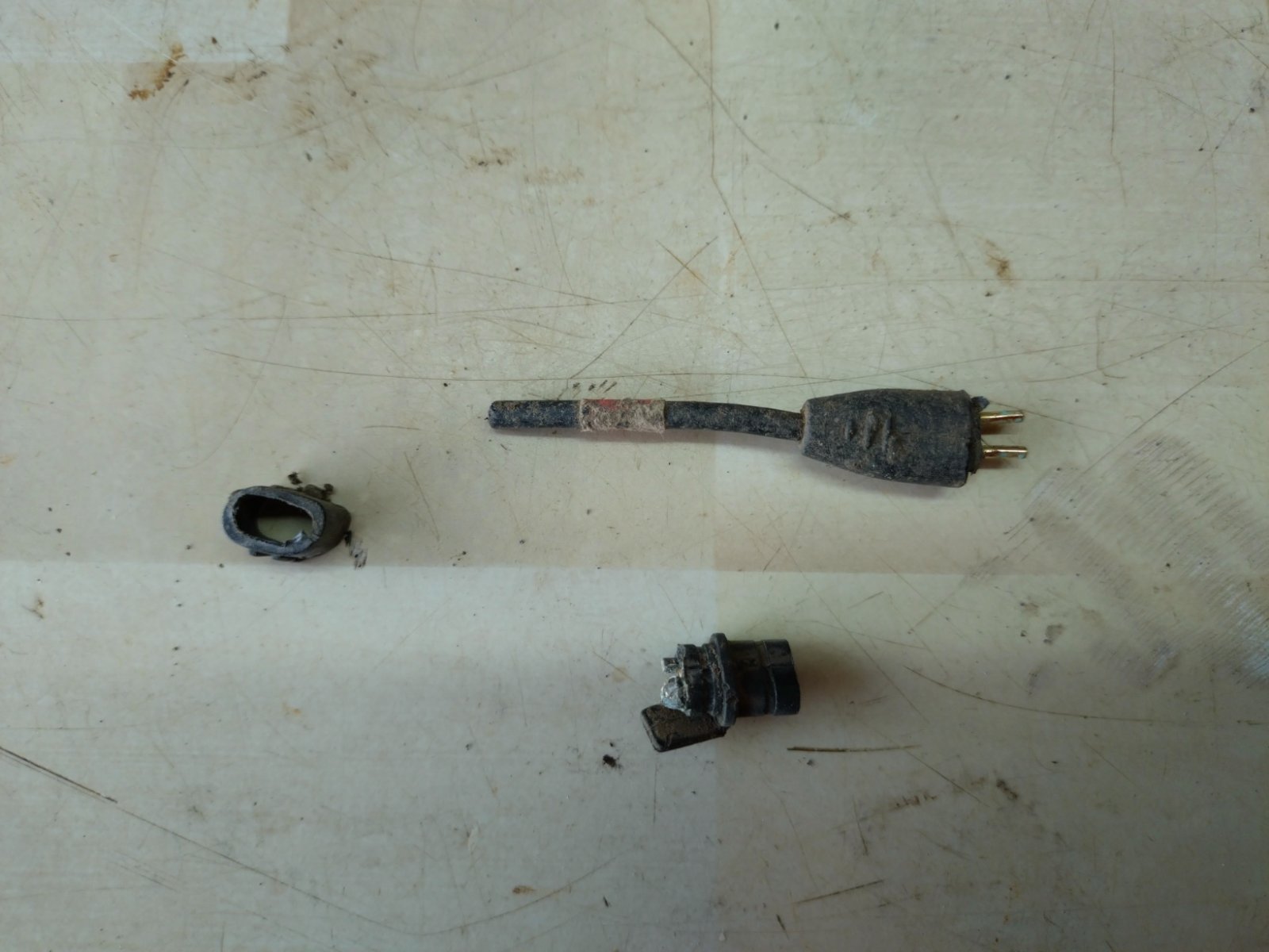

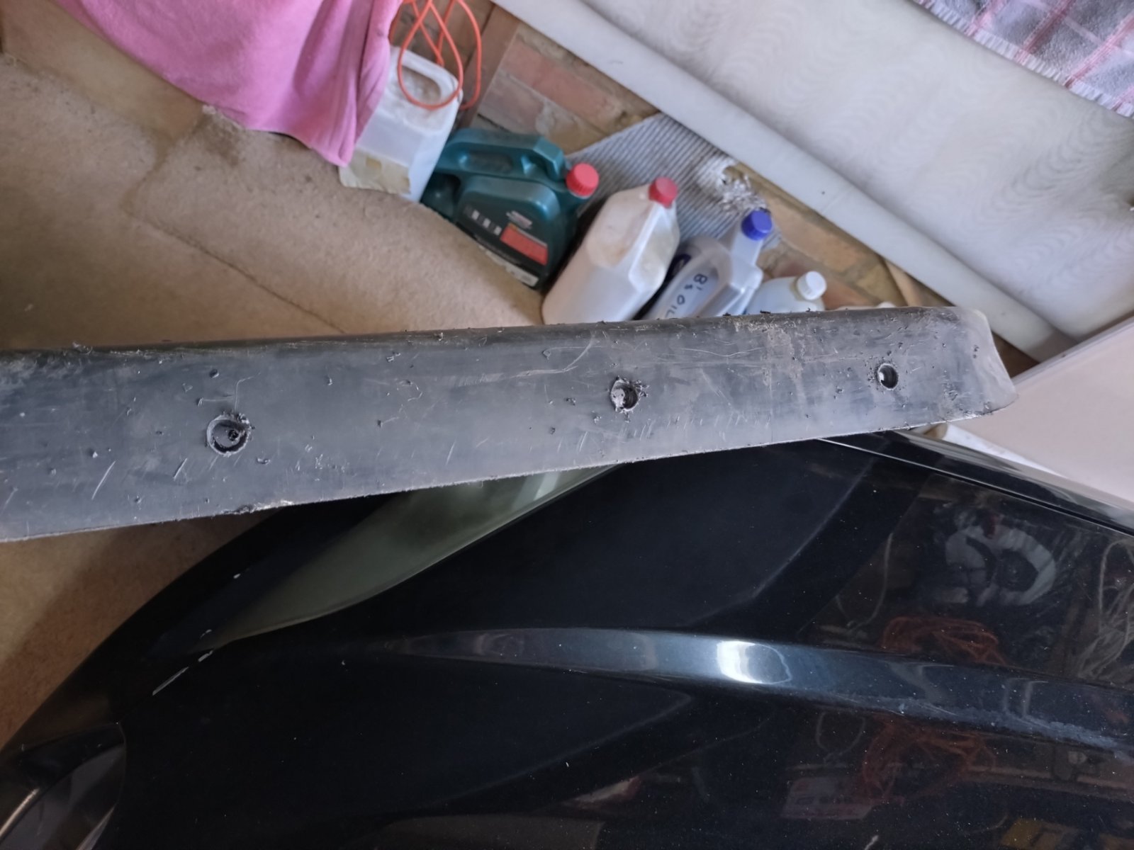

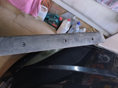

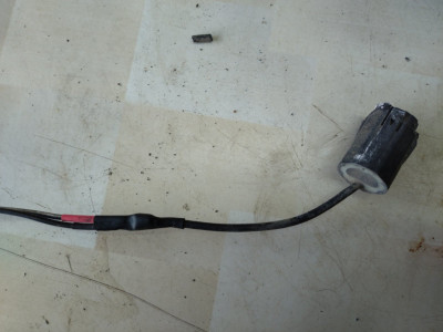

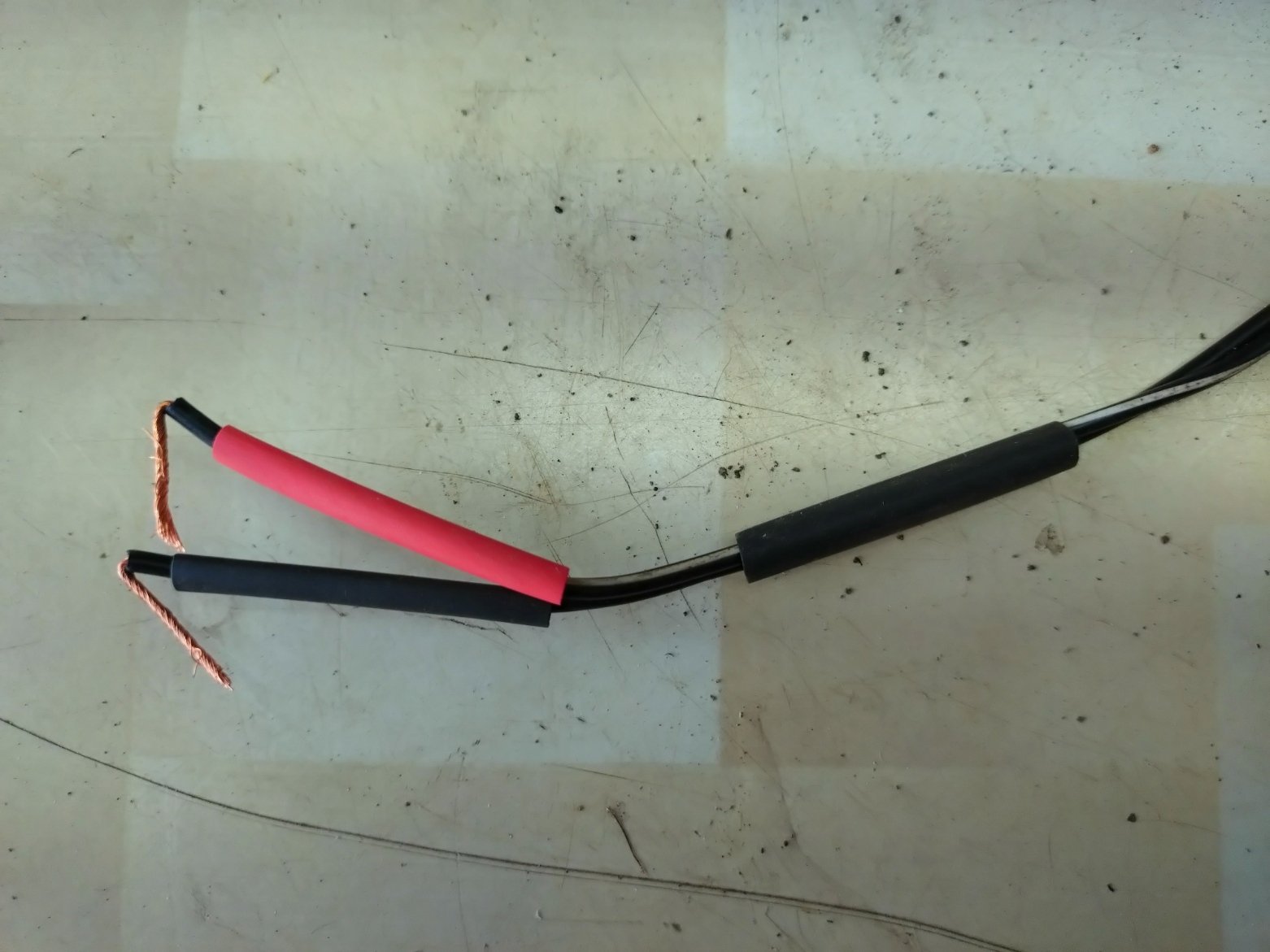

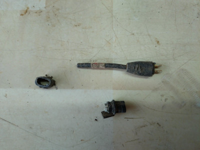

Got up this morning and thought 'Sun' and empty garage, SWMBO out on Mondays, time to make a better job of the emergency bumper repair that I did last year! So I removed the parking sensor and ran into the first issue. The connector plug fell apart in my hands so a bit of reworking required:
The obvious thing to do is to cut the plug off clean and splice in a section, so I found and prepped a decent link:
This end is ready to go back on the car when I've finished the painting but I could finish the end to the sensor:

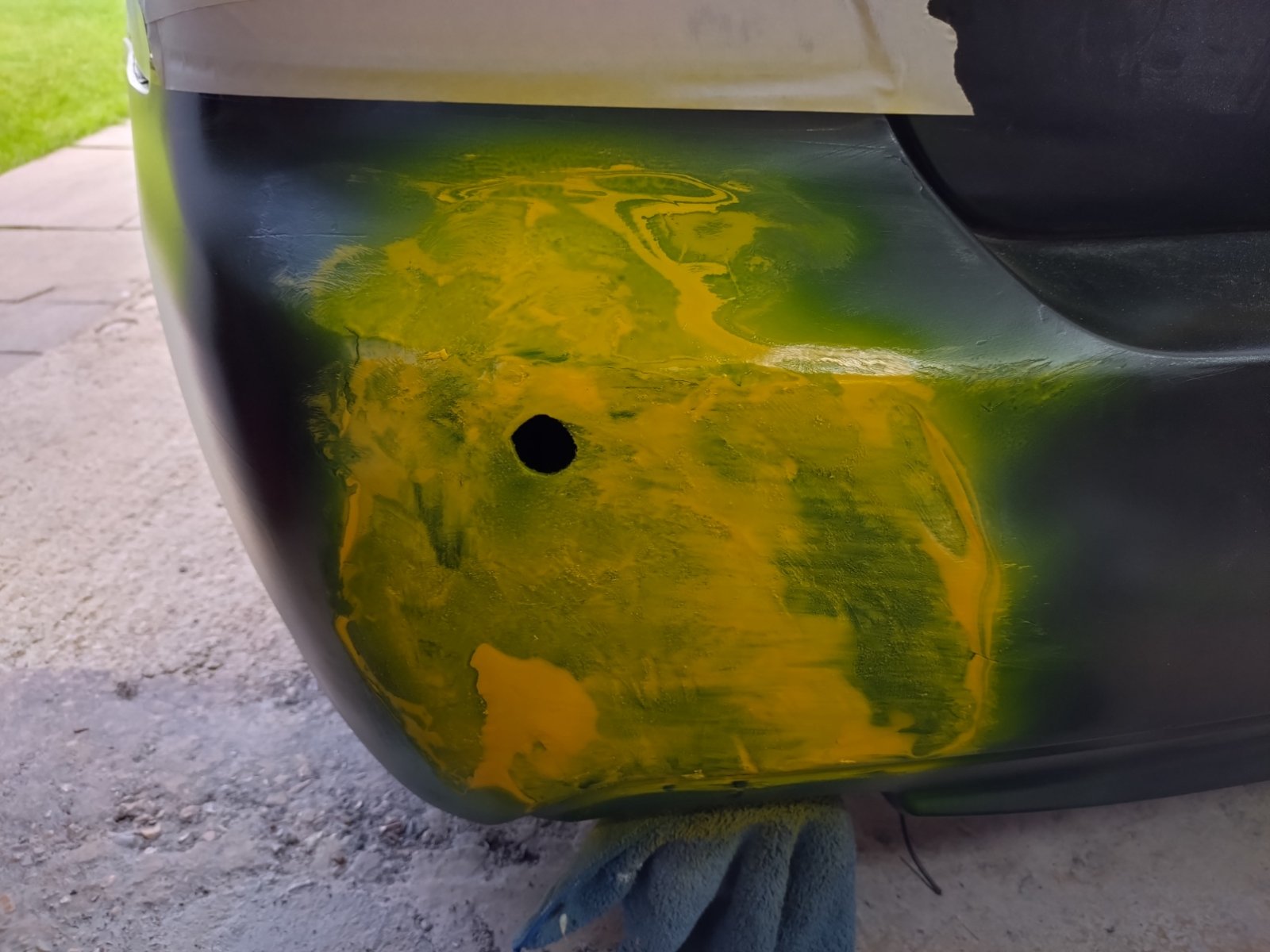

Having got that ready I did the body prep and initial filling and now I am waiting for the stopper primer to dry ready for the top coat, hence I came indoors to post this:
Once painted it won't be concourse finish but lets be fair it is a 20 year old daily driver!!

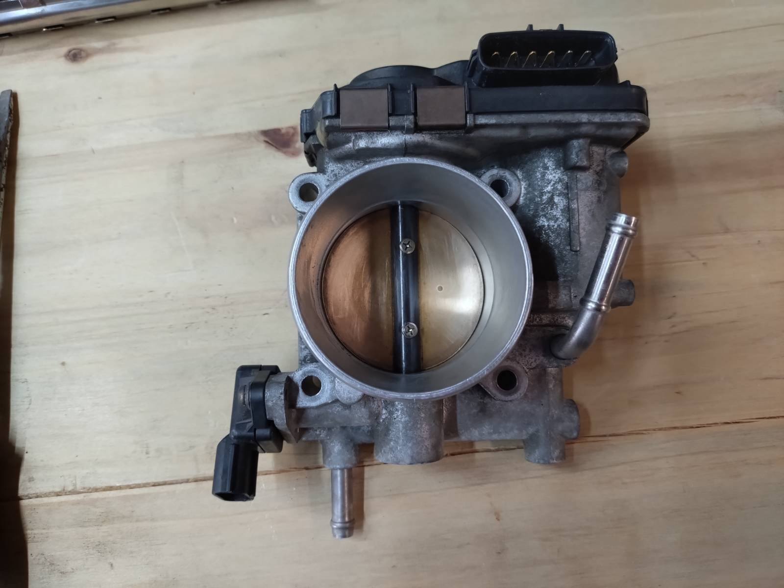

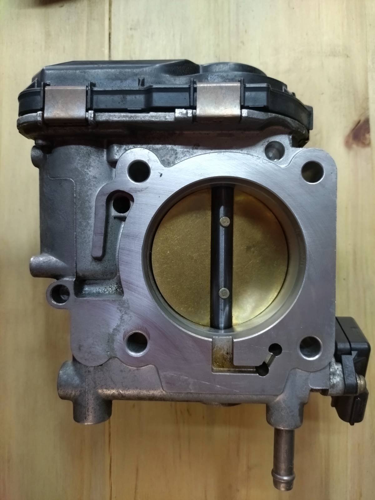

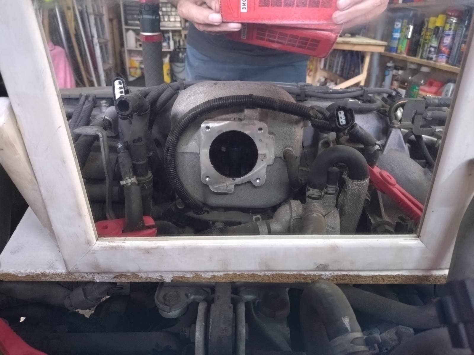

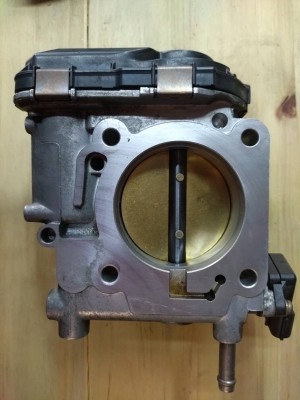

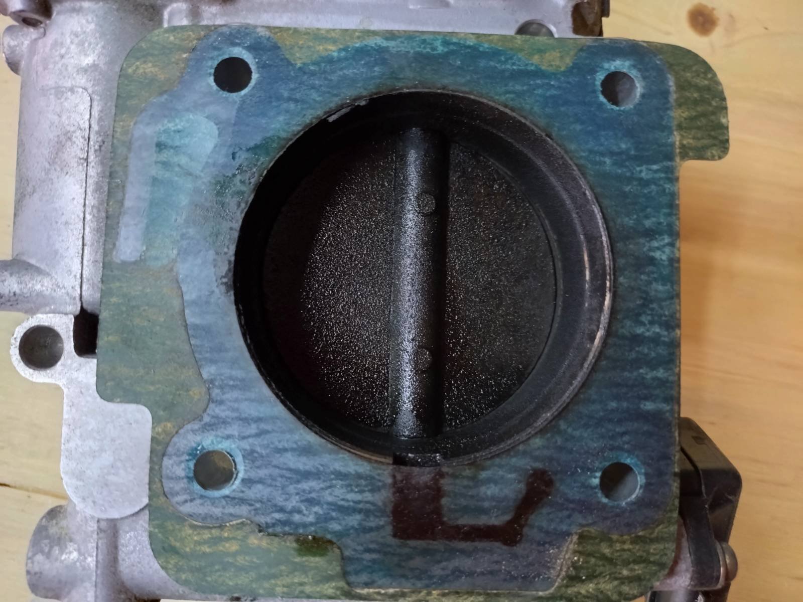

Over the last few weeks I have noticed a slight hiccup in the Subaru tickover which is dependant on the load on the engine. If I stopped in traffic and applied the handbrake but left the car in Drive the tick-over was very smooth but down to 500rpm and very occasionally a slight misfire. If I turned on the aircon it got worse but then eased off if I put it in neutral but still there. Turning off the aircon while in neutral and it disappeared completely. So to sum up when loaded at idle it misfired occasionally.

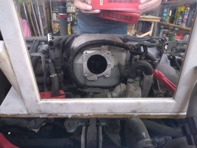

A little research suggested that this problem was almost certainly down to carbon build up on the throttle butterfly rim thereby blocking the correct flow of air for idle speed. The cure simply being to remove and clean the throttle body. Thus I decided to take a run up to Cambridge to collect a new gasket before stripping it down. My trip came across a couple of interesting things which I have posted in the Double Pillar Boxes thread and the Garages thread.
On my return I opened the bonnet, removed the air box and place a mirror against the bulkhead to view the throttle body:
I didn't want to clean it in situ as debris may have gone into the manifold so it was a simple disconnect two electrical connectors and two cooling hoses, clamped off first, withdraw the 4 x 10mm bolts and lift it out on to the bench.

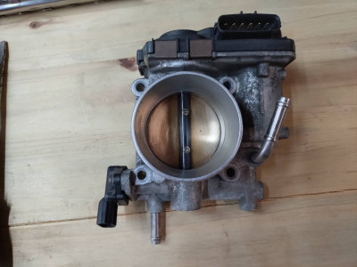

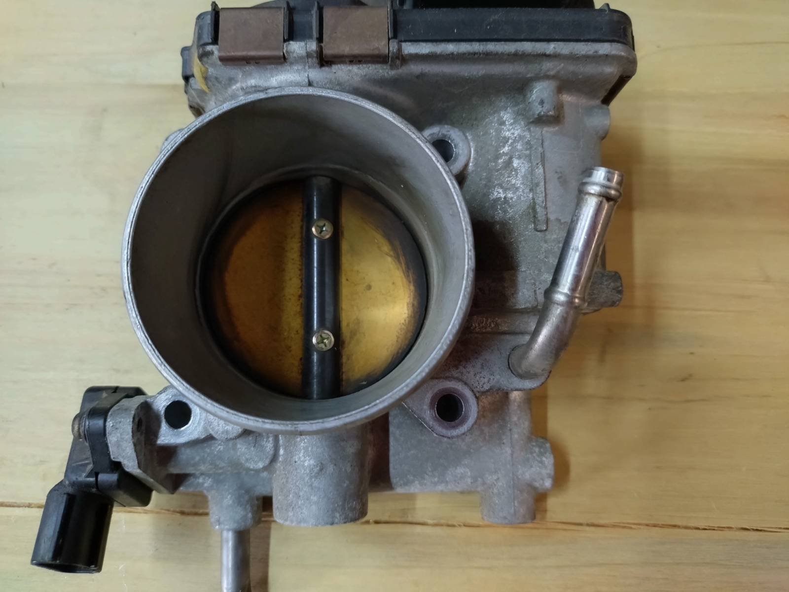

This is how it looked:
I set to with my carb cleaner and an old tooth brush until I reached this condition:
Then it was a simple matter of reversing the process with the new gasket installed to complete the manual work. However the job was not finished as any work done to the air input system on this engine requires a re calibration of the idle speed as there is no actual way of adjusting it. That involved a procedure of reprogramming the ECU for idle which I completed and now it is running perfectly with no missing when loaded at idle. Job Done!!

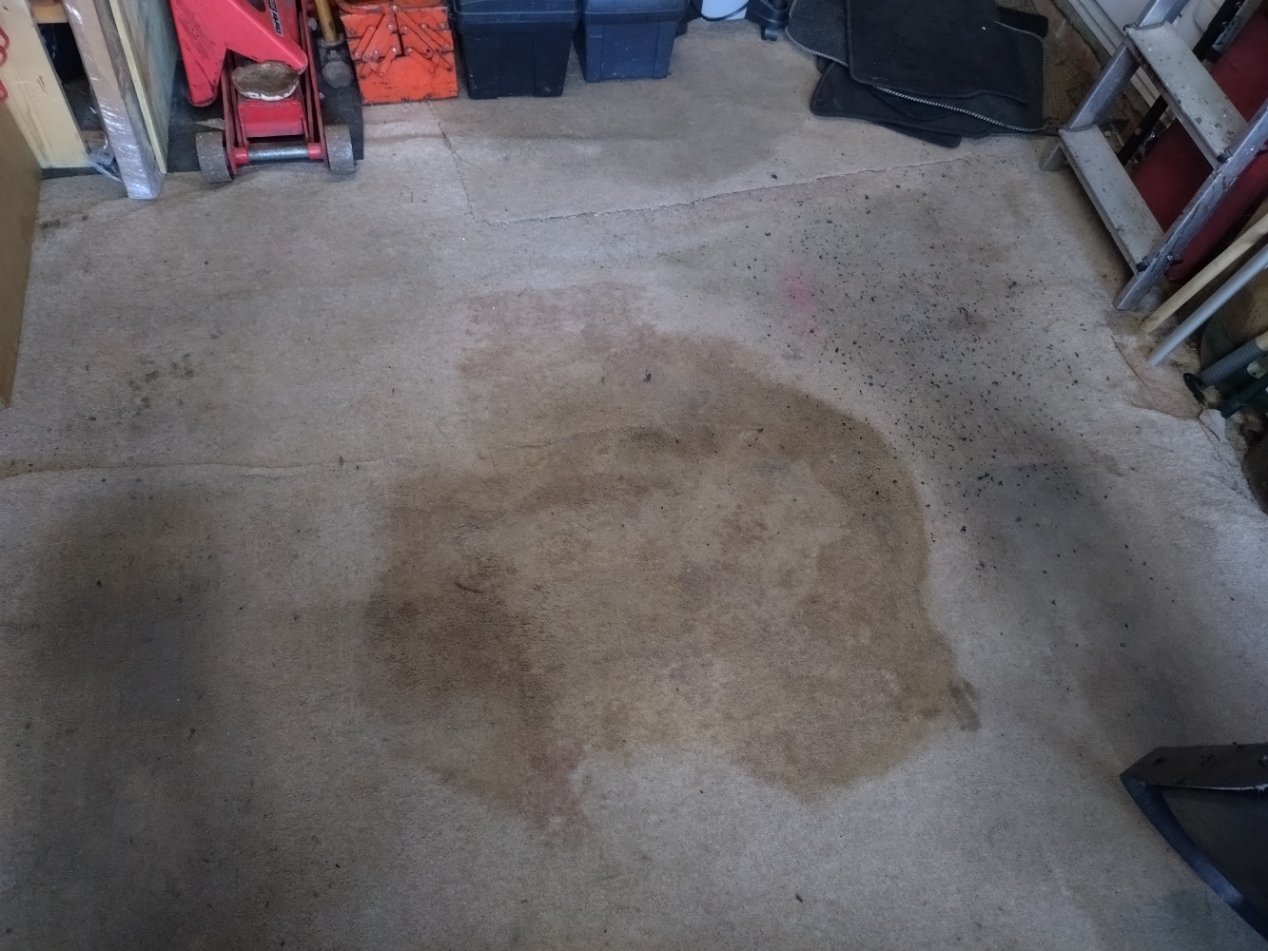

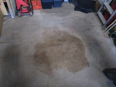

A little secondary job. I keep a large oil tray on the garage floor to collect A/C condensate when SWMBO puts her car away. The idea is to stop the carpet getting damp but it has failed:
So I had an idea today and I have drilled vent holes in all four sidewalls of the tray in the hope that the resulting ventilation will keep the carpet healthy!!:
So fingers crossed and we'll see what it looks like after a week!!
