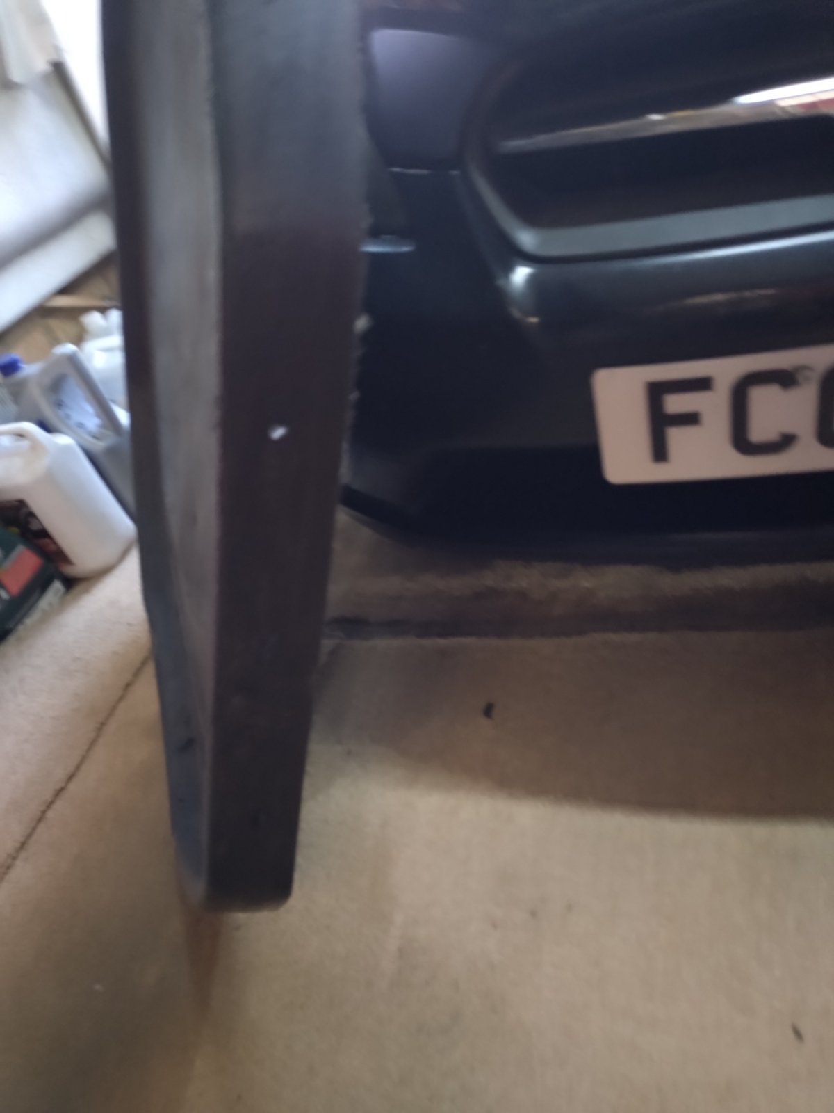

A little secondary job. I keep a large oil tray on the garage floor to collect A/C condensate when SWMBO puts her car away. The idea is to stop the carpet getting damp but it has failed:
So I had an idea today and I have drilled vent holes in all four sidewalls of the tray in the hope that the resulting ventilation will keep the carpet healthy!!:
So fingers crossed and we'll see what it looks like after a week!!
