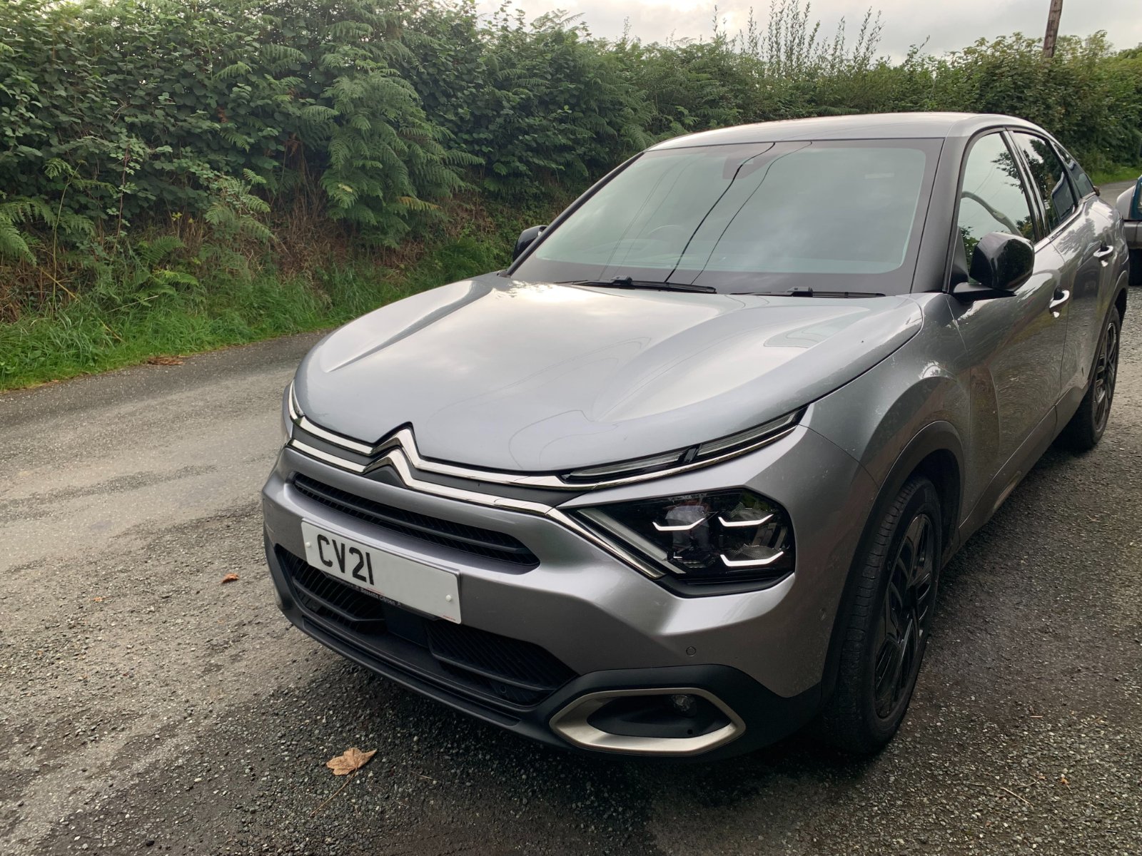

So I have a new C4 Petrol as a courtesy car for a few days. It's a petrol with the EB2 ADTS Turbo charged engine. It has a displacement of 1199 cc, 100 kW of Power and 231 Nm of Torque, and of course 3 Cylinders.

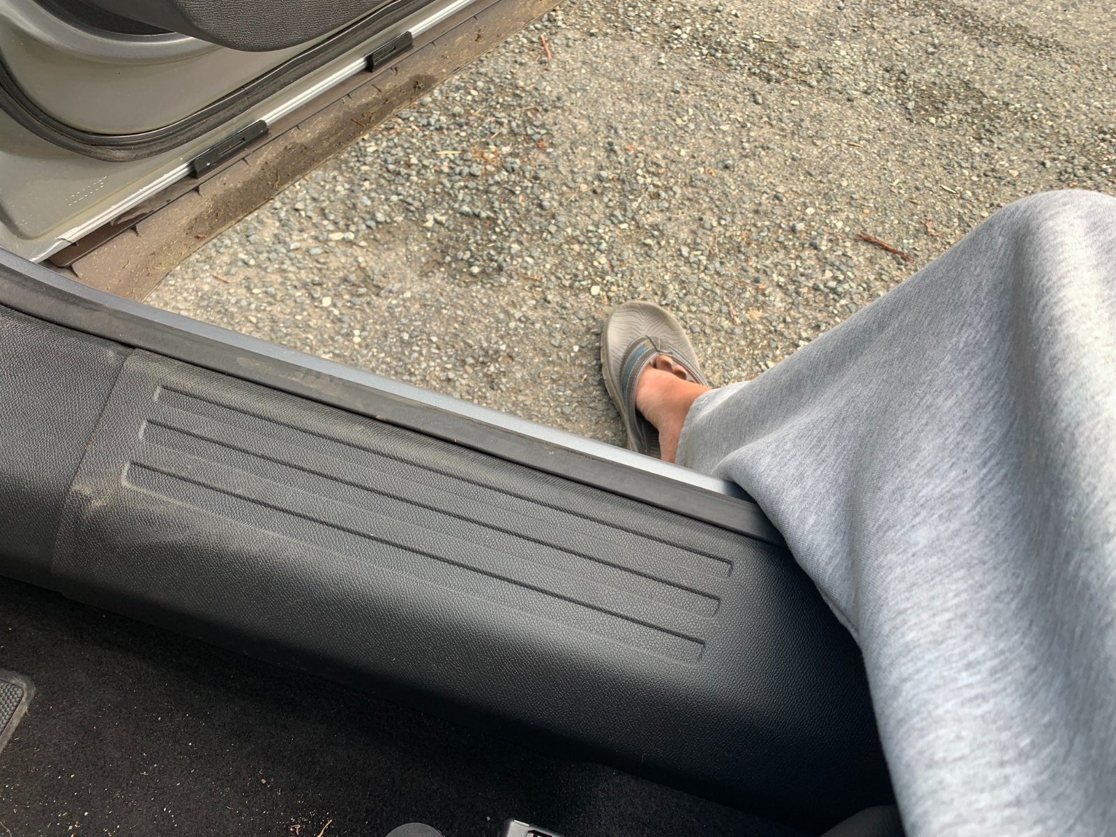

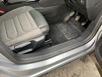

1) It's like a canoe to get in and out of. By this, I mean the sills are very high, so you have to literally step over the sill to get into the car and when trying to get out, you have to do the high jump in order to get your leg out

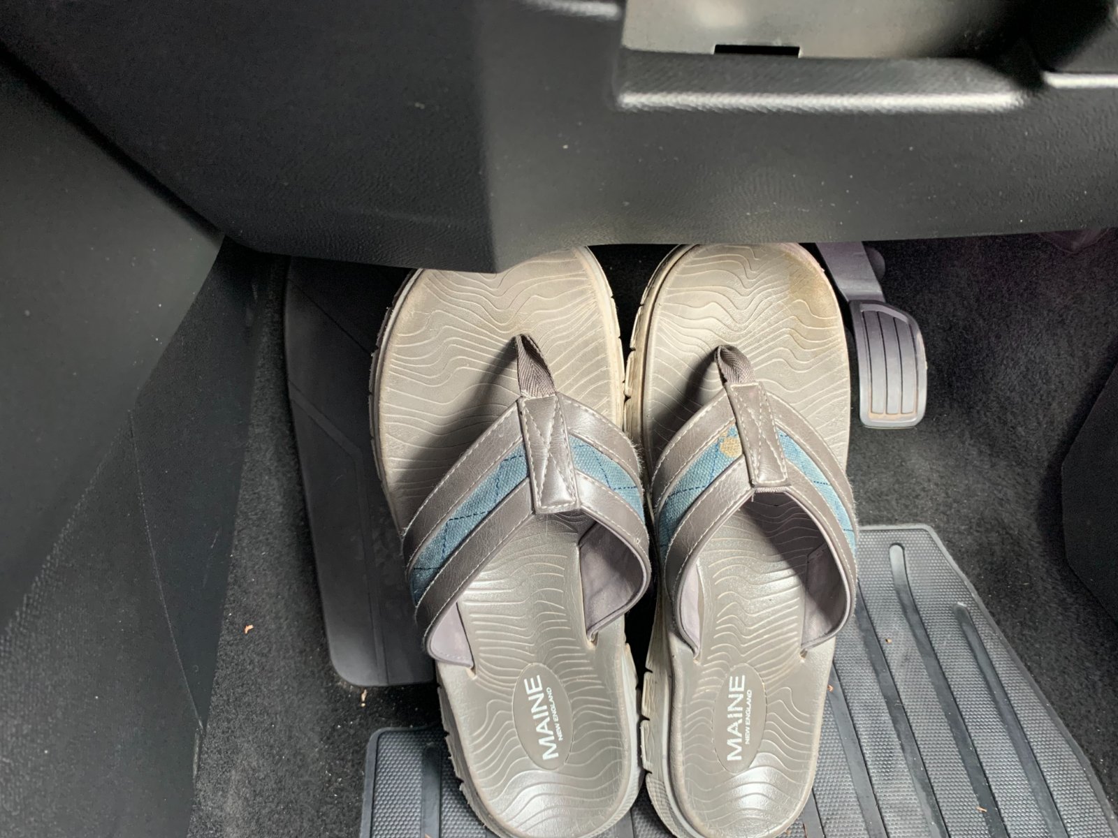

2) Pedals - terrible! I've seen this before on another PSA vehicle, but I can't remember which model now. Basically the clutch pedal is too near the foot rest, so as you are pressing the clutch, your foot is catching on the foot rest and not the pedal - very annoying and I couldn't drive like this for long. Because of this the brake and clutch pedals when used together cause your shoes to catch each other - it's a total dogs breakfast.

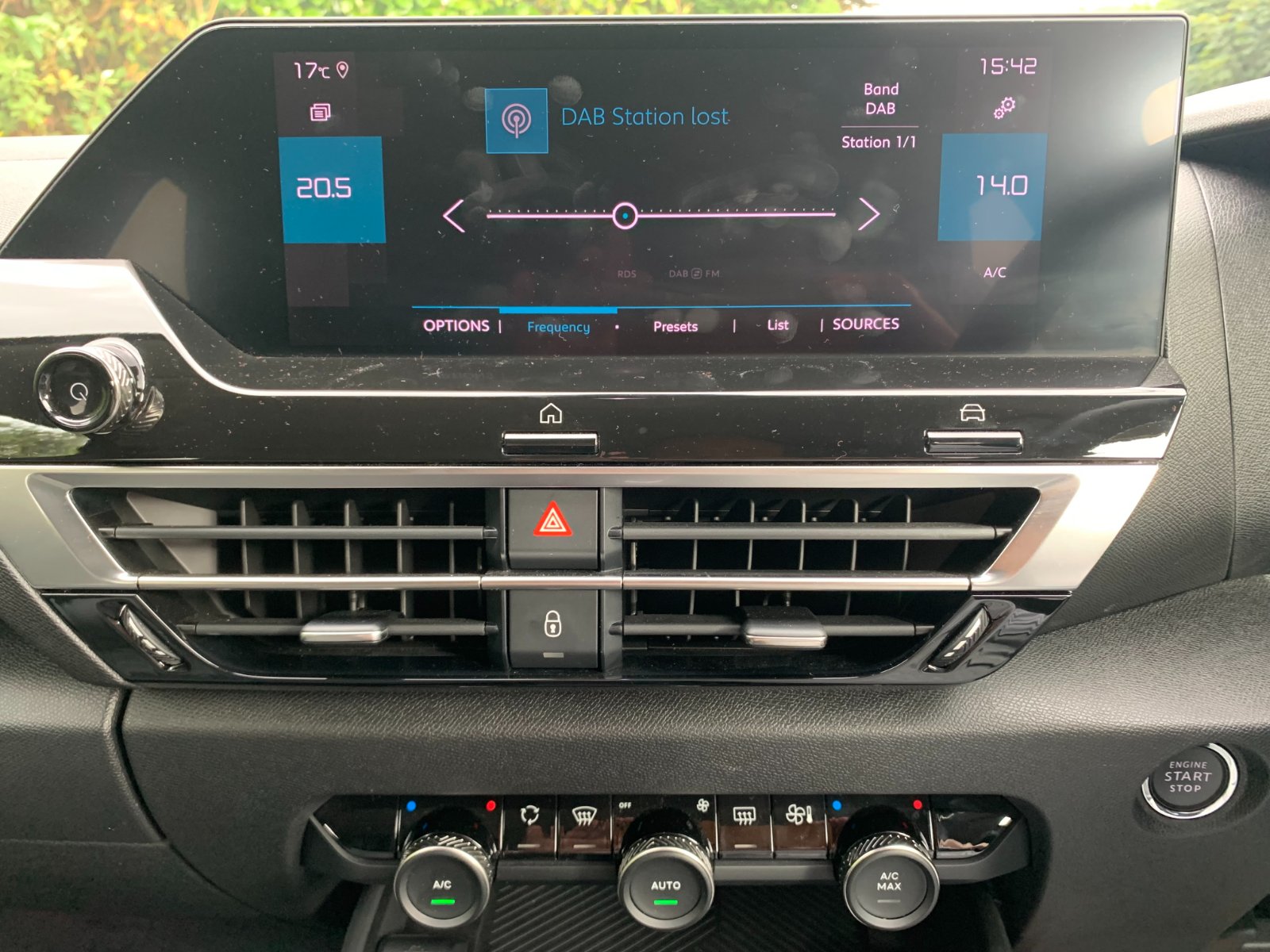

4) The interface is worse than mine, with different steering wheel controls, it is now overly complex to engage or change the cruise control settings. There are too many buttons in close proximity to deal with and this means taking your eyes off the road to see what the hell you are doing. The extra buttons are confusing and you have to keep checking the display to see what you have done. The rectangular buttons need to be pressed up or down and pushed in to confirm settings - but hard to see what you are doing.
The 'Assist' button just seems to deactivate Cruise and does nothing else except confuse. The addition of the limiter button is ridiculous - who uses this with today with speed sign recognition? By removing the cruise / limiter stalk paddle that most people know how to use and putting extra buttons on the steering wheel, it becomes overly clustered and unintuitive as you now have to take your eyes off the road to see what the heck you are pressing.

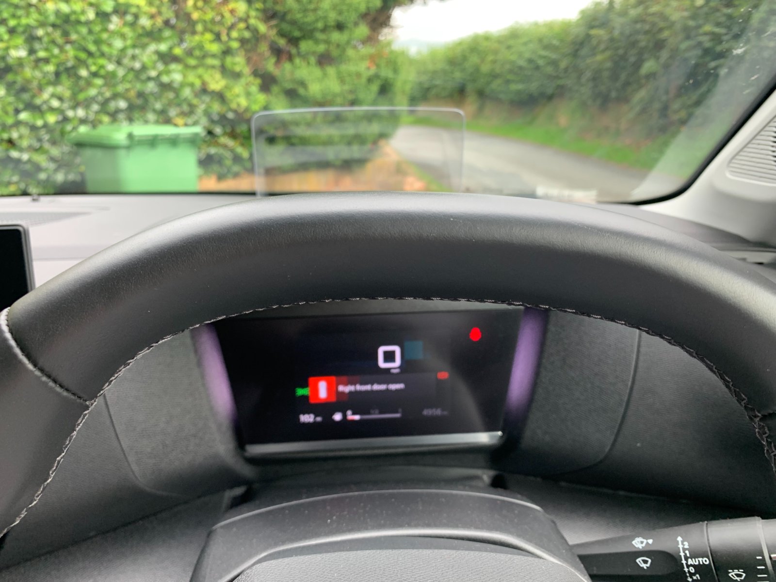

Not that you can see anything much displayed from driving position, but here are the display options:
Citroen C4 Instrument Panel
I had a few close shaves coming back, as I pressed the wrong button and it resumed the 70MPH cruise from the dial carriageway instead of the OK button

| 1) Quite unusual rear end styling. | 2) The Side shows more aggressive Tonka Styling. Shows wheels to be dominant. | 3) The Front follows similar Styling found on other later models. |
| 4) Seats are nice, but instrument display view is hampered. | 5) The deep footwell. | 6) A struggle to get in and out. |
| 7) I need this storage in my Aircross! | 8) 10" Display & note Climate controls are now physical buttons. | 9) You can just see the instrument panel through the spoke, but not in a driving position. |
| 10) Display is no better to use than previous and does little to improve. | 11) Can't fit an iPhone XS Max on the top. Not much use but better than nothing. The USB is one port for charging and another for Music / Mirror Link. | 12) Quite Roomy in the rear. |

| 16) Removed the thumb wheels and put awkward switches in place. | 17) Pedals have limited space and are clumsy with the large footrest. | 18) Totally awkward to use - even with shoes! |

I like the drive, it is comfortable and responsive, but entry and egress are not easy and you can trip over yourself trying to get out - you really have to lift your foot up a lot higher to get over the door sill. So it won't be ideal if you have knee or back issues IMO.

I do think that putting that large footrest on the left is a bad design job as on a manual, you really can find it difficult to press the clutch pedal, especially when braking at the same time. My shoes were rubbing together getting caught up trying to do this, so that would be a big negative on the practical driving aspect, for which there is little you can do, unless you have pixie feet!

It took ages to get my phone paired and the heating controls are not easy to sort either:
I thought I had the left and right set up with the correct temperature, but there wasn't enough air flow, so I hit the MAX A/C button and it lost all the settings and turned the fan on full blast. Had to stop to reset all the settings - really frustrating and not the same as previous dual climate systems I've had.
Now I'm very tech savvy, but I don't find the interface intuitive at all and this has been a major criticism of later PSA vehicles with touchscreen interfaces.
People are used to having a tactile interface - buttons which they know where they are located and what they do - find it and push or turn it - simple. Having a centralised system that requires multiple presses in different areas of the screen depending on which screen you are currently in is distracting and not conducive to focussing on driving / watching the road.
So they partly listened by reverting the heating / climate controls to physical buttons - but they have missed the general criticism. It is overly complex and impossible to use without taking your eyes off the road. If they think that by making the interfaces bigger each year and giving you more touch screen real estate this is going to improve, they've missed the whole point.

I think it's a shame that the steering wheel being rather thick and rectangular obscures the instrument panel - not that there's a lot there to see. There is a Heads Up Display as seen on photo 14 if (you look at the windscreen, you can just about see it).

Well it was too good to be true. Popped out yesterday in the new C4 and 20 minutes in "bing bong" - Collision Alert Warning System Fault!
Pulled over, switched off, restarted, but no, that's not worked, so no cruise control now either. The car has done 5000 miles!
With the very smooth suspension ride on the progressive hydraulic cushions I am really impressed with the system. It is a frim ride, with very nice cushioning on the road - near C5 quality without the self-levelling.
This system has active cruise control, so uses an ARTIV unit in conjunction with the camera (Autocruise Adaptive Cruise Control Radar Module) or distance alert radar.
I know from issues with the later C4 Picassos that have this system, that the slightest misalignment of the radar unit can cause it to stop working - and of course all associated functions. I know that it can take days to calibrate these units on the road, so I'm glad I don't have that part of it on my Aircross. It does not seem very robust and even on a car with this soft suspension it seems to have nobbled it!
So that won't be a quick fix when it goes back and will likely need recalibration.

Re: Marc's C3 Aircross SUV, Rants Raves & Everything Else
Seeing how 'deep' the tub is (with very high sills) I wonder if the designer had worked on the Dutton Surf, Marina and Commander, and forgot that not many cars need to have such deep footwells?

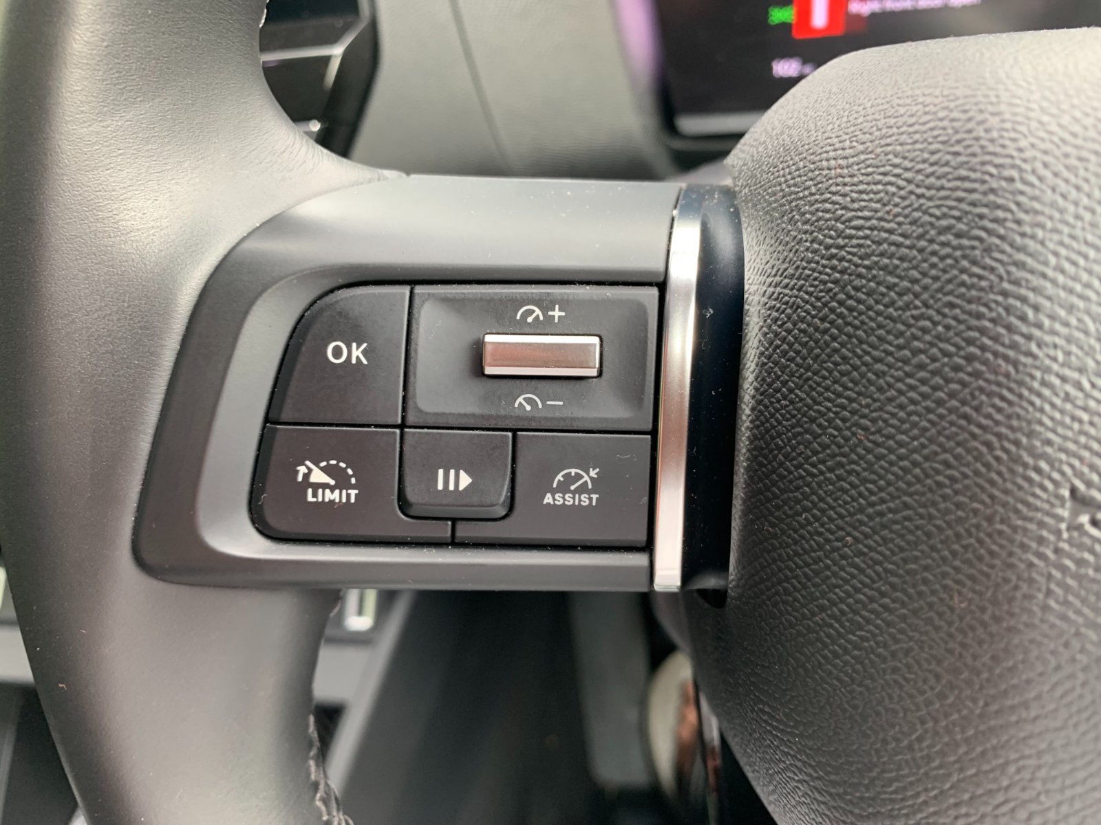

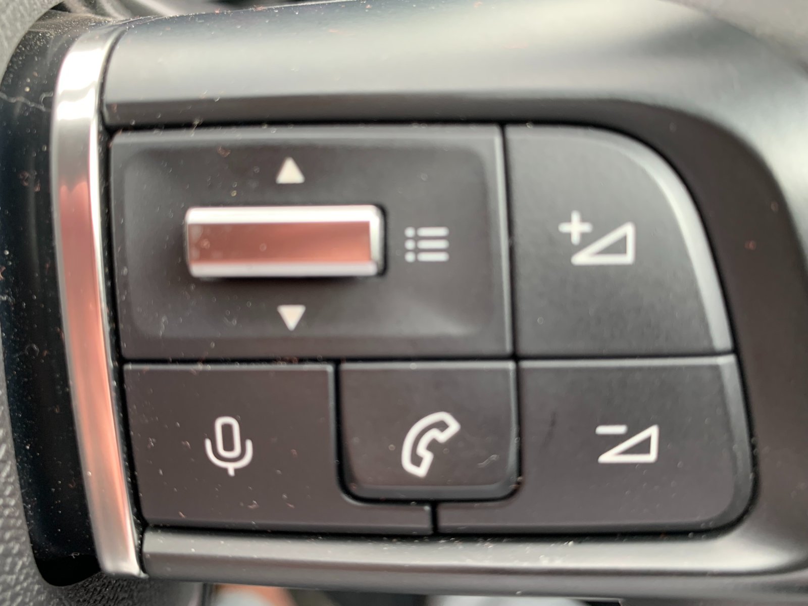

Those steering wheel controls look almost identical to the ones VAG use - which is who every other manufacturer seems to feel the need to emulate these days.
I've only driven two cars with them and just gave up on using any of the functionality as I knew I was going to end up driving off a cliff trying to turn on the cruise control, so just used my feet instead.

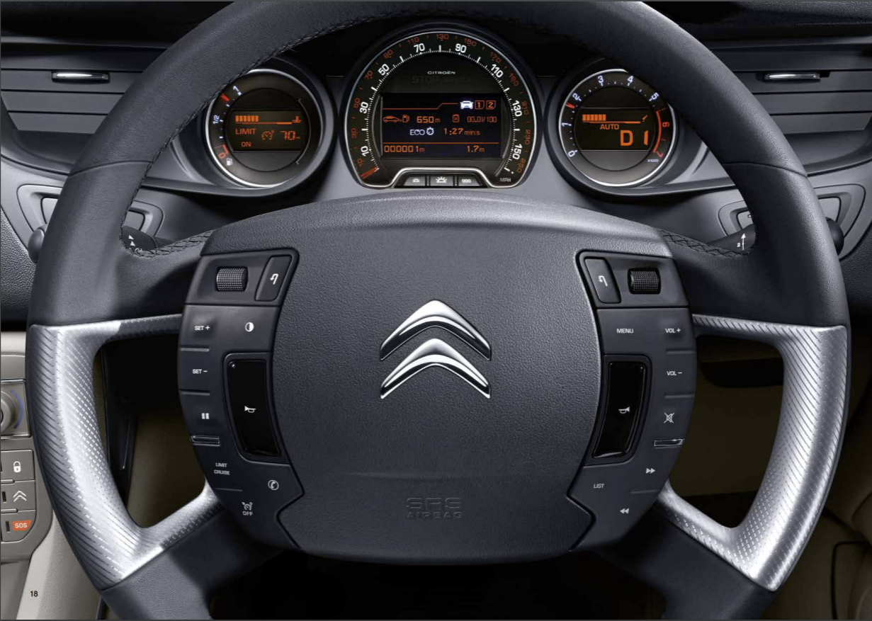

My C5 X7 had a rather complex looking steering wheel and I had many comments form passengers saying they'd "...never seen so many buttons in a car.."
Click Image to Zoom But on this it was logically organised and had the fixed centre boss, so the controls always remained in the same place when you turn the wheel.
On the left are the speed limiter / cruise controls, a button for night panel activation and phone answer / cut off.
On the right are the audio and media controls - volume up / down, mute, channel search and menu.
These have subtle raised 'bumps' on the relevant button that corresponds to increasing anything - volume or speed, so provides a tactile feel so you know when your finger or thumb is on that switch. The decrease button is always directly underneath on either side. They also have solid bars to separate sections of the controls - again providing a tactile way of navigating the most important buttons.
So these are somewhat easier once you get used to a fixed boss and the layout.
Now on my Aircross, they retained the standard cruise control paddle stalk on the left - which a lot of PSA users are already used to - so that is easy to use: forefinger to increase, middle finger to decrease speed. Press on the end button to pause and resume or confirm speed sign recognition recommendation and set.
But the C4 has done away with that and added more buttons which you can't 'feel' to distinguish which does what and can't easily locate the button.
Perhaps the designers ignored all the practicality of the previous system and thought it looks too dated with the new digital instrument panels and threw common sense out the window.
