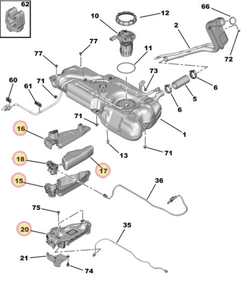

Well, I've just learned something new today about my Aircross. It has a Particle Emission Filter and Selective Catalytic Reduction system, but it appears not to have any DPF additive pump or additive system at all....
I must admit to having double and treble checked, but no - according to the information I have it does not have one on this engine.
I noticed something didn't read right when I was looking at the BSI data and configuration in particular, when I saw this entry:
So according this the DV5 engines don't have an additive pump.
So looking at Parts, I confirmed no additive tank:
So I do not have:
(15) Fuel Additive Sump
(16) Fuel Additive Cover
(17) Flexible Fuel Additive Pouch
(18)Fuel Additive Pump
(20) PEF Additive Reservoir
It seems the 15, 16, 17, 18 are for Euro 5 vehicles with Particle Emission Filters, and
20 is for Euro 6.1 Technical Emission Control.
I have Euro 6.2 Technical Emission Control. So there must be some jiggery pokery going on with these engines to get round it. I've found no mention wither in any of the technical info regarding 'additive' or associated terms - so will have to look into this a bit more...
So I do not have:

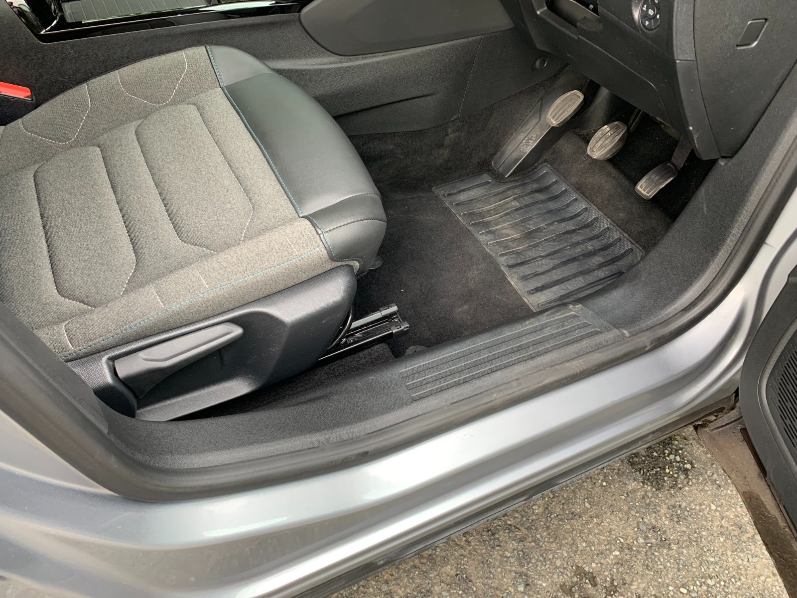

1) It's like a canoe to get in and out of. By this, I mean the sills are very high, so you have to literally step over the sill to get into the car and when trying to get out, you have to do the high jump in order to get your leg out
I've already tripped up several times and nearly fell overboard as I've tried to get out.

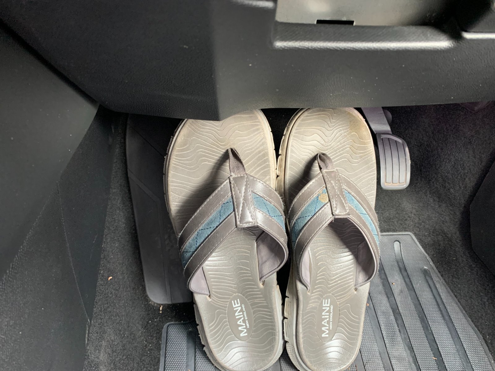

2) Pedals - terrible! I've seen this before on another PSA vehicle, but I can't remember which model now. Basically the clutch pedal is too near the foot rest, so as you are pressing the clutch, your foot is catching on the foot rest and not the pedal - very annoying and I couldn't drive like this for long. Because of this the brake and clutch pedals when used together cause your shoes to catch each other - it's a total dogs breakfast.

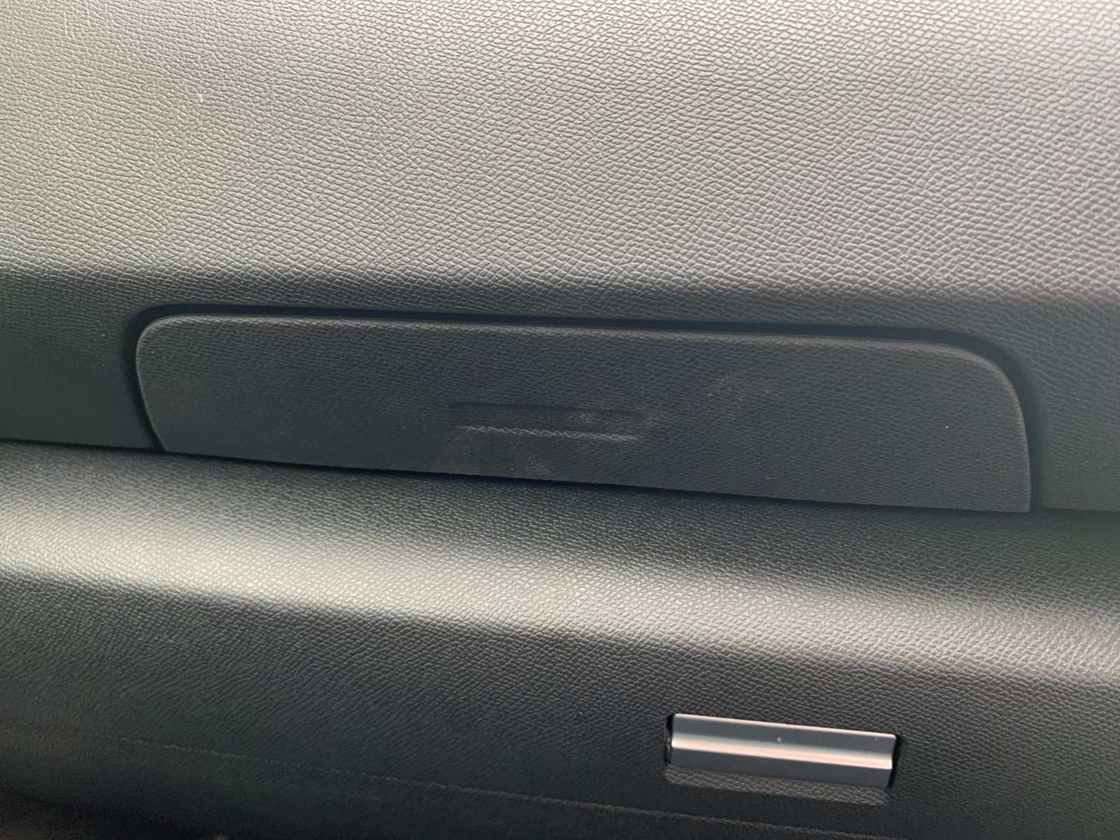

5) As per the picture in the table, there was this 'thing' that didn't seem to do much - I did suspect it being cup holders but ruled that out as there are 2 in the gearbox binnacle. I had to look this one up in the manual as it didn't seem to do anything. Turns out it's a mount for a smart phone or a tablet - but here's the catch - you have to buy the custom mounting from Citroen depending on what you want to mount
Citroen C4 Smart Pad Thingy

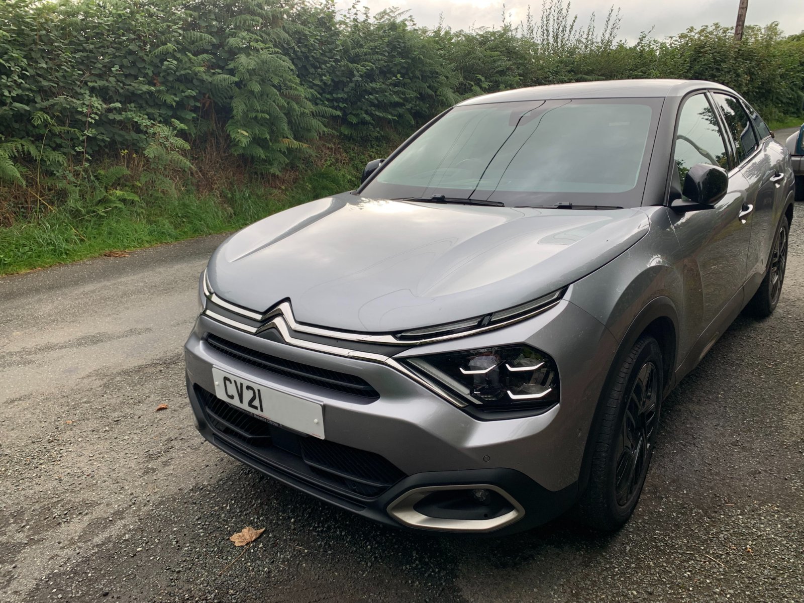

So a few pics whilst I've got it:
| 1) Quite unusual rear end styling. | 2) The Side shows more aggressive Tonka Styling. Shows wheels to be dominant. | 3) The Front follows similar Styling found on other later models. |

| 19) A 'Thingy'. I was trying to see if it was a cup holder No - it's a smart device thingy. | 20) My knee is just above the sill! Very awkward for entry / exit. | Blank |
