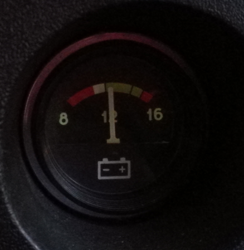

Looks like you're right Jim. Just did a quick test and got the following data.
Here's full-load (main beam, heater blower on full, rear fogs on and rear window heater on) at idle just after a cold start - idle admittedly is a bit slow as well.
Voltmeter on the dash says this:
Multimeter on the battery shows 12.28V - so pretty close.

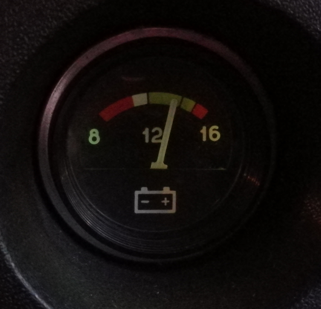

Same load with the engine brought up to anywhere above idle and it jumps straight up to here:
Which reads as 13.93V according to my meter on the battery. Off-load it's a steady 14.2V, and sitting right on the black mark in the green zone on the voltmeter, which is obviously intended to signify "normal." It's a bit hard to come up with precise measurements on a non-calibrated instrument like this, but it seems at least functionally pretty accurate.
