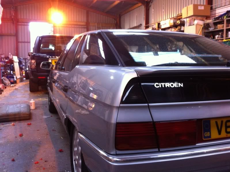

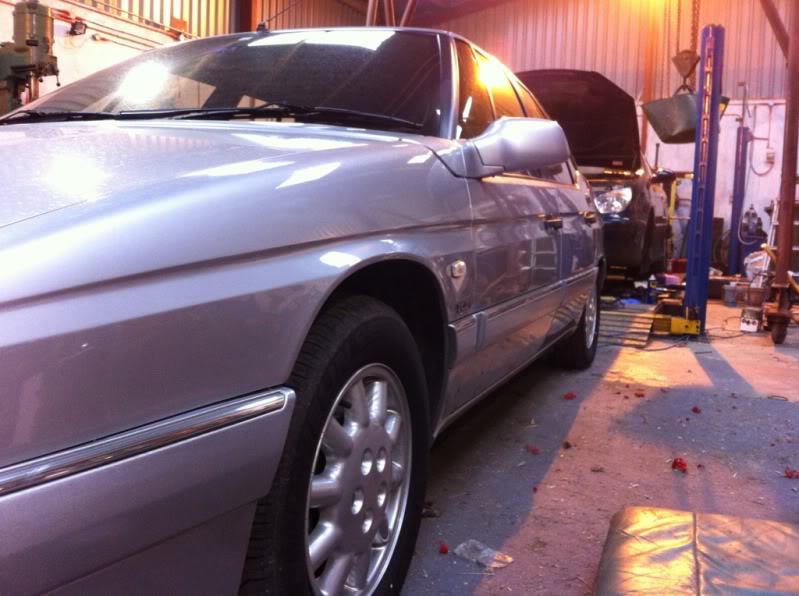

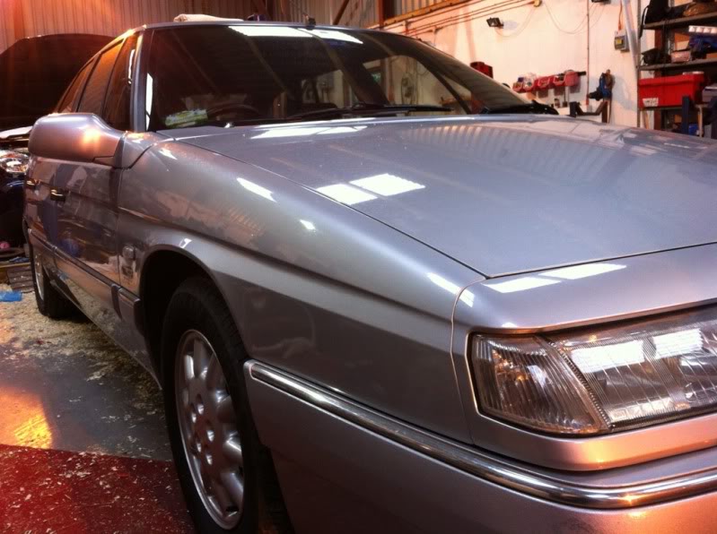

Well, I decided to finish removing the stripes from the XM tonight.
I peeled the stripes off the car and it left adhesive marks on the paint, I bought a bottle of white spirit on the way home from work tonight.
After half an hour with a rag damped with some white spirit and a bottle of AutoGlym Super Resin polish here are the results:
The car looks a bit plain now :? I'm almost tempted to put the thin coach line that runs along the cars waist line back on it, in some red, unfaded lines.
