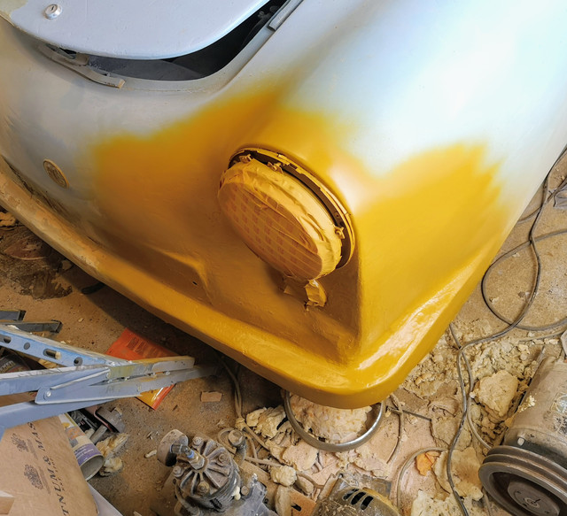

I've also started to build up the lower edge of the offside corner too. It doesn't need anywhere near as much work to get it to a usable state thankfully.
Really wish I'd discovered this glass??? fibre loaded paste sooner as it's so much easier to use than the old school separate Matt and resin approach?. Having done a bit of anecdotal testing shows it to be more than strong enough for this job.
Hopefully I'll get time to get it finished tomorrow and start throwing some paint at it.

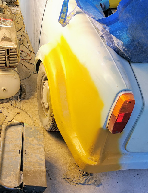

The radius of that corner??? being quite a ways off was bugging me...so out with the grinder????? again.
?At close of play today this is where we were.?
Still not perfect, but is close????? enough now that I think I can call it "good enough" given I started out with this. ?
I am going to be finding dust for months.

I had a feeling this morning that???? this was going to be one of "those" days, and indeed I was correct. Spent the entire day running around all over Hell chasing my own tail. As such was limited to about twenty minutes in the g?arage while dinner was in the oven. ?
This was however sufficient to move things along with the Invacar bodywork. The nearside corner was now showing roughly the correct profile following the wor?k a couple of days ago, however the surface was still quite rough as the underlying foam had been revealed in a few areas. The resin there had ensured that it was structurally fine, but the finish was obviously going to need work before we could even start to think about paint.
To remedy this I managed to scrape just about enough filler out of the ancient tin I stumbled across the other day an?d slathered it on, trying to do as much as I could to ensure that it was worked into the surface to leave as few pockets of air as possible (the same was done for the slight void left aroun?d the crack just below the indicator). ?
Then once that had just started???? to harden I hit it with the san?de?r?.
Will want a little bit more??? sand?ing before a resin layer is laid down over it, however I had to abando?n things at that point as the timer telling me dinner had to come out the oven was beeping at me.

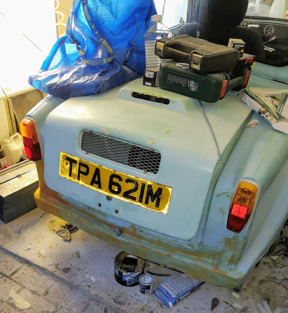

I suspect that tomorrow is going to involve lots and lots and lots and lots of sanding.
Even before sanding the rear valance is looking a lot smoother now... I'd forgotten how roughly I'd just slapped the filler on there originally!
