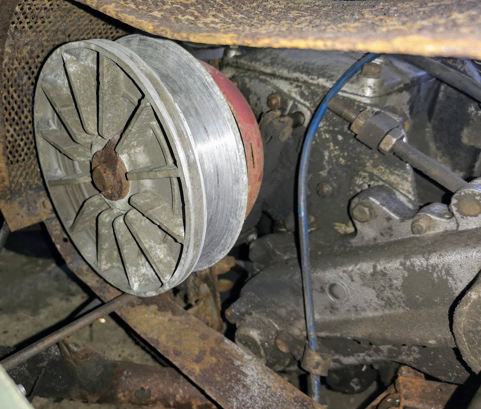

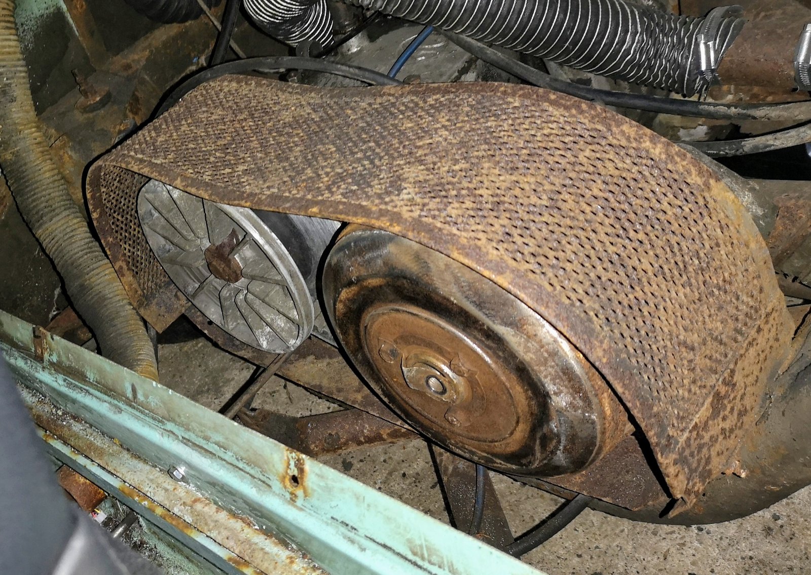

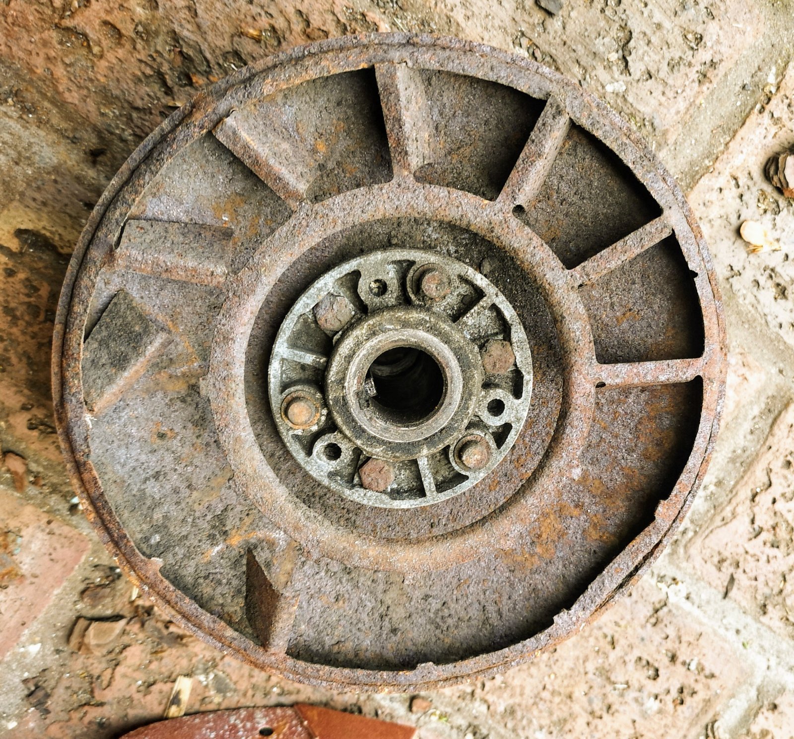

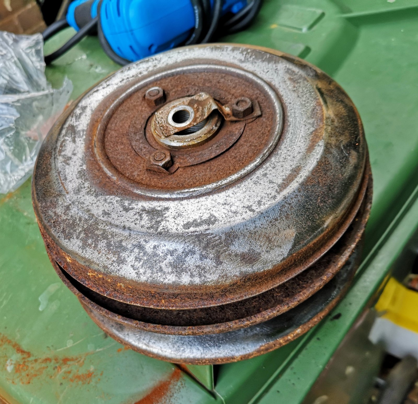

Given I've been scrambling to get the van ready for a trip later this week the Invacar has taken a bit of a back seat. Hasn't moved since the last trip out when I had issues with the drive system slipping. The basic issue seemed to boil down to the poor shape the surface of the pulleys were in. Dealing with this issue was being hampered by the fact that I hadn't been able to get the pulley retaining bolts out. This was despite having applied enough torque to tip the car onto two wheels.
Today I had a bit of free time, and with the van away at the garage figured I may as well see if after soaking for a week or so, if the secondary pulley bolt was any more interested in moving.
After a brief fight...
Finally!

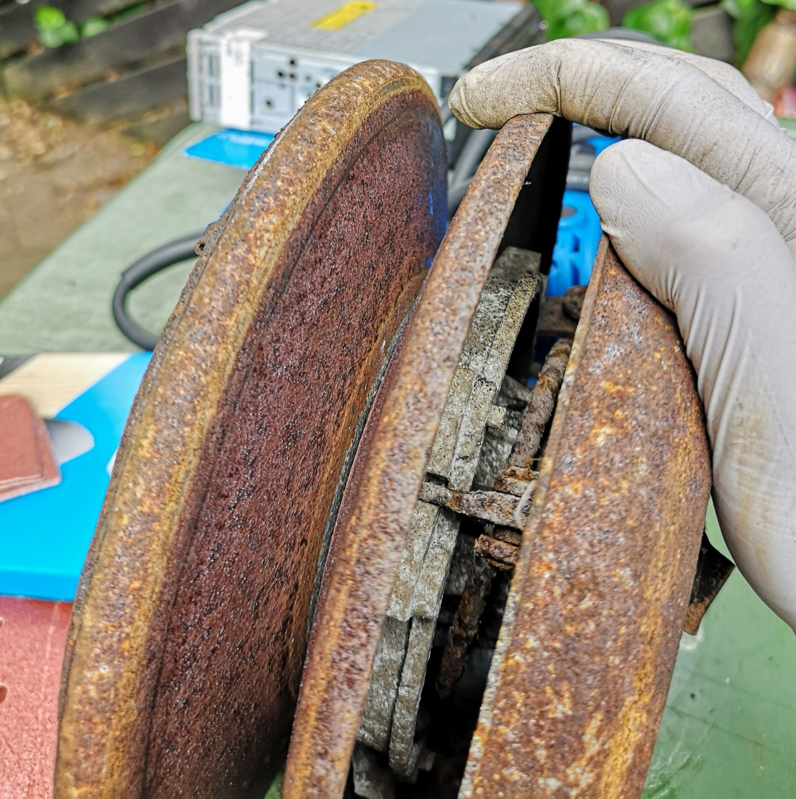

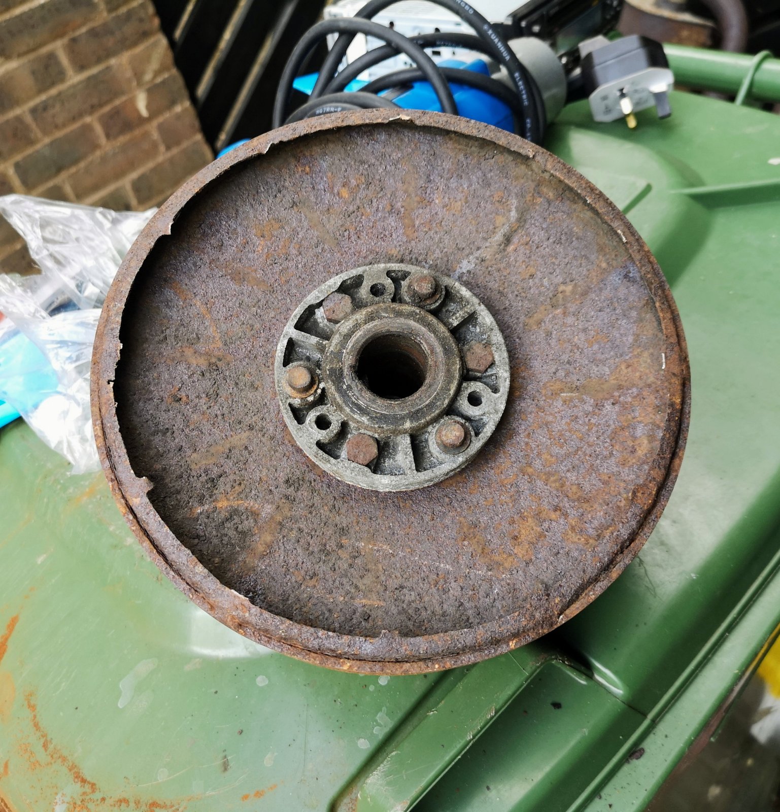

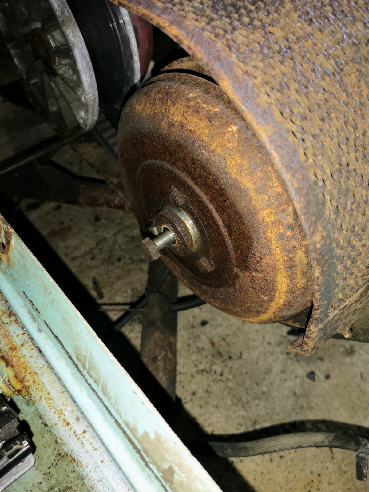

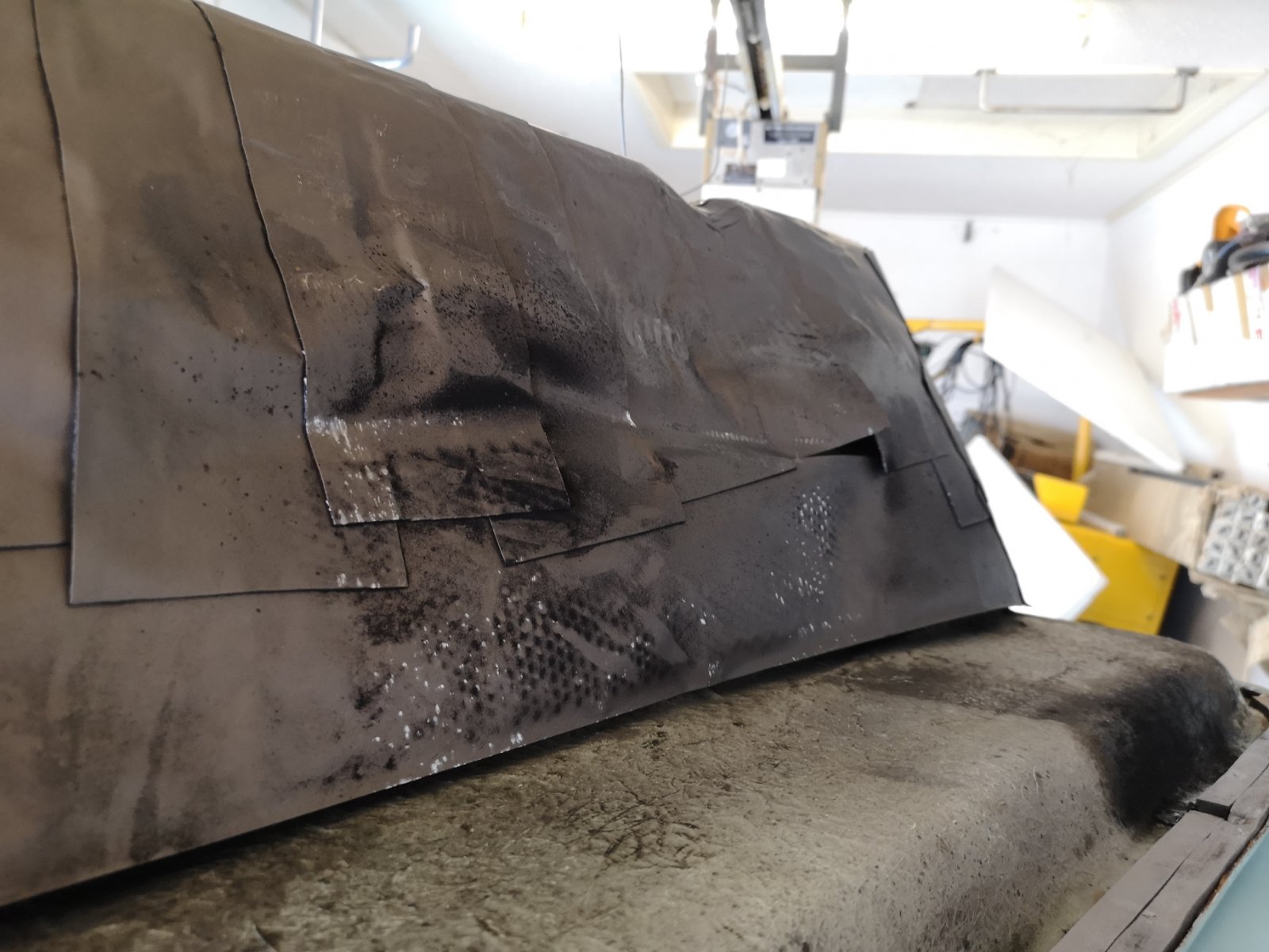

Doesn't take a genius to see why the system has been struggling and making a royal mess of the belt.
I'd seen that the fan on the back of the pulley was pretty well shredded, wasn't really obvious how bad till it was off!
This may well have something to do with the not insignificant vibration I've been suffering at speed given it will have been making a royal mess of the pulley balance.
It's just a thin bit of pressed steel... corrosion and centrifugal force over the years have done a number on it. If I find there are issues with pulley temperature I'll have a look at improving that side of things...we can probably do better than a bit of time with modern electric fans I reckon.
For now though I've just pulled the shattered remains of it off, which will *hopefully* significantly reduce the vibration issues I've had. Time will tell.
Astonishingly the moving elements aren't seized, despite looking like they've been dredged off the Titanic.
The one thing I hadn't realised until today through was how mental the preload on that pulley is - I'd originally half planned to take it apart to clean and lubricate the innards - however now I've decided to leave it well alone for now. I have visions of it taking my head clean off if I were to mess with it.

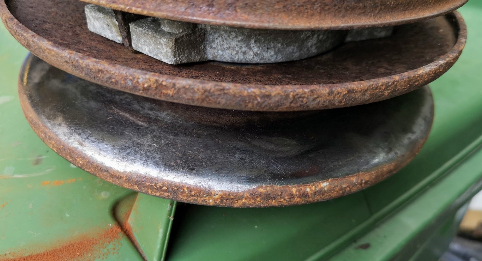

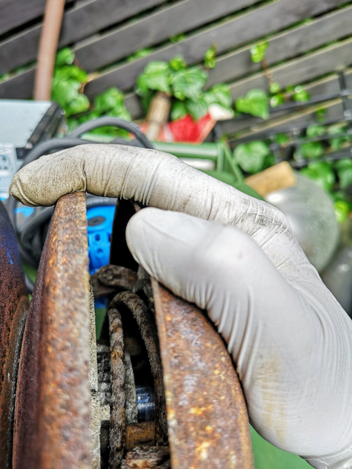

The primary pulley is aluminium so was in generally better shape. It was a pretty quick job to clean that up by running the engine in gear and using a sharp chisel as an improvised lathe.
I had planned to do something similar with the secondary pulley using my workbench and the drill...until I realised that the drill is in the back of the van. In a yard at the far side of town. D'oh!
So plan B was a bit more of a hack, just attack it with the carbide mop on the grinder.
Couldn't quite get right into the grove but should have got most of the running surface I think.
Gave the top a bit of a scrub too.
Just got things back in place (with a new belt - the old one had lost about 1/3" worth of width) before running out of time.
I'll get it bolted back in, adjust the belt and give it a test run tomorrow... I'm honestly really curious as to whether it will make any difference!

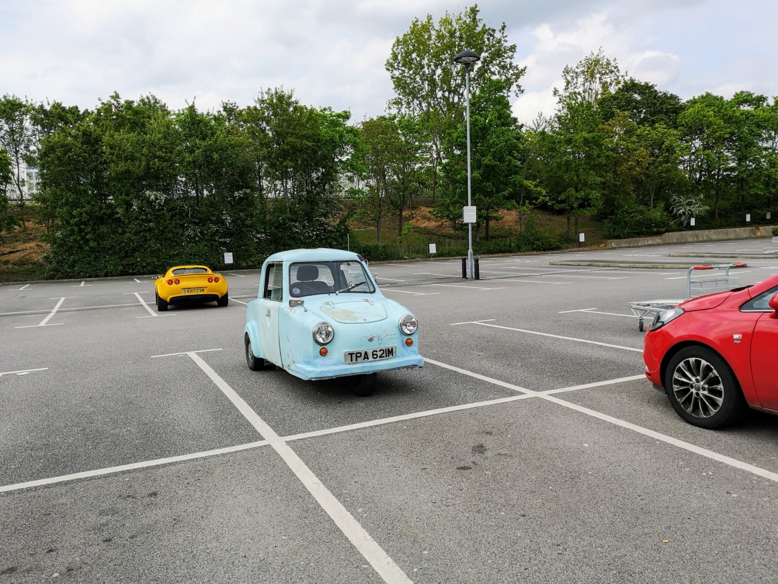

Today while I was pacing around waiting for the van to turn up I was able to get the Invacar put back together.
Plus I was then able to get out for a test run to get a couple of errands run.
The main issues which had been making TP quite unpleasant to drive were threefold:
1. Severe judder when taking up drive.
2. "Slipping" of the drive at speeds over 45mph or so.
3. Low frequency drone and vibration at speed (not unlike a duff wheel bearing but a couple of octaves lower frequency).
[YouTube]ixCHdSoluLA[/YouTube]
Apologies for the horrible camera shake. I didn't have my decent camera handy, and the phone holder works fine for being a sat nav display...not so much for recording video...hence the jiggling.
Given I'd only done a relatively quick clean and thrown on a new old stock belt I wasn't expecting miracles.
Okay...I underestimated things!
The judder when taking up drive is almost gone. Still there to some extent, especially if you give it beans from a standstill. Not worrying about that though as it's apparently just something that the drive system does and isn't a fault. Just a limitation of the design.
Slipping has totally disappeared as far as I can tell. Have had her up to 60mph twice today and even cruised there for a couple of minutes. Behaved impeccably.
I can conclusively say that this was the cause of the "rumble" at speed. It's now gone...even up at the legal limit...whereas she tended to start shaking herself to pieces as soon as you saw the speedo needle move over 40mph or so.
I'm a happy camper. If this is an indication of what I can expect once everything is sorted, she's definitely going to be getting used a lot more as time goes on. Aside from just being fun and different, the drive out today was actually *nice* which was a big step forward.
Sad I'm away for the weekend so won't be able to drive her again until Monday now.

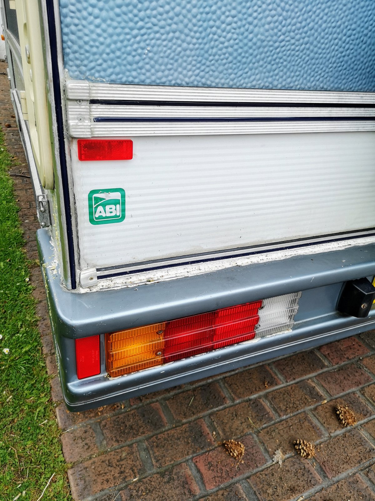

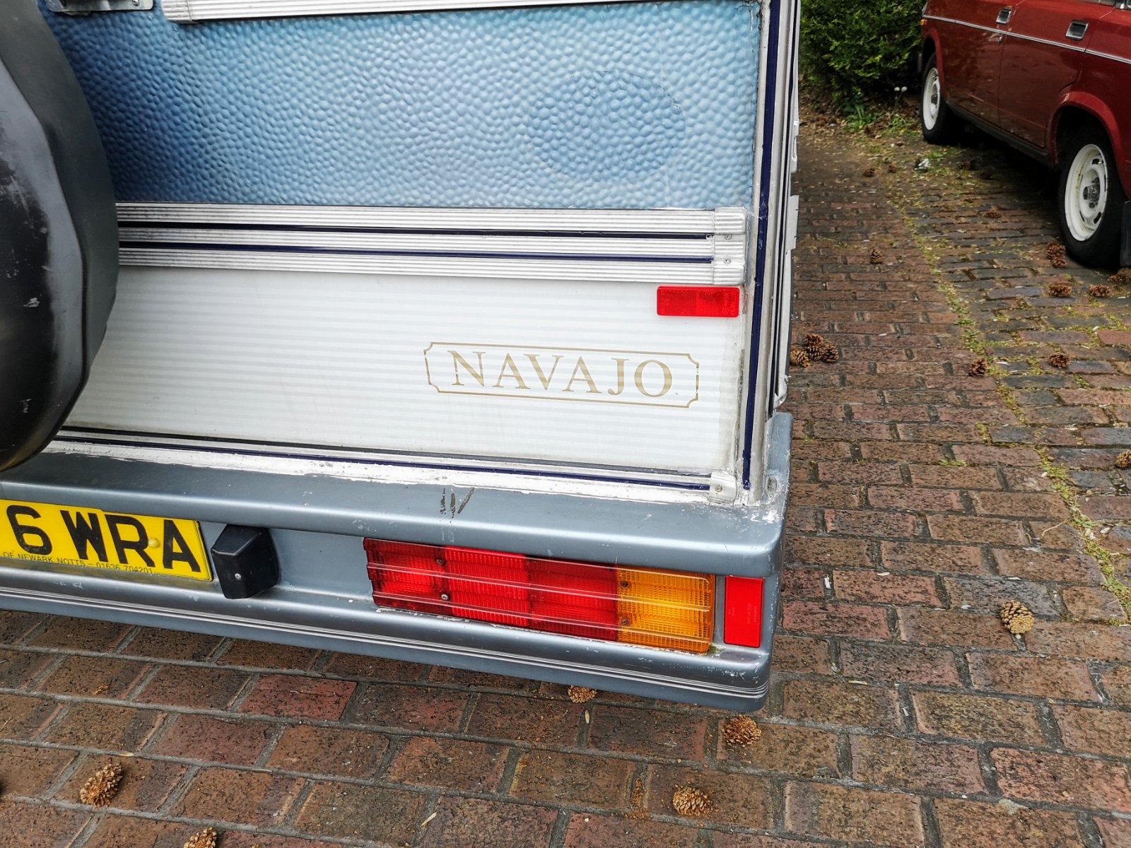

First up was the question mark over the "missing" rear reflectors. The tester at the time wasn't interested in entering into discussion. So I stuck a couple of additional ones on at near enough driver eye level.
The tester totally failed to notice these...and went and stuck an additional two on the back of the van down next to the tail lights. It looks like the thing has been attacked by a 90 year old who's raided the caravan aisle in Halfords.
Not impressed. Especially as they're not even fitted straight.

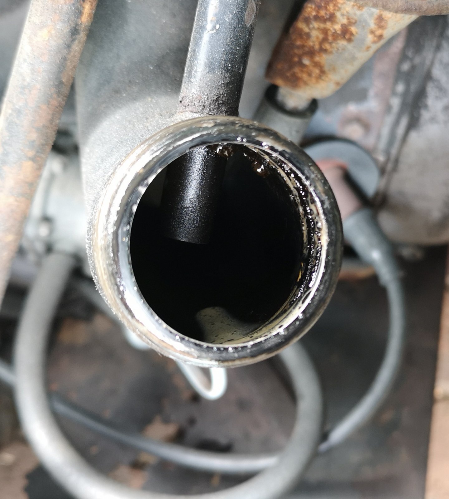

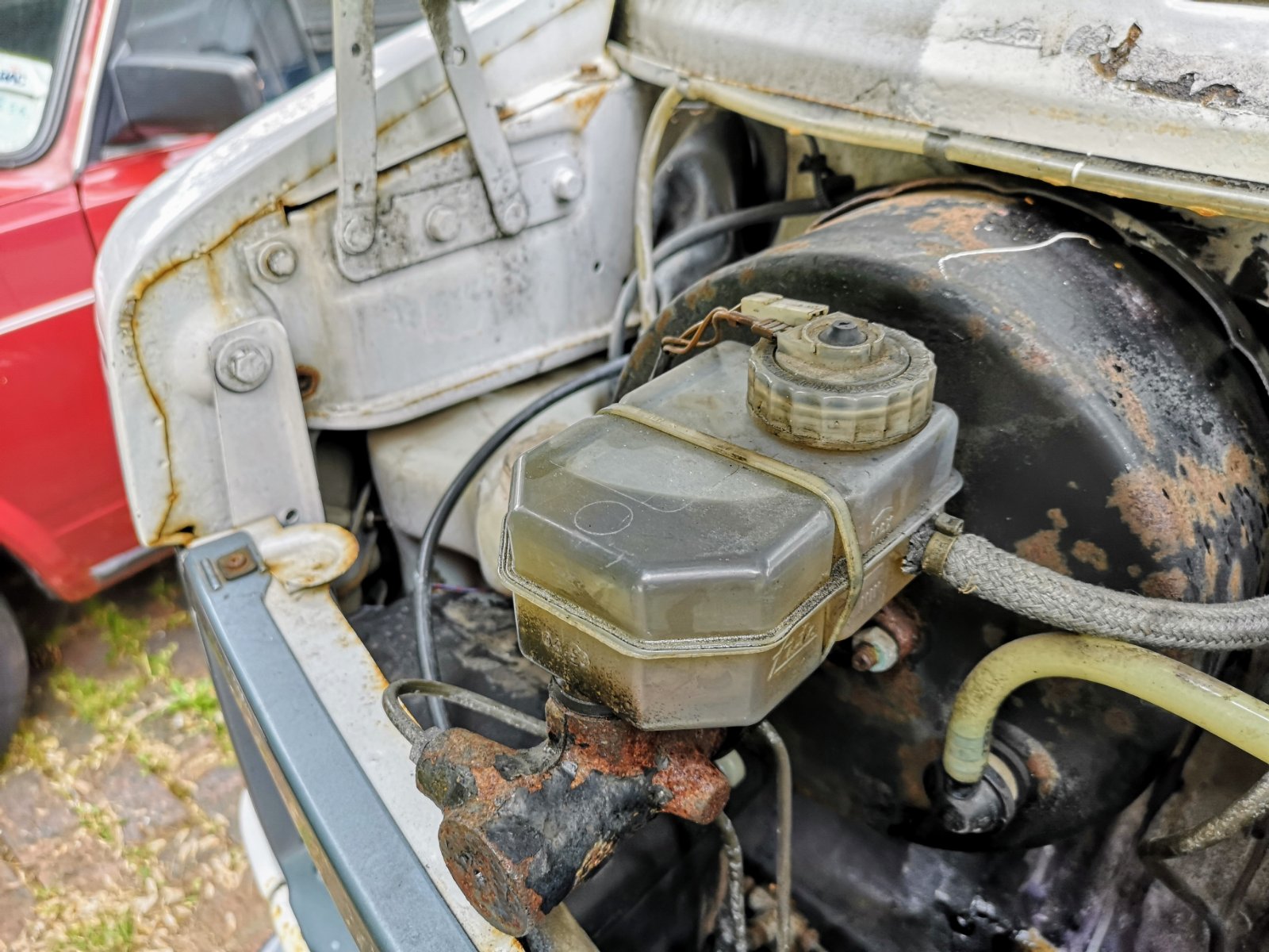

Picking the van up, in addition to the obvious complaint about the hideous reflectors, two wheel trims weren't properly attached and the bodywork has a not insignificant number of greasy hand prints on it. Not a deal breaker...and I'd not blink at it from a little local garage I'd paid £100 to do a job...but this is a big concern who have just charged £300 odd of labour...sorry but I'd expect them to have spent five minutes wiping things down before calling it done.
Oh...speaking of details I'd expect them to get right (especially given their PCV/HGV background) would be this.
This isn't overfilled. This is overflowing. I am not impressed.

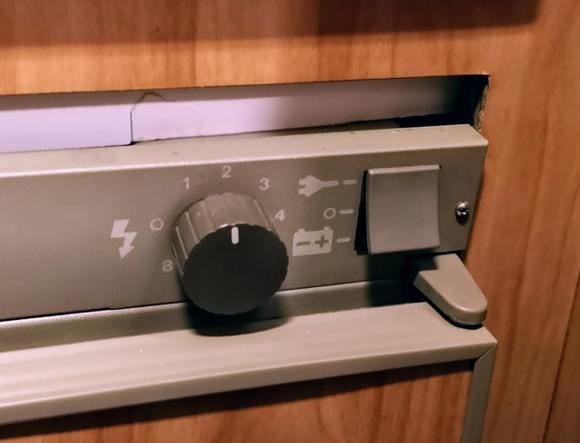

We had originally planned to be heading out today even though the event doesn't really start off until tomorrow afternoon. However we did a bit of math and figured that by the time we had done everything we needed to here we would be arriving there after dark. There's no guarantee of lighting at the camp ground as we're essentially just parked up in a field next door to a camp ground, so we decided to just head out tomorrow early on. All it means is that the charity have made an extra £20 or something from us so no big issue. Did leave me time to get a few more things done though.

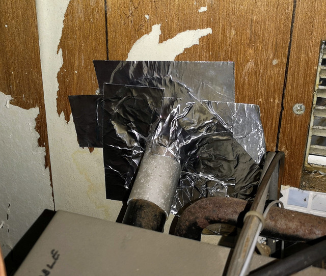

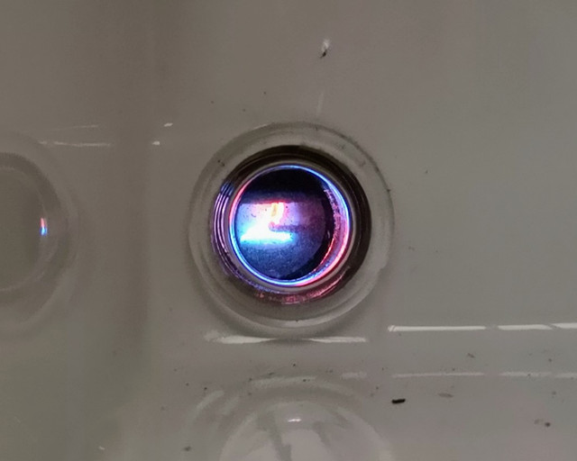

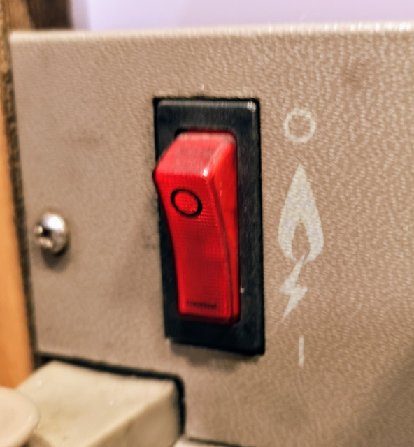

First issue was the non-functional fridge on gas. I hadn't ever tested this before (nor connected a gas supply to it to allow me to). The fridge is an Electrolux RM 212, which means that the gas side of things is the only complex thing about it as it has automatic electronic ignition. So instead of the normal clicky ignitor button you have a switch.
In theory, when this is on it will automatically sit there ticking away whenever there is no flame detected (with a little red light in the switch blinking so you can see it's trying). However mine wasn't doing anything when the switch was turned on. What is annoying here is that there is no manual ignitor nor any access to the burner which would allow me to light it the old fashioned way. Equally annoying is that most of the wiring diagrams for this fridge I've found are for the older version which lacks the electronic ignitor...
After a not insignificant amount of swearing and headscratching I worked out that we had a multiple offender on our hands. The wiring to the ignitor was totally wrong *and* the switch contacts were dirty. The best decision I made at this point was to just rip all the wiring out and redo it from scratch. Which took five minutes. That done we had it cheerfully going "tickticktickticktick..." when turned on. Adding gas to the equation...
Much better. I gave the flame failure detection system a good workout to make sure it behaved and it did.
Knowing the gas system worked I made a point of actually securing the flue and sealing the joint to the body...much aluminium tape was involved to cover the good inch or so gap I made between it and the surrounding woodwork. The flue doesn't actually get massively hot, but I'd rather keep good distance between plywood and hot stuff.

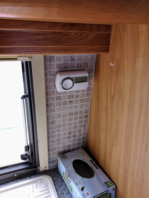

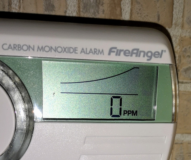

Of course with gas onboard a new bit of equipment needed to be installed.
I like these CO alarms as they give a useful indication of any low background level which wouldn't actually trigger any alarms.
I let the fridge running for a couple of hours while I was doing other work...
So everything I needed was finally working. Oh...and I stopped the exhaust rattling by smacking the front most bracket with a hammer.

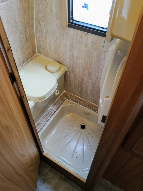

Empty and prep the toilet for use. It had been left with a cleaning solution in...seems to have done a good job, no smell whatsoever and looked pretty clean in there. The treatment agents for these toilets seem a lot better than when I first used one twenty years or so back it has to be said.

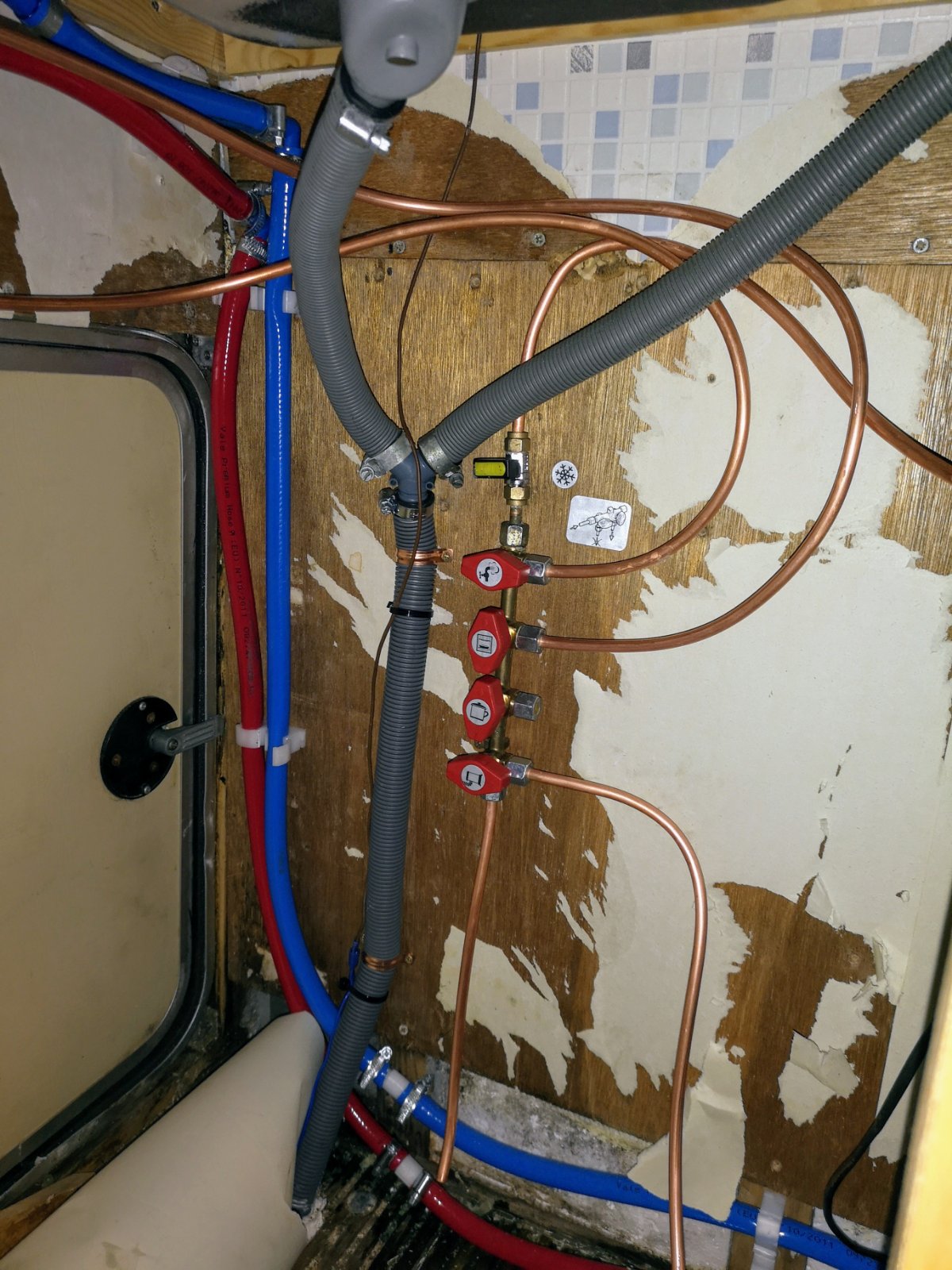

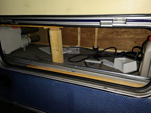

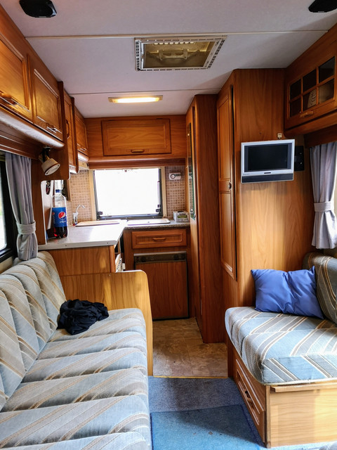

Just needed to get all the junk out of the van and clean stuff up.
All the non-van related stuff chucked out the luggage locker...

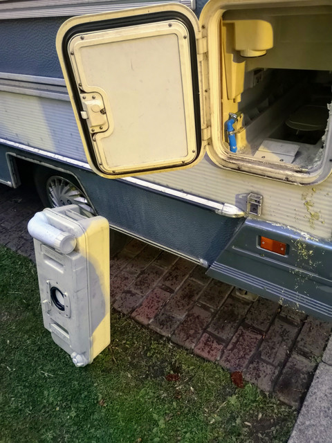

Stick the fridge on mains mode so it can cool down overnight before we load it up for the trip in the morning.

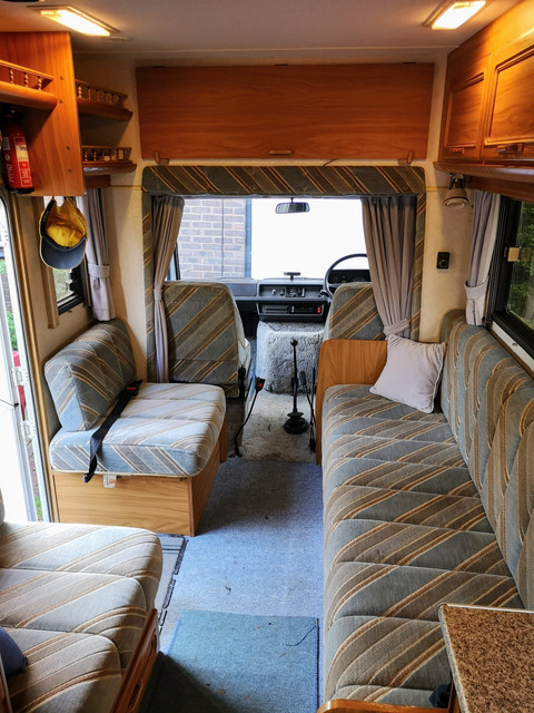

Gave the cabin and cockpit a clean up - the bit I always enjoy.
Cockpit scrubs up well.
So that's it... tomorrow we will be off as of 11 or so hopefully.

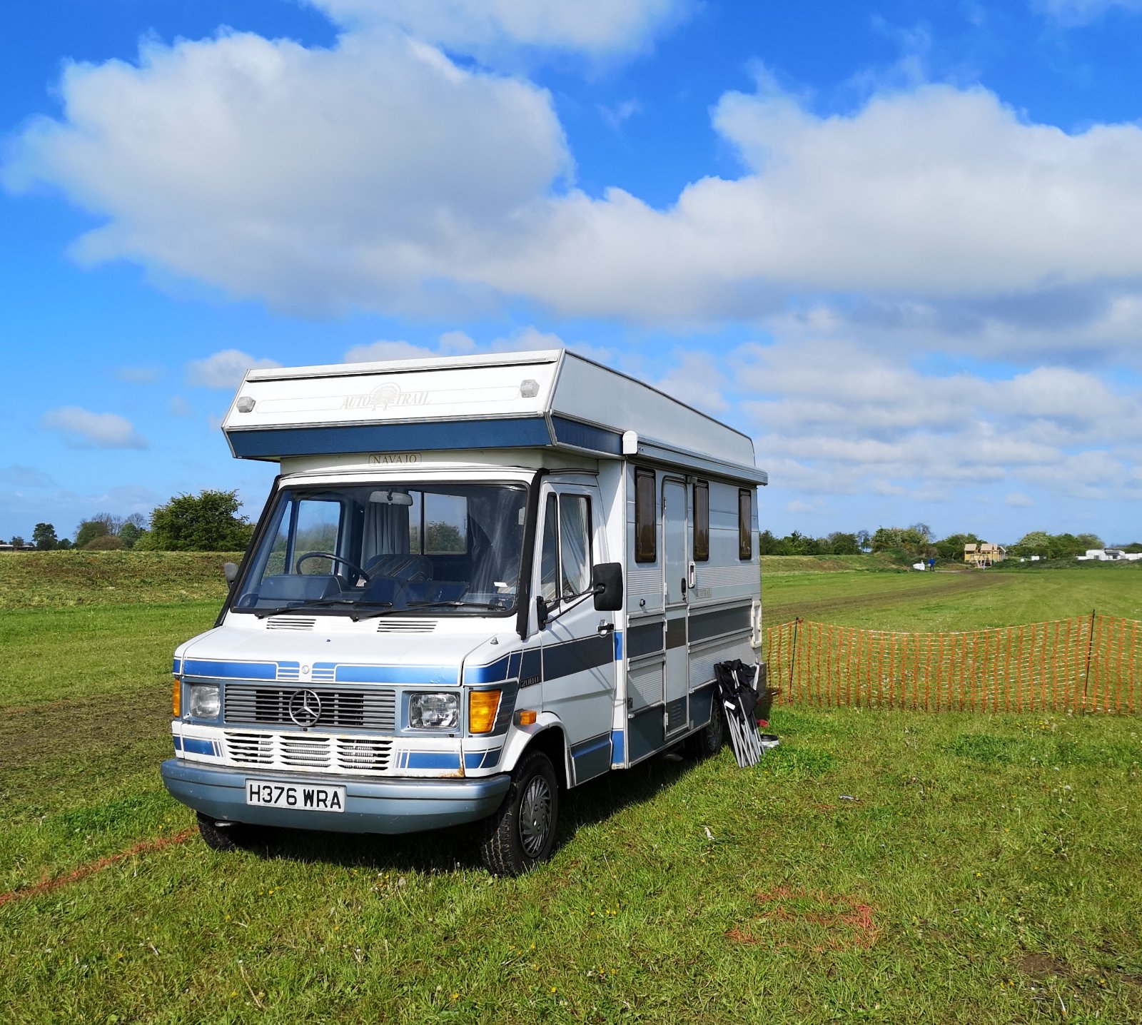

We have made it here in one piece.
Can categorically say having now had 150 miles to test the theory that the new exhaust has vastly improved the ability to make progress on the motorway. Even if it does leave us with a soundtrack which isn't dissimilar to a WWI era aircraft at times... Mercifully it's actually not that loud once you're up to speed or that could have become wearing rapidly. At 60 though it's totally drowned out by the rest of the mechanical racket and wind noise.
Given we're at a camping event I'm not hugely surprised that I don't have the oldest vehicle here. What did surprise me though is that it's not a VW that is (no classic ones here at all actually).

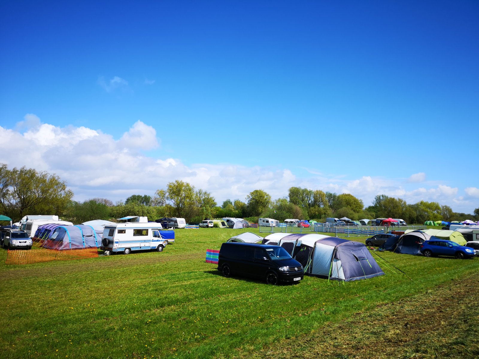

Have a snap of two from earlier today when we've had (sporadic) actual sunshine.
It is actually something of a trick. Yes it's sunny, but there's still a bitterly cold 40mph wind! So quite a bit of hiding inside is still happening.

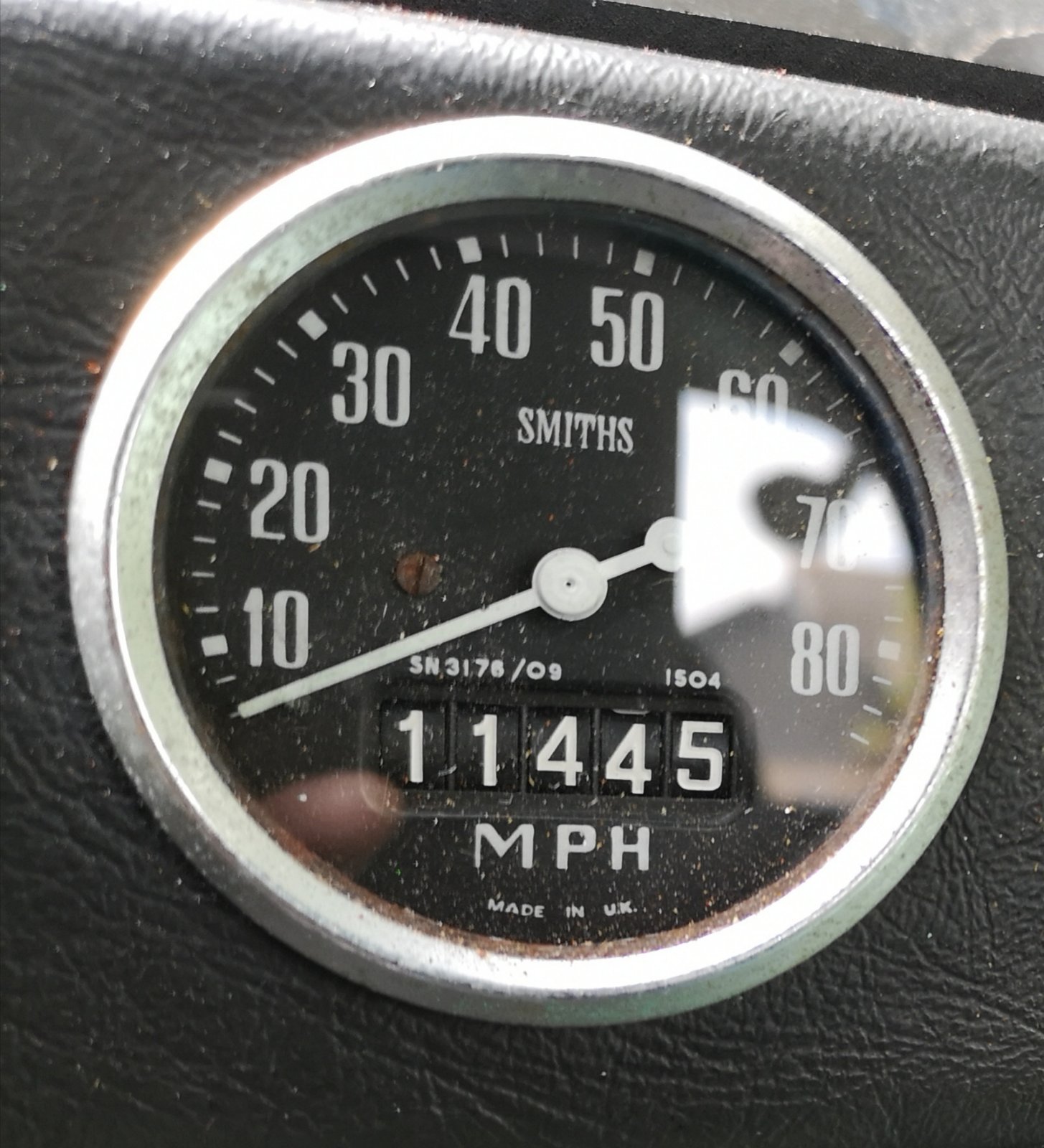

Couldn't resist??? getting the Invacar out for another run today. Previous to this the furthest I got in one day was 9 miles (having aimed for ten but miscounted).
That?'s 17 miles today in one afternoon. Doesn't sound like much, but it's progress and is a step towards actually going somewhere beyond this corner of Milton Keynes. Most importantly today that was seventeen miles WITHOUT anything misbehaving or falling off. That is why it's progress. ?
Because it seems to have become a thing now what I take photos everywhere she goes, did the same today.
B&Q was the first s?top (looking for some sticky back plastic to tidy up some of the cabinet facing in the van).
This? was? the first time that I had a proper crowd of people turn up while I was in the store who wanted to know what it was and the story behind it was. One of the folks there did remember them who? was very surprised at the complexity of the car beneath the very 50s looking bodywork. ??
?As they didn't have what I needed, wound up at Homebase (who did have it once I'd walked round the whole store five times looking for it). Bonus Lotus i?n the car park?. ?
Next stop???? was Morrison's - though the photo from there for reasons best known to the gods of tech has vanished into the void. So you will just have to trust me.
The difference in the drive system is night and day compared to before I started cleaning the pulleys up, she is now quite happy to cruise at 50mph. 60 is definitely on the cards but she's obviously more ?comfortable at 50. I do have a video of this (with a better camera than the last one), however so far it's being stubborn - once I kick YouTube into behaving I'll get it added here. ?
It is noticeable that the judder when pulling off has become more noticeable today, though it wouldn't s?urprise me if the belt tension needed a tweak now she's done a few miles.
I may well get the secondary pulley back off tomorrow and finish cleaning it - I'm hoping the drill will be able to spin it fast enough to get the pulley sheaves to open up as that will make it a lot easier. ??We'll see I guess...
?One thing which is really obvious now looking far better is the state of the PCV system. There was a lot of mayo in the oil filler o?riginally, but after the run out today that's looking *far* better. ?
That?'s more li?ke it.?

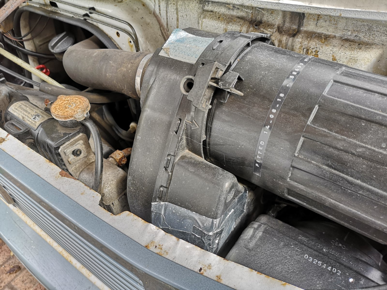

The question of "which sticks better?" between duct tape and self adhesive aluminium foil tape has been answered. The original patch I ?stuck on the air intake resonator on the van was duct tape, it was blown off in a matter of minutes. The ally foil tape repa?ir is still there and still quiet 240 miles later. It's hard to believe how much quieter fixing this 1/2" or so diameter hole makes life in the cab! ?
It will? do for now??????, at least until I find a replacement air box.

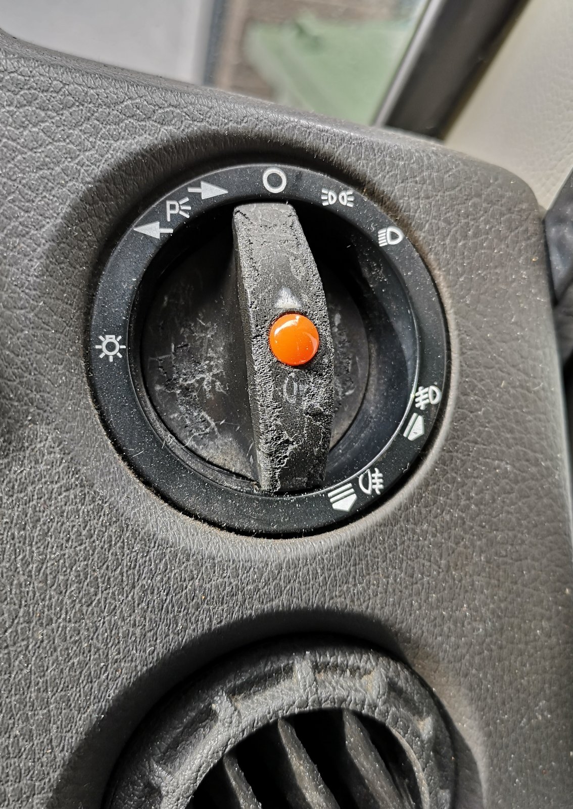

Speaking of tidying stuff up...a?nyone got one of these light switches (or even just the knob) floating around? While this one wo?rks fine it looks like somebody has used the knob as a chew toy and it really bugs me. ?
So far the dealer???? and eBay have turned up blank. The latter though doesn't mean much given that pretty much the entire search result list is "promoted" content which appear to have absolutely nothing to do with my se?arch string... ??
Have pulled???? the secondary pulley back off TPA ready for proper cleaning before being met with a slight impass because I'm stupid.
It's clear from the deposition of belt material on the service hatch that it's the secondary pulley that is responsible for shredding it exactly as I expected.
What I had?? failed to take into account is that the bolt screws into a shaft which passes most of the way through the pull?ey...not straight into something level with the back. So I need to get some threaded rod to make what will essentially be a? really long bolt to attach the pulley to my drill which will be essentially taking the place of a lathe. Will get that done tomorrow and hopefully get everything back tog?ether for ano?ther t?es?t.
Felt like a right idiot when I realised the bolt was a good couple of inches too short to just bolt it onto the drill!
