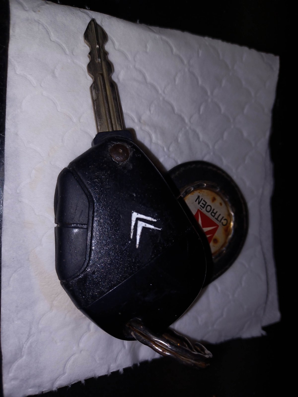

mickthemaverick wrote: 16 Dec 2024, 17:44 Well done Alasdair, nothing like a result from a bit of part scavengeing!! :-D
With a 3-6ft "range" I find it all rather pointless really :)

Is that with a fresh battery in Alasdair? Mine went down to only working straight through the driver's door window a couple of weeks ago so I changed the battery and now it works from my seat in the lounge!! :-D

Being an infrared device, it is pretty much limited to line of sight...
Although I did once repair a Grundig TV (about 1975 vintage) which had a very powerful IR remote that would reflect off any shiny surfaces and I could change channels from 3 rooms away!

mickthemaverick wrote: 16 Dec 2024, 18:45 Is that with a fresh battery in Alasdair? Mine went down to only working straight through the driver's door window a couple of weeks ago so I changed the battery and now it works from my seat in the lounge!! :-D
That maybe the problem....I will get some tomorrow and try that.

After you swap the PLIP batteries Alasdair, have a look at the IR Receiver up in roof - it lives adjacent to the sunroof motor. Unclip the cover and give the little black dome a clean inside and out - it's likely to be covered in dust by now and that can affect range. Also, give the IR Receiver LED a gentle clean.
LEDs do suffer small reductions in light output as they age and given the ages of yours, I think they can be cut a little slack. That the IR remote system is working at all is a major achievement :D

New batteries, it gave me about 2ft extra .... so still utterly pointless so why bother locking it , nobody is going to steal an old shed anyway :) :)
At least the rubber "buttons" are not sticky any more.

Screen wash (-10 Halfords) in an Ultrasonic....it was "human grease"

IF the rubber is breaking down there is not a lot you can do....I think a good scrub with a soft tooth bush and some hand soap/swafega (Red-with NO water) would be the way to maybe address that
