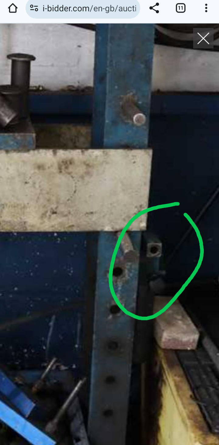

1 very heavy. Is a floor mounted job so guess about 5 foot tall or so, chunky steel. Would have to lay it flat in my big trailer (which would leave that gauge vulnerable, which would need to be removed, which would leave a rout for the oil to exit, which would need a solution. Hmmm)
2 good point, my garage is already full!
3 manually powered - pump just about visible here:
4 date stamp 1989, never exploded since then! I worry less about hydraulic stuff Vs pneumatic as the energy dissipates very quickly (as the oil is effectively incompressible) is the compressed air stuff that's more exploding worries! :-D

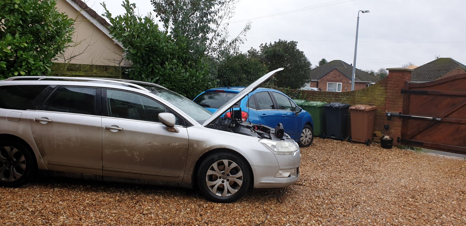

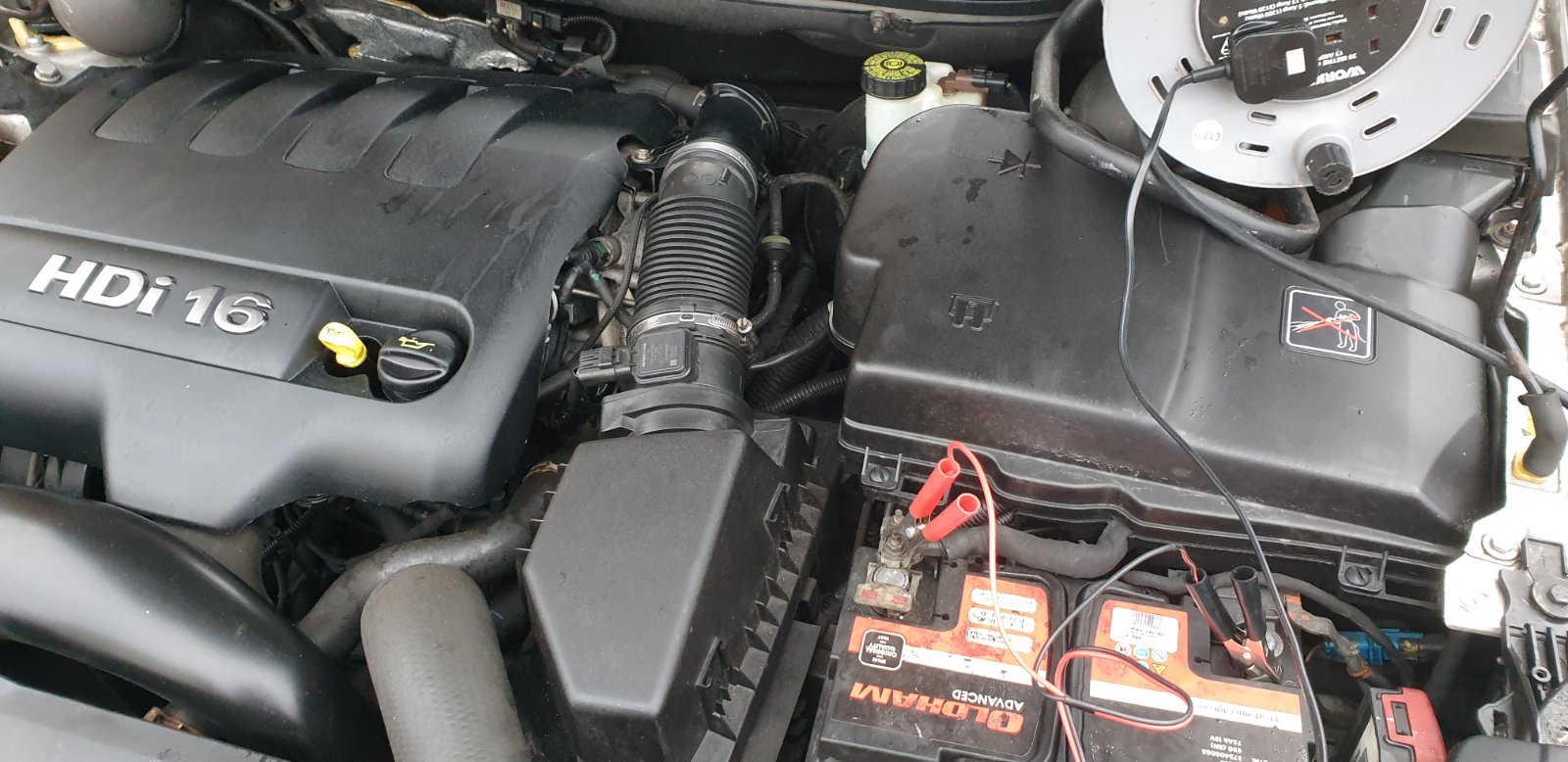

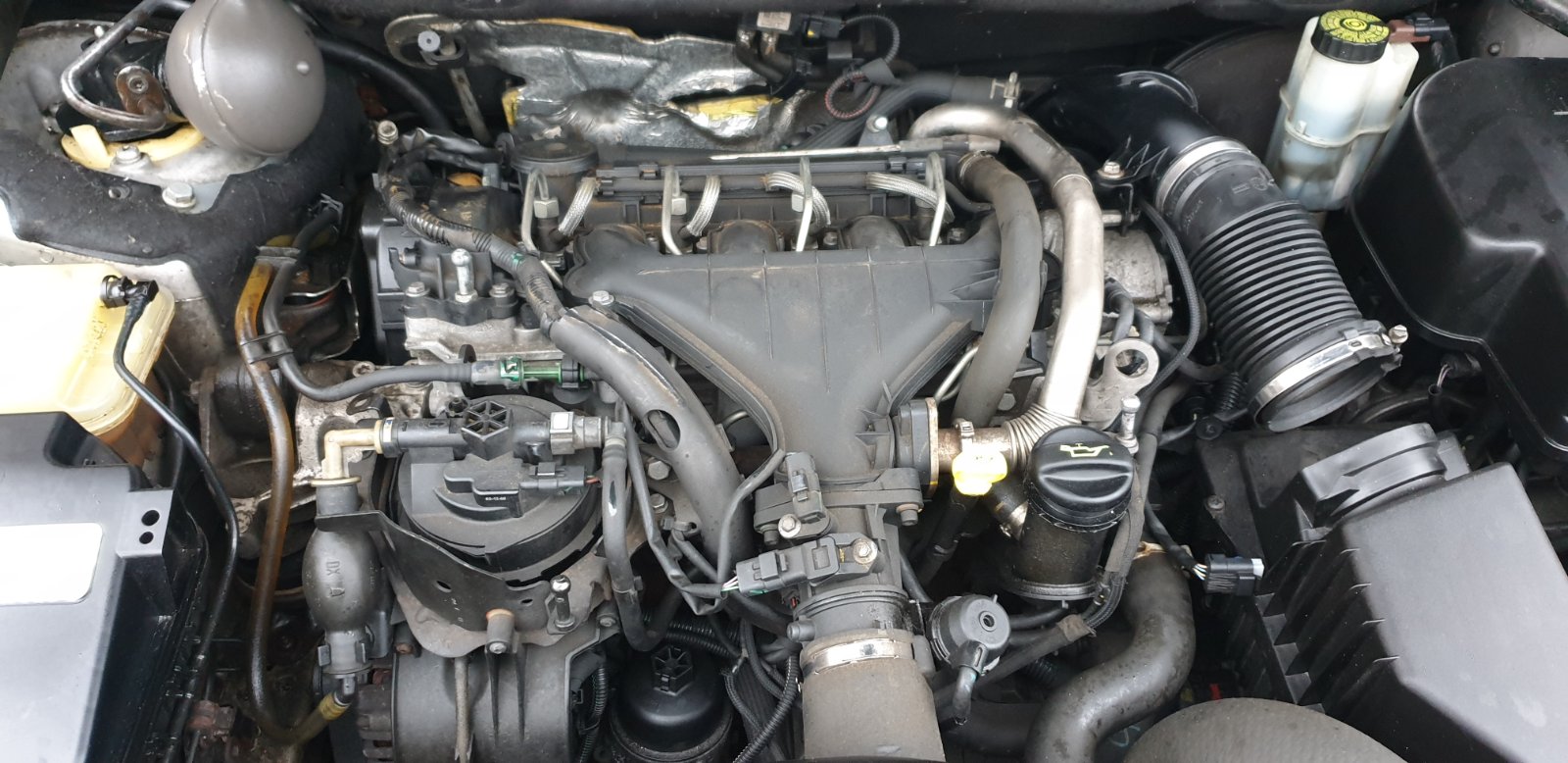

It was the 27th December before I got any time to look at the C5, which had been feeling sorry for itself all December, and had not turned a wheel.
The battery had gone flat over the course of a few weeks, so I had to charge it first...

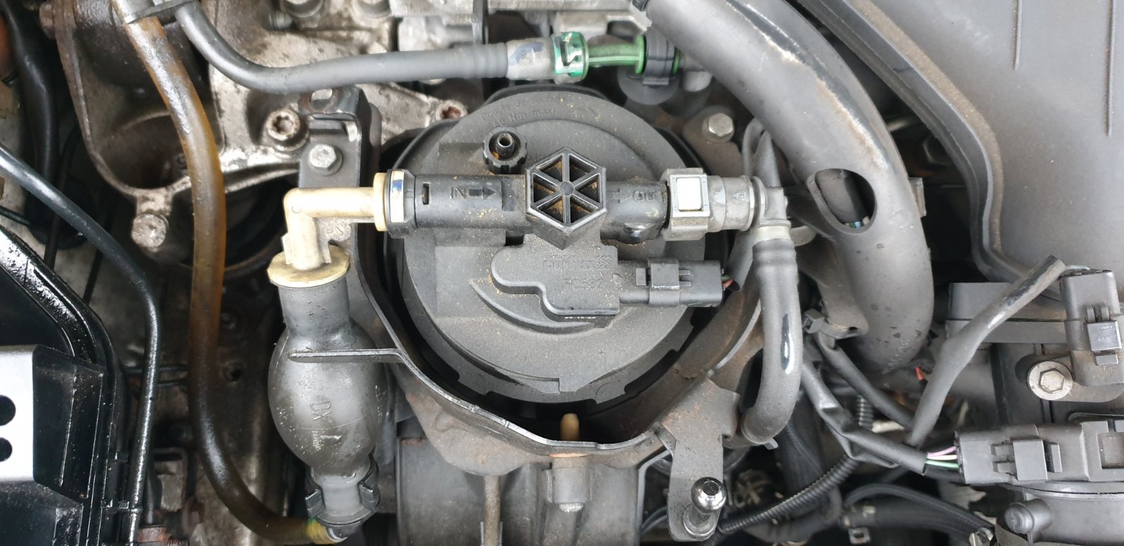

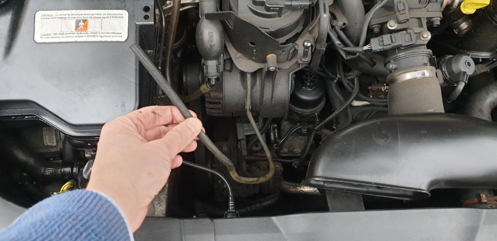

First order of the day was to replace that fuel filter. For those who do not know, its east to find... its this kiddy:
This video gave me a nice idea of what to do.
There is a nice drain pipe underneath, which I fed into a coke bottle, that I left down in the engine bay, sitting on the undertray.

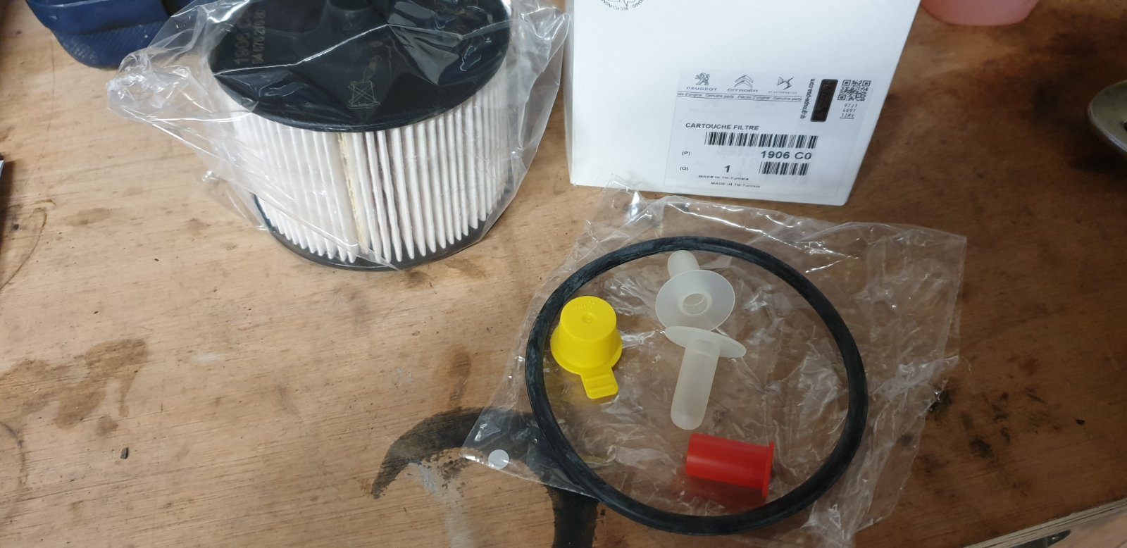

The new filter comes with accessories to cap off the pipes while you work.

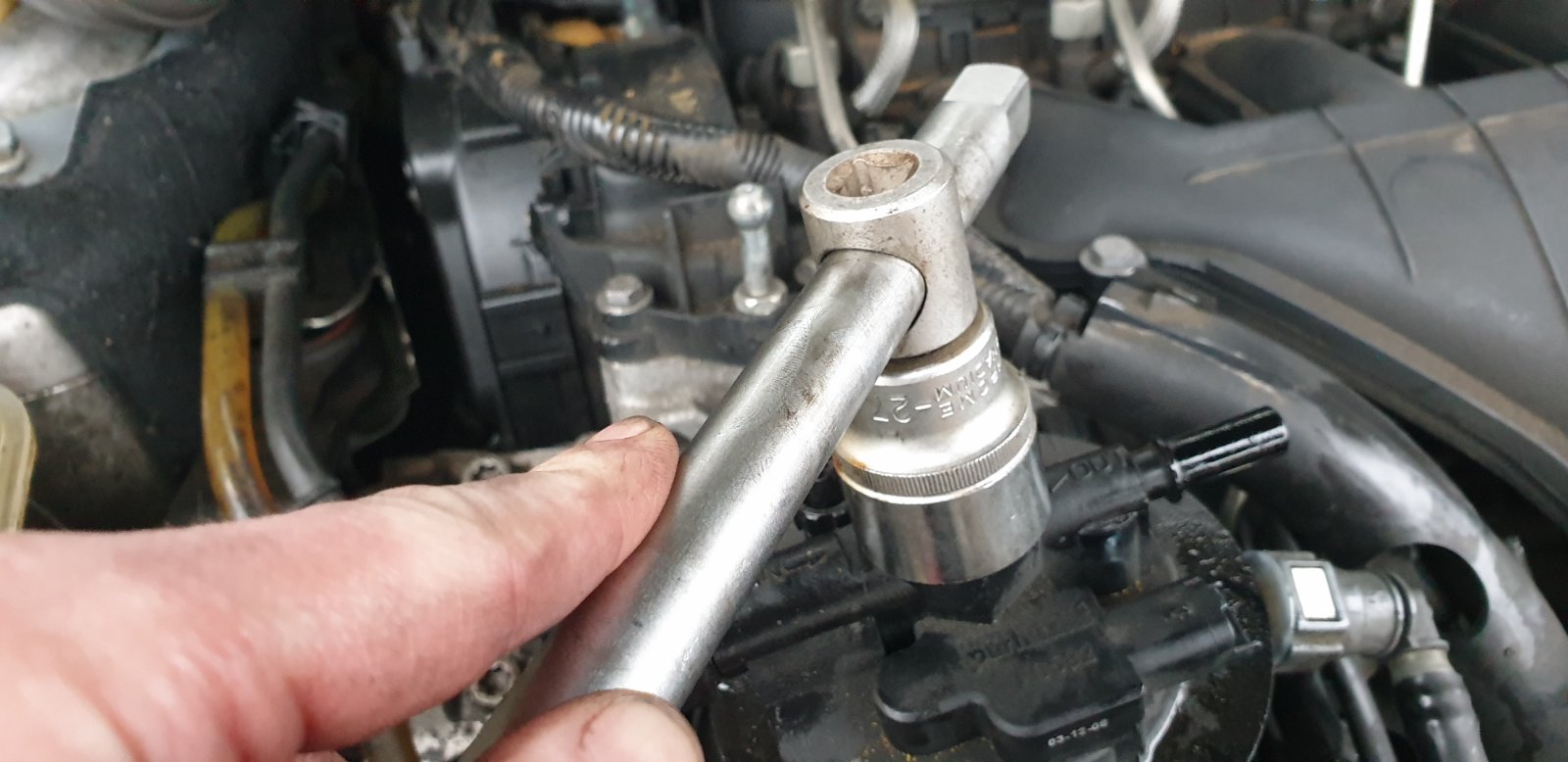

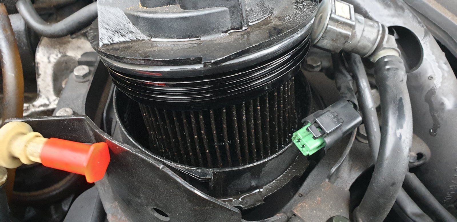

I drained the fuel out, then released the filter (27mm socket).
This is what the filter looked like.
I have no idea if this is bad or not......
But... I primed the filter, started the car, reset the codes, and gave the C5 a drive - problem solved!! The car no longer hesitates, it accelerates perfectly, and the engine management light stays off :-D
I cleaned the MAF sensor for good measure, but did not take any photos... :roll:

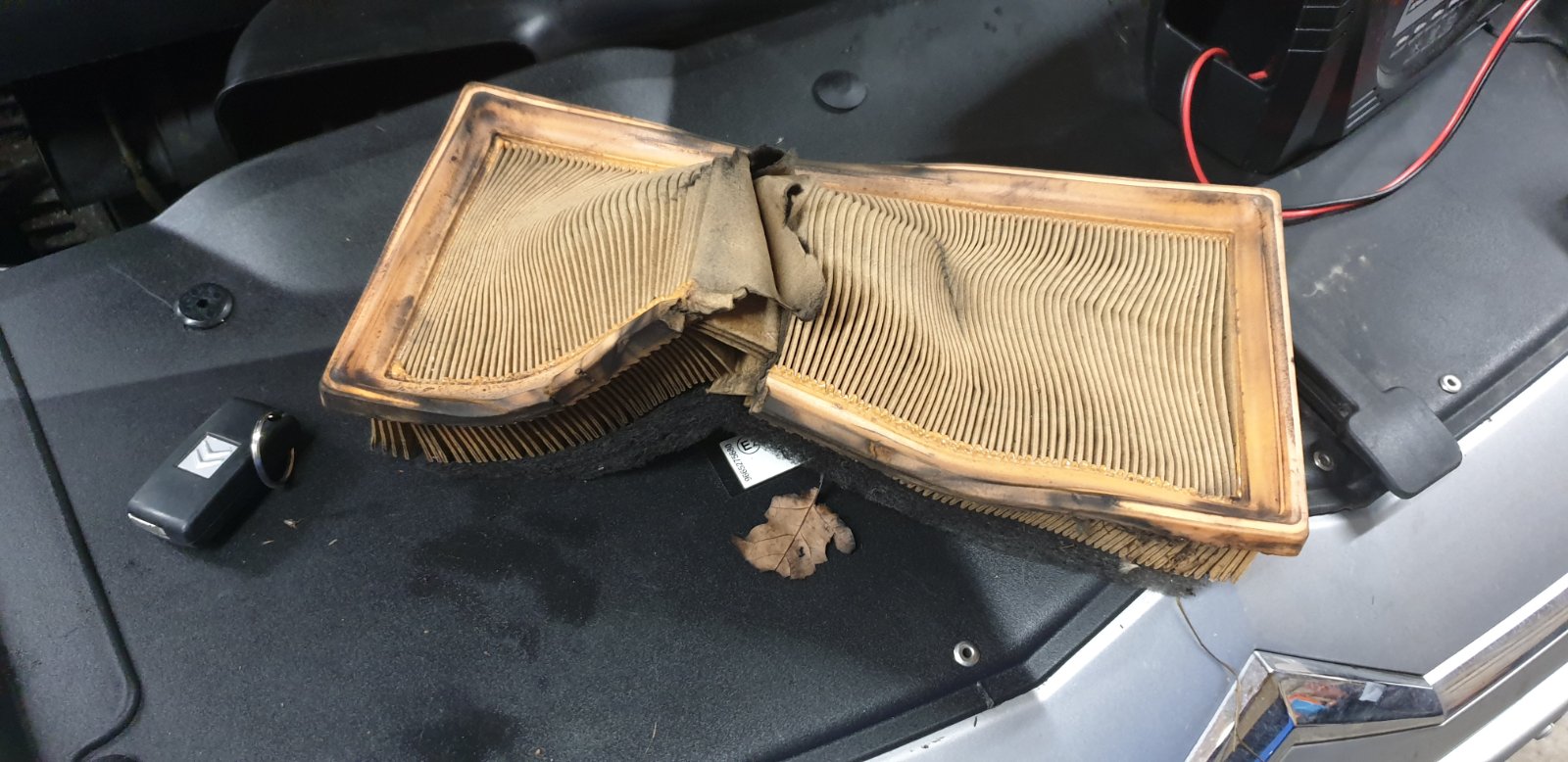

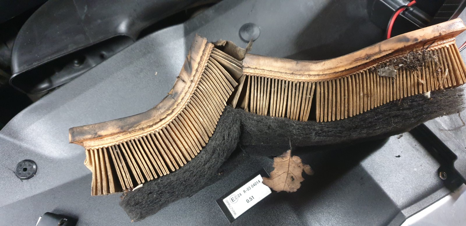

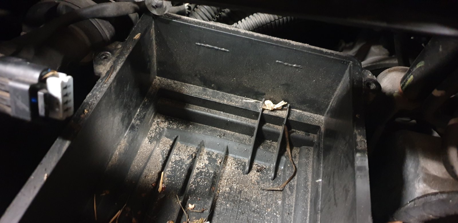

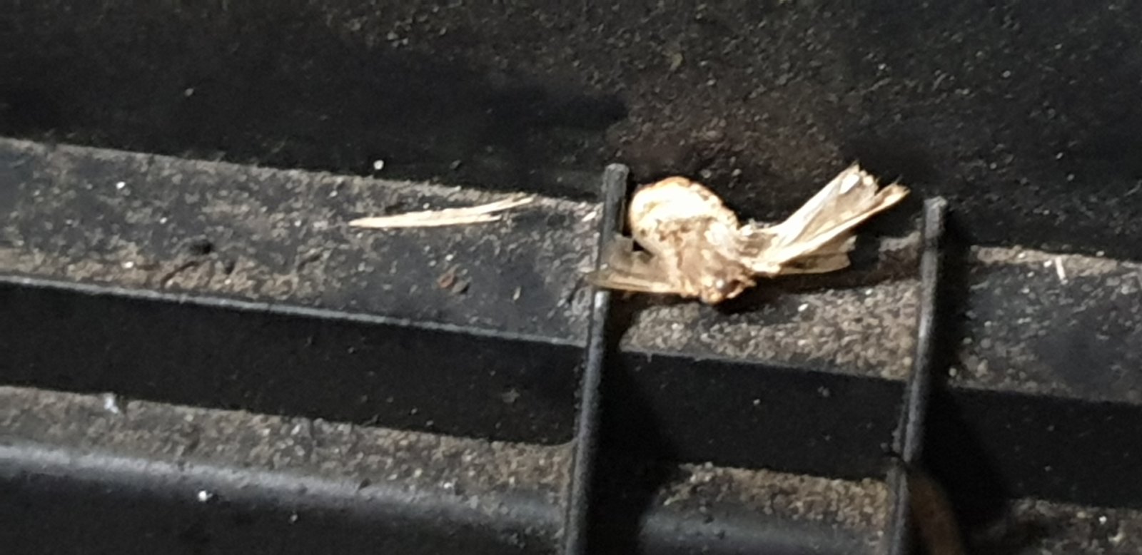

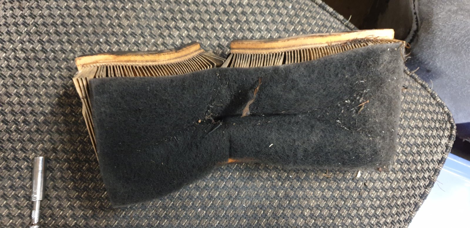

I decided to check the Air filter, as I had not done that yet, and was not sure if they changed it at the garage when the did my service and CAM belt... safe to say they didn't :shock:
There's probably a few thousand more miles of life in that filter... :lol: but I decided to change it anyway... I cleaned the filter housing thoroughly too, as I did not think all that dust, and the dead moth, would help the performance of the engine.

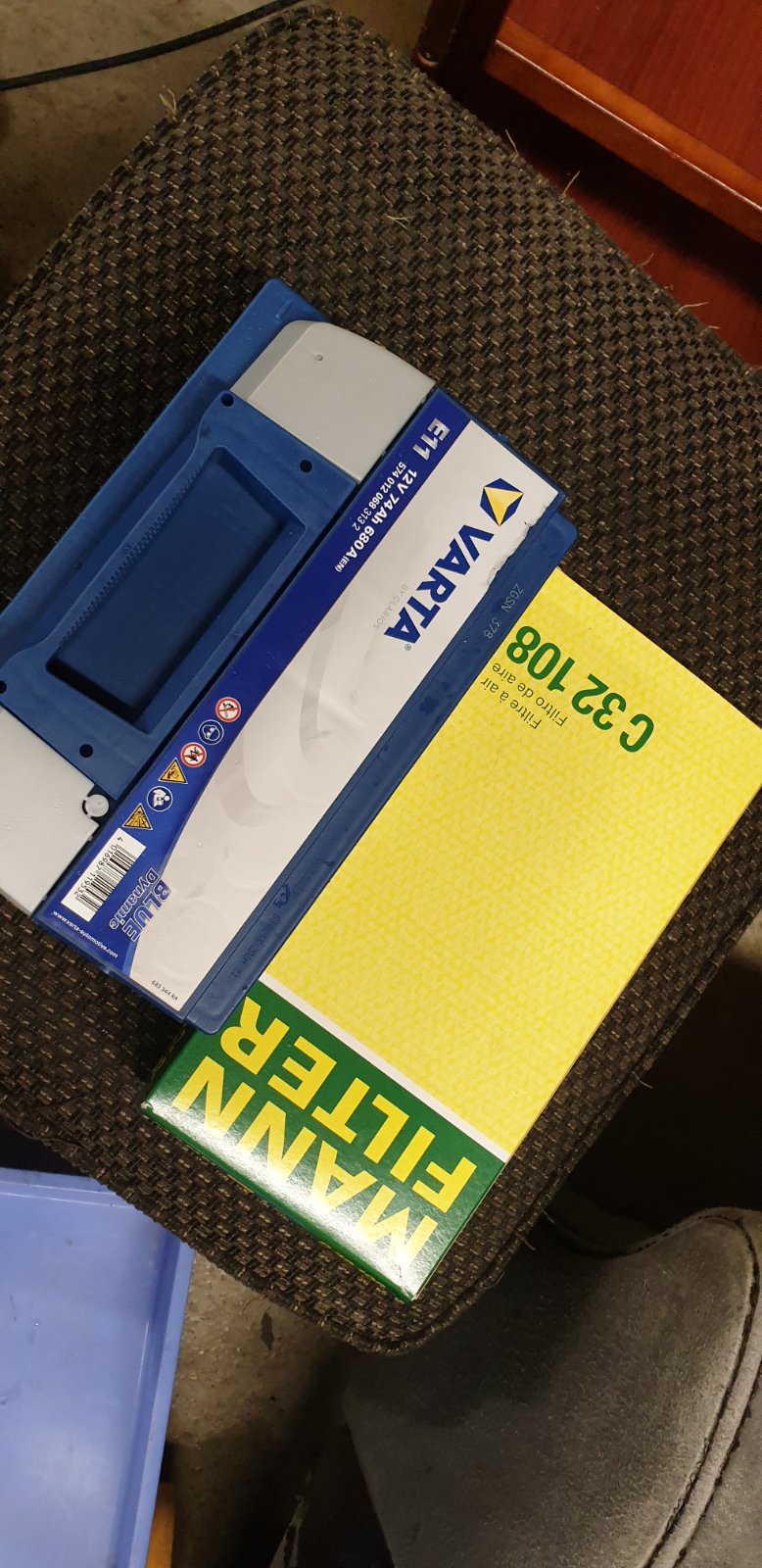

As the rather old looking battery had gone flat over December, I decided to treat the C5 to a spanking new one... :lol:
So that's a spanky new Air filter and battery replaced... and the C5 is running rather nicely.

Great to see you back Chris :D I fully appreciate the issue with photos. I have the same with photos taken at Junior parkrun. One method is to cover the child's face with a smiling emoji - other emojis are available to suit the mood the child might be in at the time ;)
Both those filters look very manky! Definitely ready to be changed...

Welcome back Chris, following similar lines to your smart shepherd, it turned out I'd I've raised a lovely Donkey :-D
Wow that air filter is awful! Did it drop to pieces on removal or do you think was falling apart in position? (Luck the turbo hasn't had chance to chew on lumps of it - though air flow meter often has a flue straightening grid that might save the day?)

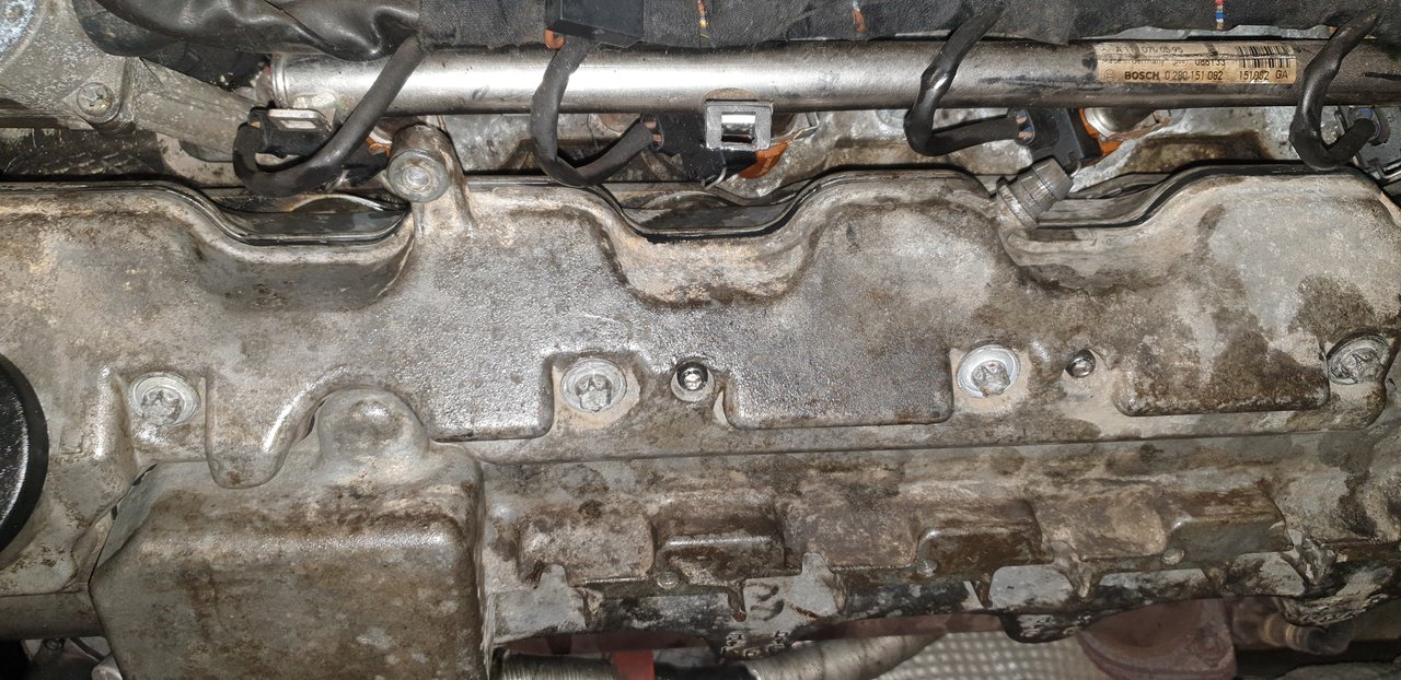

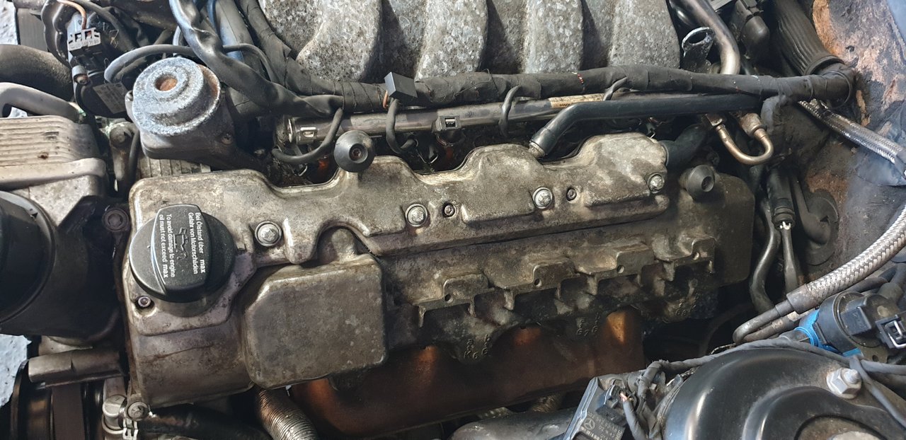

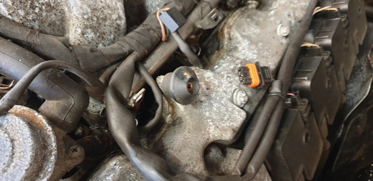

So with the suspension sorted (I think) I turned to the next bottle neck. When the car ran, there would be a burnt oil smell from the engine bay, and small puffs of smoke would rise either side of the engine.
This is a common fault on M112 and M113 Mercedes engines, and the likely cause is the valve cover gasket failing. Oil seeps out, and drips down to the exhaust manifold, then when the exhaust heats up it burns the oil.

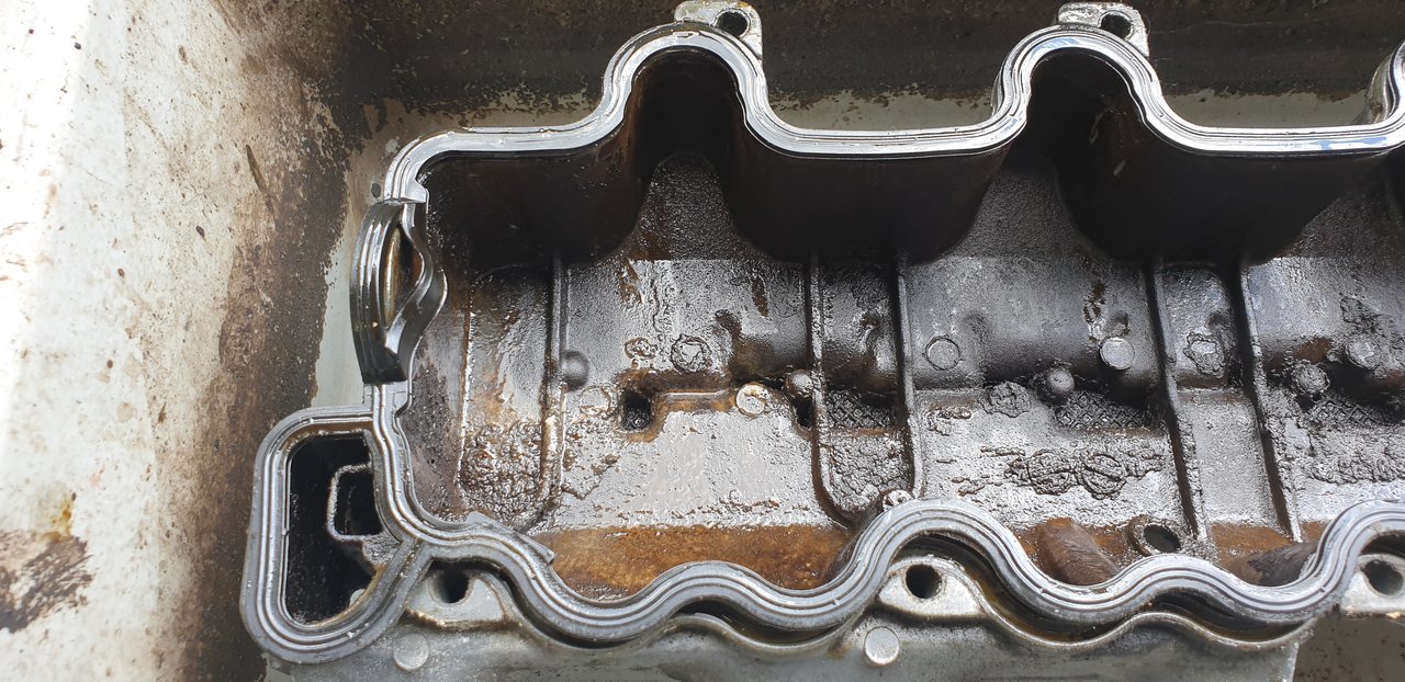

I have watched a tonne of Youtube videos on changing these gaskets, and last Saturday was my time to do mine! I have never opened up an engine before, but I was feeling adventurous, and why get a garage to do it and charge me hundreds maybe even over a thousand pounds, when I can do it for the price of a gasket and some minor materials... and a day or two of my time :lol:
First I removed the engine covers, and air box. I was shocked at how pitted and corroded the engine looks... :(
These bits are very pitted!
It certainly is a tired old engine...
I removed the coil packs...
The gently with a rubber hammer I loosened and removed the secondary valve cover.
Needs a clean for sure.
Then I removed the main valve cover.
I spent the rest of the day cleaning, and then a lot of yesterday too.
Then I cleaned both parts up with alcohol and a microfibre cloth.
I used Mercedes liquid gasket to refit the secondary cover to the main cover.
Then I put the gasket in place and refitted the main cover.
What a pain in the backside the gasket was, it was not the right shape and kept popping out. Next time I will go for a genuine Mercedes gasket hoping it's a better fit!
So that was one side ever so nearly done!

So now I turned to the air box. I have brand new air filters to fit, so I decided I could do that too.
Mucky airbox/cover...
A quick spruce up.
Then I removed the air filters, but to my surprise they look brand new! So I will keep my new ones aside and leave these ones in.
So that's a nice clean airbox, dressed in plastic restorer, and I put that aside for when I have finished the rest of the engine valve covers.

I never thought I'd get time to do the other side of the engine this weekend, but yesterday Lindsey and Spencer were both feeling tired and unmotivated, and so Aston and me went outside to get some stuff done. I cut the grass and did a bit of tidying, then I decided it was time to plough on with the Mercedes.
First cracked off the secondary valve cover by (gently) whacking it in every possible direction with the rubber hammer then dislodging carefully with help from a block of wood.
Then I noticed these two oil runs on the exhaust manifold, it seems pretty obvious where the oil leaks are :?
Then it was off with the main valve cover, and I was dismayed to see the whitened oil in a couple of places... I hope that's just condensation from the engine sitting for a couple of years... :shock:
So I'll have to keep an eye on that - I cleaned all this off, and I'll be doing an oil/filter change when the car is back up and running.
There is something really cool about the engine being open :cool: - or at least to me there is... it's perhaps because I never in a million years thought I'd ever have the confidence to do stuff like this. The internet really is a wonderful thing :-D
Thats both parts off, ready for cleaning. These covers from the drivers side were MUCH MUCH dirtier than the passenger side; I wonder if that's because the gasket was leaking?
Incidentally, I only clean one at a time, so make sure I do not crash the two pieces when washing - so the smaller part came straight back out of the tub after this photo.
