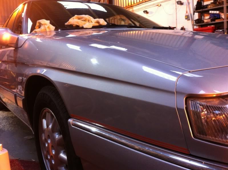

When I got my XM it had coach lines down it on both sides. A thin line at the top of the waistline and a thicker one along the doors just above the rub strip.
I've been told by a lot of people to remove them but I've always been a bit nervous about doing it as they have been on the car since it was 3 days old and I was worried about the paint having faded beneath them but tonight as I was walking past it I decided enough was enough...
I've taken them off on the front wing and given it a quick clean with Autoglym Super Resin polish which has removed most of the adhesive left behind but not quite all of it. I'm gonna try it gently with some white spirit or petrol tomorrow and then polish it once I've got them off I think.
Anyway, here's a before and after shot... Poor light and a iPhone camera don't help unfortunately...
Before: (Whilst wearing Malaysian number plates)
After:
Looks better I think, am sure most will agree.
After:
David.

Definitely better without.

That looks better David , when's the other stripe coming off ?

Hopefully tomorrow!
There was a little glue residue left on the paintwork so wanted to figure out what best to get it all off before starting on the other one.
Apparently petrol or white spirit are good options. Chris has told me he has used white spirit without any ill effects so the others can come off now I know how I'm going to get rid of the marks.

Yes, definitely better without David...
