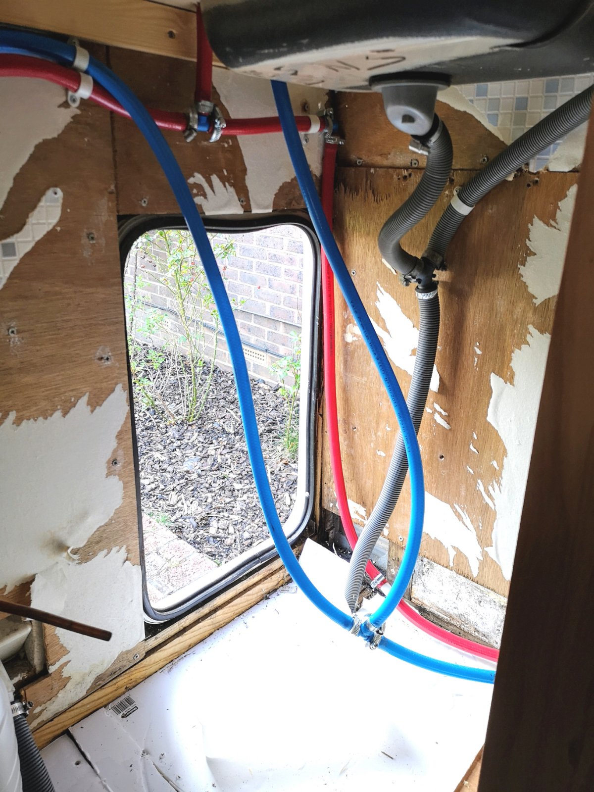

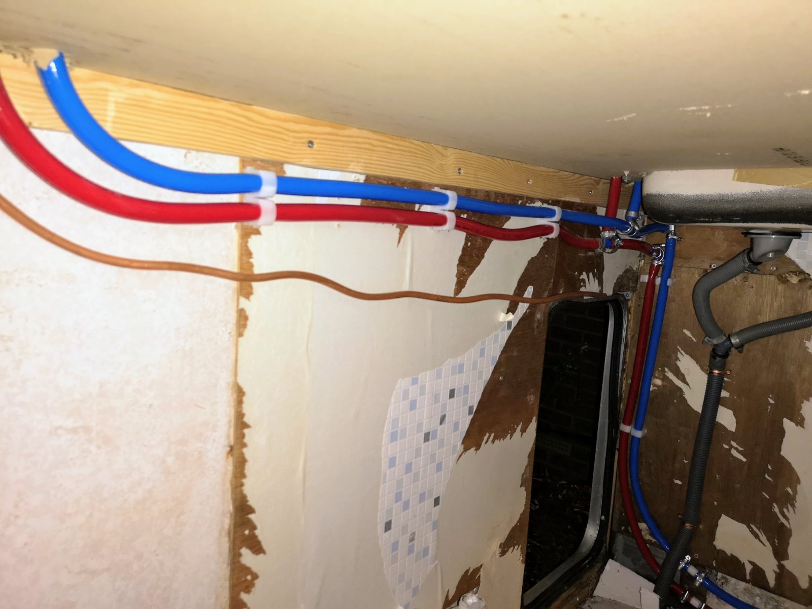

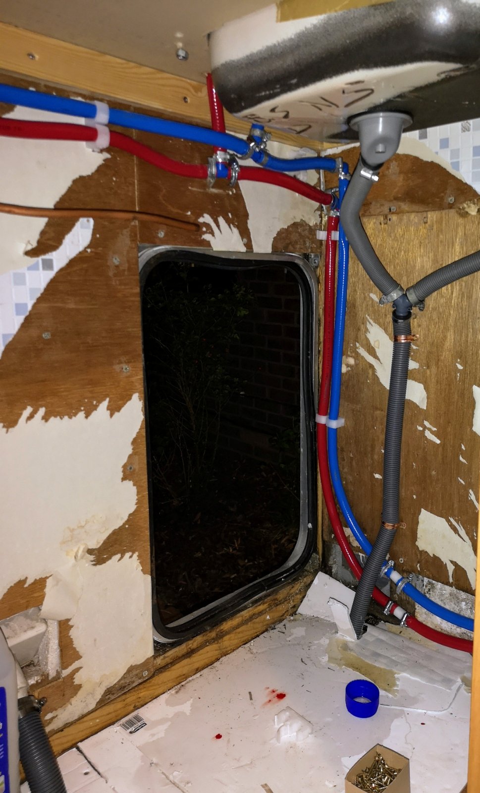

Currently working on sorting the kitchen plumbing out.
It's worth remembering that when Abby and I took this thing to Scarborough that I was up pretty much into the wee hours of the morning we set out to get the services working. So the pipework connected all the relevant points to each other - but the routing was basically just where stuff landed and nothing was trimmed to size. Just to make my life easier I had managed to end up with no less than three pipes wanting to occupy exactly the same space as the gas cylinder too.
Now it's time to sort things out properly. The hot water line here has been trimmed and loosely routed where it's meant to go. The cold shows how randomly they were just thrown in before!
The pipe clips I've picked up today can clip onto each other, so it will be possible to get them routed nice and neatly alongside each other.
I'm going to totally pull apart the sink and draining board waste line and remake it - want the Y piece right on the wall to keep it out the way. That's a bit of the original pipework that was reused, but I've got a load of convolute in stock so can make it fit properly...
Once that's done I can get the gas lines routed too. Wanted to do the water first as those pipes are more bulky and awkward so was obviously going to set the route.
The gas locker is going to have a lot of connections in - so I'm going to run all the lines to it, leak test everything *then* build the sealed box round it...as doing the fiddly bits will be far easier when I've got good access from three sides rather than trying to work in a tiny dark box.

Had been hoping to get most of a day to mess around with car stuff today...however it was gone six in the evening before that actually happened.
So not a massive amount done, but the pipework tidying from yesterday has continued.

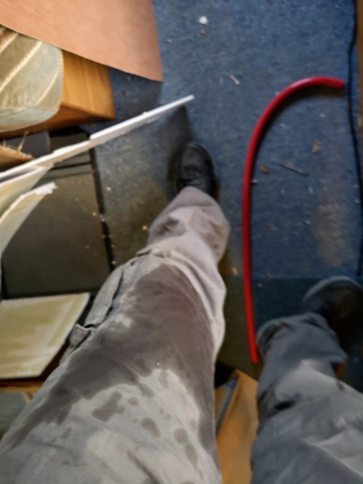

I did quite early on do my first idiotic thing of the day when an went to remove the first bit of piping to trim it. I made absolutely sure that the water pump was switched off...I didn't however turn a tap on to depressurise the system, did I? So the moment I pulled the pipe off, I promptly got a rather cold shower.
This unsurprisingly made me jump and smack my head on the underneath of the worktop that was folded under at the time. In the process finding another couple of old panel pins still poking out and tearing a hole in one of my favourite T-shirts (and my shoulder).
We're getting there though. This is actually starting to look like it's being put together by someone who is vaguely competent now...doesn't it?
The pipes heading up through to the worktop will be trimmed above the worktop tomorrow as it's way easier to do from that side than trying to get it millimetre perfect while standing on your head in the puddle of water you just spilled.
The copper pipe you can see there is the gas supply for the water heater, it will be getting run along there just below the water pipes - once I track down some 8mm pipe clips (or I make up some rubber spacers and just clip an additional 15mm one on to the ones already there) I'll get that done. I'll probably pull that pipe out and fit a new one as I'd rather have a single piece all the way from the appliance all the way to the distribution manifold rather than having any unnecessary joints which could be potential leak sources in the future.
This is where we stopped tonight thanks to another idiotic blunder on my part. The clips are quite a tight fit (unsurprising given the hoses are thicker walled than the equivalent copper pipe), so you either need to give them a good old shove to click them closed. Or you can thump them with a hammer (especially for the awkward ones in the corner that are harder to get at) and they click straight in usually. Right up to the point you totally miss and instead of the clip you thump your thumb.

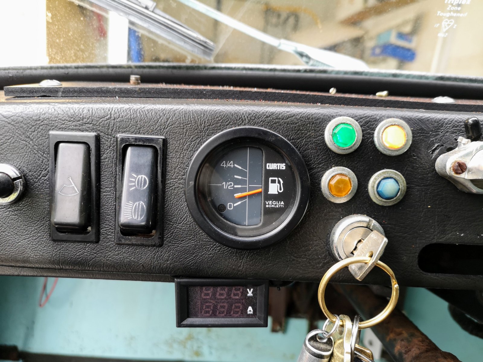

Given that the fuel level had dropped below a third of a tank I reckoned that I should have plenty of clearance to pull the fuel gauge sender and flip it around so it was fitted the right way up. For future reference - the cutout in the case that the wiring comes out of should be pointing directly up.
Flipped round and resecured to the tank let's see if the gauge is reading sensibly now...
Much better. I did a dip test, and that's actually reasonably accurate, only reads slightly low - which is exactly what I want, following the gauge I shouldn't get caught short.

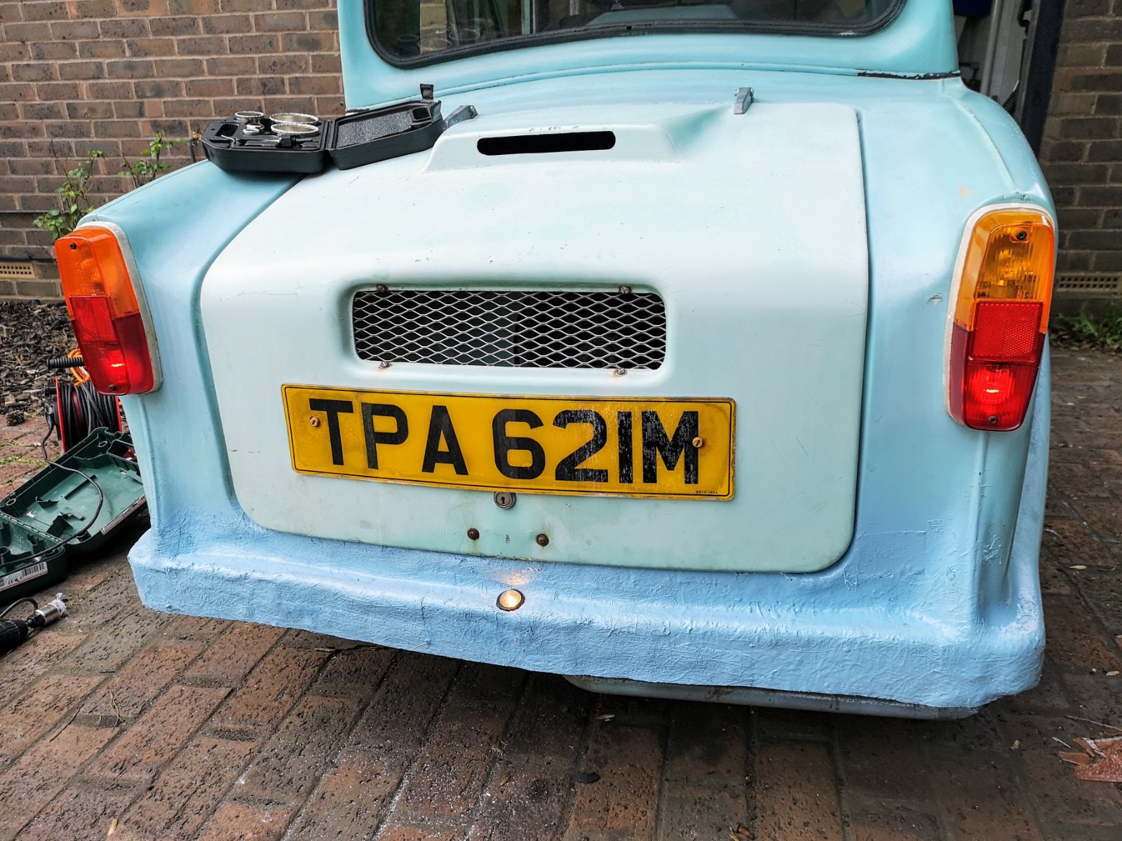

Finally got around to re-fitting the number plate light. I've turned the entire garage upside down several times looking for the little metal trim...No idea what I've done with it.
Current plan is to stop looking for it - as soon as I do that I'm sure it will turn up, that's how things usually work here.

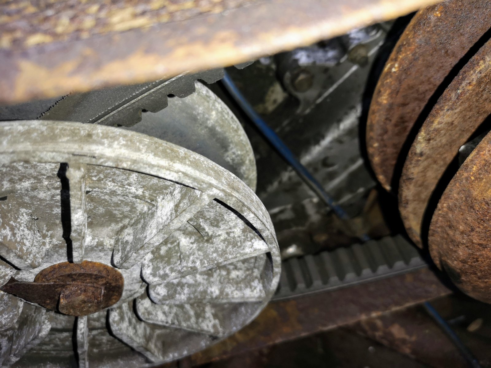

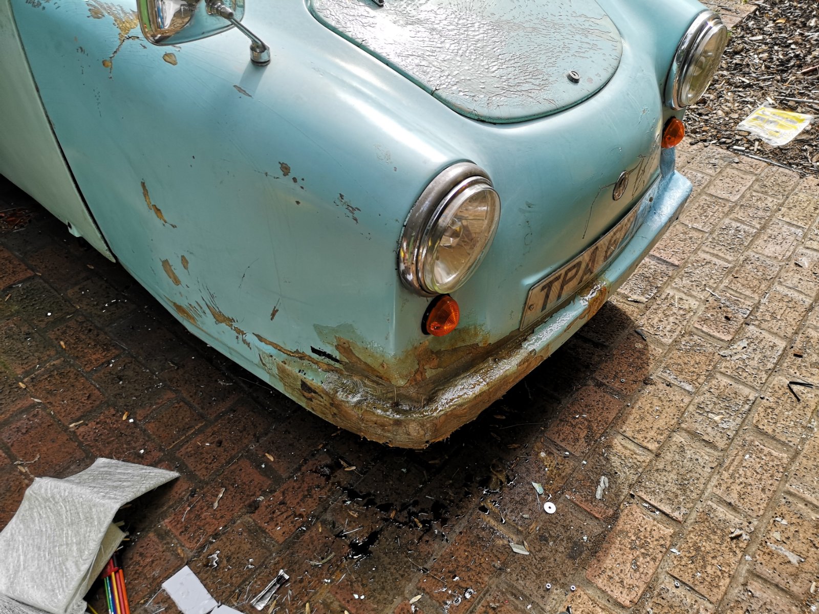

Having paid careful attention to both the behaviour I had seen on the last few test runs I'd done and watching a couple of videos on YouTube that another owner has just produced where they have fitted a brand new set of pulleys and a new belt, I had decided that my CVT belt needed to be slackened back off a bit. It seems that if the belt is too tight it tends to make the behaviour when taking up drive very snatchy, and as it pulls the belt too far down into the grooves it also messes up the gearing. This was quite obvious in that the belt was sitting a good inch down from the outer edge of the secondary pulley at rest, rather than level with the outer edge as it should be.
A quick fiddle around with the tension soon had things sitting more sensibly.
The drive system here seems to be very noisy at speed - My best guess is that this is due to the fact that the secondary pulley is really badly pitted due to rust. The primary looks bad in the photos, but feels smooth save for the last 1/2" or so to touch with just some light pitting at the very outer edge. The secondary (to the right in this photo) is in quite a state though.

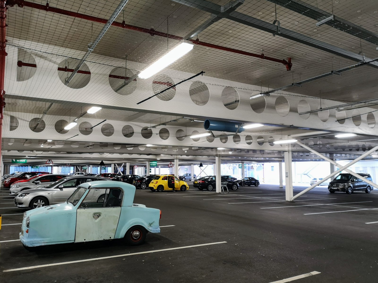

Time to take to the road for a test run. Once TP got done reminding me that it's far too long since she was last out by blanketing half our neighourhood in smoke when she was first started anyway.
There's no emission test as such required at all for a vehicle of this type and age beyond a visual "doesn't emit huge plumes of smoke at idle" check. TP isn't bad at all on that front, just tends to smoke for a few second or two on startup after sitting for a few days. There's no smoke visible on the overrun when driving so I'm not worried about this being symptomatic of worn valve stem oil seals - think it's more a case of "a really basic engine from the early 1970s" than anything else. I'm just going to keep an eye on it, I've a sneaking feeling that it's something that may well get better with use anyway.
We spent a good half hour or so trundling around our local area, the drive system seeming *far* happier today than on any previous outing, and so far the newly dismantled, cleaned and rebuilt carb has been behaving itself. No bouts of "sneezing" or any carrying on like that were seen other than one or two when she was still cold - and it seems that this happening occasionally is just "something they do" on occasion and shouldn't be worried about so long as it's not excessive. My gut feeling is that it's thanks to the inlet tract being quite long - I think under certain circumstances it takes longer for a richer mixture to arrive actually at the cylinder than it ideally needs to to keep things running exactly right. That's my theory anyway.
I was just thinking about going for an experimental high speed run when I noticed something at the side of the road stacked up next to a skip. I wasn't initially sure what it was - but it was clearly some form of tech from the 60s or 70s - something that my eye is pretty well attuned to spotting. Turned out that there were actually quite a few things there which were of interest. Of course I was in the ideal car for dragging ancient tat back home wasn't I...oh...wait...no, I was in a tiny three wheeler with no luggage compartment of any kind. Well, one of the main things I want to prove is that these little cars can actually manage just fine in day to day life...so she was loaded up!
Think we can officially say she's earning her keep by doing actual work now can't we?

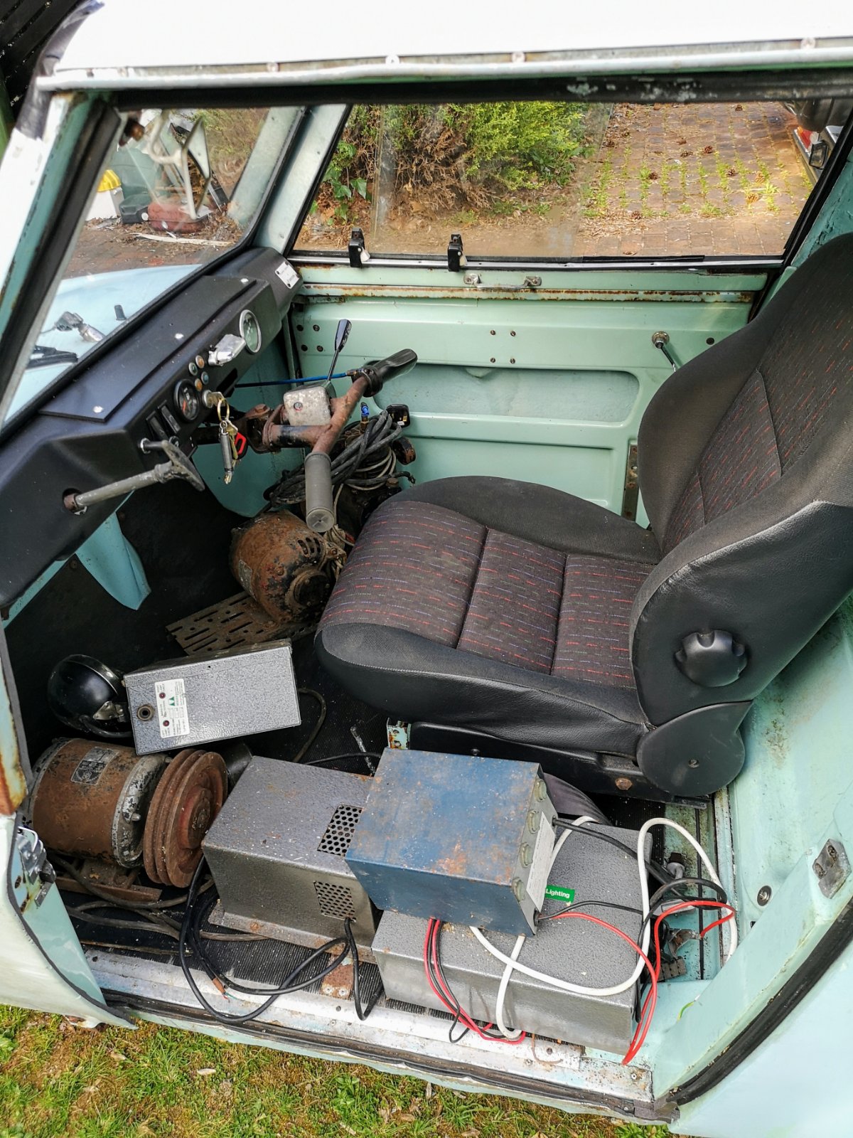

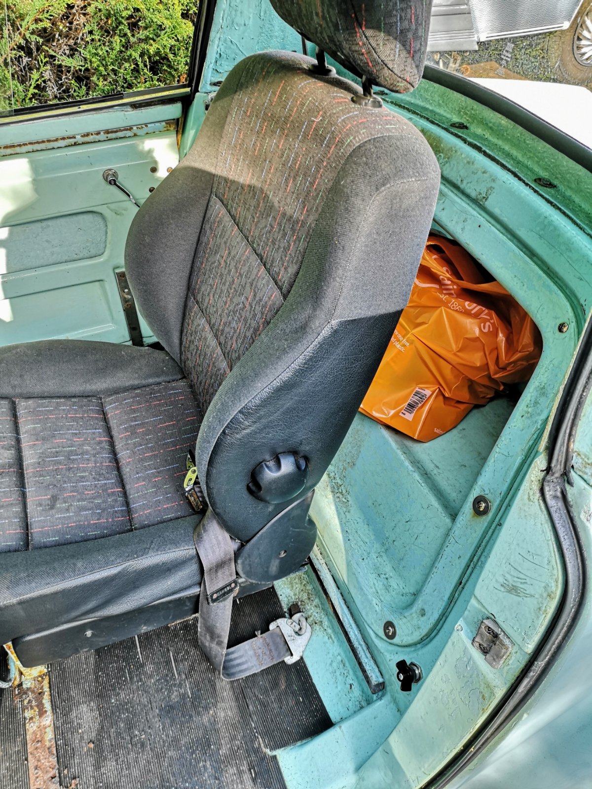

Turns out that you can actually fit quite a decent amount of stuff in there on account of there being no foot controls.
I wasn't actually sure what I had grabbed to be honest...Was vary much a case of purely grabbing what really looked of interest. I may make another run by tomorrow to see if there's anything else worth grabbing hidden a bit deeper. I did speak to the owner of the house and they were fine with me helping myself. The way stuff was stacked neatly next to rather than in the skip very much suggests to me they were hoping someone would adopt some of the now homeless stuff which really was too good to be scrapped.
So what did I grab? Figure some of you might be interested at least given you put up with my ramblings most of the time...

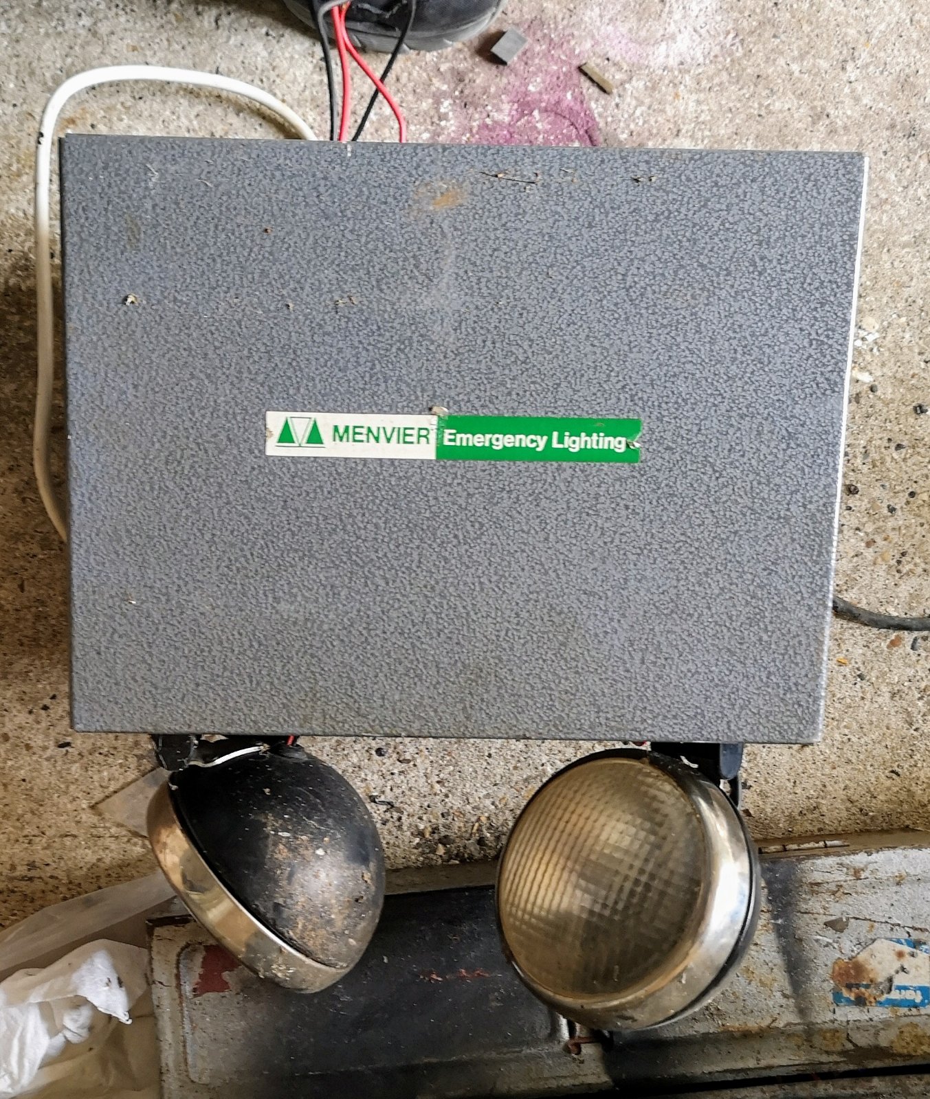

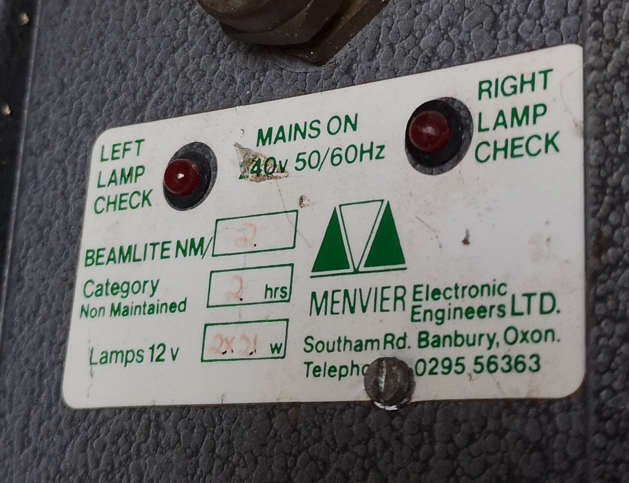

A pair of these old Menvier emergency flood light units for a start.
Doesn't feel like they're fitted with any batteries currently, but with a new set sourced that should be emergency lighting for my garage sorted. That's something I've been meaning to look into for a while - our fuse box is in there so it's kinda sensible to make sure there is some provision in there.

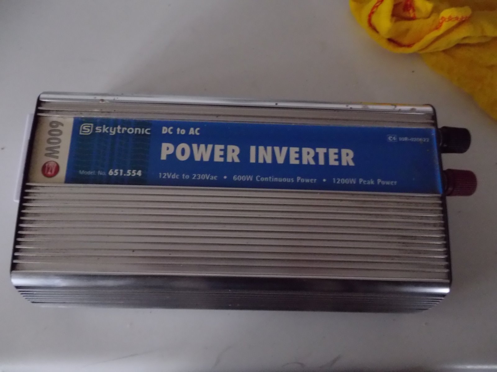

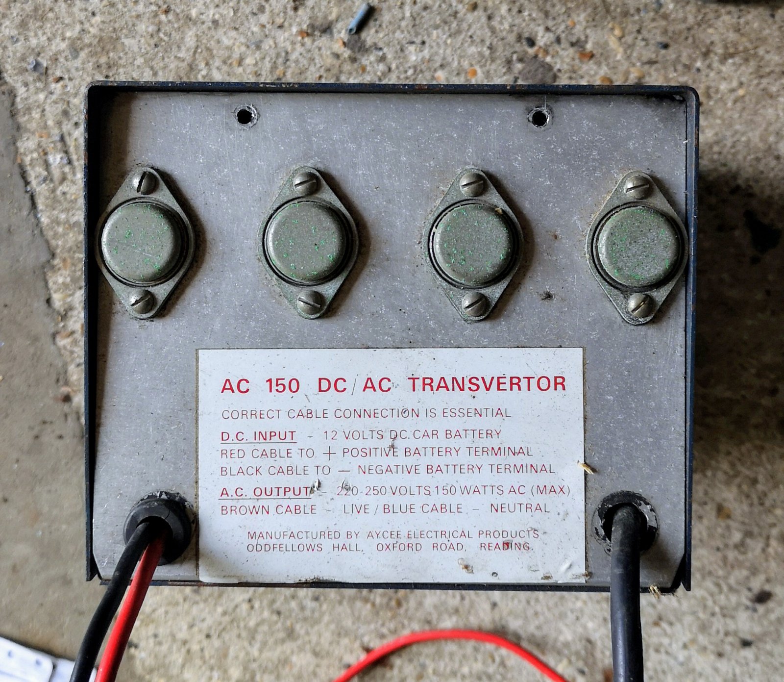

Next thing looks to be one of the oldest 12V DC to 250V AC inverters I've come across so far.
Curious to have a closer look at this, suspect that one this old probably runs at a low enough frequency to ensure it whistles in just the correct way to ensure you want to you've your own eardrums out in ten minutes flat. Curious to take a look at how it's put together and what components have been used. Even if it's not actually used often, could be a nice upgrade to fit to the van too.

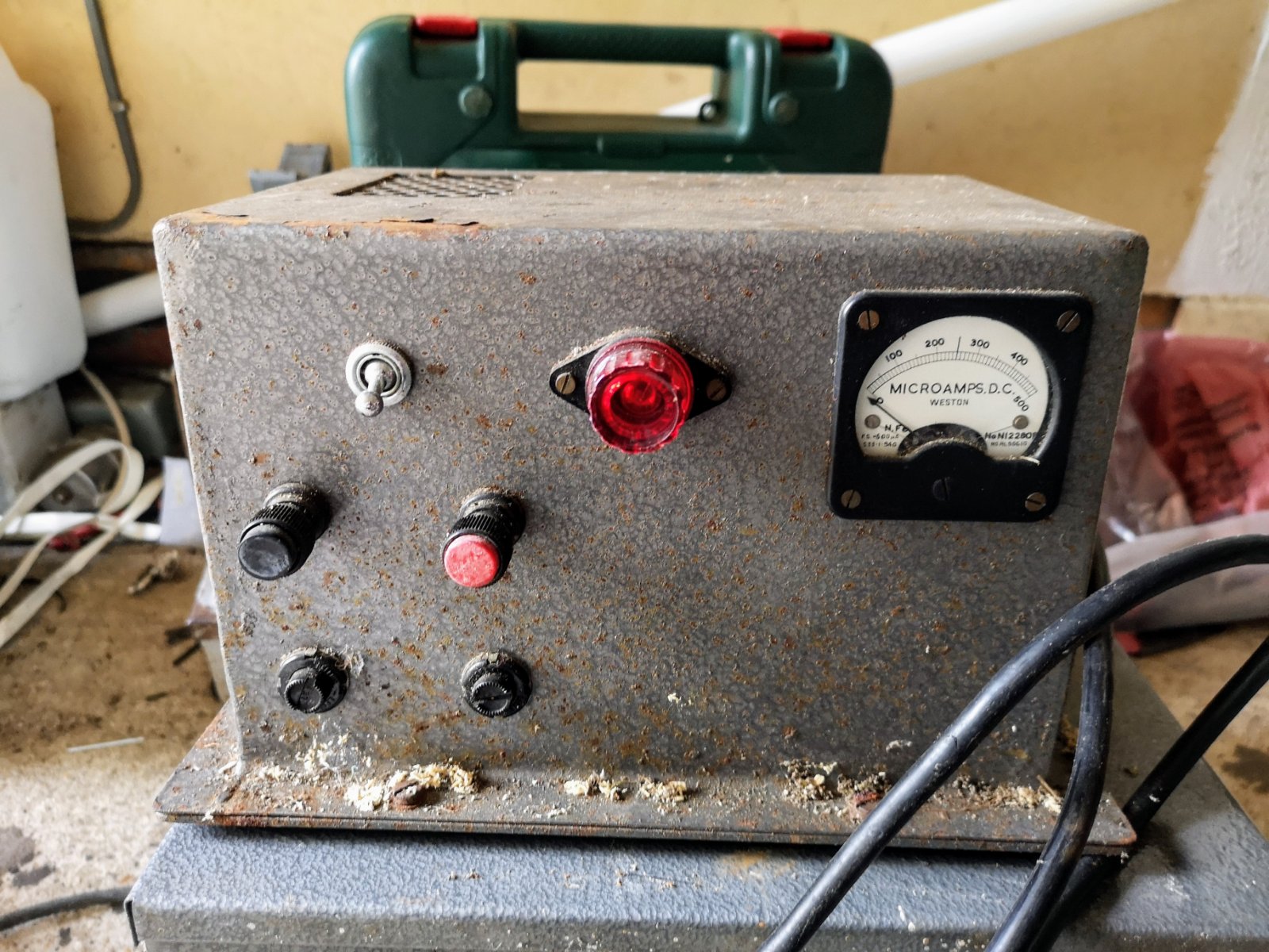

Not sure what the next one is yet beyond "DC - probably low voltage - power supply of some sort - possibly battery charger."
I'm guessing the 500uA range on the meter is misleading and it's likely been scavenged from another bit of gear at some point. No makers mark anywhere on it, so this might be a home brew job. Given the age this quite likely involves a selenium rectifier, so testing will definitely be done outdoors! You don't make that mistake twice...

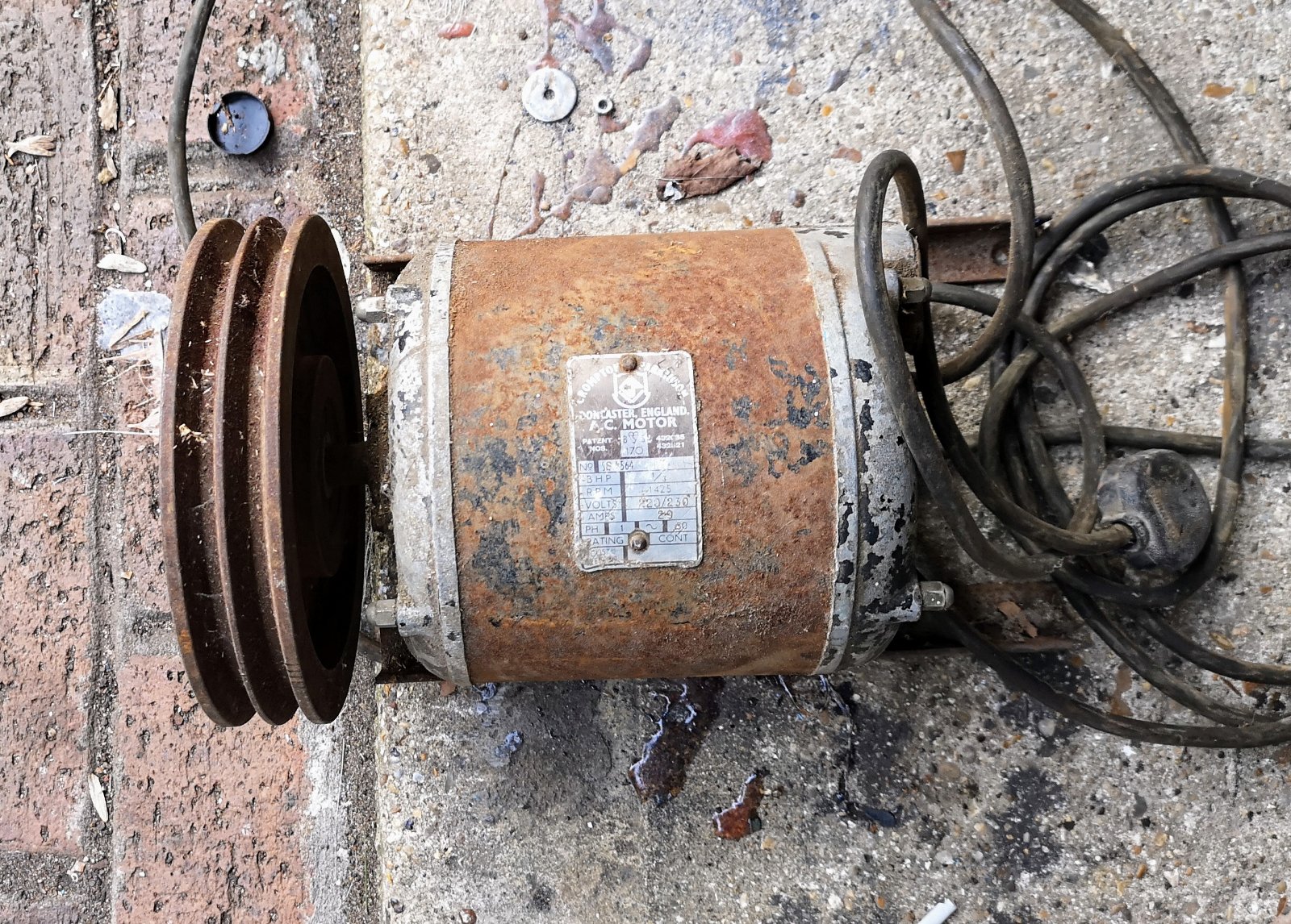

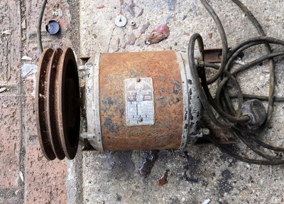

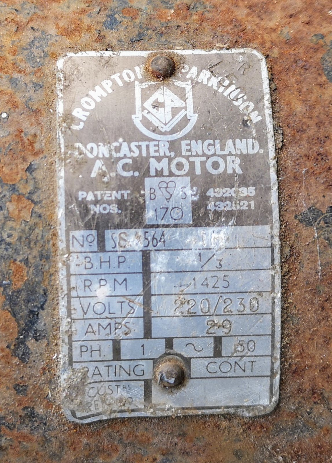

Nearly dismissed this motor under the "don't know what I'd do with it" heading before telling myself to stop being silly, we that it was far too good quality kit to be seeing get binned.

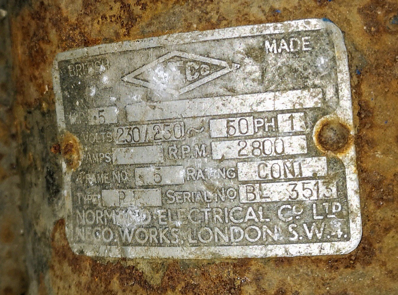

Here's the rating plate for those who know their motors...
For all it looks rough, if you give it a spin by hand it takes a good thirty seconds to stop, so the bearings seem fine.
This is what I initially spotted poking out beside the skip which made me look closer and see the rest of the stuff.
It's a teeny tiny compressor...Beyond that I've nothing. As with anything from this era though it's just a really nice...thing. I'll have a run by there again tomorrow and see if there's a receiver to go with this, though I doubt it. Will be curious to see whether it works. The plastic fitting on the outlet suggests it has been in relatively recent use though, and turning it over by had seems to suggest it is pumping.

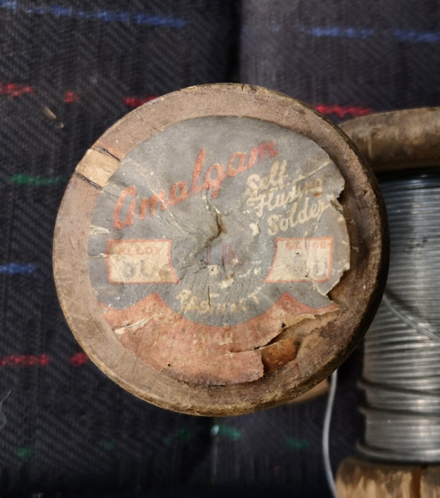

A couple of reels of proper old school solder were grabbed as it's always useful to have around.

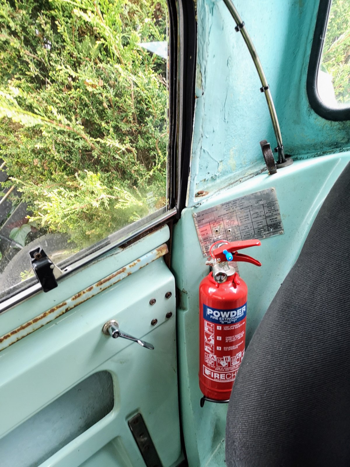

Last thing I spotted though - literally as I was initially pulling off - was something I've been keeping an eye out for for a while. Nice proper old-school pump action oil can.
That will look right at home in the Invacar regular maintenance tool kit.

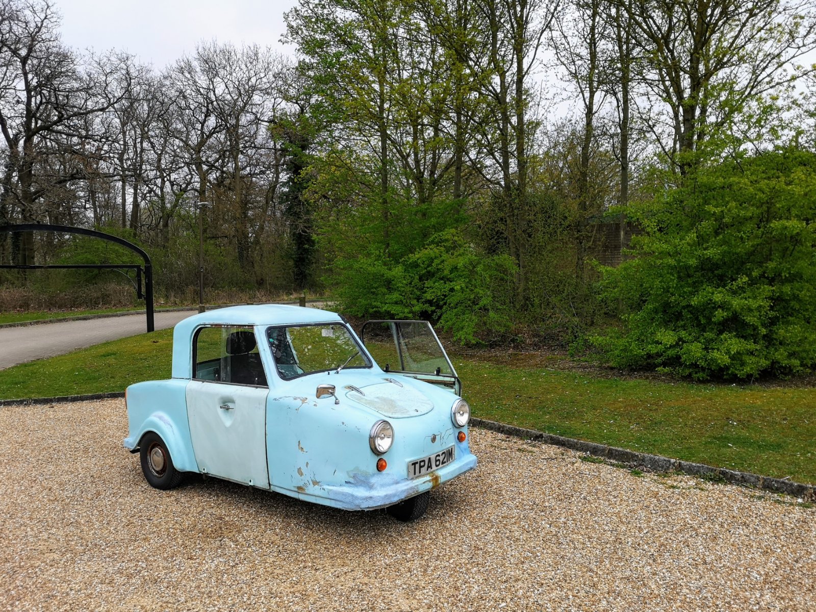

Having obviously put my actual plans momentarily on hold when spotting all this stuff and dragging it back to my garage, my schedule was a little behind. I decided that I'd get one more thing ticked off before calling it a day - the high speed test run I had been about to do before I distracted myself by spotting interesting tat at the side of the road. Given the drive belt had been adjusted and the carb was a lot happier I wanted to see if she was capable of handling main road speeds now without excessive drama or any bits falling off.

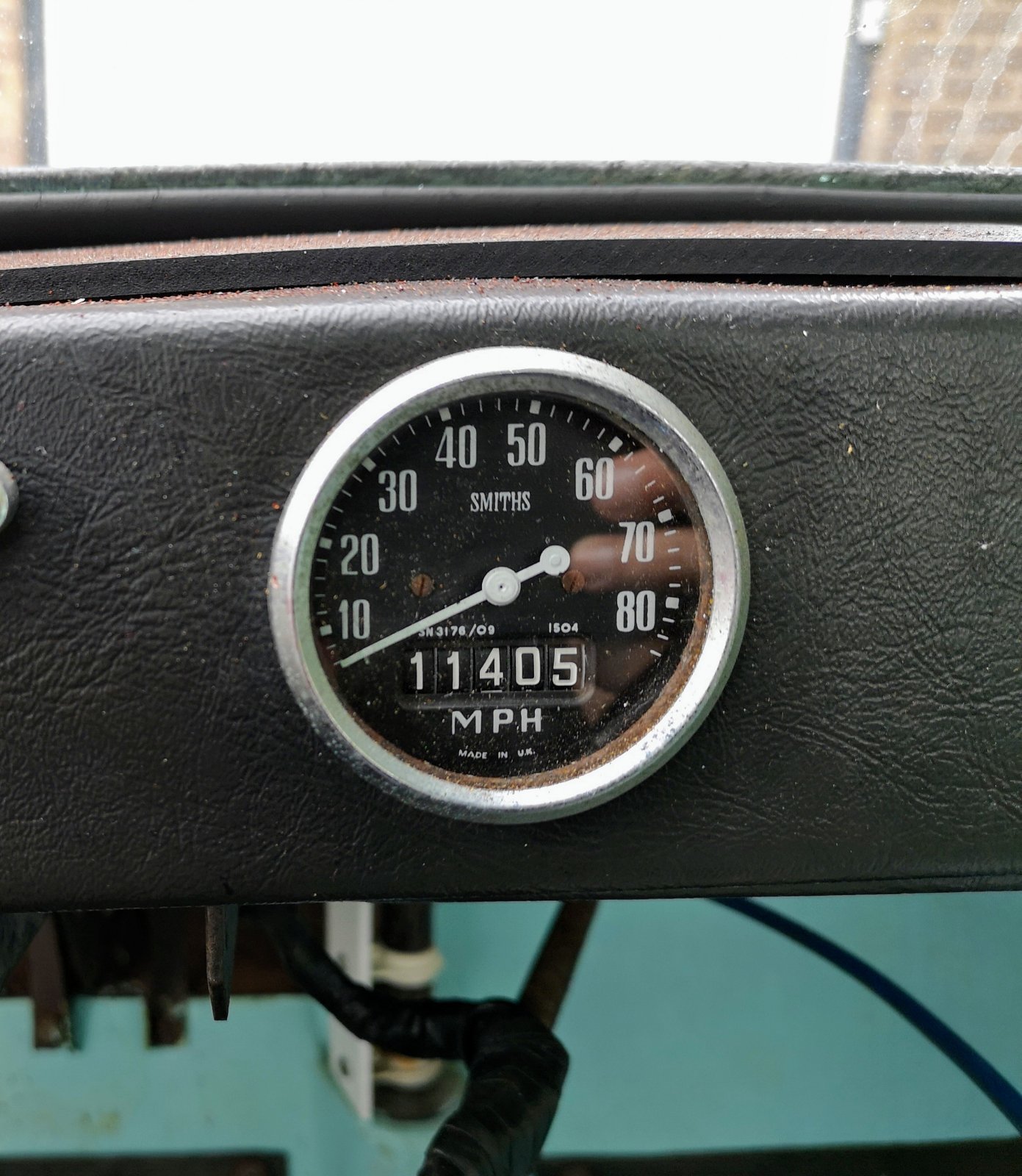

An ideal day for that, as unsurprisingly the grid roads in MK are pretty quiet on a Sunday after the shops have all closed. First three attempts to get up to any real speed were thwarted by almost immediately catching up with and getting stuck behind modern traffic trundling around the 60mph roads at well below 40. Eventually though I did get a clear run on the stretch alongside our area - and decided to see if 60 was something that could actually happen.
Yes, yes it is! She will definitely do 60 (well, indicated anyway!), even within the relatively short run between our side road and the next roundabout, and on a slight uphill gradient. Time was against me today though given the amount of it I had wasted earlier, so I had to wrap it up there. Sixty isn't nearly as terrifying as some would have you believe - incredibly noisy, but didn't feel as though I was staring death in the eye. Only thing which makes it feel a bit strained at the moment is the low frequency vibration from the drive system, which I think is largely down to the rust on the secondary CVT pulley.
Had to do a bit of Automotive Tetris to get her back in the garage, so here's a photo of TP looking triumphant before retiring for the day having both hauled a load of stuff home and then managed to safely reach the posted speed limit.
Nicely showing off the hubcaps donated by a friend recently too.
Have to wonder, is that the first time that she has ever actually travelled at that sort of velocity under her own power? You do have to wonder with a vehicle like this!
Did get a fantastic double-take from the driver of the first Prius taxi I got stuck behind though when he saw me in his rear view mirror...

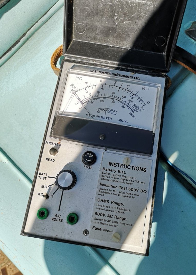

I'd say that's quite a decent day really. Will get the Megger out tomorrow and if they pass the initial tests, maybe see if any of this stuff works...Then inevitably make another run past to see if there's anything else worth nabbing that I can justify given the limitations on space I have to play with. Today's lot seemed far too good to just leave sitting there though.

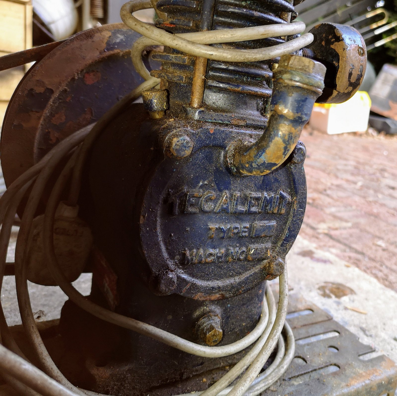

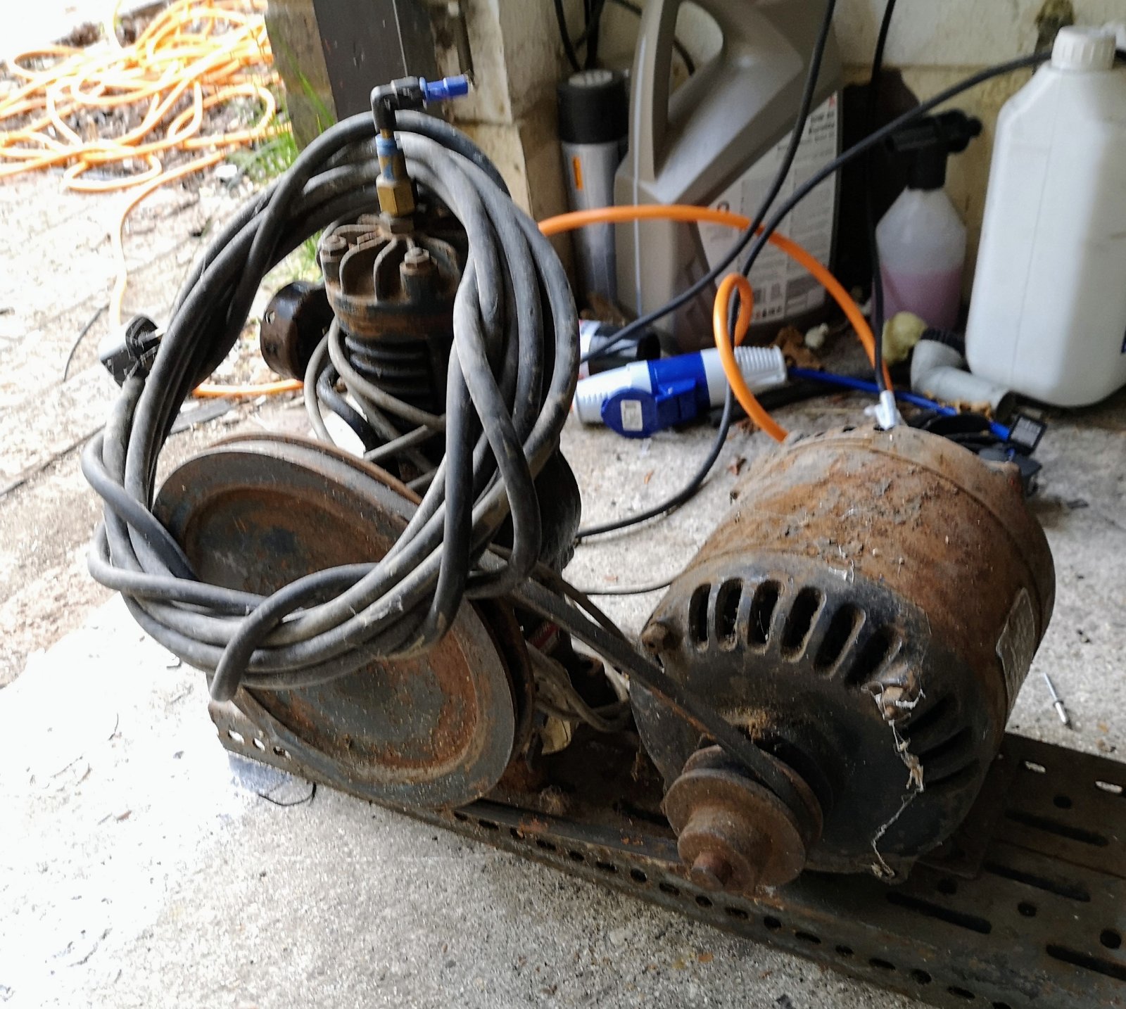

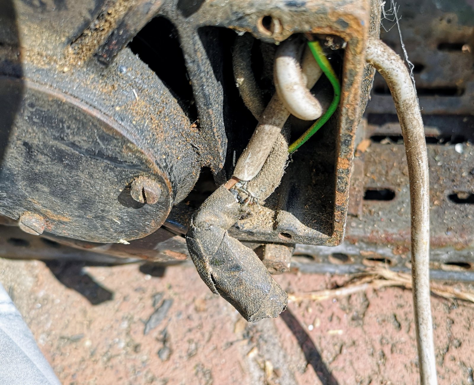

Figured today I would mostly have a nose at my finds from yesterday. Compressor up first as it was probably the thing that I had the most immediate use for.
Immediately noticed some "quality" wiring where the junction box originally would have been...
Wouldn't be garage equipment of this age without dodgy wiring...
However it had most likely been working fine like that for decades so I'm not about to worry about it until the thing has proven itself - if it does I'll obviously sort it properly before it gets installed in whichever corner of the garage it winds up living in.

For those not familiar with their test equipment this is a Megger. Well, technically it's a high voltage insulation tester - Megger is a brand name. On your average household multimeter when measuring resistance it will apply less than five volts to the test subject. This uses 500V to do that - so can spot where you have issues with insulation that is breaking down at higher voltages, especially often where damp is concerned.
You learn very quickly to keep your hands out of the way as it doesn't half sting if you get zapped by it.
It tested perfectly and the resistance through the windings looked reasonable for a motor of this size. There was oil in the compressor (it actually has a teeny tiny dipstick) so seemed time to see if it would work.
Here's the verdict:
[Youtube]BIX5h006PwE[/youtube]
Yes, and it's astonishingly quiet. Certainly won't be a chore to have it burbling away in the garage now and then. No knock from the bottom end at all which is nice. Hooking it up to the only high pressure gauge I have to hand, it almost immediately pegged the thing at 200psi...so it definitely can pump a decent head. The fact that there was absolutely no change in speed of the motor at that pressure seems to suggest that the motor is somewhat over rated for the job.
Not going to be running air tools with it, but hooked up to a small receiver and pressure switch (probably still have one from back when I used to help out with some HVAC stuff) it should be just dandy for inflating tyres, clearing stuff out of bolt holes and blowing water off cars after a wash. Stuff like that.
Happy with that.
Number two was the other random motor that I grabbed. If it's good I'm thinking workbench mounted polisher/grinder. This one is free of any dodgy wiring at least.
Hooking it up really surprised me...Very brief hum, then near silence, just a really quiet hiss from the brushes. Turning power back off, it kept going for nearly a full minute before it stopped.
[Youtube]KjRMCZdZT9w[/youtube]
Now that's a nice set of bearings! You just don't get quality like that on a general purpose motor these days. Will definitely need to find that a purpose.

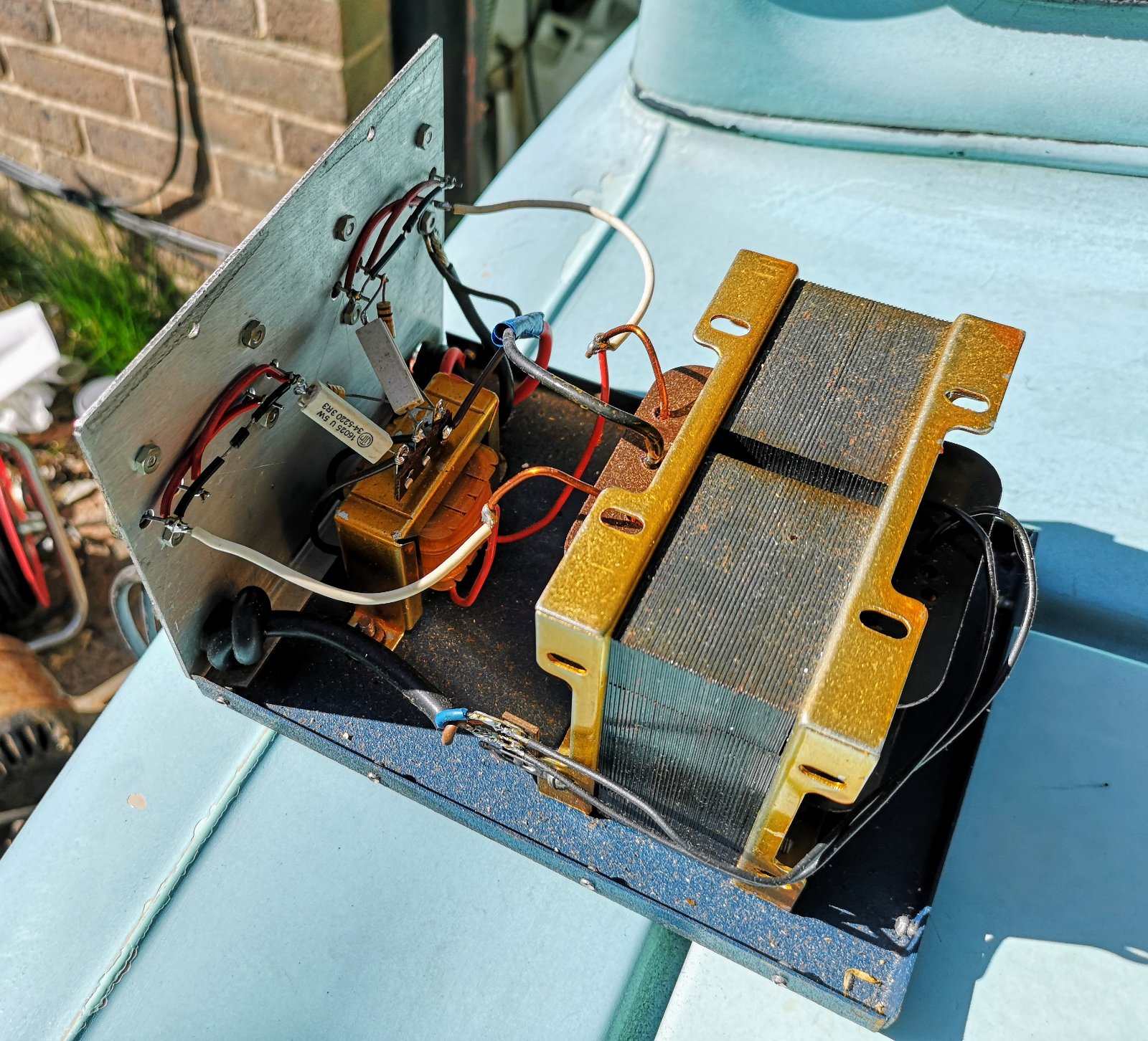

The inverter was up next. Really wanted to see what was in the box, so the lid was pulled. I wasn't expecting it to be exactly packed full...but I wasn't expecting this little in there!
This has to be the definition of a &quot;keep it simple, stupid&quot; design
This has to be the definition of a "keep it simple, stupid" design

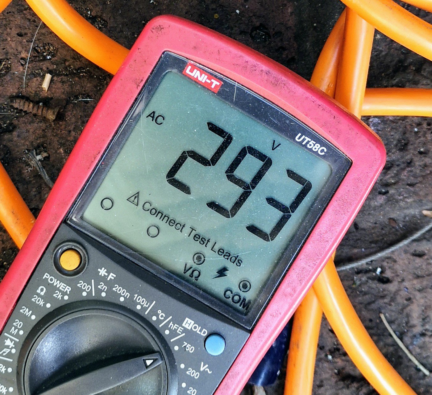

Hooking it up and we had a loud buzz and this on the output.
Keep fingers well clear!
Not surprised it's high given there was no load connected and there's obviously no regulation as such. Reckon this may well take up residence in the van...not likely to have a huge need for mains when off grid, bit nice to have the option.

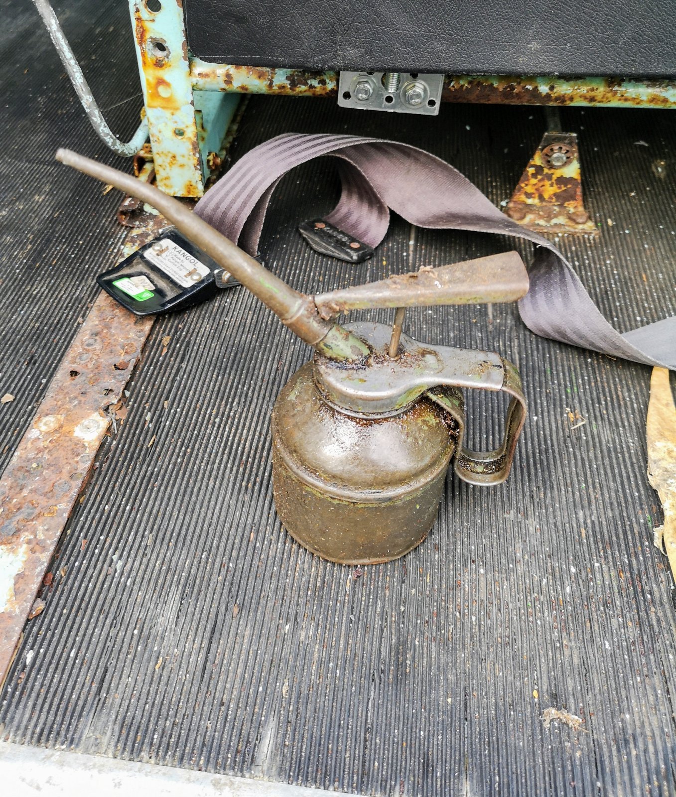

The oil can also works a treat, which is no surprise.

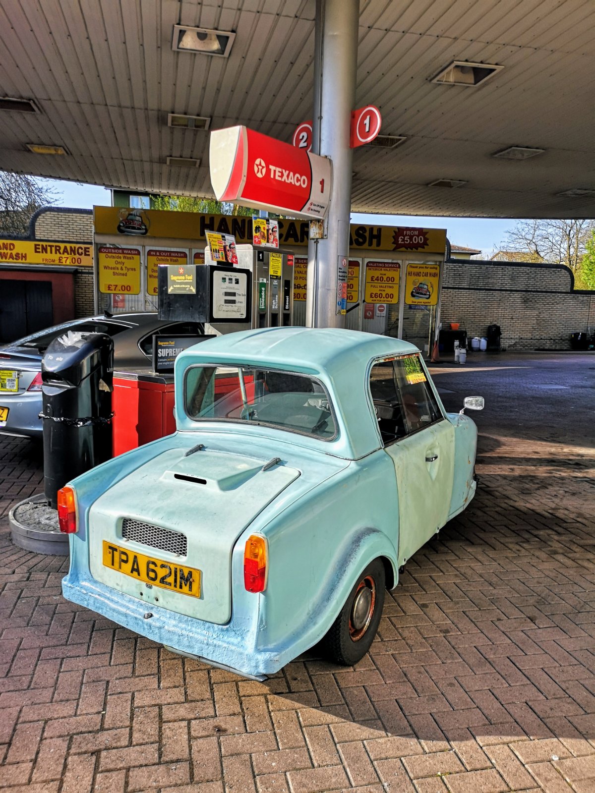

On the way home she was fuelled up actually at a filling station for the first time in at least 18 years.
First visit to an actual fuel pump in at least 18 years
This literally brought the filling station to a standstill for a few minutes as the cashier felt it was necessary to come and take a look as he had no idea what it was! Only 12mpg indicated...but there are at least a couple of hours static running , plus the carb was playing up for a while so no surprise there really!

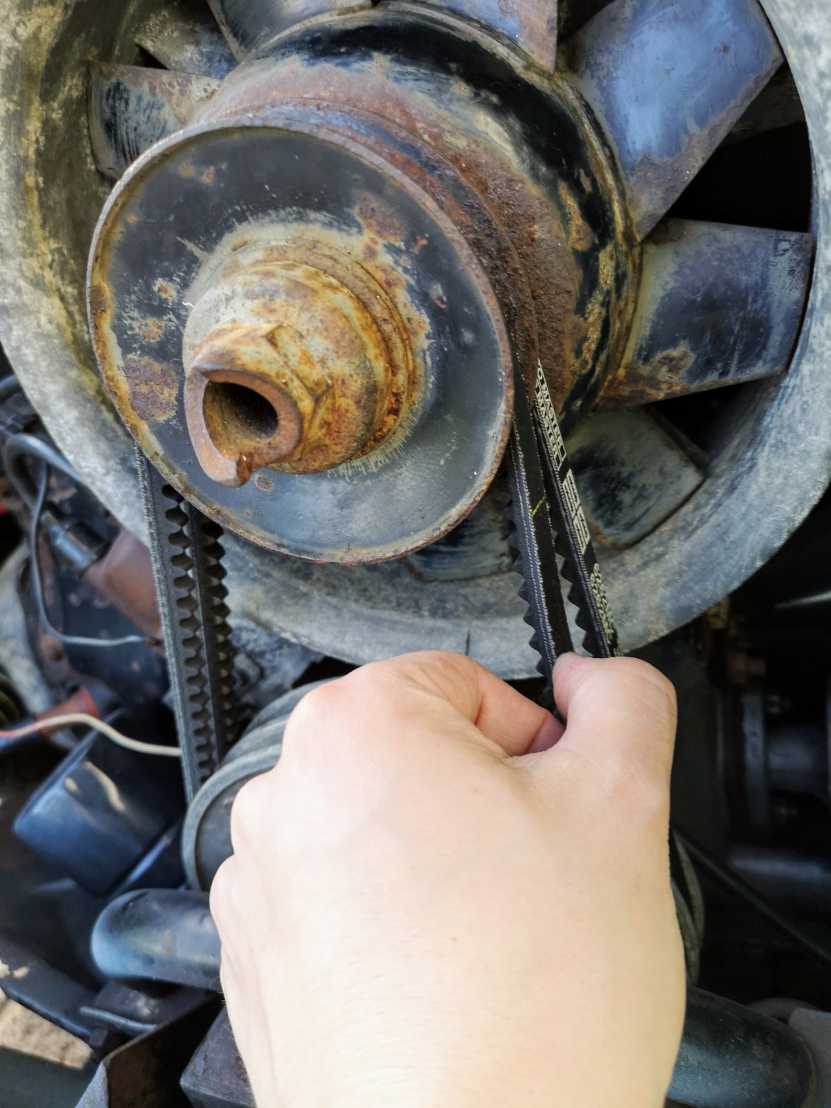

Only thing I do need to tweak tomorrow is the Dynastart belt tension, it's a little loose now the new belts have bedded in a bit.
Belt is slightly too loose
No slipping, but you can hear them flapping around at one very specific point in the rev band.

I think that your electric motor looks like an induction-repulsion motor https://en.wikipedia.org/wiki/Repulsion_motor . My dad was really chuffed when he once found a new crated 1/2 hp repulsion motor in a clearance sale, it got instated on a circular saw bench. The advantage of these motors over normal induction motors is that they have much more starting torque. It is also often possible to convert them into reversible variable speed motors by arranging the brush holders so that they can be moved around the commutator.

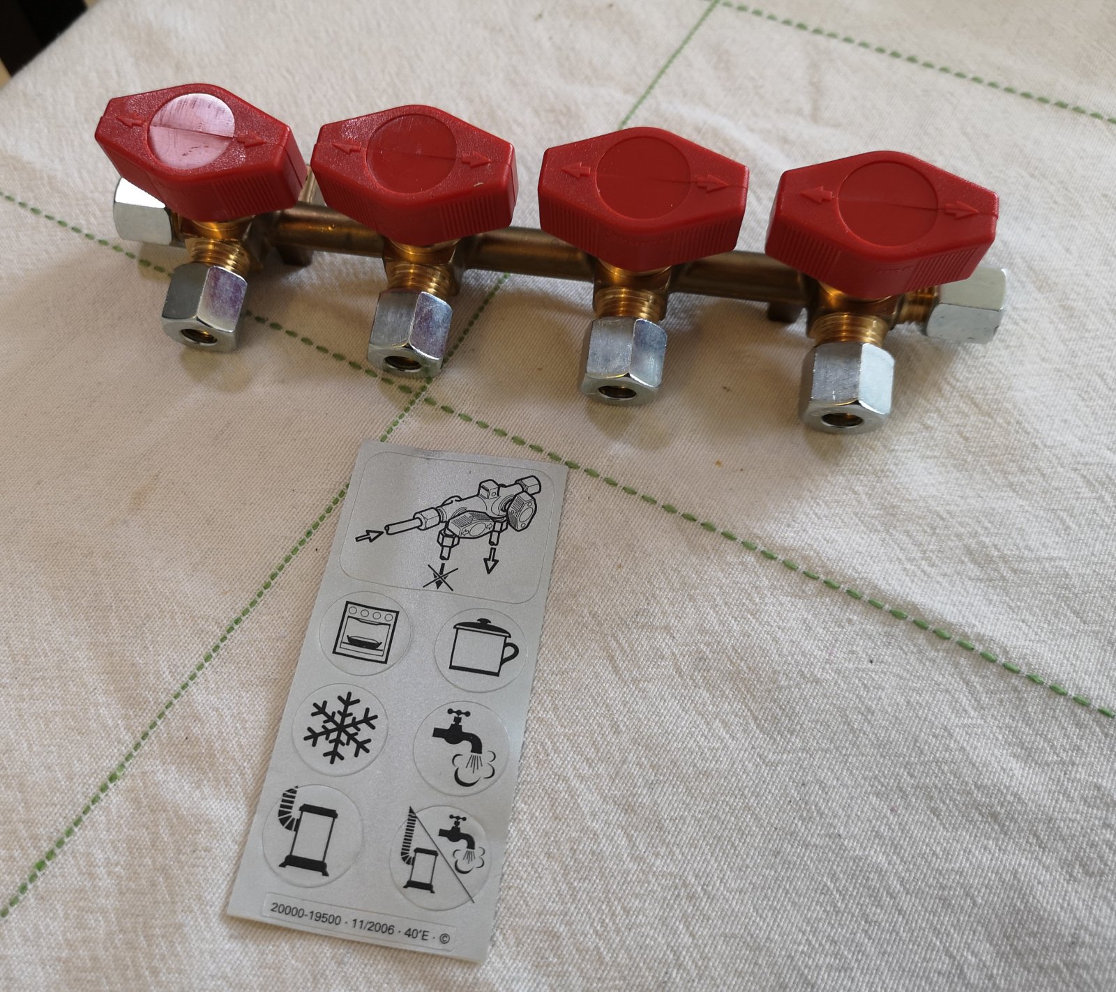

This turned up this morning.
New gas distribution manifold
So shall be able to get the gas system rebuilt shortly. Figured just buying a new one was easier than faffing around trying to get the ancient one cleaned up and sealed properly.

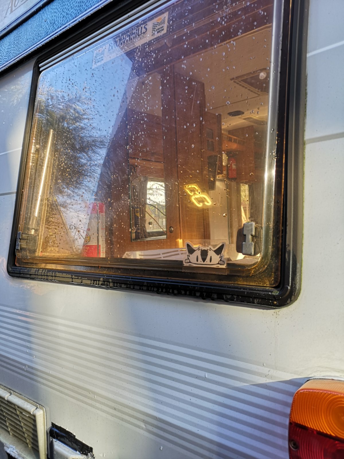

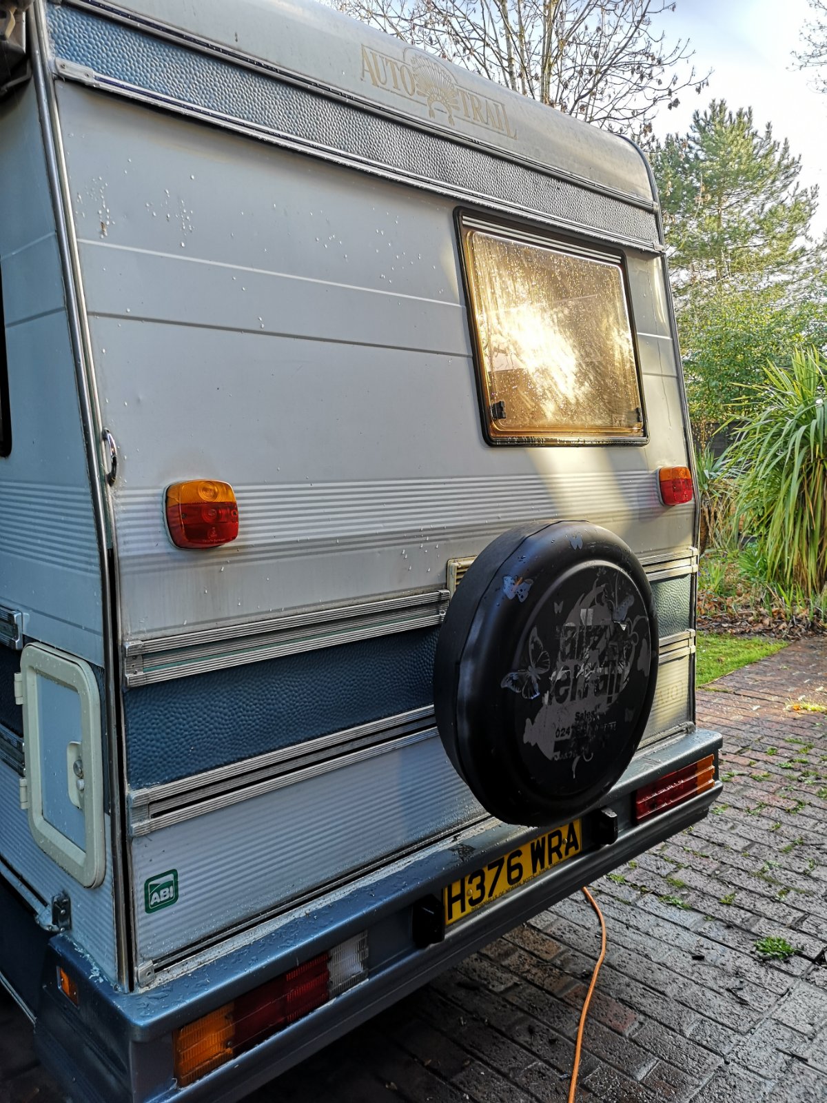

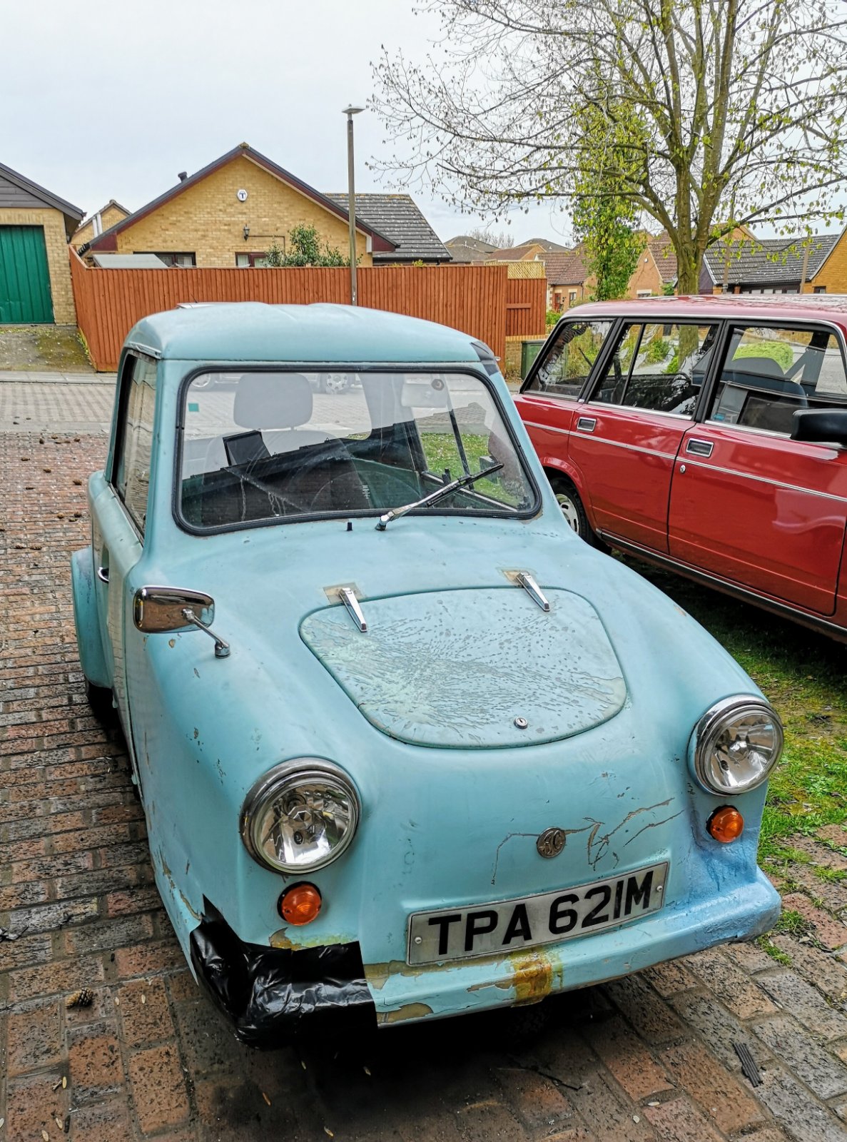

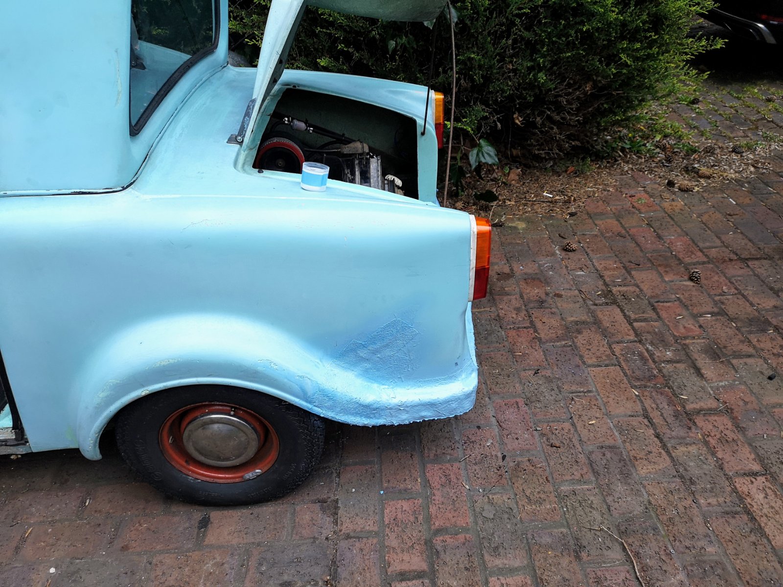

The downpour that we have had overnight has done a good job of highlighting that rainwater is still getting into the one corner of the van.
Still not entirely sure exactly where the point of entry is. However for the purpose of elimination of a possibility I have refitted and properly sealed the high level tail lights (though obviously this will make myself more MOT prep work as I will need to wire them up now). Not actually a bad idea anyway as one limitation of the of the factory lights in the bumper is that they aren't visible from the side at all - the little orange reflector is just that, it's not a repeater. Plus given the fact that so many drivers seem to be in a complete daze addition of extra lights can only be a good thing.
High level rear lights reinstated
I have also re-bedded one of the bits of sealant just below one of the upper weatherstripping which looked a bit suspect. If this still doesn't do it I will just pull all of the strips and trim off the entire corner of the van, clean back and rebuild everything from scratch. Messy job but it will probably be needed.

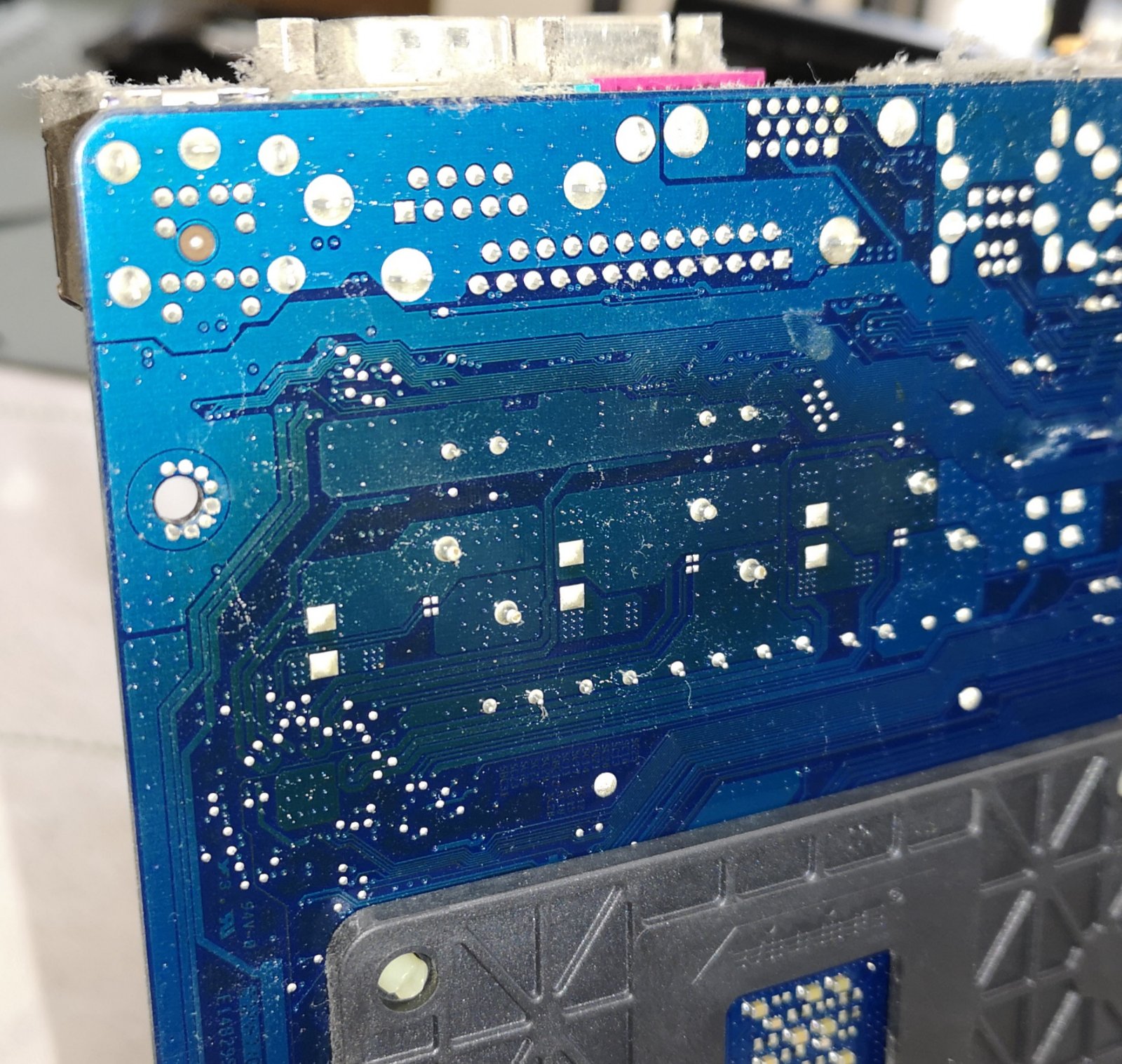

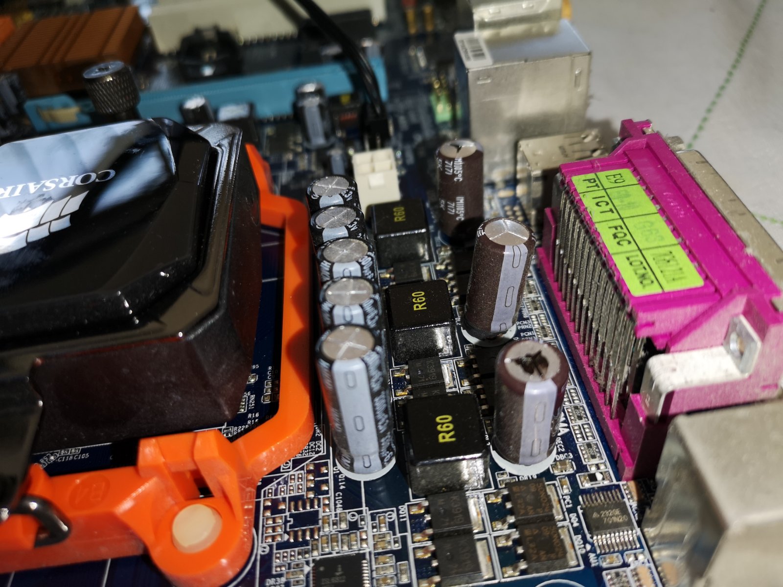

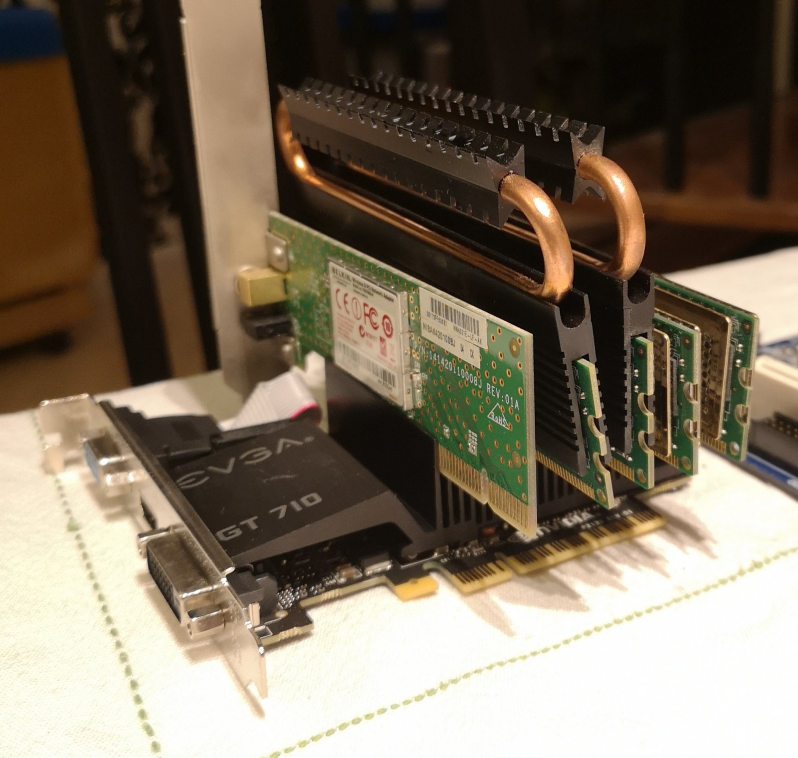

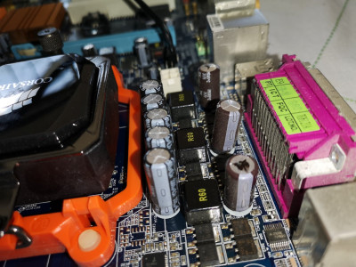

Brief pause this morning as I needed to figure out why my old workstation PC had croaked at the end of last week.
It has generally been extremely stable and reliable but at the end of last week it suddenly refused to boot. Or even POST. No beeps, no flash codes...nothing.
Hauling it down off the shelf on the workstation revealed that A: it is every bit as heavy as I remember that machine being. B: There was an immediately visible bulging capacitor near to the CPU.
It was overdue a bit of cable pruning etc anyway as there had been a couple of bits of hardware changed in the last year or two, so time to pull it to bits. Immediately discovered that my main hard drive with my OS on was hooked into the expansion card rather than the onboard SATA controller. Really smart. Not a clue how that happened! No need for that expansion board now anyway as the number of drives involved has reduced somewhat (Windows 7 having nuked itself saw it removed from the lineup for one). Been an age since I last used the SCSI equipment on this machine as well (have two other machines with SCSI abilities and a PCMCIA adaptor as well) so that card is coming out. It added a full 30 seconds to the boot as well so won't be sorry to see it go.
With the board out (was slightly shocked to discover that every one of the screws holding the motherboard down had vibrated loose!) a quick visual inspection revealed three very obviously cooked capacitors.
This whole region runs rather warm as it's where the CPU voltage supplies are derived, and, and with this machine having spent probably a couple of tens of thousands of hours with the CPU flat out not surprising things have got a bit cooked.
Didn't realise *how* warm until I saw that it had actually discoloured the mask on the reverse of the board!
Nothing else was obvious visually, so I'll get some new caps ordered in (sadly can't just pop down to Maplin can I...boo! Will see if that sorts it out. Finger crossed.
I may have wound up using the fins in the graphics card heatsink like a tiny toast rack to keep all the expansion cards and the memory out of trouble until it goes back together.

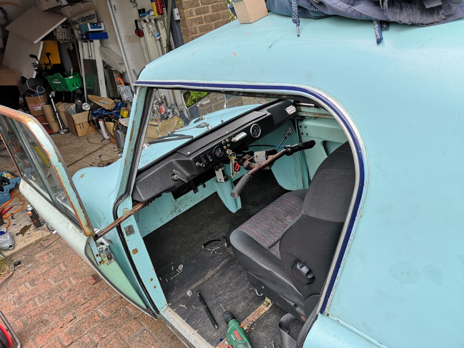

Before I could do that though I wanted to tick a couple of things done inside as it's been too long. The fuel pump power supply cable floating around in the footwells was one as it has got yanked out every time it's been vacuumed so far.
Nice simple job. Sill covers lifted just enough to tuck the wiring under then put back in place.
Fuel pump supply cable no longer dangling in the footwells
The ECU will be moved from the void where the glovebox should be where it is just now shortly and will be attached to the underside of the under dash shelf.
ECU still waiting to be moved
That will also get rid of the one remaining visible bit of wiring there too.

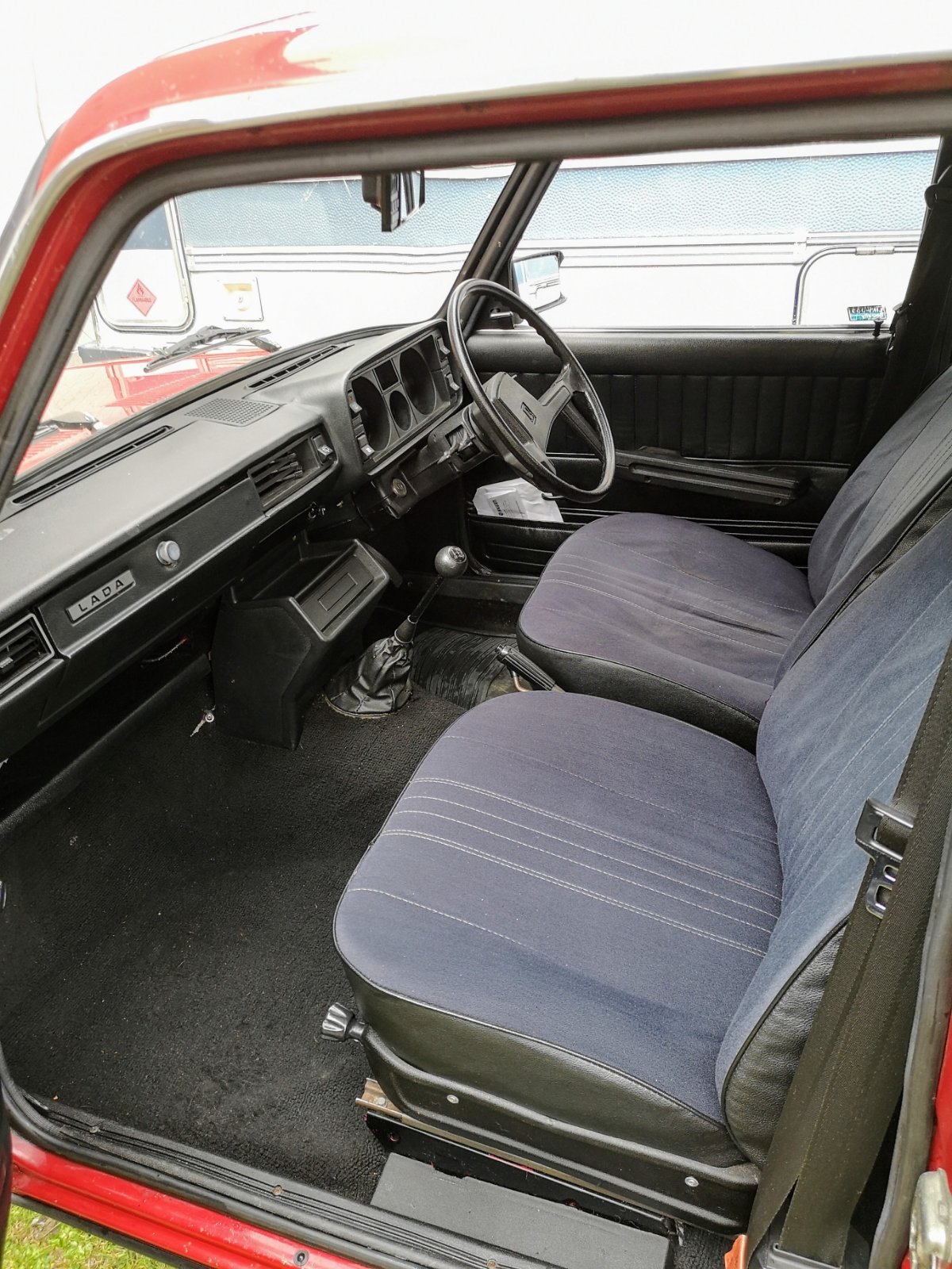

The driver's side will covers were removed early on when I was fiddling with the accelerator linkage. The one had been being awkward about going back in which is why I had ignored it for a while.
Turned out the reason for this was due to the trim being fitted before the seatbelt. As such even though they do not share any fasteners, the trim is trapped behind the seatbelt bracket. So that had to come off. This turned into a 45 minute battle as the bolt was jammed into the belt bracket so it tied the seatbelt in knots. Also then had to clean threads out as the carpet had been mashed into the bolt hole when the car was built.
Eventually got it all back together.
Trim reattached and car ready for a clean
Also got the seatbelt inertia reel properly fitted upright so it should be less touchy about extending.
This seatbelt wasted me 45 minutes

Your out of the skip compressor is the same as one my brother built, he converted a Calor gas bottle to use as a receiver.

Comments about the inverter reminded me of this, I bought it some long time ago as a stand-by but it never got used, sitting on my shelf in the workshop.
I was going to pop it on Ebay but if you want to make an offer for it for your van...…………………..

Gibbo2286 wrote: 04 Apr 2019, 12:16 Comments about the inverter reminded me of this, I bought it some long time ago as a stand-by but it never got used, sitting on my shelf in the workshop.
Thanks for the offer! I don't think it's something I will really have particular use for. Only pondering using the one I've got here because I stumbled across it. Mains AC on the move isn't something I really see these days given that pretty much everything just plugs into a USB socket. Few more of those will be getting installed though!

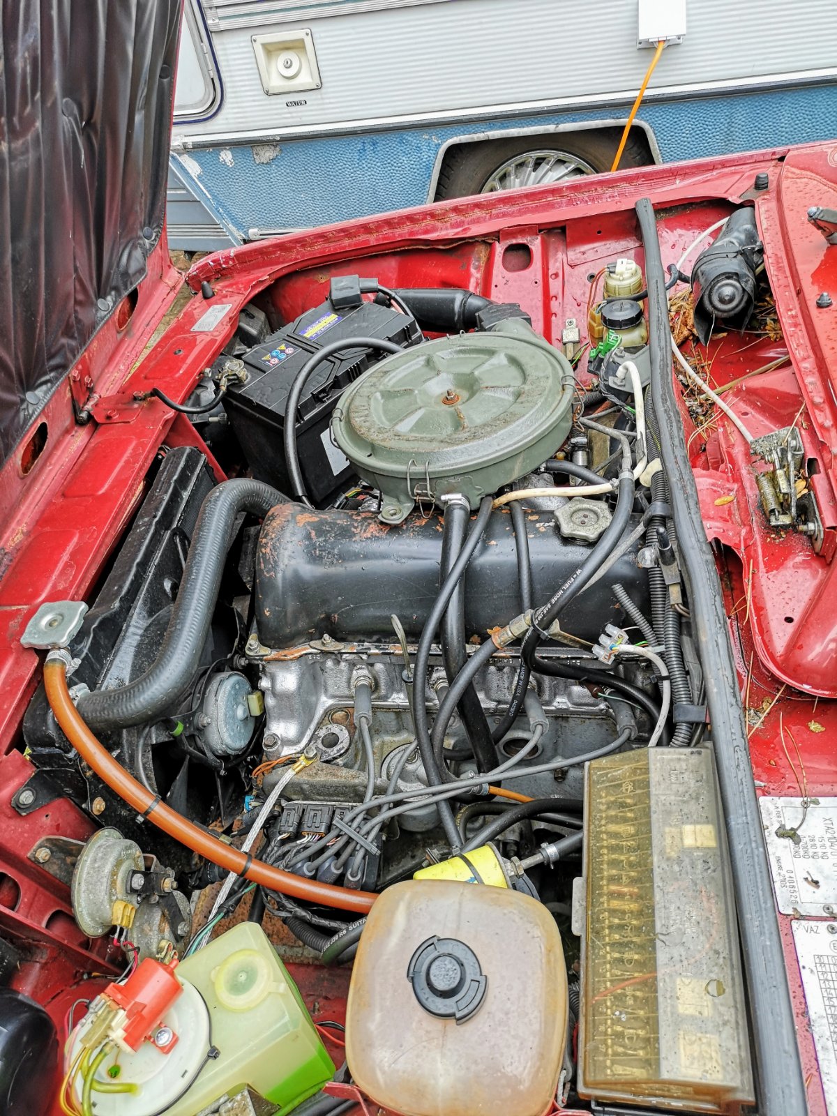

Need to attack the engine bay with an air line to get a whole load of pine needles out of the scuttle etc.
Nearside engine bay
Nearside engine bay
Offside engine bay
Offside engine bay

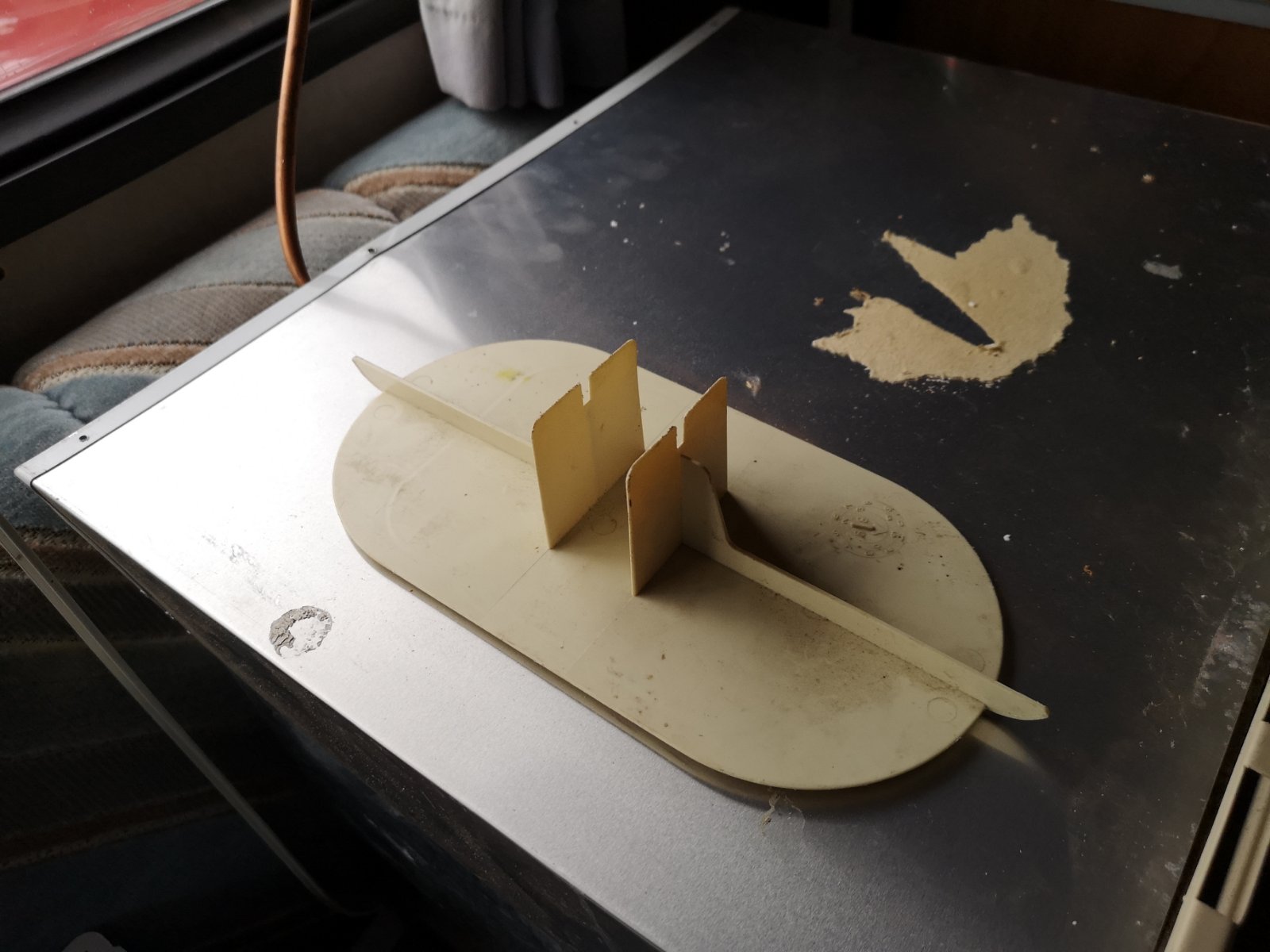

Oh - completely at randomly I spotted a copy of this in an eBay listing yesterday...
Mystery piece of beige plastic
Have been chasing it around the van since I got it trying to work out where on earth it lived. Turns out the answer is underneath the toilet cassette - intention I guess is to help prevent the tank sagging in the middle when it has 20 litres of liquid in.

I was quite pleased with how the Invacar behaved when I last had her out. So when I had a local trip lined up this afternoon if obviously made sense to take her rather than have the Activa drink another half gallon of fuel.
While only a couple of miles across the town centre, this would be the furthest from home that I had ventured so far. Did she make it?
TP venture as far afield as Morrison's for the first time
Of course she did. Place only opened a couple of years ago, so I doubt there has ever been an Invacar in that car park until today.
Had to swing by the pharmacy on the way home, which left me the opportunity to watch out the window for several minutes watching people walking past TP and be totally baffled by what they were seeing.
The size comparison to a Skoda Roomster is somewhat comical.
One of these things is not like the others...
Back home an hour or so later and a milestone has been reached.
Mileage as of close of play on April 5th 2019

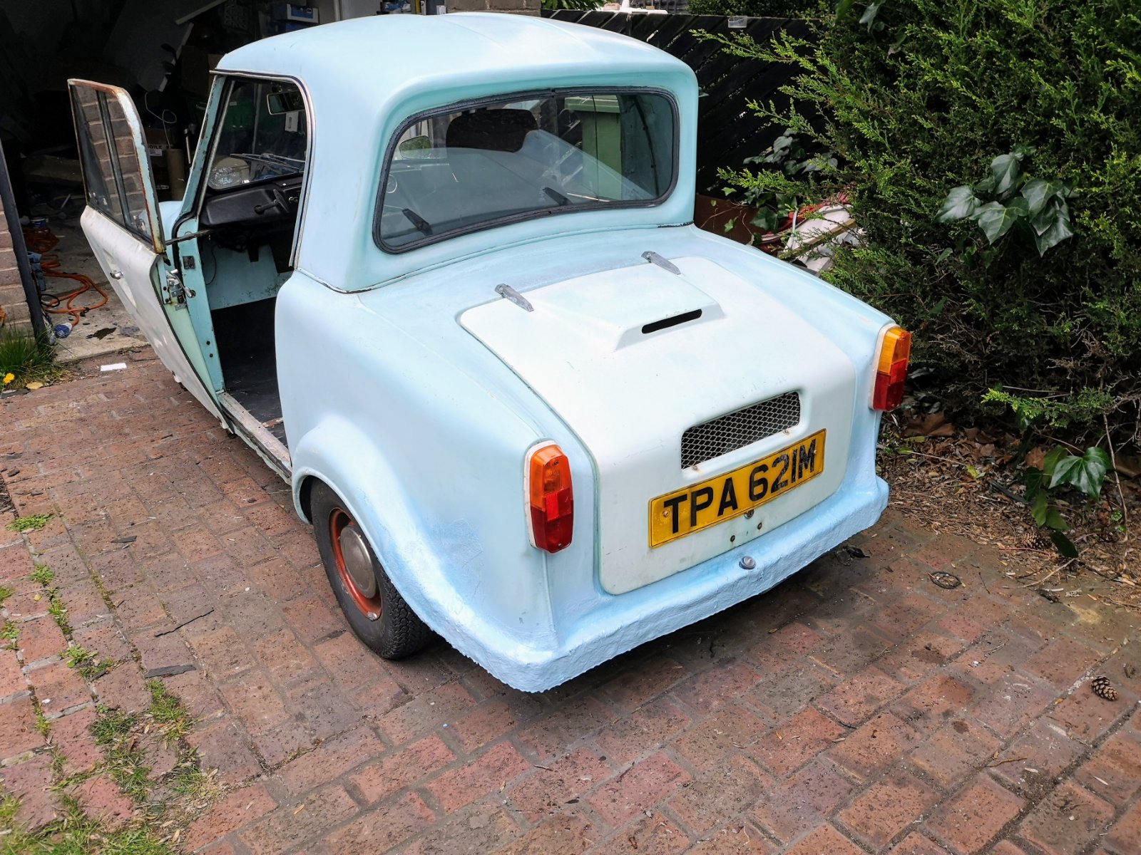

Encouraged by the success of the let couple of runs I figured it was time to start working on getting TP looking slightly less like an escapee from Scrapheap Challenge. The huge chunk of duct tape on the offside front had to go.
OSF corner starting to look vaguely the right shape again - without duct tape

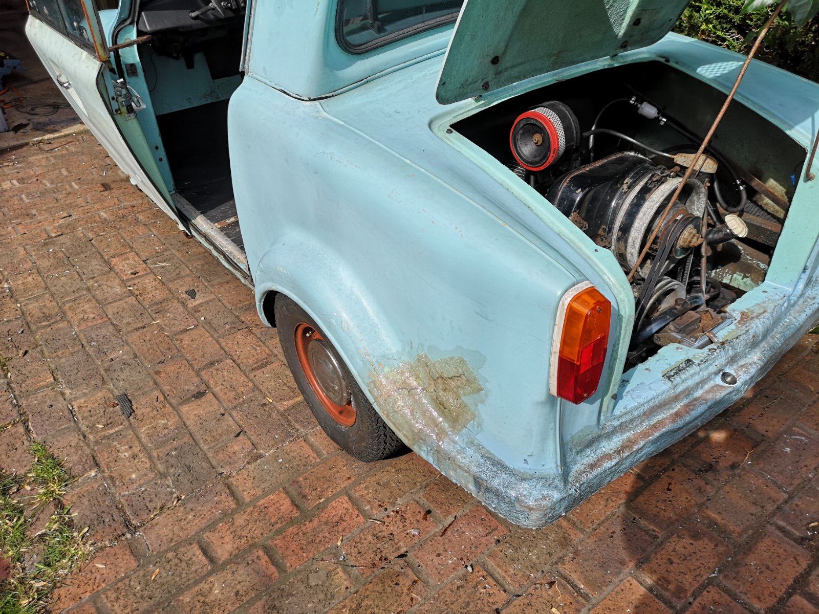

While I was at it I finally got some matting down over the huge crack in the offside rear quarter with a view to actually tidying it up at some point.
NSR quarter repair underway
On the subject of cosmetics I also figured that it made sense to get the infill strip in the gutter put back in. The original one had turned to plastic so atomised when I removed it. However I have tens of metres of the stuff for the van, so nicking a couple of feet wasn't an issue.
Because I just hadn't had enough fun fitting loads of new infill strips to the van
This actually does a lot more to tidy the car up than I expected - which shouldn't have surprised me given the visual impact of doing the same on the van.
The original fire extinguisher was a huge point of concern for people. As a result I have made the decision to swap it for a modern one.
Modern replacement for the old Halon fire extinguisher
It's a shame that whoever fitted the original extinguisher just drilled holes in the vehicle build plate. I will probably move the extinguisher at some point as I really don't like it there. It looks messy and gets in the way whenever you want to get the service hatch out. I reckon in the footwell on the opposite side of the car to the washer bottle would be better. Easier to grab in a hurry too I reckon.

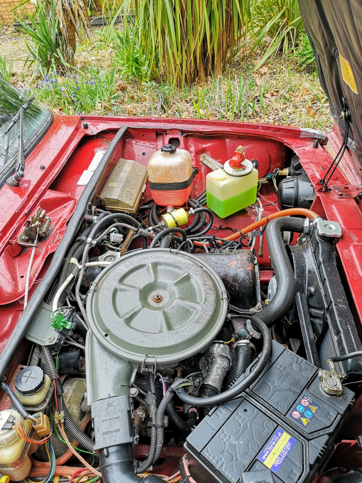

Backing the van back into the drive (I have to do some automotive Tetris to get to/from the garage) the exhaust suddenly became louder - didn't take long to discover why.
Something tells me this should be connected to something...
Interesting. Especially interesting in that the engine feels far more responsive now...so I do wonder (especially in light of where the silencer is split) if something has collapsed in there causing excessive back pressure. Will see what I can do about this shortly. On the plus side, having separated this join will make getting the main silencer off though. It's heavy enough to be almighty awkward even so.
