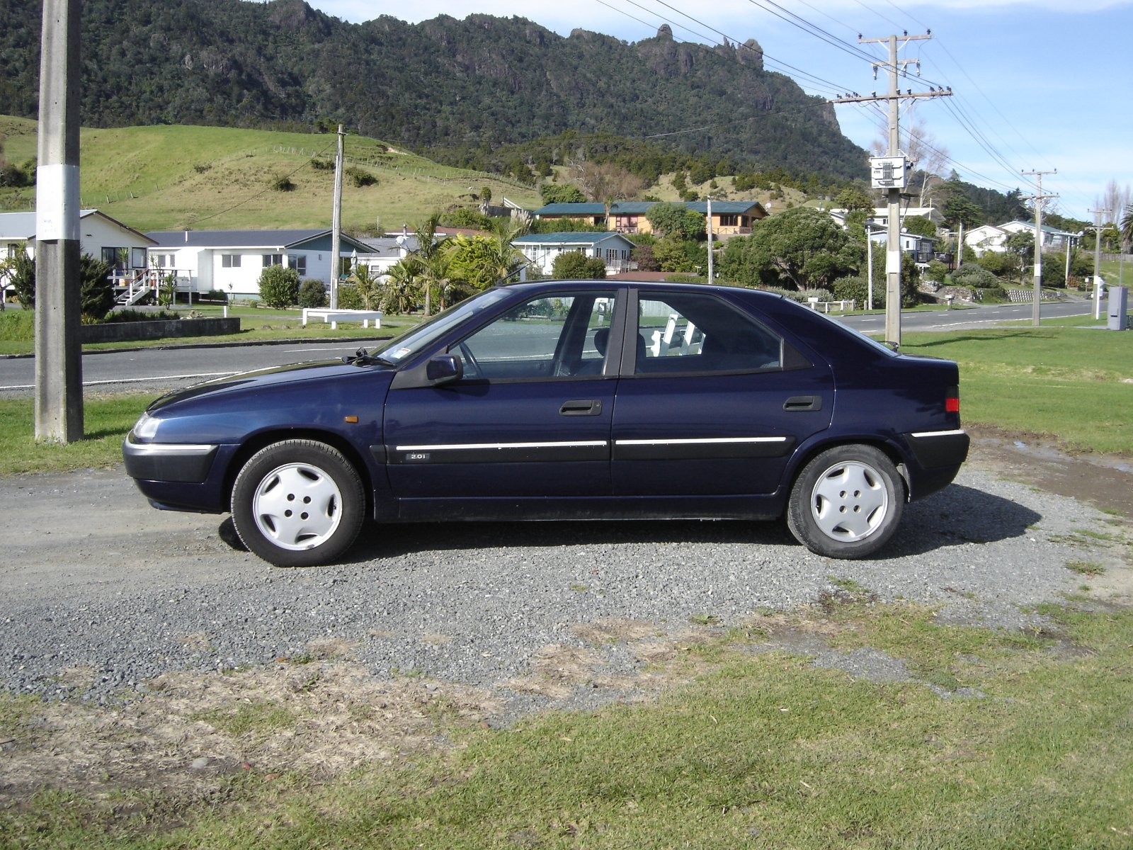

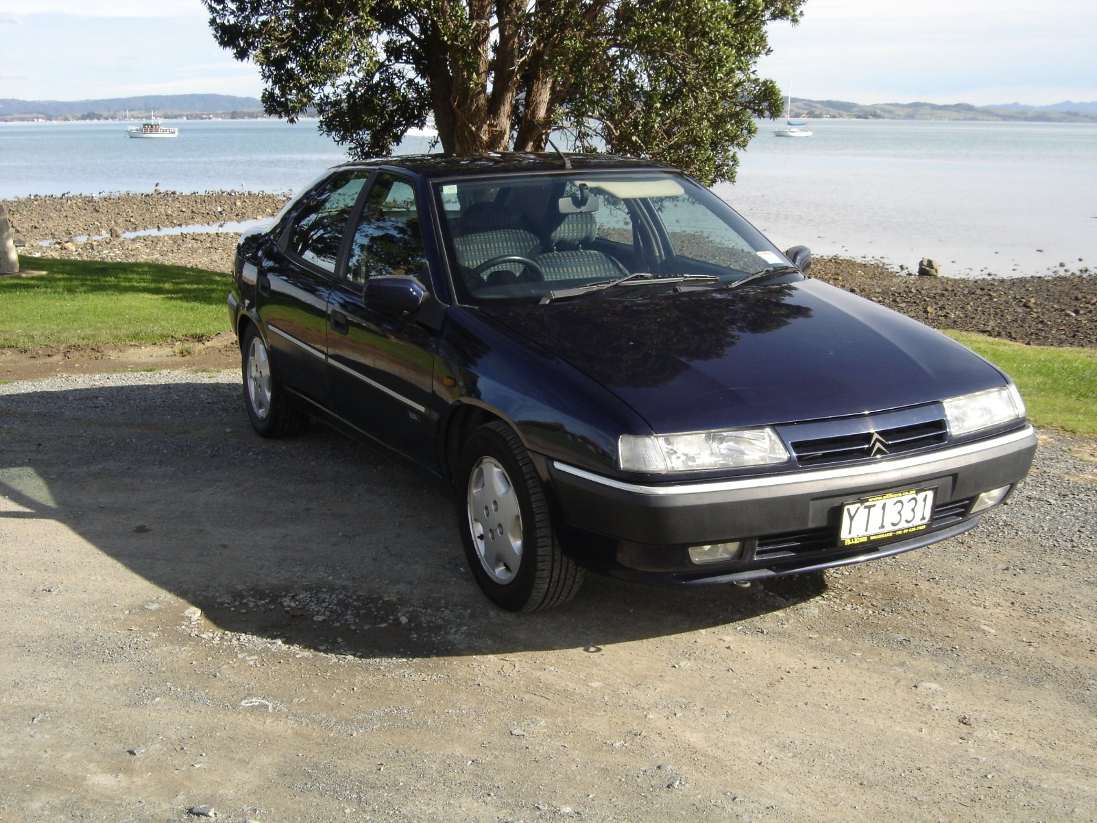

Looking through all the papers belonging to this car while finding them and found a receipt from the previous owner for new brake hoses fitted in 2012!
Can brake hoses really fail again in as little as 12 years ?
Having said that, my 2 litre petrol Xantia I had in New Zealand had issues with the front brakes where they never seemed to be as sensitive and responsive as they should be no matter what I did to them mechanically, and that car was 8 years old when I bought it and 12 when I sold it.
In hindsight I suspect it could have had brake hose issues - and back in those days I was not really aware of the manner in which a brake hose could fail (internal collapse under vacuum) and it never crossed my mind that a brake hose could cause insensitivity in the brake response and need replacing in an 8 year old car. Given these hoses seemingly failed in 12 years it does seem plausible that NZ Xantia needed brake hoses too but I will never know!
I have no idea if that car is even still on the road - probably not. :(
(Edit: I checked and the registration has been cancelled but it doesn't seem to be possible to get any information on when...)
