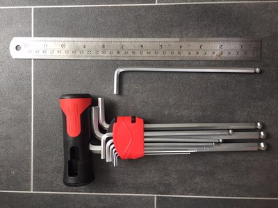

Would one of these long reach ball head Allen keys work do you think ?
The 6mm one is beside the ruler to give an idea of its length. I literally just bought this set from LIDL 2 days ago for the princely sum of £3.90. :mrgreen:
If you have a nearby LIDL nip in and see if they still have any, if not and you think it might help I can drop mine off!

Looks a handy set - Lidl on the way home from work, and one here, so good chance I can bag a set. Might need a socket drive one to crack it off, but the ball end probably useful for winding it it once it loose.
I have a set of those now :P
I reckon the ball end bit might actually be a bit long, but it should turn easily once it is cracked, I can always cut the return part off.

Not sure what you mean by the ball end bit being too long ? or do you just mean the entire length ? Would you be able to attach the plastic handle to the end or would that foul something ? #-o
LIDL are turning out to be a great source of cheap tools - for £4 you really can't complain, and their battery charger was good too! :)

Entire length - it may well come past the end of the starter and foul on something else. You can see the stunning amount of access on this video. The troublesome bolt is above the solenoid, but set back - no way you can see it without a mirror!
