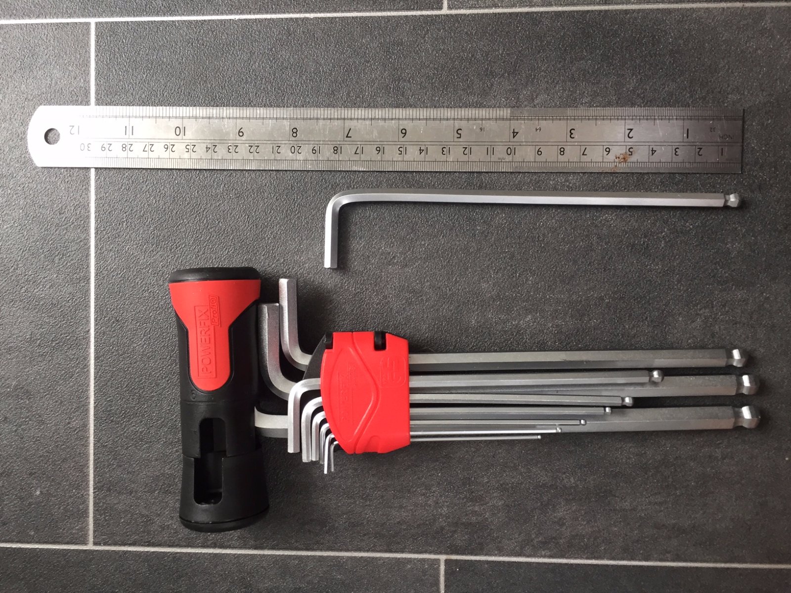

Would one of these long reach ball head Allen keys work do you think ?
The 6mm one is beside the ruler to give an idea of its length. I literally just bought this set from LIDL 2 days ago for the princely sum of £3.90.
If you have a nearby LIDL nip in and see if they still have any, if not and you think it might help I can drop mine off!

Looks a handy set - Lidl on the way home from work, and one here, so good chance I can bag a set. Might need a socket drive one to crack it off, but the ball end probably useful for winding it it once it loose.

Mandrake wrote: 16 Jul 2017, 15:15
I have a set of those now
I reckon the ball end bit might actually be a bit long, but it should turn easily once it is cracked, I can always cut the return part off.

RichardW wrote: 18 Jul 2017, 08:38 I have a set of those now![]()
Not sure what you mean by the ball end bit being too long ? or do you just mean the entire length ? Would you be able to attach the plastic handle to the end or would that foul something ?
LIDL are turning out to be a great source of cheap tools - for £4 you really can't complain, and their battery charger was good too!
